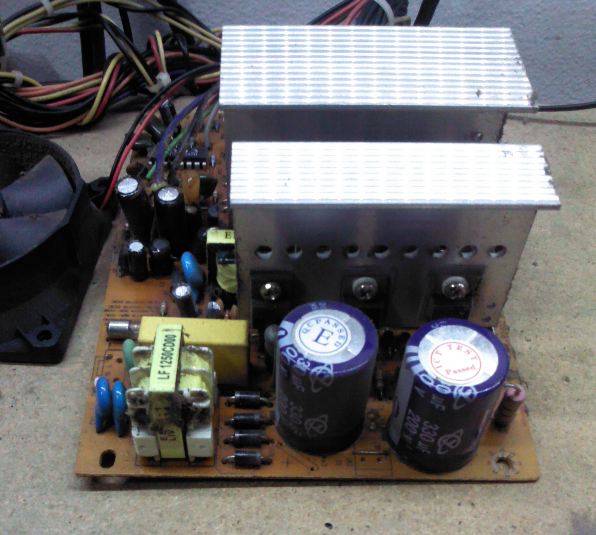

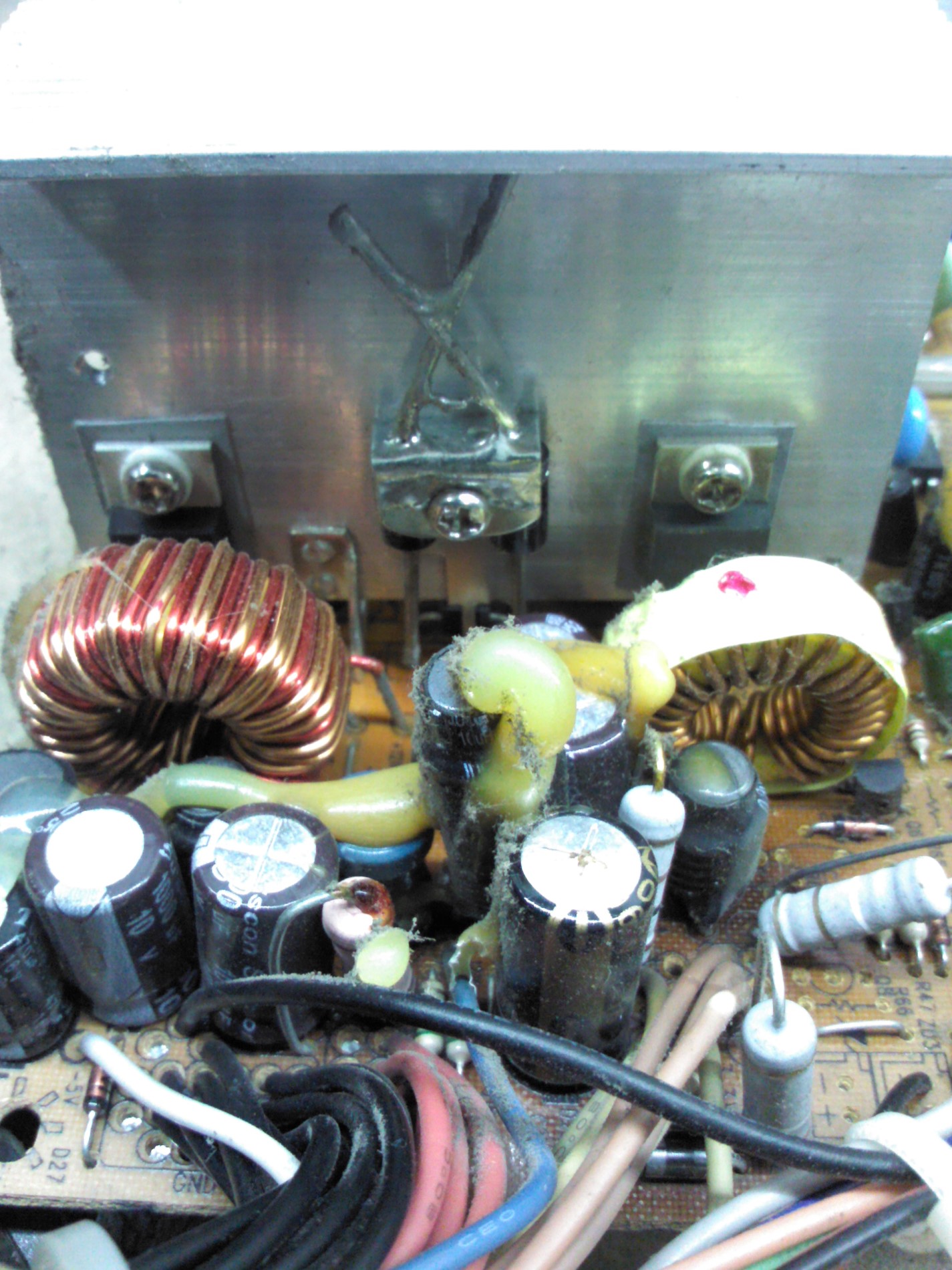

          Oh, Deer Me! Another Deer, It was branded "Mirage", rated at 500W. It's similar to the A-Power in Post 685. Let's have closer look at it.
          2A four diode treatment - check
          Tiny 330uF input caps - check
          13007 Switchers - check
          Very thin heat sinks - check
          EI-33 transformer - check
          Junk caps - check
          Two 3A fast recovery diodes on a bracket for the 12V rail - check
          Tiny secondary toroid coils - check
          No-name sleeve bearing fan with no oil in the bearings - check
          Big hot load resistors next to the secondary caps - check
          And I think that about covers it. Horrible design from the ground up.
          Sorry about the horrible picture quality. All I had was my tablet

            Oh man that is horrible. Does the fan still spin?
            Not able to supply a useful load in spec - check
            Interesting, it looks like all of the Su'scon caps are good. Did this thing kill the motherboard it was connected to?
            Also, can you post a picture of the label?

              Lots of YC (planet) caps in that PSU...
                Yuck. I'm surprised they wasted input filtering on this thing. Those are actually decent looking Y caps
                  Yes, it does. It doesn't have any odd sounds either, although I've seen those same fans fail lots of times before
                  I noticed that. It looks like Yang Chun are worse than Su'Scon. No, it didn't take the board with it. I replaced it with an In Win IP-S400EQ3-2 and the PC was fine.
                  No, I don't have the label. I peeled it off and tossed it before I took the pics. I transplanted the innards of a Dell H305P-00 PSU into its case.
                  • Pentium4
                    CapXon Be Gone
                    • Sep 2011
                    • 3741
                    • Power supplies are my primary interest
                    #709
                    Re: the gutless, bloated, and fried power supply hall of shame
                    I'm surprised, and judging by the dust it ran for a long time. A drop of oil and it might last a while assuming the motor isn't on its way out
                    That's embarrassing. Although I think the Su'scon also would have failed had they been on the 5VSB
                    Nice! The case must have lots of holes in it. Is it not one of the classic flimsy aluminum-esque cases?

                      The case wasn't too bad. It had plenty of ventilation (similar vent structure to the one in post 685), and even screw holes for a front 80mm fan (which I installed, after cutting out the area in front of it)

                        more openings to let the sparks/flames leave.
