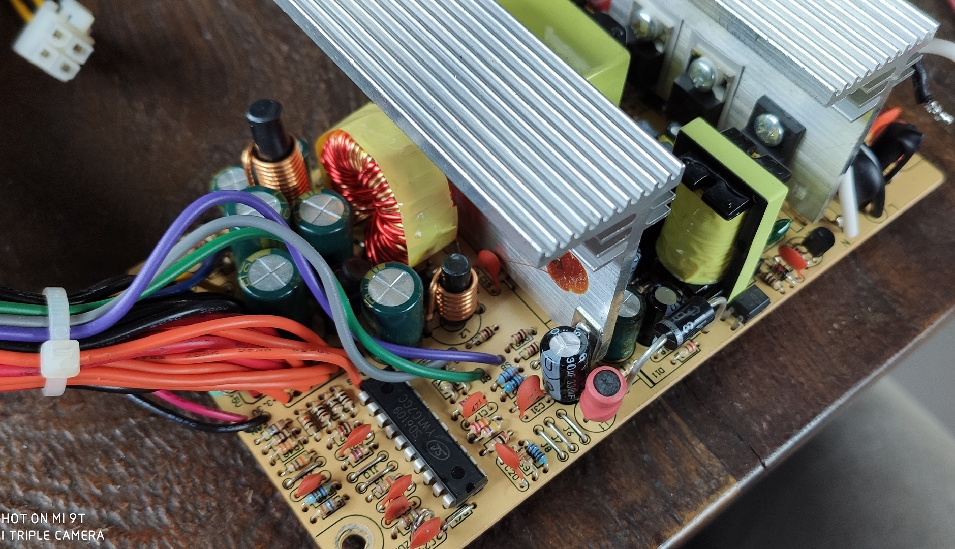

    Back in 2020 i bought a (2nd hand) compact ATX psu to replace my current one. My PC case only fits very short ATX power supplies so i didn't really have the choice of buying a decent 80Plus unit. The current unit is a modded YoungYear unit that i made a thread about a while ago:
    A "nice" YoungYear unit? - Badcaps
    The "new" unit is a KDM-M6480 480W psu, the 480W number is a typical KDM bullshit claim of course, but the 24A rating on the 12V rail seemed reasonable and the "Active PFC" claim gave me a bit of hope that this was going to be decent-ish. I mean, they even included an input voltage selector switch 🤨
    Click image for larger version  Name:	compactpsu.jpg Views:	0 Size:	161.9 KB ID:	3168444Click image for larger version  Name:	psulabel.jpg Views:	0 Size:	211.7 KB ID:	3168445

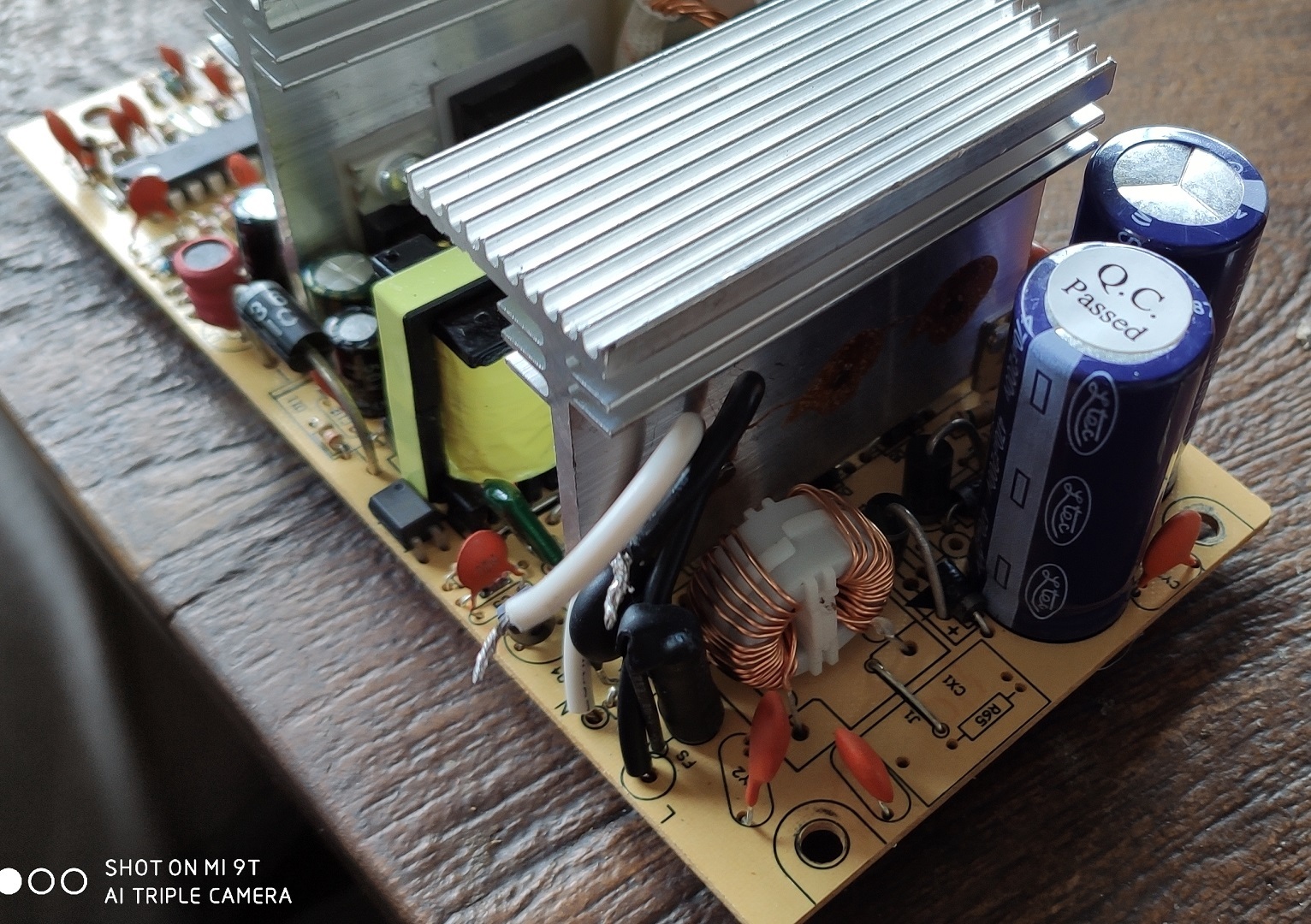

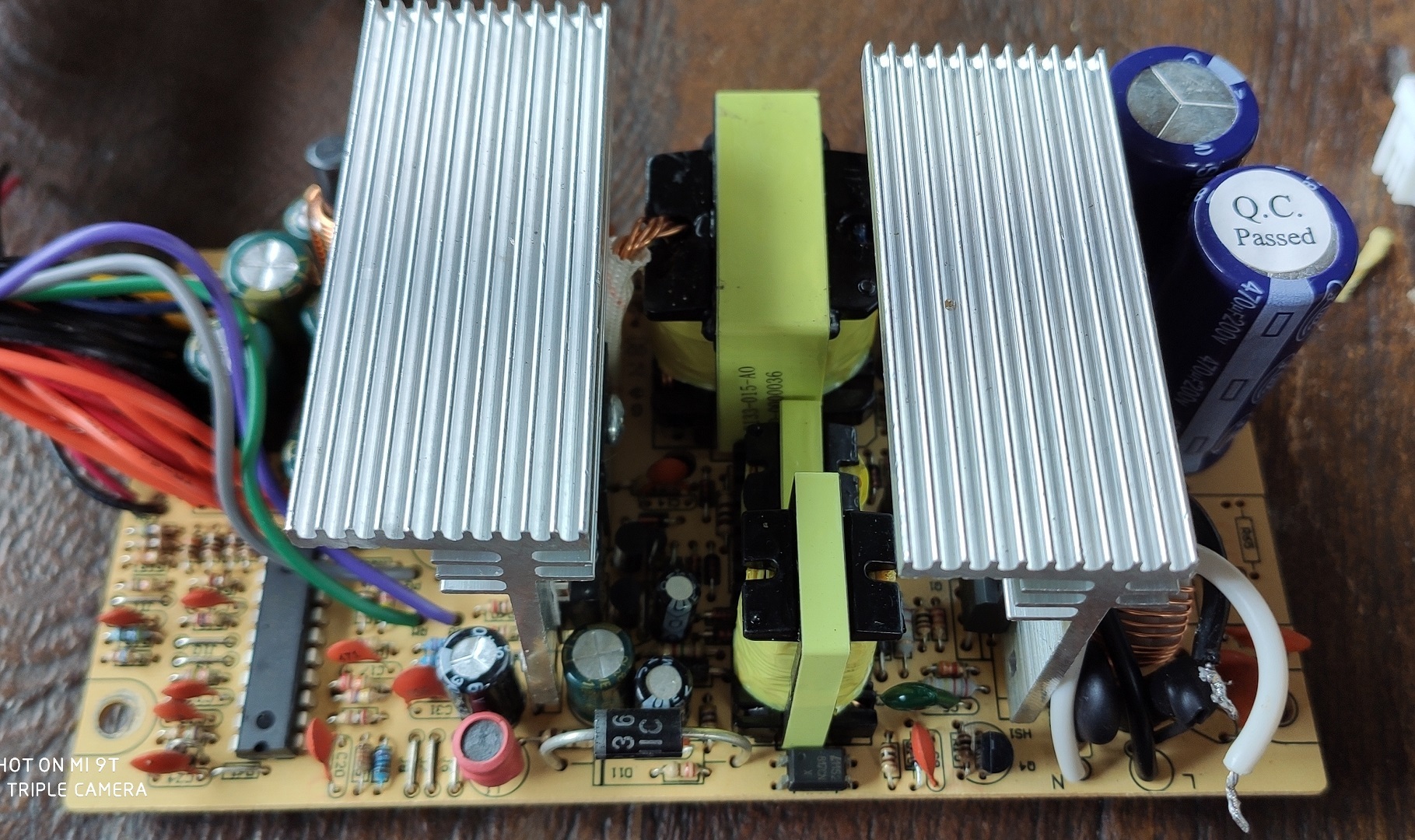

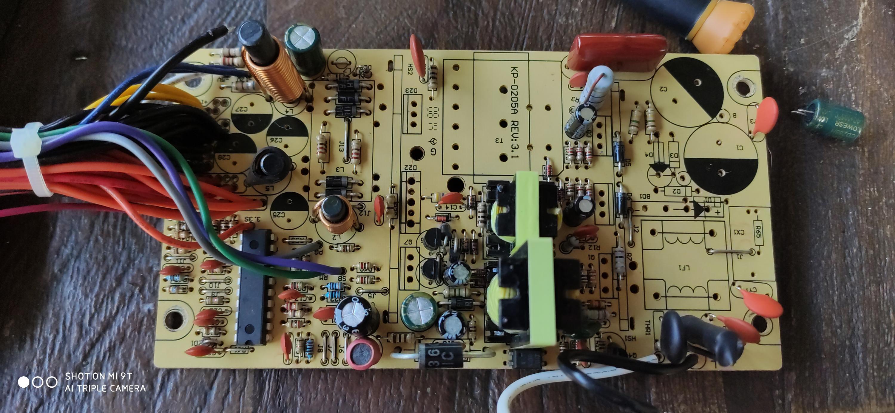

    Opening up the unit made clear it wasn't a decent Active-PFC unit and that it wasn't going to hit that 24A spec, 200W in total would've probably been a more realistic expectation...
    Click image for larger version  Name:	fetch?id=2047644.jpg Views:	0 Size:	505.5 KB ID:	3168446Click image for larger version  Name:	fetch?id=2047645.jpg Views:	0 Size:	668.2 KB ID:	3168447Click image for larger version  Name:	fetch?id=2047646.jpg Views:	0 Size:	559.7 KB ID:	3168448Click image for larger version  Name:	fetch?id=2047647.jpg Views:	0 Size:	694.3 KB ID:	3168449
    Low and behold, a very basic and compactly built half-bridge unit... Just a mediocre one. There hasn't been any extreme corner cutting when compared to the real gutless wonders, but definitely not powerful in any way. The transformer and output toroid are pretty small and the PFC is nowhere to be found. Some noteable things were the partially present input filtering (yay), low profile transformer (EI33 but shorter), the small output toroid and the 3.3V rail which is actually tapped from the 5V rail and regulated with a mosfet.
    The last couple of years this PSU was one of my side projects which sometimes got a bit of attention. The modded YoungYear unit was lasting better than expected so the urge to complete this project disappeared for a bit. But recently i acquired an Oculus Quest 3 VR system which required a bit more graphical horsepower from my PC. So here i go, ordering a Radeon RX6800 GPU while being fully aware that my current YoungYear unit can't handle it 😅 All hopes are on this KDM unit now 🤞 A couple of years ago i did make the first round of upgrades and posted the results in the hall of shame thread:
    https://www.badcaps.net/forum/troubl...75#post1423575

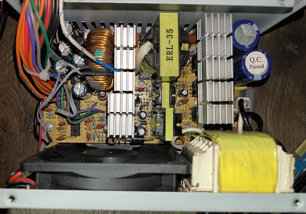

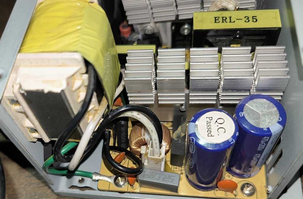

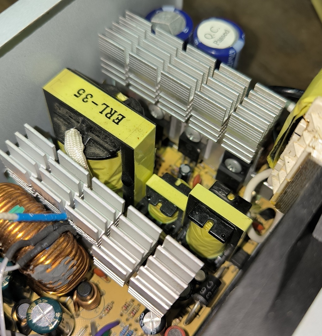

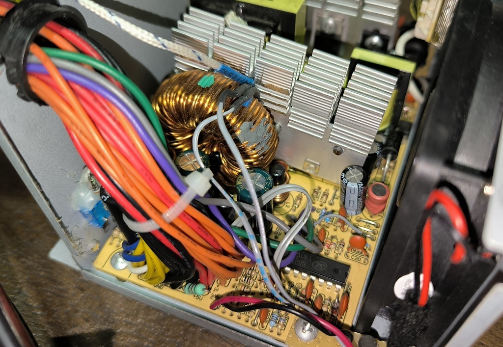

    To keep thing simple i'll just post the end result here. Last week i gave it a final round of upgrades, hoping it would do ~300W. It got upgraded quite extensively, the transistors, 12v rectifier, main transformer, output toroidal and heatsinks were upgraded. The whole PSU got Teapo-fied except for the primaries. Passive PFC was also added as well as temperature-based fan control.
    Click image for larger version  Name:	PSUPCB.jpg Views:	0 Size:	232.4 KB ID:	3168452Click image for larger version  Name:	psuoverview.jpg Views:	0 Size:	254.3 KB ID:	3168453Click image for larger version  Name:	psusecondary.jpg Views:	0 Size:	274.7 KB ID:	3168454Click image for larger version  Name:	psumisc.jpg Views:	0 Size:	349.3 KB ID:	3168455Click image for larger version  Name:	psuprimary.jpg Views:	0 Size:	218.1 KB ID:	3168456
    Primary:
    NO PFC -> Passive PFC
    2x Y capacitor
    NO X capacitor -> added X capacitor
    1x common mode choke -> 1x better wound common mode choke
    2x 2.5A diode + 2x 4A diode -> KBL406 rectifier bridge
    2x 470uF 200V Ltec primary caps
    2x 13007 primary transistors -> 2x D304X primary transistors (still TO220)
    1x SVD2N60F mosfet
    Swapped primary heatsink
    Middleware:
    ERL33 low-profile transformer -> ERL35 full-height transformer (swapped the primary snubber circuit with it)
    SC6105 switching controller
    Added temperature-based fan control
    Secondary:
    12V: MOSPEC F16C20C 16A TO220 Fast Recovery -> DSSK 40-008B 40A 80V TO-247 Schottky
    5V: MOSPEC S30D45CS 30A TO247 Schottky
    3.3V: Advanced Power AP40N03GP 40A mosfet (tapped from 5V)
    Tiny output toroid -> Way bigger output toroid (with more efficient green/blue core and thicker windings)
    Swapped secondary heatsink (modified a bit to make the larger output toroid fit)
    Output Filtering:
    12V: 1x 1000µF 16V ChengX, PI Coil -> 2x 1500µF 16V Teapo SY, PI Coil
    5V: 2x 1000µF 10V ChengX, PI Coil -> 2x 2200µF 6.3V Teapo SC, PI Coil
    3.3V: 1x 1000µF 10V ChengX, PI Coil -> 1x 2200µF 6.3V Teapo SC, PI Coil
    +5VSB: 1x 470µF 16V ChengX -> 1x 1000µF 6.3V Teapo SY
    -12V: 1x 470µF 16V ChengX, NO PI Coil -> 1x 1500µF 16V Teapo SY, added PI Coil
    -5V: 1x 470µF 16V ChengX, NO PI Coil -> 1x 1000µF 6.3V Teapo SY
