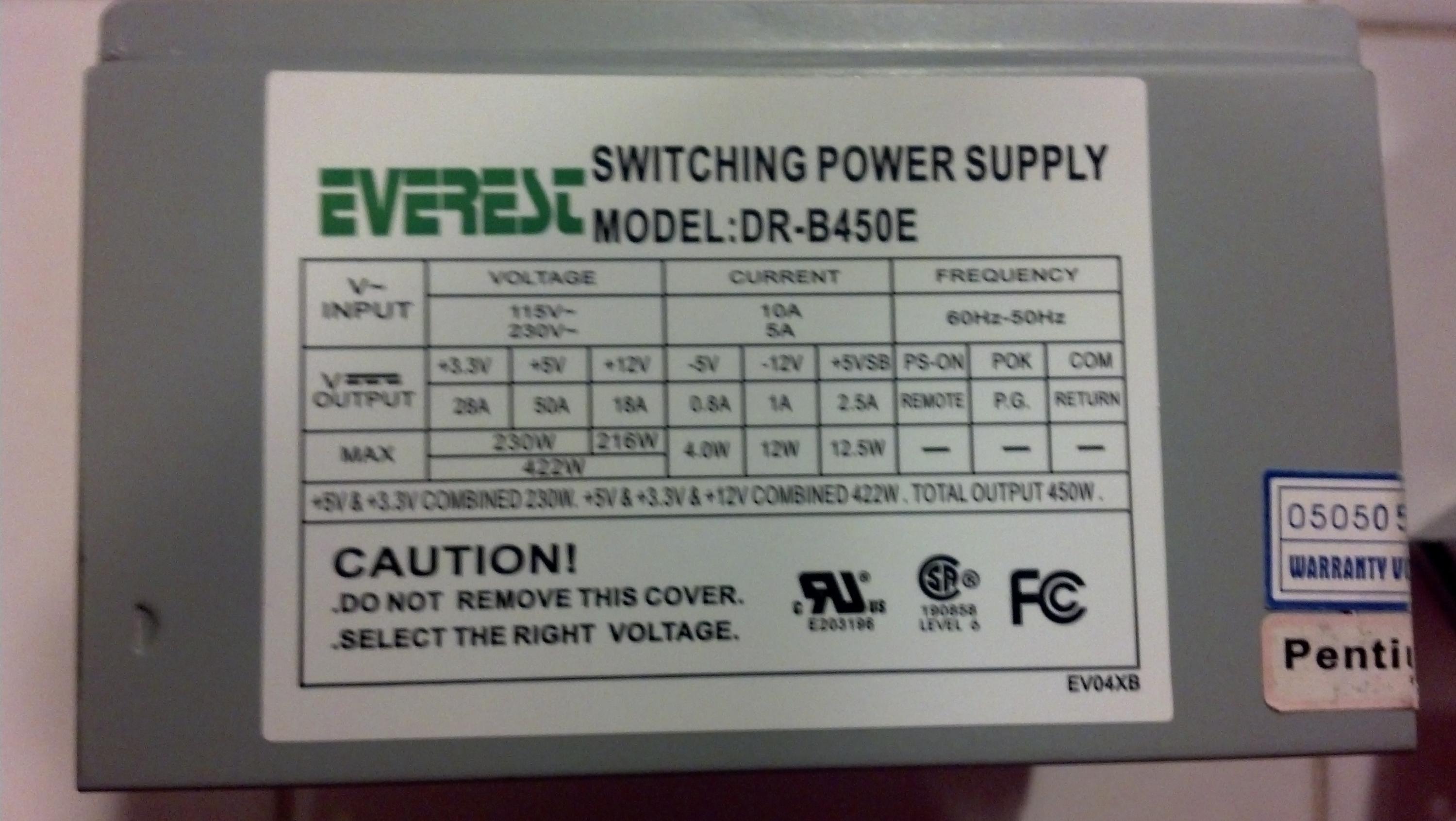

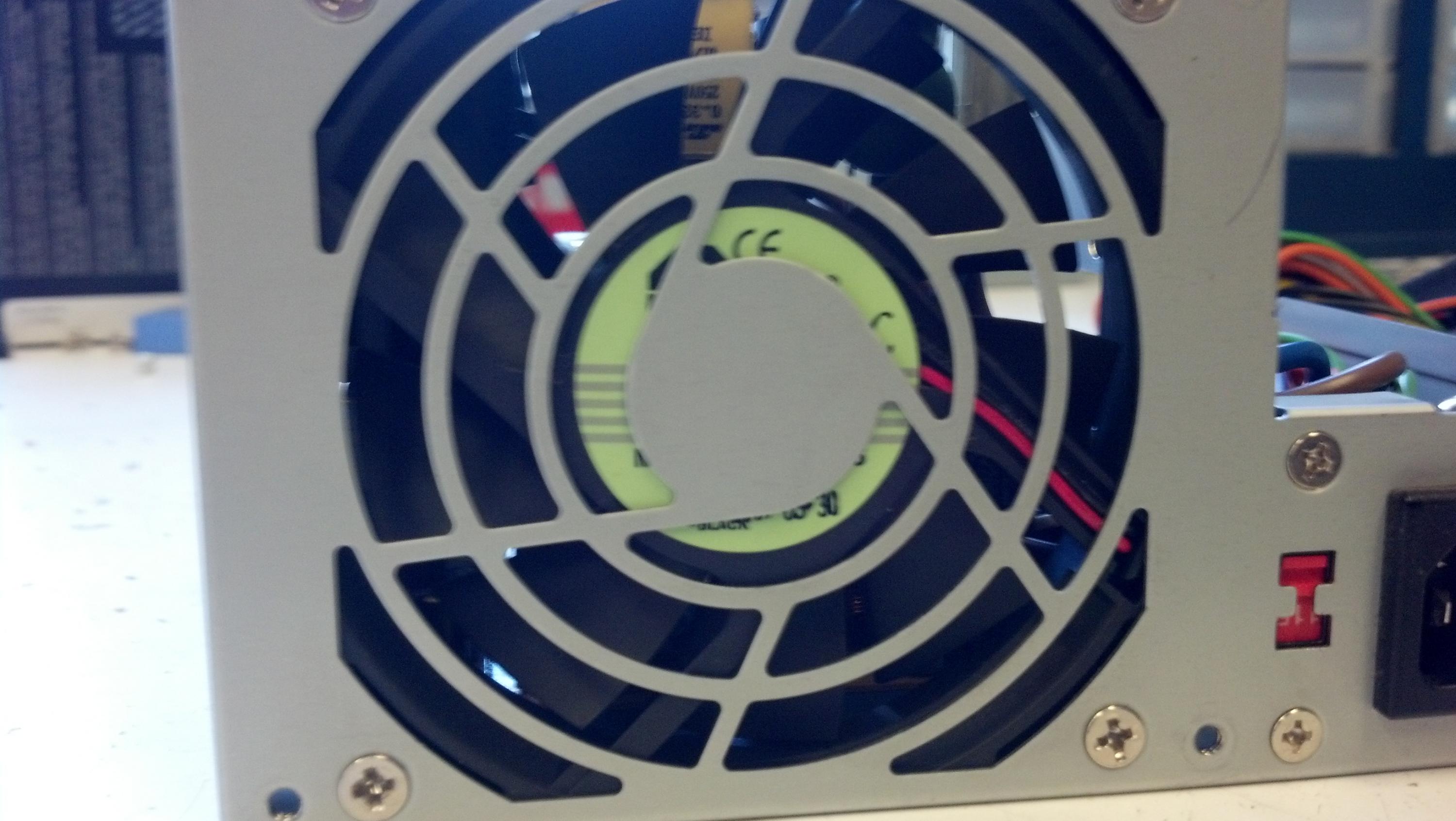

                      #670
                      Re: the gutless, bloated, and fried power supply hall of shame
                      I'm going to steal Behemot's line and say "prepare your vomit pale"
                      I can't believe this was used in a computer for years. Those poor components. 220uF input caps, four 2A diodes, D4242 switchers, 10A for 3.3V, 16A for 5V, and two 3A diodes for 12V One cap for 12V filtering. "Pentium 4 ready" ?!?! those diodes would barely be able to handle JUST a P4 let alone everything else that uses 12V!
                      Fan is made by Foxconn, sorry for the blurry pics they didn't seem blurry till I uploaded them
                      Maybe it's called "Everest" because it would need to run at the top of Mt. Everest to do over 150W without overheating?

                        #671
                        It was waiting for you the whole time

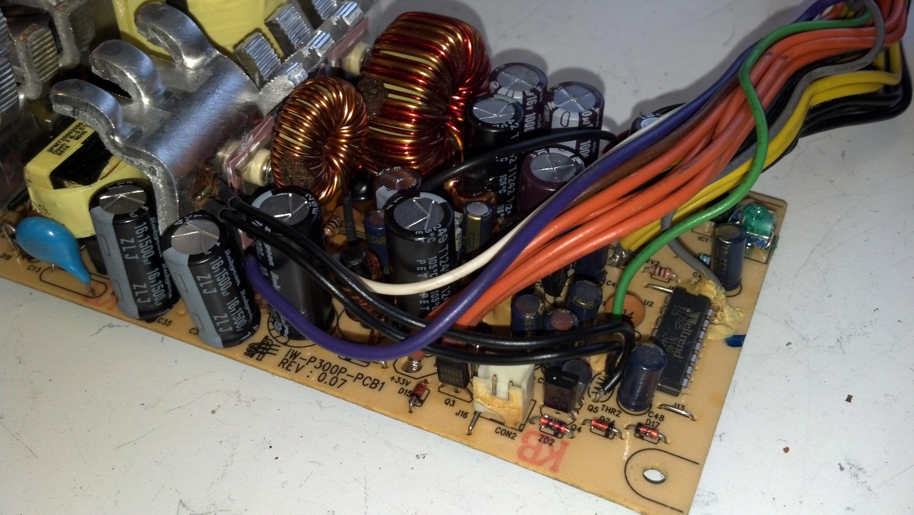

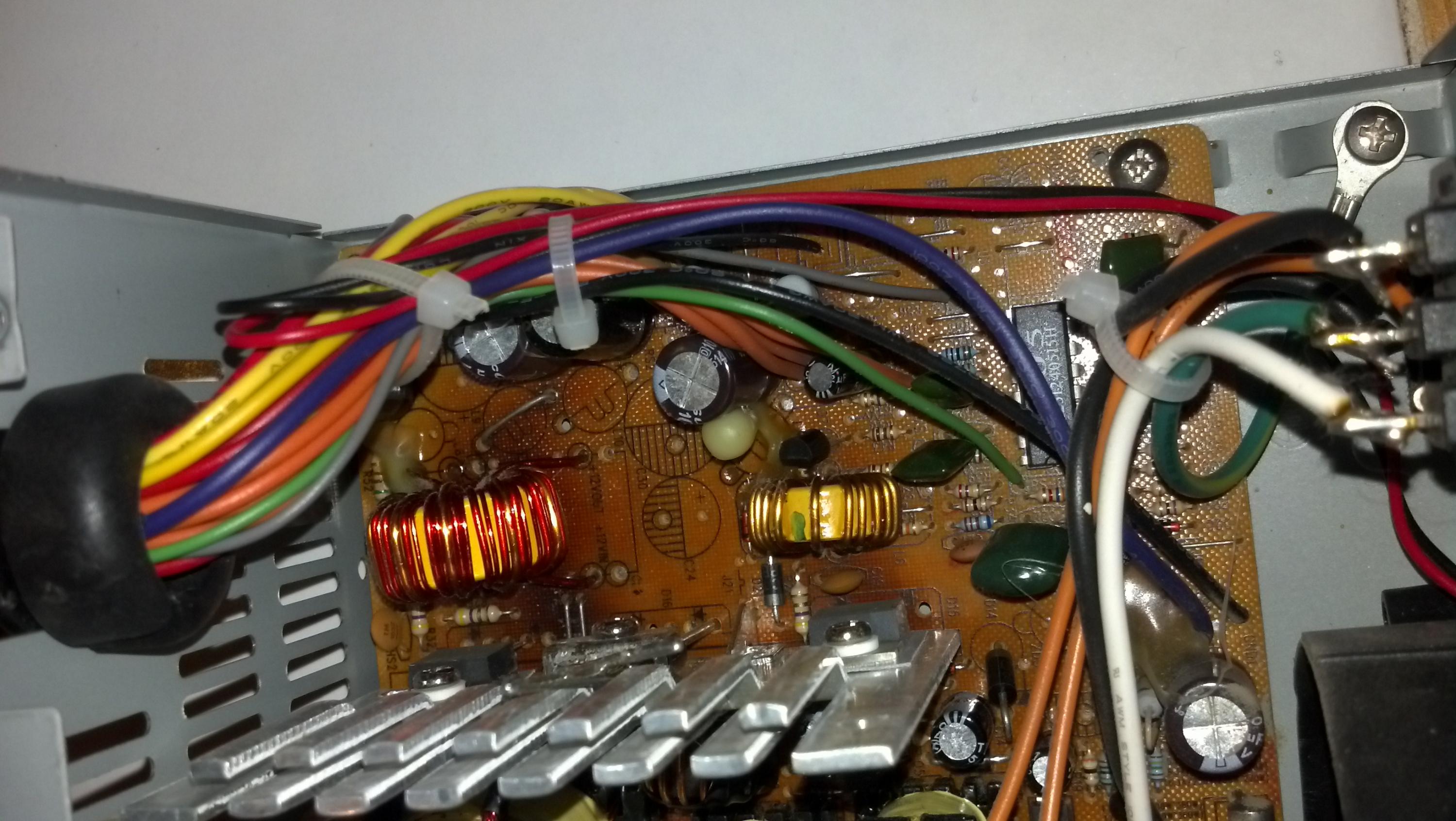

                            #673
                            Wow, look at how smokin hot that filter choke got!
                            I guess those caps survived because they weren't mounted next to any hot components xD
                            What is wrong with the psu? Does the 5vstby read 5v, or does it read 20v?
                            Muh-soggy-knee
                            • kaboom
                              "Oh, Grouchy!"
                              • Jan 2011
                              • 2507
                              #674
                              Looks just like the free-with-tigerdirect-case power supplies.
                              Because it is.
                              Looks like undersized traces overheated, discoloring the board... The winding varnish is not discolored.
                              What isn't?
                              No X-rated line-to-gnd caps
                              "Invisible" RFI/EMI filter- that's ok since the "FCC" logo is fake
                              Undersized wiring, complemented by overfusing
                              But at least the standby transistor is heatsinked!
                              25v, with lots 'o ripple- the 5VSB cap, yes, just one of them, seems to be "hiding out" behind the heatsink... :eek:
                              A Deer, perhaps? "Model number" (that they pulled outta their ass) is the same format. xxB-450.

                                #675
                                Because it is.
                                What isn't?
                                In "what is wrong with it" I meant, is there a short on one of the rails? Blown transistors? 5vsb overvoltage, etc...
                                Lol at the 25V on the 5vsb!
                                Muh-soggy-knee
                                • kaboom
                                  "Oh, Grouchy!"
                                  • Jan 2011
                                  • 2507

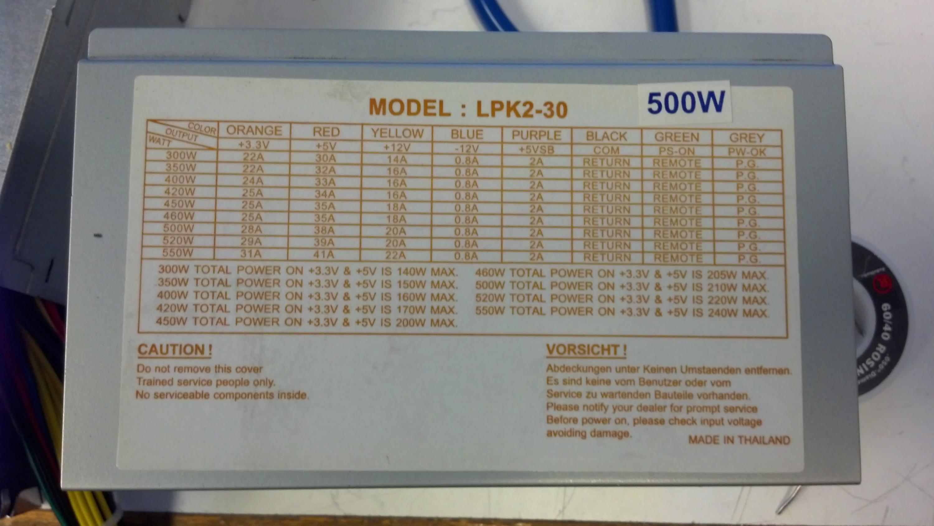

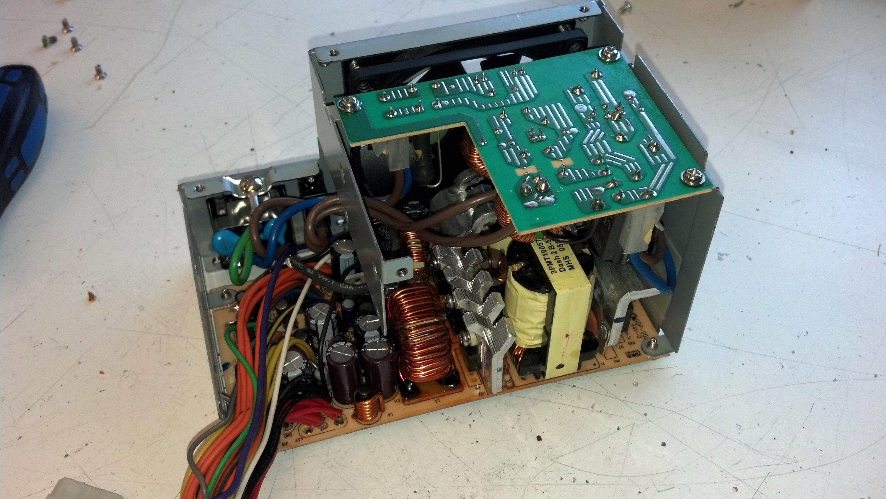

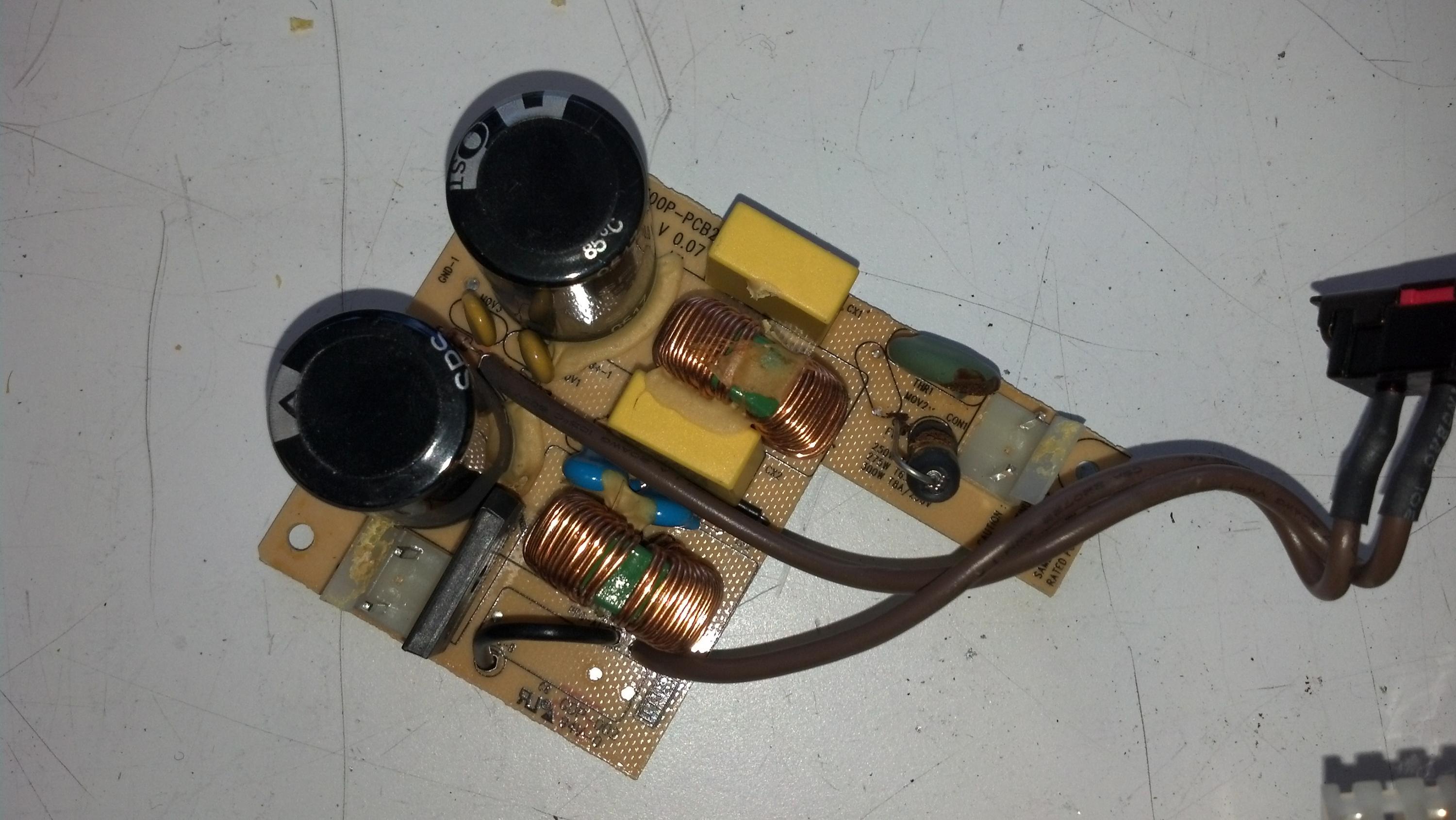

                                      #678
                                      Linkworld LPK2-30. I am somewhat surprised by this thing actually, but it still sucks. 470uF Fuhjyyu input caps. Really surprised to see a 6A bridge and 12A TO-247 switchers. What else is surprising, no fast recovery rectifiers, and the biggest one is on the 12V. 3.3V = 20A, 5V = 20A, 12V = 30A. And...it even has a good size inductor on the 12V, but a Fuhjyyu cap... Sleeve bearing fan wired straight to the 12V 5V minimum load resistor is burned up.
                                      I would consider recapping this and replacing the fan if the main transformer wasn't microscopic.
