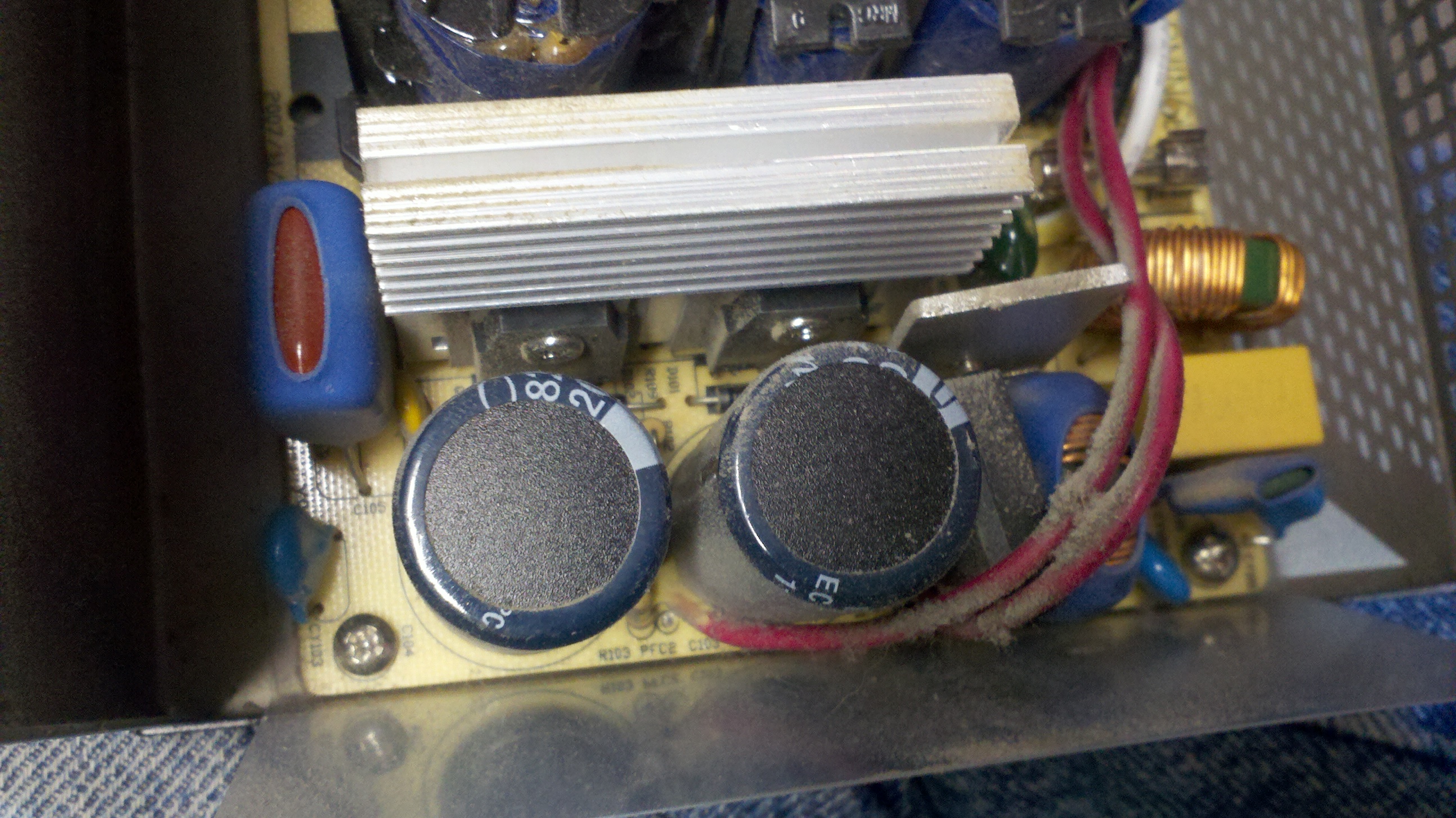

                    Re: the gutless, bloated, and fried power supply hall of shame
                    nice lead dress there huh?
                    sleeving those cap leads would have cost about 1/10 of a cent!
                    Originally posted by LDSisHere
                    The way the caps are attached to the mains input is very......interesting. Safety must have been their main concern followed closely by wanting to put out a quality product that would easily do its' full rating.
                    The important question is did the original buyer learn their lesson?

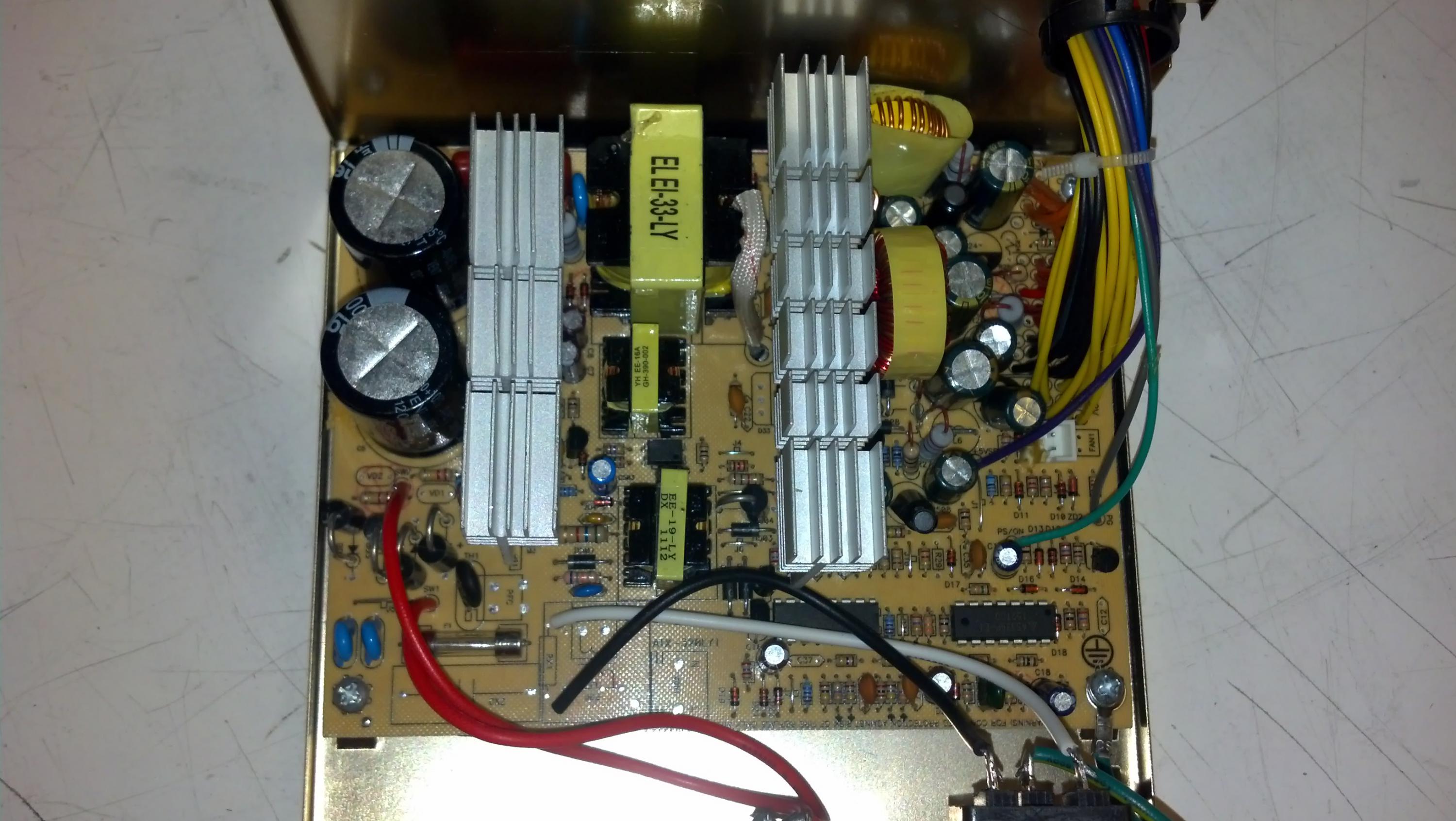

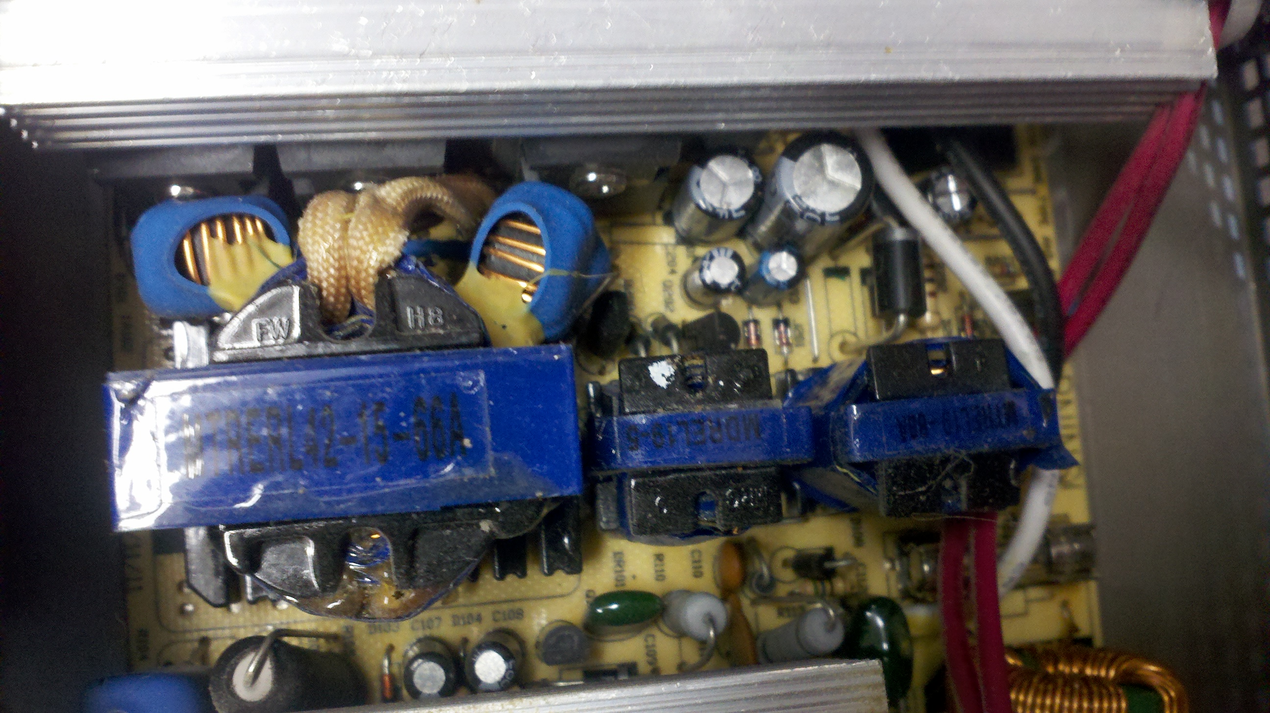

                      #790

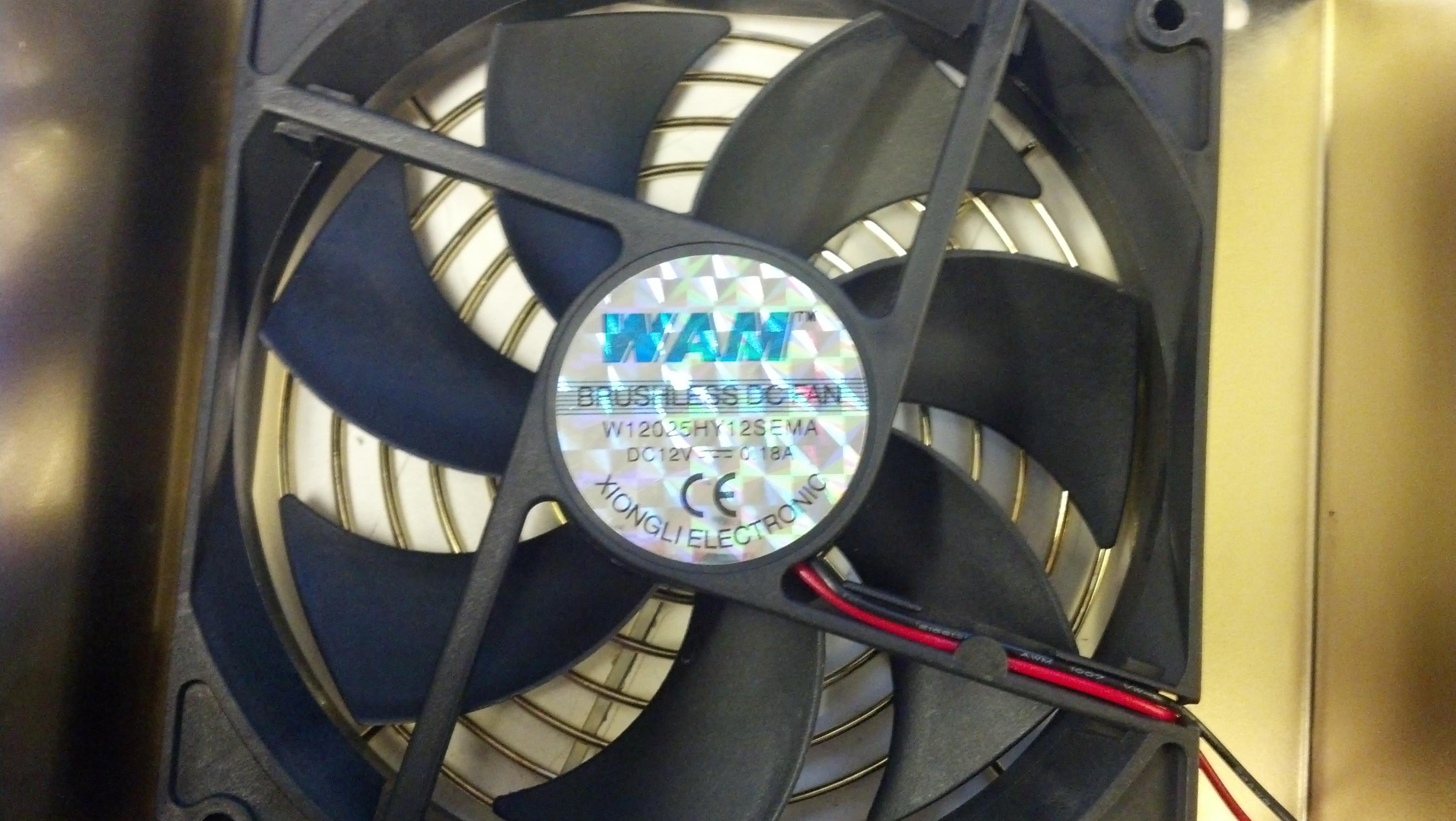

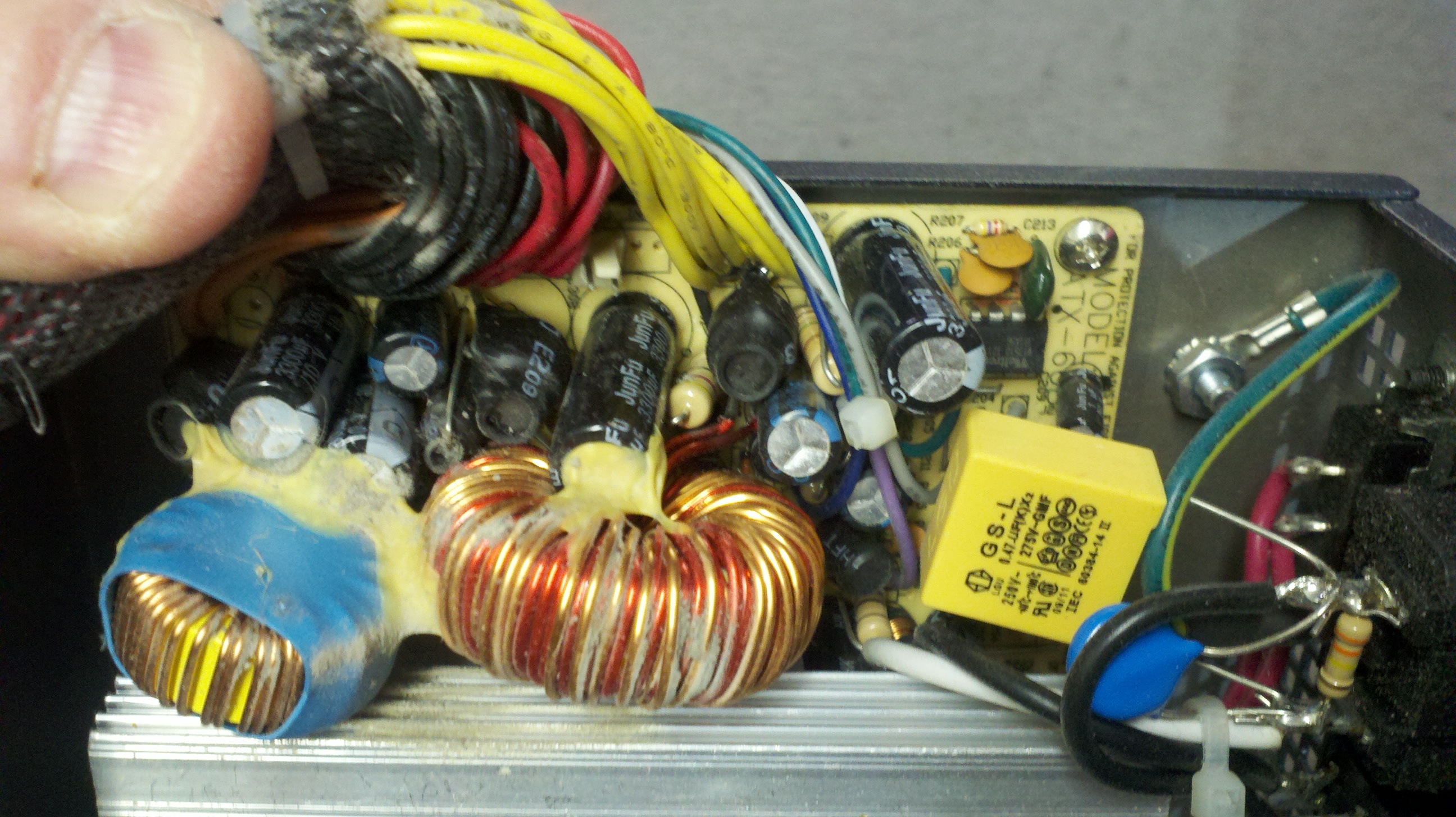

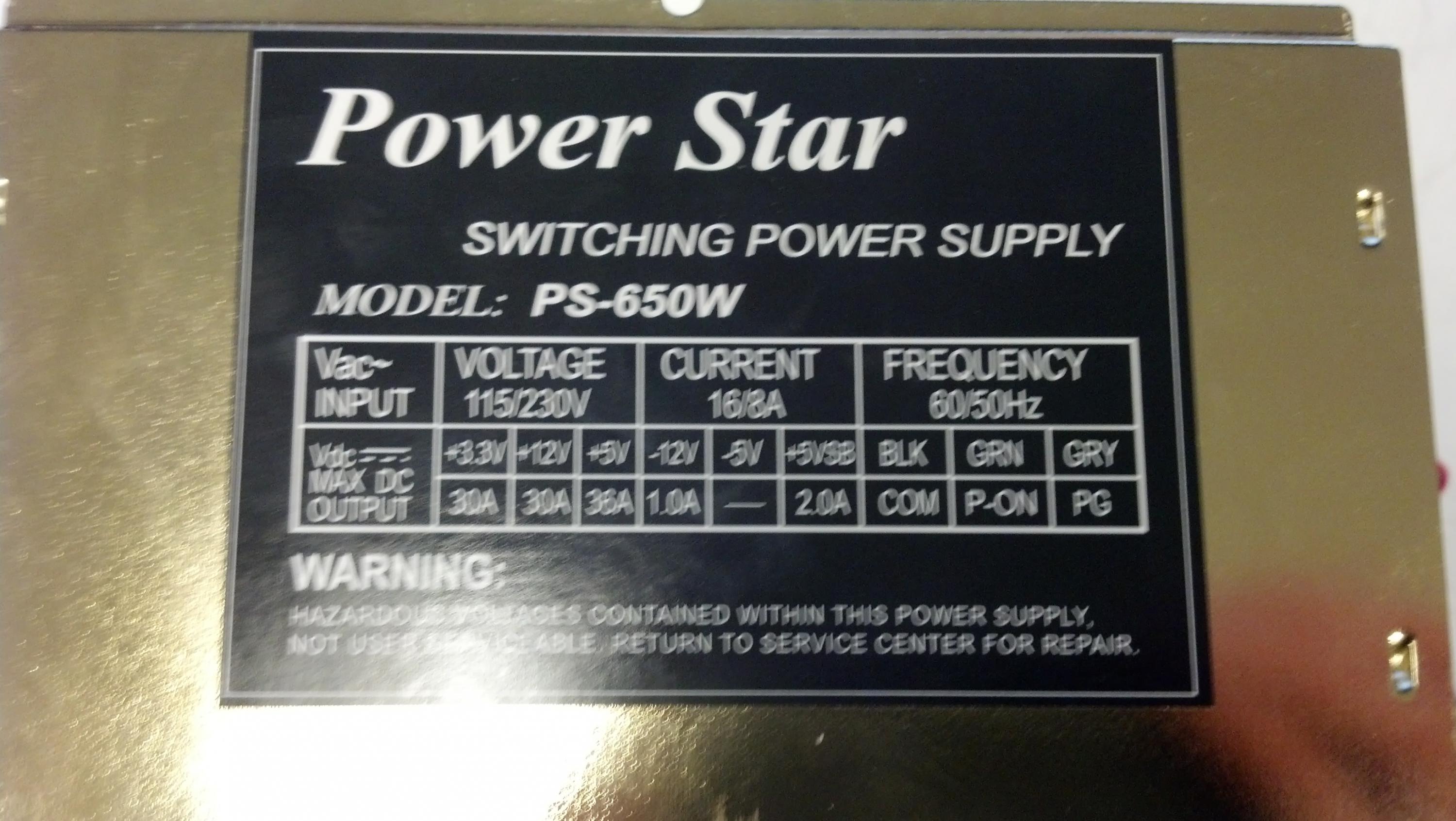

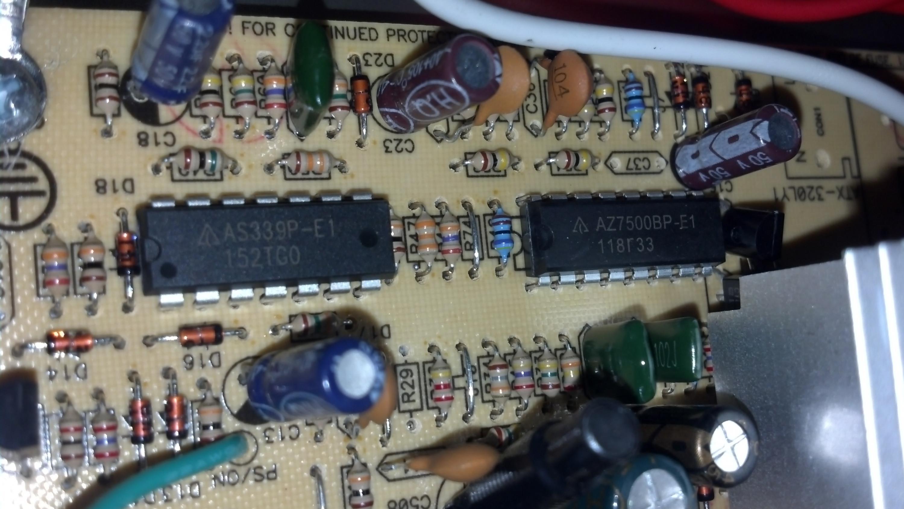

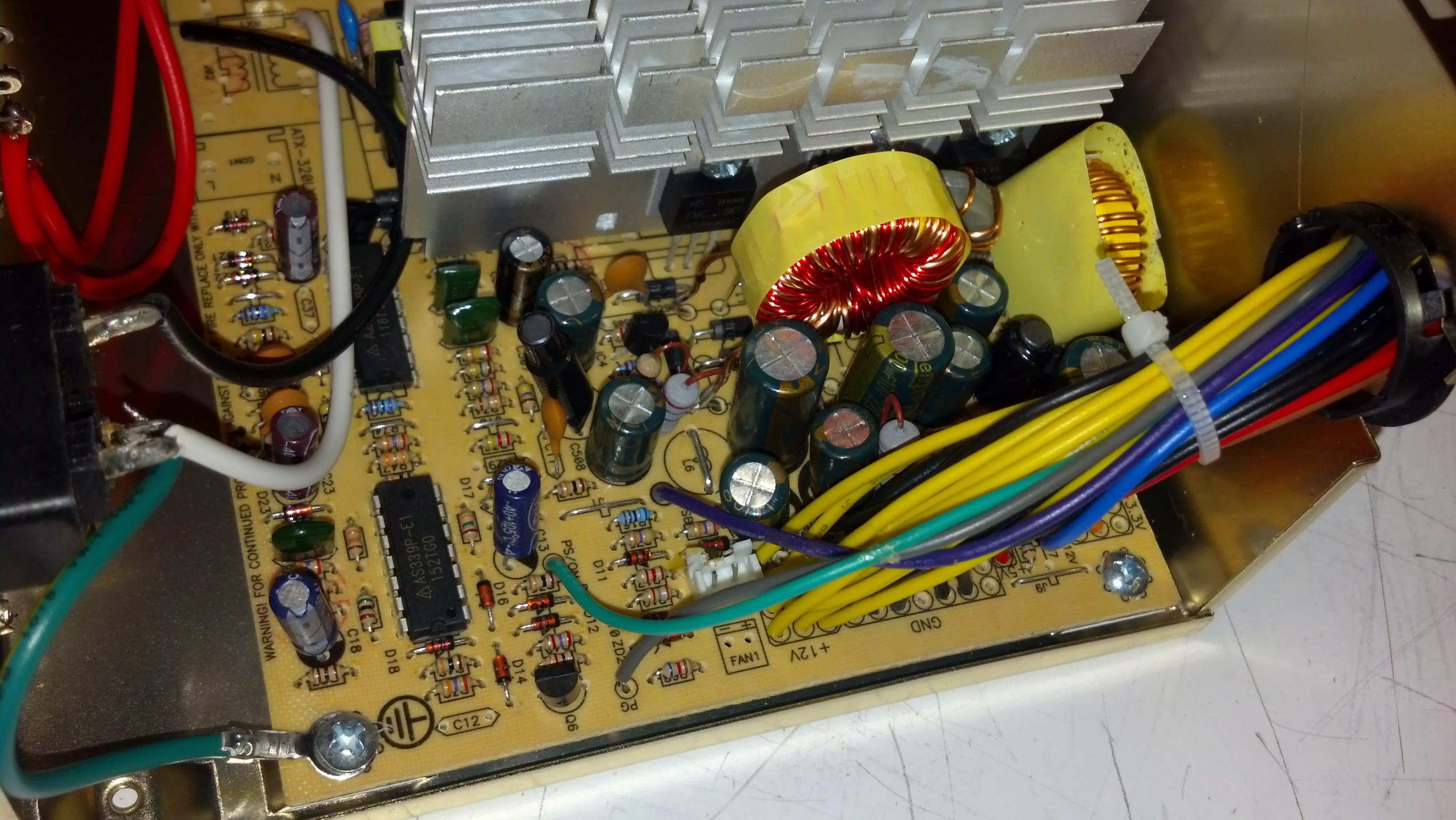

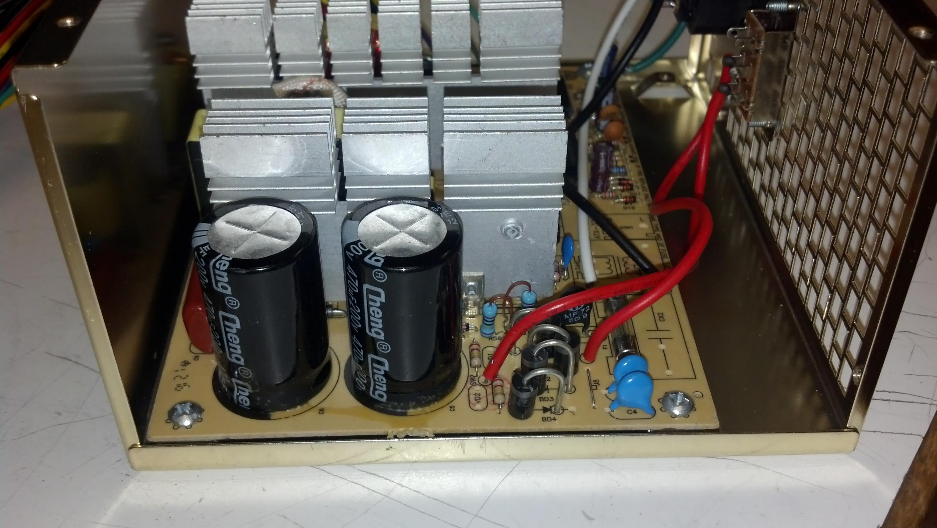

                      Power Star PS-650
                      So Power Star, 650W huh? Ohhhh they meant at -25*C ambient But at a realistic temperature....250W cause of those 13007's. Even if it had 13009's, that transformer could pump out maybe 300W?
                      The NTC thermistor looks pretty pitiful
                      The rectifiers are a joke with 12V = 16A, 3.3V = 20A, 5V = 20A. I found it interesting how they used a PI filter on the 3.3V rail but put a jumper for the 5V and 12V PI coil slots. So maybe your RAM won't fry?
                      The 5VSB transformer is tiny! And using the 2 transistor design, I'm sure that area would run pretty hot.
                      The only words of praise this unit gets, is that ugly WAM fan moves a lot of air while being quiet, and the bearing was well lubricated
                      Not sure who OEMs it but on the PCB reads "ATX-320LY1" I imagine you could get this design up to 320W safely with the right parts
                      Chinese worker 1: I know this thing is unreliable and all....but how can we make it less reliable?
                      Chinese worker 2: I dunno...maybe make that hot minimum load resistor physically touch that low quality H.Q. cap?
                      Chinese worker 1: Genius!

                        #791
                        Pretty standard 200-250W TL494 clone based, 25-50KHz half bridge design. Even a mere 250W would cook the O/P caps or the O/P inductor cores. Assuming the main transformer core didn't saturate, with a resulting in a loud noise, bright flash, and unpleasant smell.

                          #792
                          The only good about it is it looks like it has proper Y capacitors ... not regular, unsafe, ceramic capacitors.

                            #793
                            Re: Power Start PS-650
                            Originally posted by Pentium4
                            Not sure who OEMs it ...
                            If you look at the fan, you can tell that the OEM is Mary. Because it has a little Wam.
