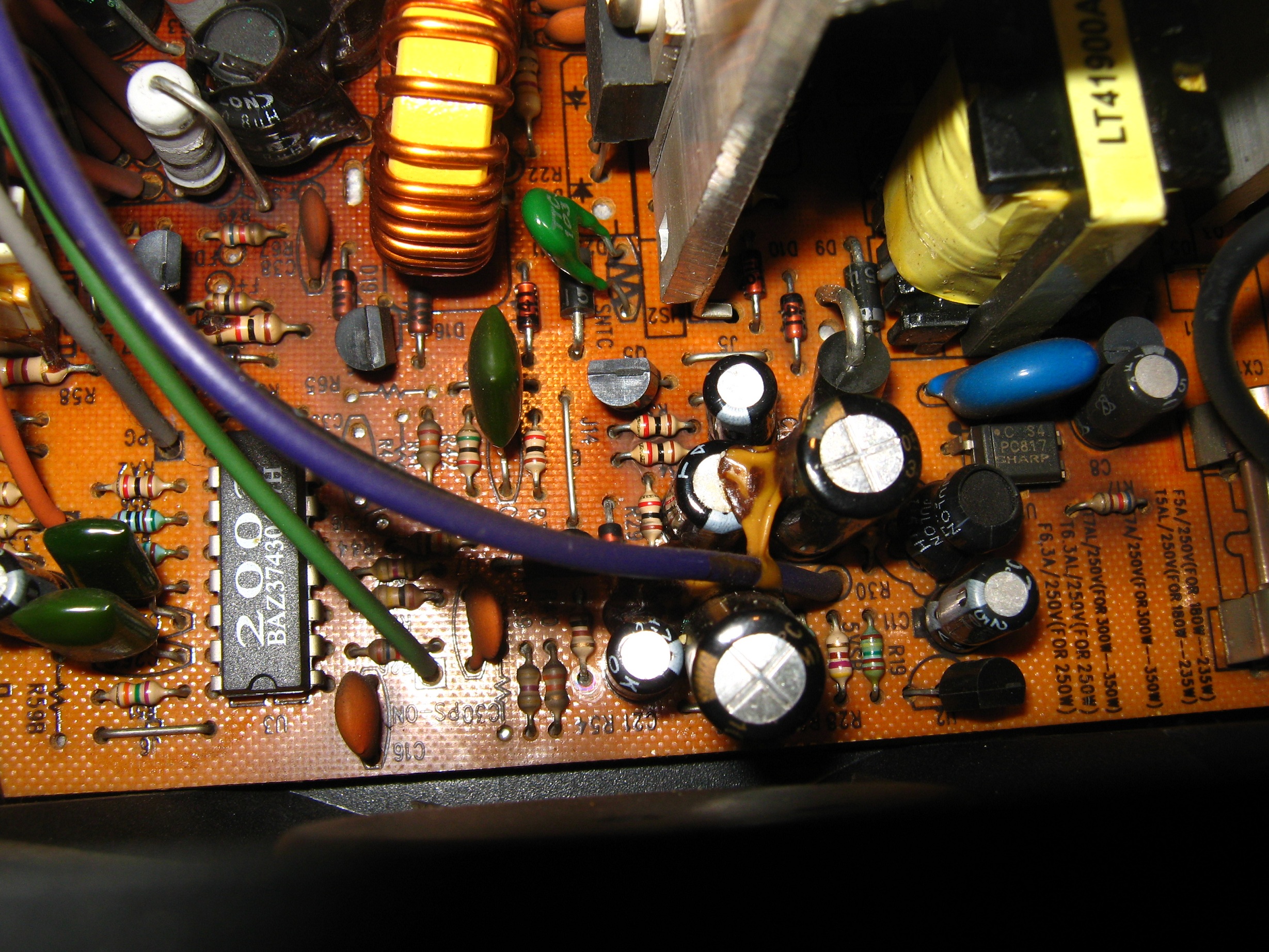

                                  Referring back to my earlier post #412: I finally got around to recapping this FSP unit, however now it does not start up! I think it used to start up before I recapped it. What should I check for - a blown fuse or a short somewhere? Any advice would be appreciated.
                                  • Behemot
                                    • 4845
                                    • CZ
                                    • Computers, reading, dancing…
                                    #577
                                    Re: the gutless, bloated, and fried power supply hall of shame
                                    Short, accidentally reversed cap, bad cap type.

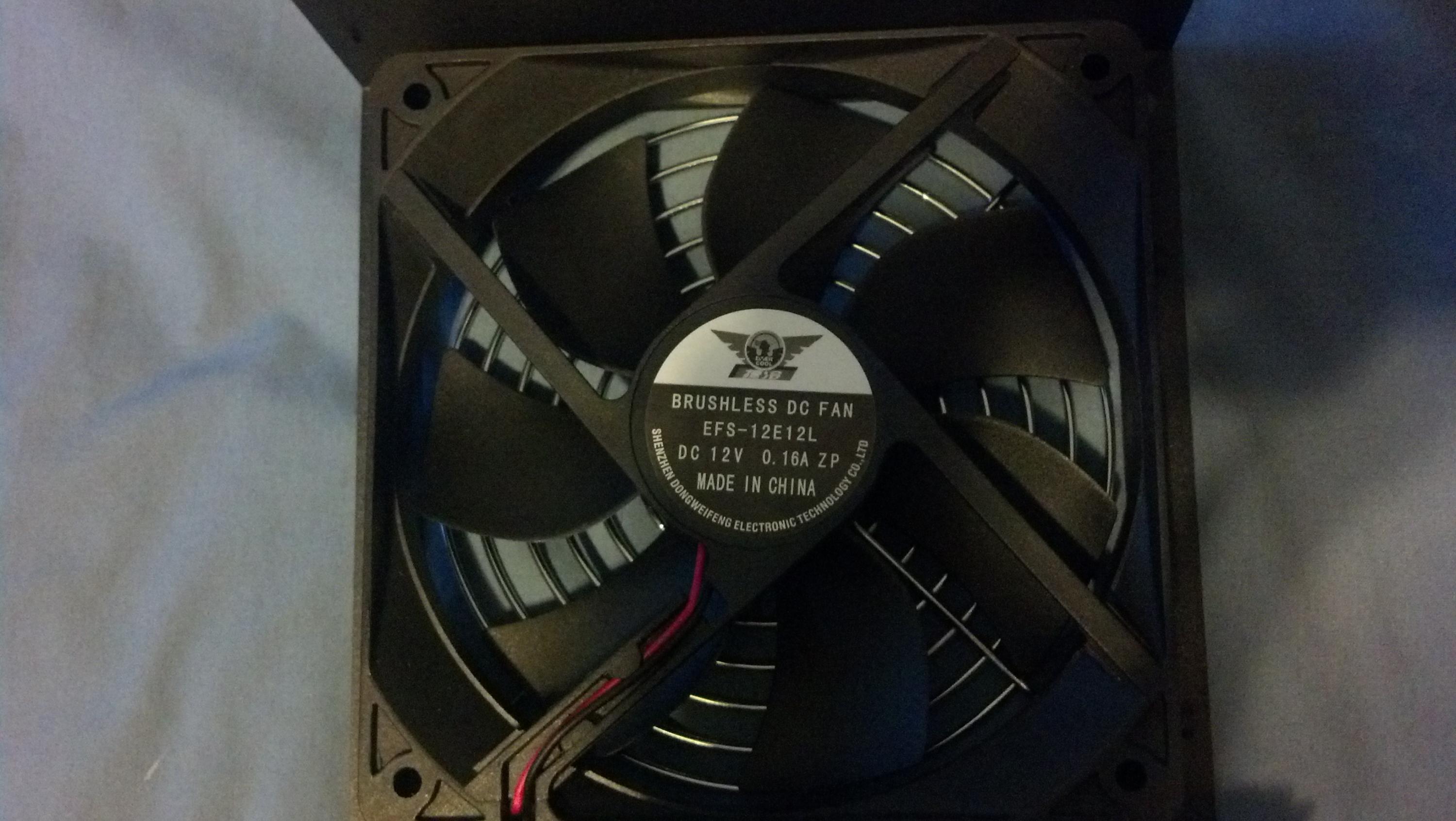

                                      The curiosity got the best of me and when I saw this brand newly listed on Tigerdirect (Manufacturer associated with it was Coast to Coast Fulfillment on the website) I bought the cheapest one ($19.99).....I knew it would suck but I had some money to burn... The label has so many lies on it. APFC? Uh-huh....78% + efficiency? There's no way.... It has a 16A part for each rail, only fast recovery is the 12V....on the other side of the fast recovery there is a slot for another rectifier. The heatsinks are so bad though! This thing would get really hot around 200W I'd imagine. Transformer is maybe size 28.
                                      There are no PI coils for the main rails but there are spots there for them. All the secondary caps are Asia X.
                                      470uF Sun primary caps, no MOV's, 2 X & Y caps (Slots for 2 more Y), one coil (If you look on the box it shows 2 input coils and 2 different X caps through the grille....), four 2A diodes, they're pretty small though. Knock-off 13007's. It has an Ever Cool fan, and the thermal sensor for it is glued onto the larger toroid coil. Wires are 20AWG
                                      Premium supporters get full download access and other benefits.
