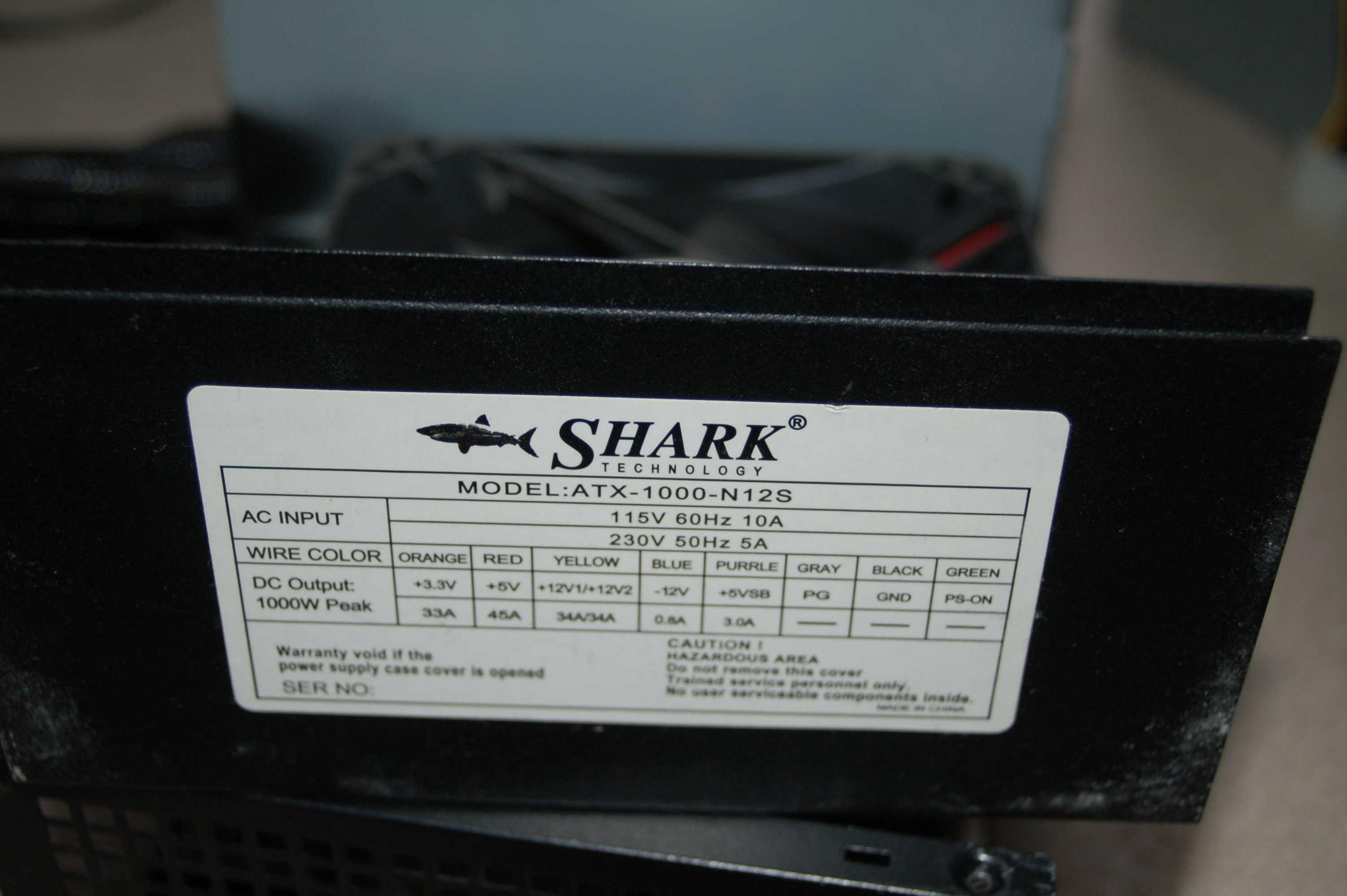

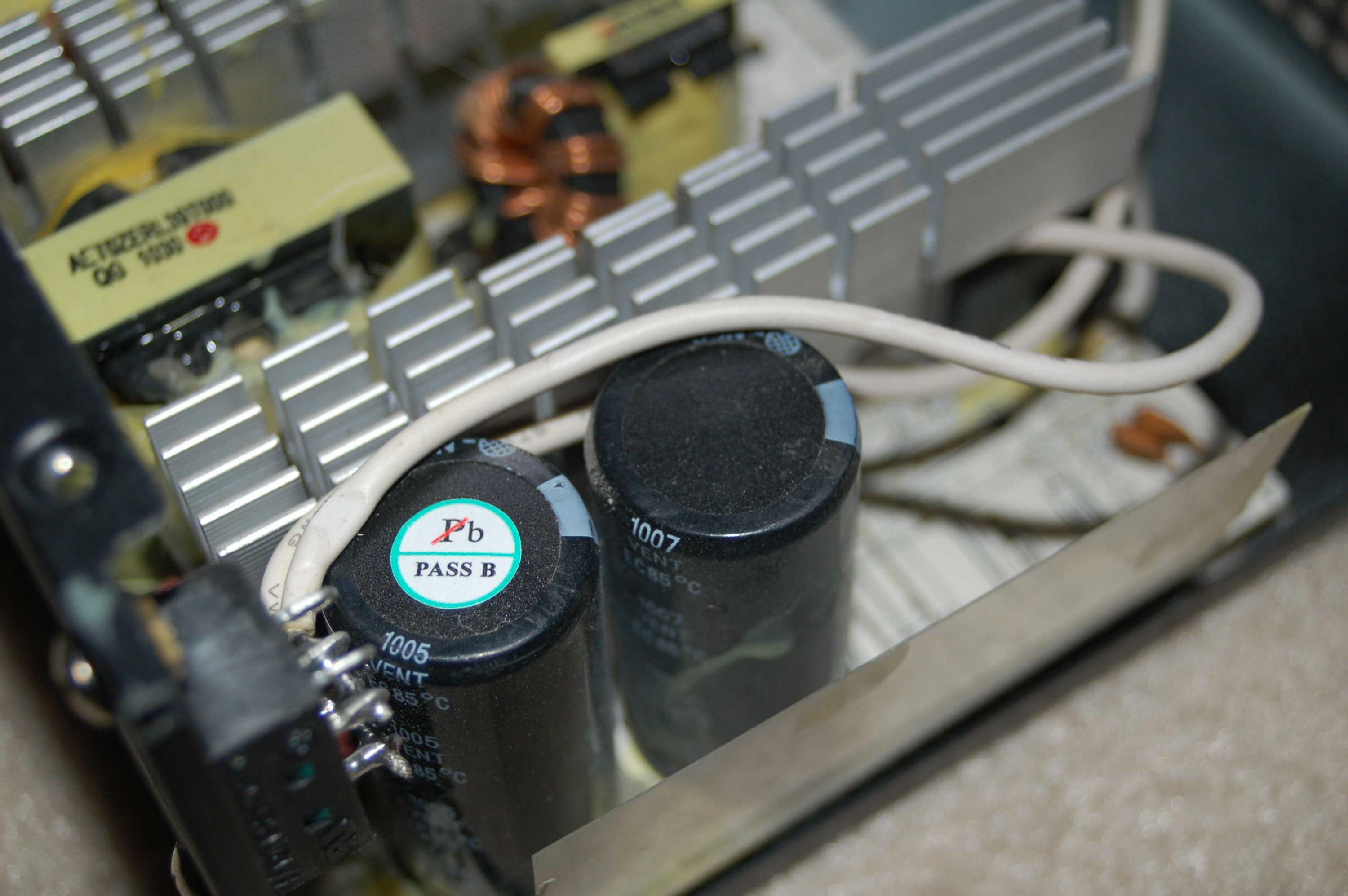

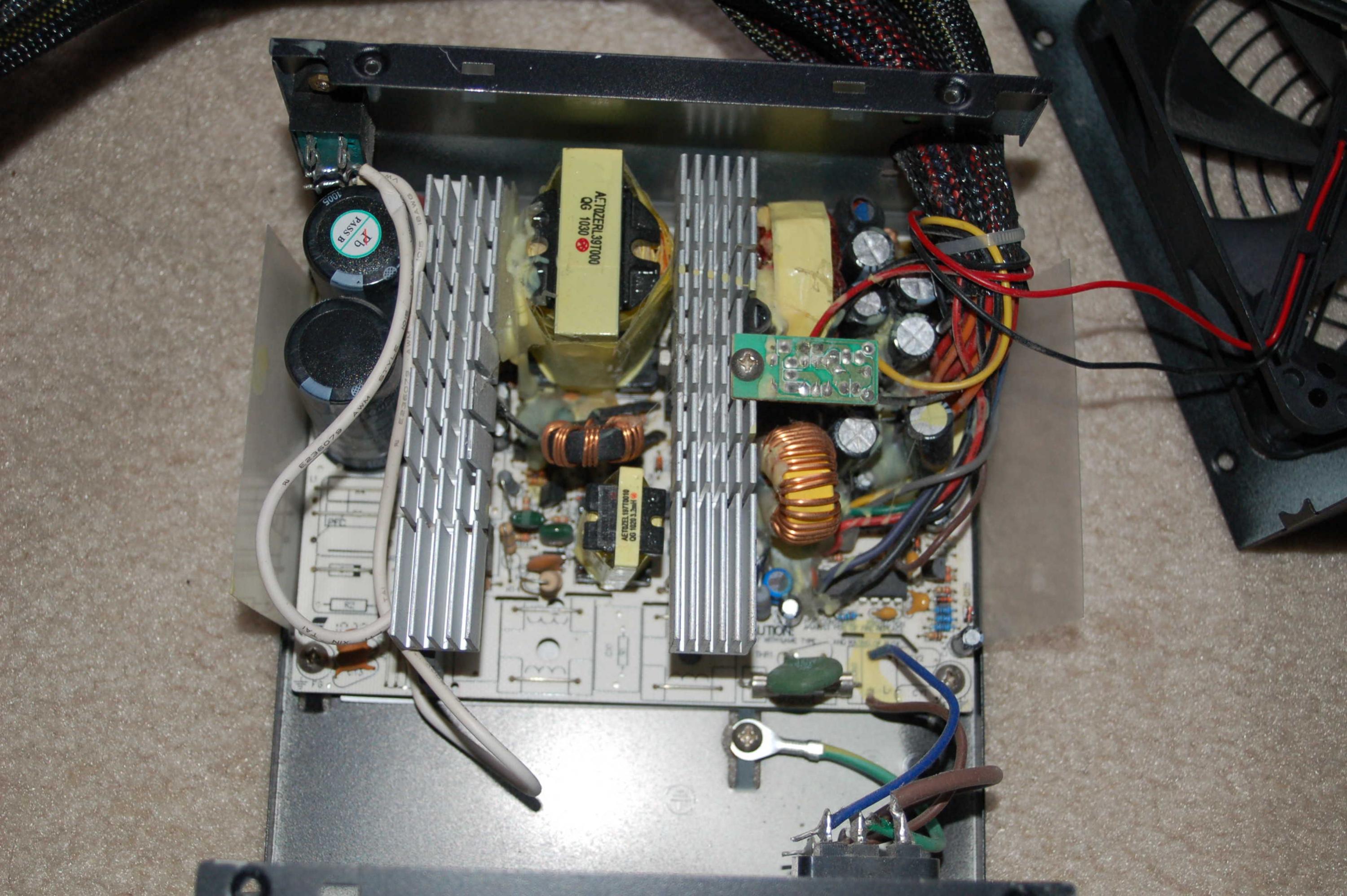

                  It looks like this power supply jumped the shark...
                  Where to begin:
                  It looks like the wires to the 120/240v selector are just wedged between the primary caps and heatsink and the assembler bent the fins to make it work. One wire seemed to have escaped and got crushed flat by the fan. I cant explain why the fins on the other side of the primary heat sink were bent inward. The input filtering is a barren wasteland. The primaries are Fuhjyyu and the secondaries appear to be a sea of Canicons. It probably cant be seen in the pic, but one of the secondary caps has been nicked through the outer sheath. Even the "Pass B" sticker looks off ... I think its an attempt at the RoHS "no lead" type sticker, but to me it looks like its got no "P" but it has "b". Or maybe it didnt Pass "b"?? The transformers appear to have a stamped red Pb with the a more proper line through it. It looks like they didnt bother with an fake UL, CE, or any other logos on the sticker. Heck, they didnt even bother to stamp a serial number into the field they reserved for it!
                  This power supply definitely looks like a good example of overrating in its finest form. Definitely not a 1000W supply.

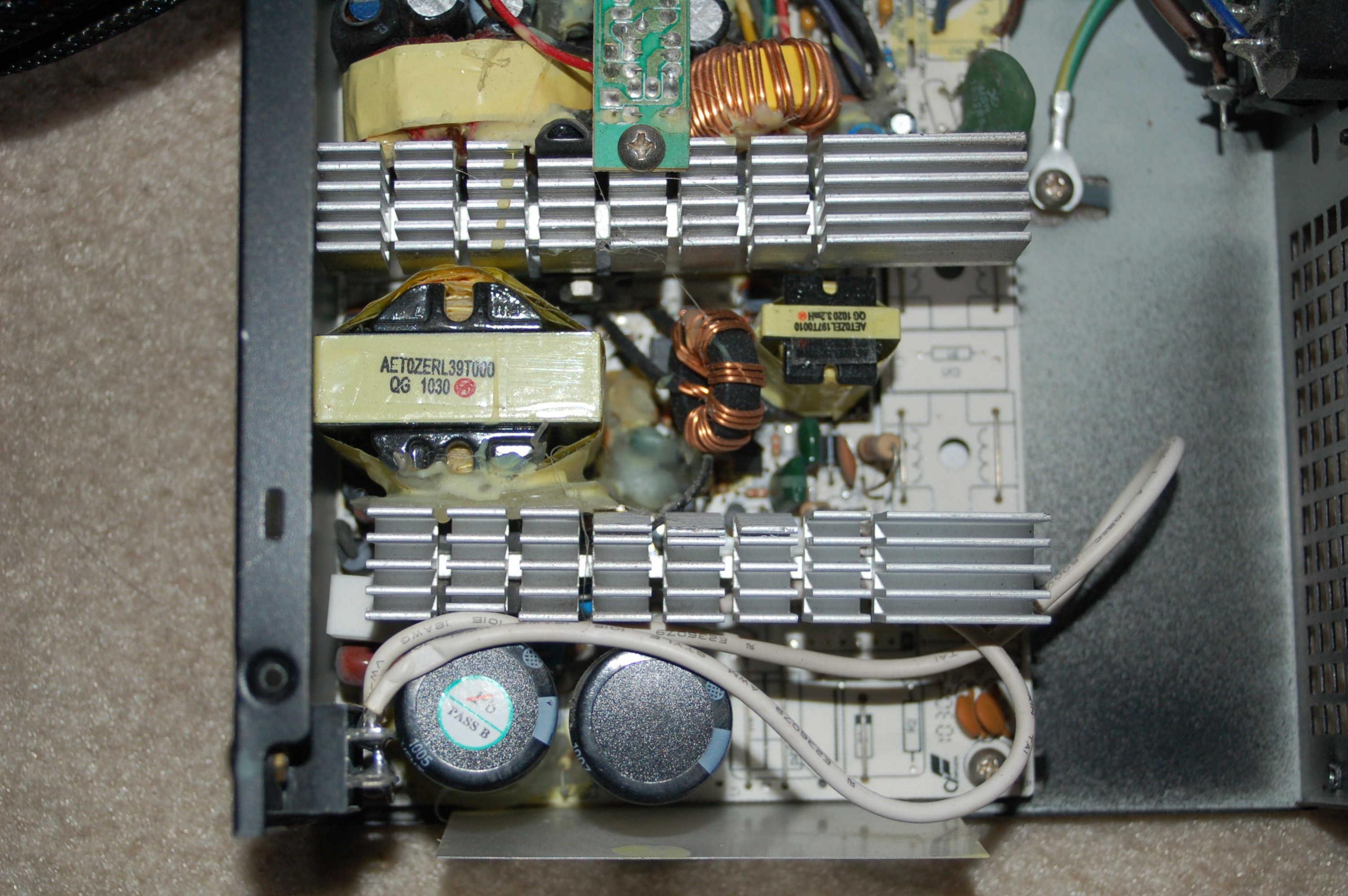

                    #589
                    Re: the gutless, bloated, and fried power supply hall of shame
                    Copy of a now quite old (and quite good) ATNG power supply. Though I think the highest I ever saw that design rated was 600W, and I believe that was one of the Key Mouse copies of that design (it actually did 600W quite well). Key mouse does a bit better copying ATNG looking at this unit.

                      #590
                      Not sure if it's Key Mouse who made it. The transformers in their PSUs are typically marked Ever-power, and they make (or at least rebrand) their own fans.

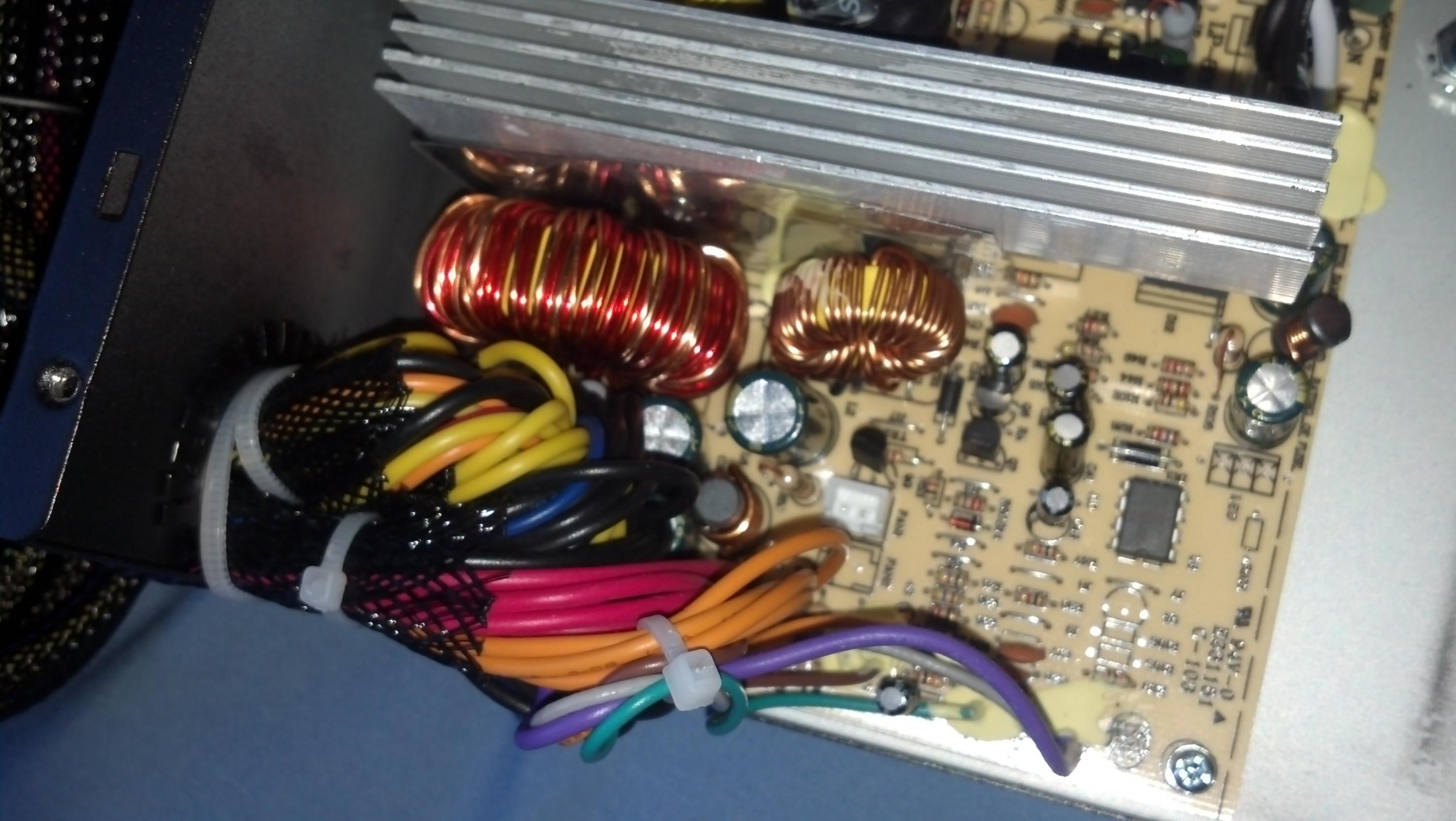

                        #591
                        Obviously not even close to 1000W but that looks like a decent little power supply I think it would be fun to fix it up. Add some input filtering first of all, recap, replace the fan...I like the heatsinks and the transformer

                          #592
                          Yea, may be good for some 400, maybe 500 W?
