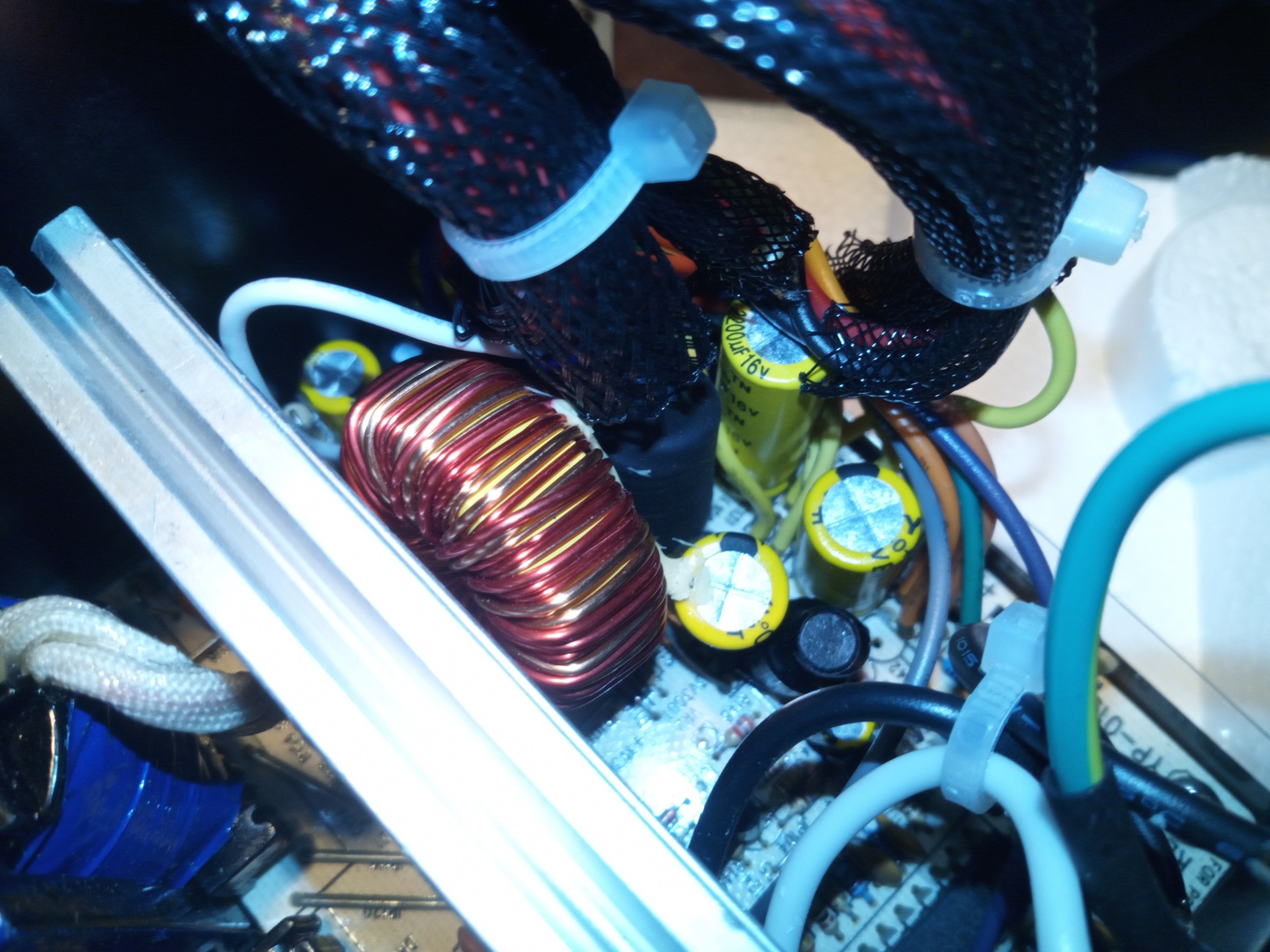

    So i bought an old-stock Apevia X-Qpack. This comes by default with a "420W" power supply. Since i read this review from JonnyGuru, i thought it would be crap:
    http://www.jonnyguru.com/modules.php...=Story&reid=79

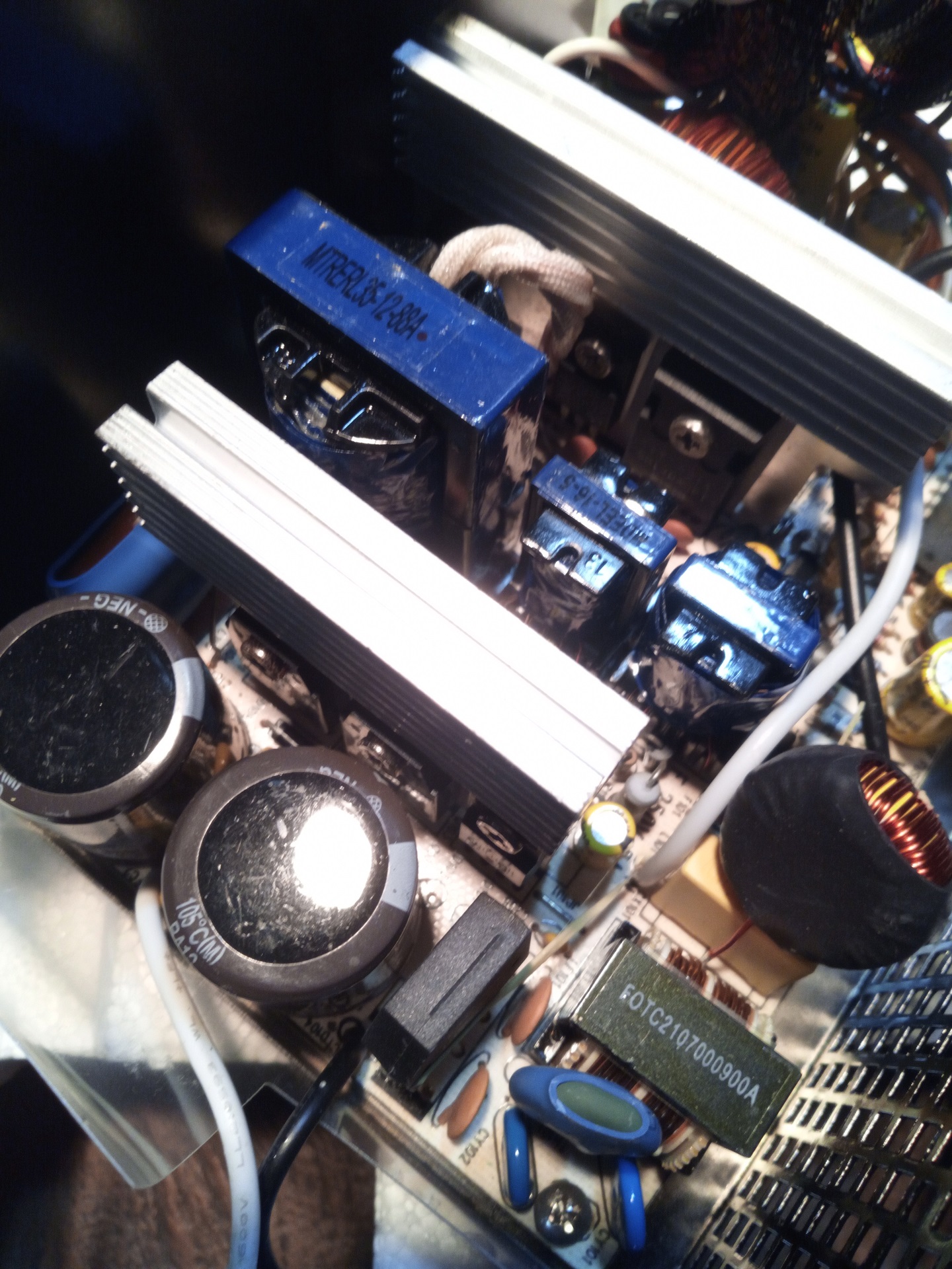

    But i think i've got a newer revision of this psu. Mine got a passive PFC and looks rather complete. I've added some pictures to show it to you guys.
    The primary:
    - a pretty much complete input filtering stage
    - Real 250W Passive PFC coil with an added capacitor
    - 2x 2SC2625
    - KBL406 bridge rectifier
    - 2x 470uF primary caps
    The secondary:
    12V: SFR20100 Schottky 20A rectifier, pi coil
    5V: SBL3040 Schottky 30A rectifier, pi coil
    3.3V: SFR20100 Schottky 20A rectifier, pi coil
    The secondary caps are really crammed together so i still have to take a good look at them to know which one is for which rail. All caps are Fuhhyu ones. The PCB says this is a YoungYear unit. It also is 230V AC only and it seems that if even has a temperature controlled fan.
    Now, when i look at the power supply and the components it uses, i really think that the unit JonnyGuru reviewed maybe had a 10A rectifier for the 12V rail?
    If i recap the secondary output stage, will i have a reasonable 250W PSU that can deliver about 200W on the 12V rail?

      I just replaced the 12V rectifier for a MBR4045PT and it works just fine with it. I hope this will give it some more leeway on the 12V rail. It does look quite good, 2 of those big packages on the secondary heatsink. I actually found a production date on the pcb, it says february 2006.
      I will wait for you guys to see what you think this power supply can do on the 12V line, if it is good enough i will recap it with some panny's.

          This is a half bridge unit so a diode package rated 45v reverse voltage should not be used on the 12v rail, I mean you can do it but if the reverse voltage peaks at more than 45v you are going to see some magic smoke

            Not uncommon for 45V rectifiers to blow on the 12V rail, unless the 12V rail transformer windings are center-tapped to the 5V rectified output (done on some newer H-bridge PSU designs to improve 5V-12V rail loading, but it decreases efficiency).
            Looks like the answer is Yes.
            I have a similar YY PSU (Aspire / Apevia ATX-AS520W) based on the same platform. But I haven't finished recapping it due to other projects, and as such I haven't been able to load test it with a more powerful rig to see how it does.
            That said, your PSU did have a 20 Amp stock rectifier on the 12V rail, so the 12V rail should be able to reach 200 Watts in theory. The primary side also has TO-3P devices, so that too should allow the PSU to do at least 200 Watts (for TO-3P parts, you're probably looking at 300-350 Watts limit on the primary side... maybe 400W with a really good design).
            Anyways, if you do recap the PSU, make sure to also do the 5VSB output, as well as all of the small electrolytic capacitors.

                The power supply luckily doesn't have that many small caps so i will do a full recap. It is going to power the following system:

                That shouldn't be too power hungry. Thanks for noticing that the rectifier isn't rated at a high enough voltage, i will swap that one today. The power supply had a test load on it for about an hour and it dit just fine. 12.6V on the 12V rail, so i was lucky that the magic smoke didn't escape yet. Thanks for all the feedback and i will keep you guys posted about the performance of this unit.

                            So i just replaced all the caps for the output rails and 5vsb with nice Panasonic caps. I also upgraded the 2200uF caps on the 3.3V and 5V rail to 2700uF. There unfortunately wasn't any room for a larger 12V cap, so that one still is a 3300uF part.
                            I also ordered a new rectifier for the 12V rail. A DSSK 40-008B 2x20A (40A total) rectifier which is rated at 80V. The forward voltage is also lower than the original part and it has the bigger package. So that should help with the temperature of the rectifier.

                              yes that should help, i think 80v might be high enough so you will probably be fine.
                              there is only one cap on 12v?

                                Yeah, only one cap and a pi coil.

                                    Well, the rectifier took 1 month to arrive. I replaced the rectifier and powered on the PC. It works great, there is only one minor problem. All the voltage rails are reading a bit high. Especially the 3.3V.
                                    12V: 12.6V real
                                    5V: 5.2V real
                                    3.3V: 3.5V real (all measured with a Fluke mm, and motherboard bios agrees)
                                    I don't think it will cause any problem, i will keep an eye at the voltages. I really don't want to take this whole thing apart for the third time...

                                        Actually not, 3.465 is the maximum allowed by ATX specs.
                                        12.6 is the maximum allowed so as long as it doesn't go beyond that it should be fine.
                                        I would still recommend not using that PSU, but that's up to you, you could see if the cx430m board fits in the case of the apevia.
                                        Remember to check all the voltages when the PC is at idle and full load (prime95 and furmark)
