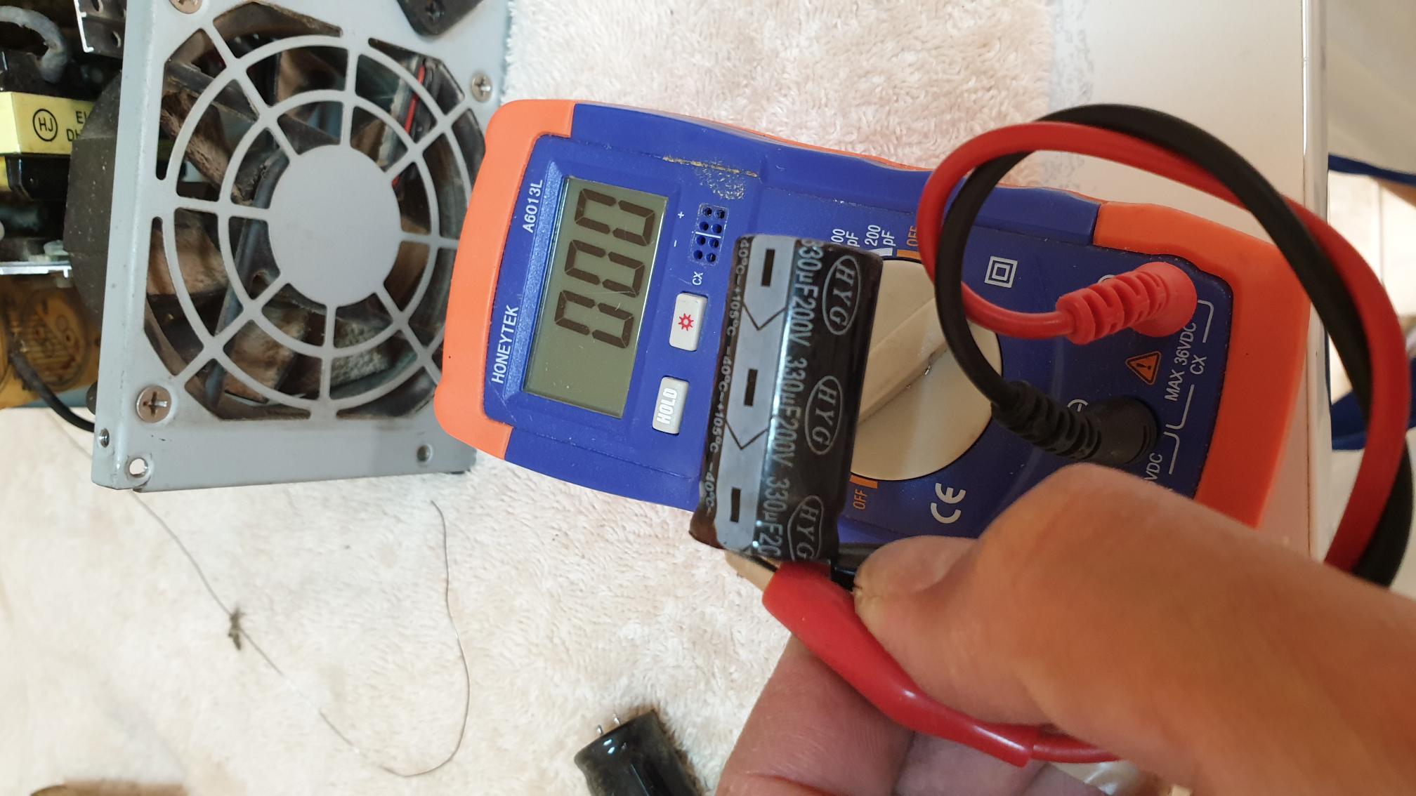

    My friend has an old PC with quadcore intel and was working fine and being used by his son for online schooling.
    Yesterday, it suddenly failed without warning, no power at all even manually shorting from the 24pins (green and black).
    I checked and opened the PSU because there was no output at all. Surprised the fuse was still intact after tested it. Tested the primary diodes and all are good.
    It has very similar lay-out of the PCB for this generic and cheap PSU and even using similar rectifier diodes and arrangement of other electronic parts.
    I already confirmed the cheap PSU is the culprit because i tried another PSU and the PC works fine.
    What could be the problem if fuse is still intact? Does it mean the primary winding is good and i should concentrate more on secondary? I want to learn how to fix this PSU and not because it is cheaply made but because i am seeking further knowledge.
    I will try to open it up again tonight and see if i can find something on the board

          You can actually see the problem in that picture: you have bad caps (or at least one on the left side, close to the yellow and orange wires.) Chances are, the other ones are bad too. Full recap will likely get the PSU going... but really not worth it on a unit like this. If you have some other junk broken electronics you can scavenge capacitors (and other parts from), or a local shop that sells cheap Chinese crap caps for cheap, that should work too, just to test out your repair knowledge.
          And if you do fix the PSU... DON'T connect it to a computer anymore. It's a really low-end unit with high ripple/noise output and will probably damage parts over time. You can use it to power LEDs, motors, and other non-sensitive items on your workbench, though.
          Lastly: that PSU looks like a Deer/Allied/L&C unit, so it can actually be turned into something... less garbage. But you will need to fill in a lot of the missing parts (output PI coils, input common-mode chokes, input X2-caps, input Y2-caps) and upgrade the cheap parts in there (2x 2200 uF caps for each output rail, 2x 470 uF 200V input caps minimum, and etc.)

            Thanks for the valuable inputs, and for safety. I am just trying to learn the basic of fixing psu's. This photo is for reference only and not the actual photo of the PSU i am trying to repair. The actual psu has been reliably working for more than 10 years and suddenly gave up. Impressive!!! yeah given it is cheaply made.
            On the other hand, I have confirmed that the 2 main caps 330uF/200V are faulty. Initially i only get 120V from the primary and supposed to have 220-240V. This prompted me to check the main caps. One has 0 uF and the other 275uF so way beyond the spec. I will try to replace them and see what happens. I have checked all diodes by removing them and also all major resistors/ small caps by removing them individually and all are good except a few that need new ones.
            If this thing works then i learn something.

                Yes, already checked them all before and all are good. Yesterday I replaced the 2 main caps with Rubycon 330uF 250V ( was expensive and i am not expecting the cost from local parts store) and also 1 transistor due to open caps as you mentioned. And now it was working, couldnt believe it.
                I wouldnt mind as long as i learn.

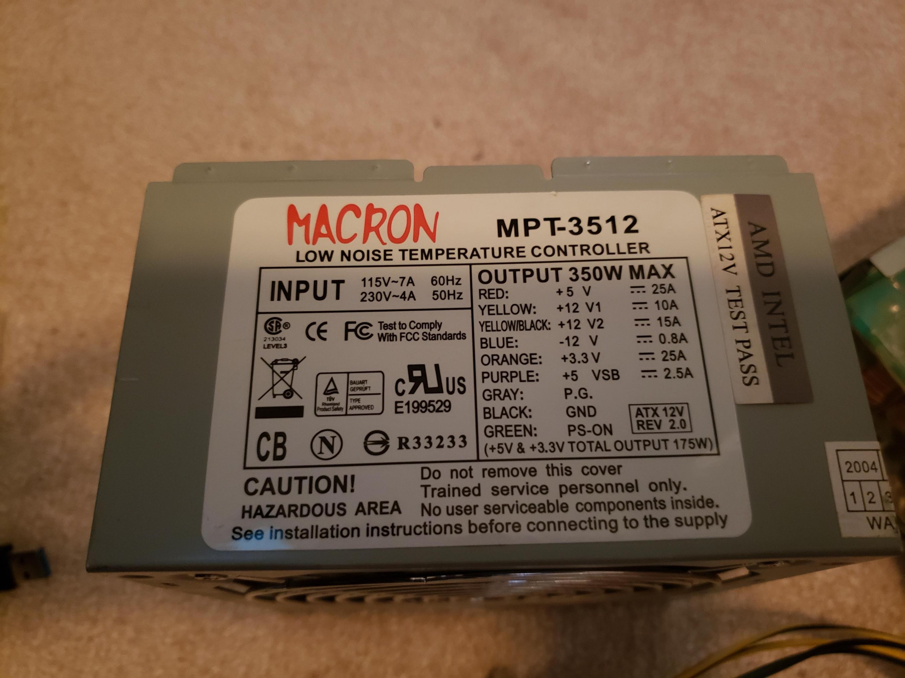

                  I can't believe it but this power supply completely fried!!
                  https://www.badcaps.net/forum/showpo...postcount=1618
                  The main output toroid core turned white and the wire is pitch black. It even fried a 12.5mm Chemicon KY and a Samxon RS!
                  Above the Ky cap:
                  Here's the story: It was made in August 2005, recapped in October 2013 and immediately installed afterwards. It ran 24/7 and was powering the following:
                  Pentium 4 641 (3.40GHz, D0 version = 65W TDP), which had the 15A rated 12V rail all to itself

                  It ran with this setup for about 60,000 hours before it failed. When you attempted to turn it on, you'd get a twitch on the PSU fan and about 3 seconds of spinning on the CPU fan.
                  It was used to stream football/TV so the P4 was pushed pretty hard. It was online, so super inefficient on the CPU compared to local x264 files. I believe maybe the toroid just wasn't enough for this PSU? The silicon was very strong for the ratings.
                  Label:
                  Silicon:
                  5V: Two 30A TO-247 schottky
                  12V1 (Non CPU): Two 10A ultra fast
                  12V2 (CPU): Two 20A schottky
                  3.3V: 40A TO-247 schottky
                  What do you think happened? I have a hard time believing that the load killed it, especially with a Cedar Mill P4 and super low power GPU. What I did also notice was a partially stripped wire on an extra cable touching the chassis. I imagine that this would have just tripped the protection and shut it down, not fry it?? What are your thoughts? This is very sad because this was a nice PSU and I don't really have the extra time to find a toroid for it.

                    These types of failures are always caused by overheating.
                    I have only seen it when the fan or fan controller failed...

                      WOW!
                      That's a really surprising failure, for sure.
                      I agree, I don't think the load should have killed it. Cedar Mills are still Pentium 4 CPUs, but relatively more tame in terms of TDP. If yours is indeed the 65W TDP version and not the 86W version (specs of the two can be found here), then that CPU peaks at almost 80W on absolute max power (generally synthetic benchmarks only.) With a heavy online load, it's probably using somewhere around its rated TDP or maybe a little more... so let's say 70-75W.
                      Looking at the pictures of the PSU again, I see the output toroid has a yellow core, suggesting Micrometals -26 type core, which is good for up to 50 KHz designs and also slightly less efficient compared to the green core with blue paint on one side (Micrometals -52.) What I also see is that your output toroid is about as tall as the UCC KY 16V, 3300 uF cap, and that's a 35 mm tall cap (the UCC KY is sitting flush to the PCB, I presume, whereas the output toroid isn't... hence why it looks a little taller, but it probably isn't.) This leads me to believe the output toroid is a T130-26 part... which should indeed be perfectly capable for the 350 Watt rating on the label. In fact, T130-26 could handle designs up to 450-500 Watts... maybe even 550 Watts. It's a pretty chunky core after all.
                      That said, I don't think I can quite identify what the issue is here. Seems like multiple things. It could be...
                      1) The output toroid's core overheated due to inadequate ventilation / airflow from the fan or the fan controller, as Per suggested. More precisely, I can see the following possible scenarios:
                      -- 1a) Thermistor is improperly placed to keep the PSU cool under high load. I notice from this picture that the thermistor for the fan controller is connected to the heatsink, but very far away from the components that generate the heat - i.e. the 12V rail rectifiers and the output toroid itself.
                      -- 1b) Fan controller is not designed properly - i.e. it doesn't ramp up the fan speed enough for the heat from the PSU.
                      -- 1c) The output toroid could be in a "hot spot", given that this PSU uses an overhead 120 mm fan and the secondary heatsink covers the output toroid almost completely. (On that note, this is one reason I tend to still prefer the old PSU designs with cross-airflow from an 80 mm exhaust fan and airy front vents.)
                      In regards to all of the above for item 1), I think 1a) and 1b) can be ruled out if you ever checked how the PSU ran under load in a PC - i.e. was the whole case of the PSU hot? If not, then that leaves 1c) as the more probable cause here.
                      2) There was a flaw with the output toroid. Things such as micro-cracks in the core material or marginal insulation on the windings, can show up as a latent failure. In the case of micro-cracks, the core/inductor will work at first, but excessive heat may form around the area with the micro-cracks. Over time, the micro-cracks can grow (due to heating in those parts), causing more heat and inefficiency, and thus total failure from overheating at some point. In the case of windings with marginal insulation - regular vibration from components inside the computer (fans, HDDs, optical drives, and etc.) as well as one-time "step" vibrations (walking in the room where the PC is, bumping the PC by accident, and etc.) could have caused a short-circuit to develop somewhere... and it only takes one shorted turn. Case in point: the Corsair CX750M I posted in this thread:

                      3) Maybe either the UCC KY or the Samxon RS had a random failure? I find this to be highly unlikely, but not impossible after all. With a failed cap on the output, the output toroid will have nowhere to "dump" its energy, and that can also cause it to overheat.
                      4) Bad output filter design. I also find this to be highly unlikely... but again not impossible. What I mean by "bad output filter design" is that perhaps the capacity of the output caps was underestimated in the design, thus leading to higher spike currents in the output core. Or perhaps the output toroid didn't have enough turns on its core? Looking at the pictures, I see a lot of space between the wire in the windings, so that could be it too. Low # of turns = low inductance = high spike currents... which may or may not have detrimental effects both to the toroid's core and the output caps... and especially adding fuel to the fire for item 3) above, if any one of the output caps was indeed marginal for any reason. That said, perhaps it may be of interest to look at the two BFG Tech. BFGR550WGSPSU PSUs I posted about awhile back here:

                        The PWS is 16 or 17 years old, including that fried output inductor. Plus or minus a failed fan or fan control circuit, my guess is that the powdered iron core was pretty hot. Somewhere around 110C, many powdered iron cores start deteriorating, gradually losing their magnetic properties. Taking my guess farther, I think that happened to that core, frying the varnish on the wire and the output capacitors which saw much increased ripple current.
                        If you try rebuilding that output inductor, I suggest using -52 material, which is the same permeability and, IIRC, lower loss, even at a “low” switching frequency (e.g. 30 KHz).

                          I think you're right with 1c. Here's some more info: my parents live very north where it's cold so they're usually running a stove fireplace. It's probably 15 feet away but it would still regularly get up to 27C ambient temperature for hours. Another thing they did is they would push the computer as close to the wall as possible (with the exhaust pointed at the wall ) to the point where you could feel it getting very hot. I wasn't checking on it often and did turn it sideways but it could have been like that for months if not a year. Then add the age, high CPU usage and the heatsink blocking the airflow, it makes sense.
                          I might take you up on your offer to rewind it! If I don't end up sending it to you. I have plenty of power supplies but I appreciate your offer
