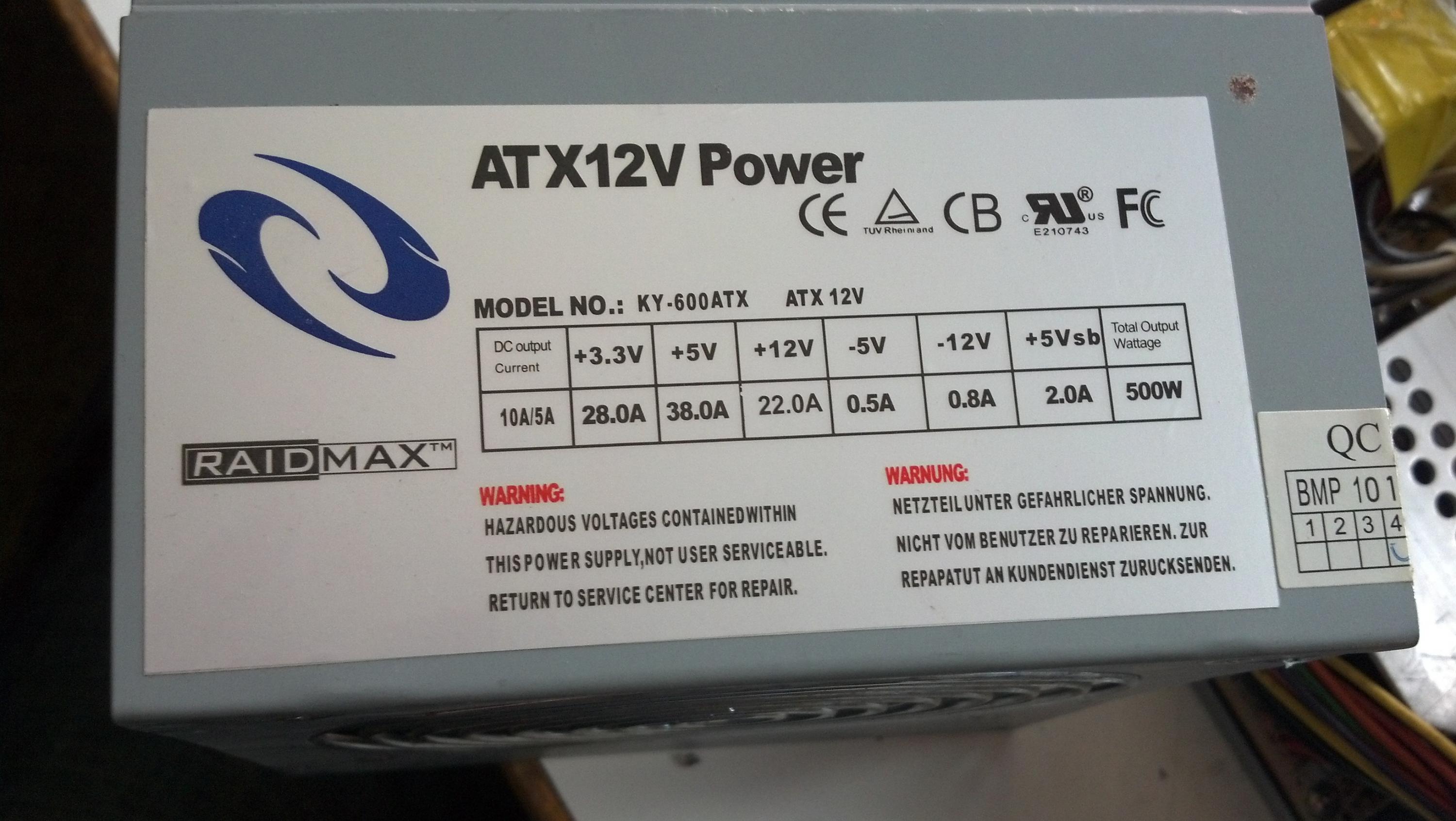

    That's quite normal on those FSP units. There are being various "flying resistor" mods used to get them away from capacitors to stop heating them.

      Re: the gutless, bloated, and fried power supply hall of shame
      Better than most Sun Pros...At least it has an input filter and PPFC (but no voltage selector) Caps are a mix of Metacon, JEE, Gold Link, and Tongjia. All the filtering caps on the 3.3V/5V/12V and 5VSB are bulged... 13009 switchers, 30A for 3.3V, 16A for 12V, 30A for 5V. My buddy had this thing powering an AMD Phenom and a GTS 250 for a few years, no wonder all the caps died. Surprised the whole thing didn't die but he must not have been doing much gaming. BTW the fan was like that when I cracked it open, completely dry in there! Anyone know what that weird wire next to the bridge rectifier is?
        Looks like a fuse holder, though I don't know why it would have one there.

          #544
          Originally posted by dmill89
          Looks like a fuse holder.
          Wired to two pads marked 'sw'. A bodged voltage selector 'switch'?

            #545
            Hmmm, weird. Yes it is a real PFC choke. It's a Sun Pro so had to double check

              #546
              Is it? Though I haven't found this model, most of newer Raidmax PSUs are made by Andyson.

                #547
                ^ It's a Sun Pro for sure. The Te Bao Metallic Plastic fan, Metacon input caps, and the "7700" text on the transformers give it away.

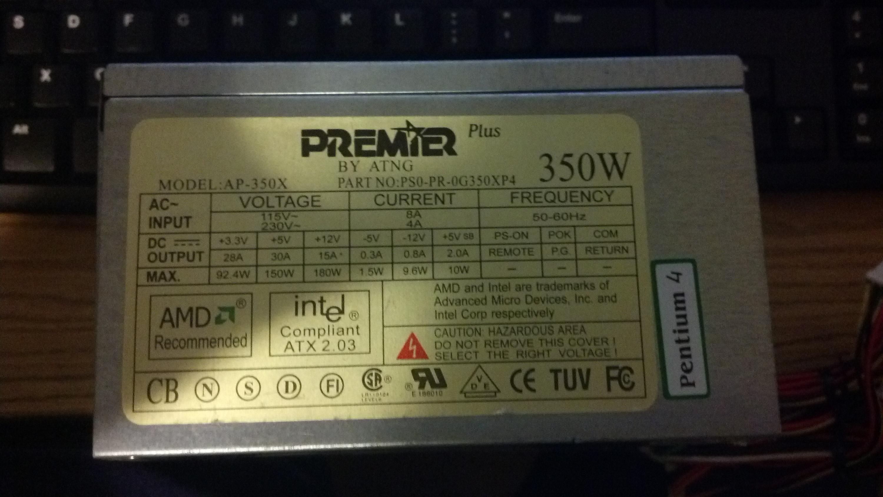

                      This one was made in 2006. Pretty old! I do like the secondary heatsink, plenty big. Think it could handle more than a 20A rectifier for the 12V?

                        #551
                        First one of these I have seen (similar one on JG though), manufactured January, 2003. I think it is upgradable, only thing I'm worried about is if I can upgrade the transformer or not, looks like a 28? I think it would be cool to get this thing up to 300W. It has two Fairchild 13007's (probably need to be upgraded) and a C150 transistor on the primary. 470uF CS caps and a 4A bridge rectifier, it needs some input filtering. The caps on the secondary are Fuhjyyu, JPCE-TUR and CS, each rail has 1 pi coil. 3.3V is 20A (ST), 5V is 30A (ST), 12V is 12A (Mospec) i was planning on replacing the 12V which a 20A part. There is a screw hole already on the secondary so I was going to add a fan controller too. Stock, it has a Globe Fan ball bearing fan.

                          #552
                          It is a 2SC3150 transistor. I think that transformer is tad small.

                            #553
                            The Premier that was in the JG bargain basement roundup was an ATNG. Can't tell if this one is too (though I am about 99% sure), or is a CWT. Their low end units use very similar designs. Also, I haven't been at this in quite a while .

                              #554
                              The transformer is pathetic....and yeah JG's was a 300 I'm pretty sure. And yeah you're right, it says ATNG on the label

                                #555
                                Ha you're right. Also, I just realized I use to have this exact unit. Unfortunately many of them got scrapped (not my decision ) though it may be among the few survivors. Not sure, haven't checked in a while.

                                  #556
                                  What a shame! Think I can get it up to 300W or more? (Assuming I can find a transformer for it)

                                    #557
                                    I wouldn't trust it for more than 250W for an extended period of time.

                                      #558
                                      Neither would I.

                                        #559
                                        250W with the transformer like it is now?

                                          #560
                                          Yes.
