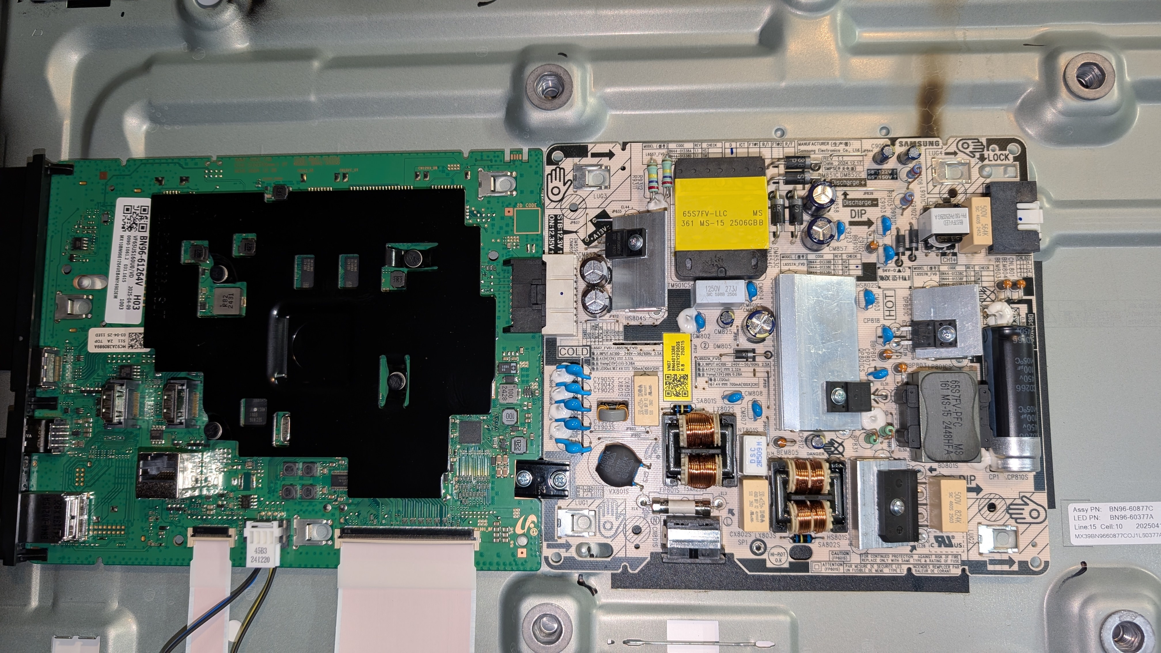

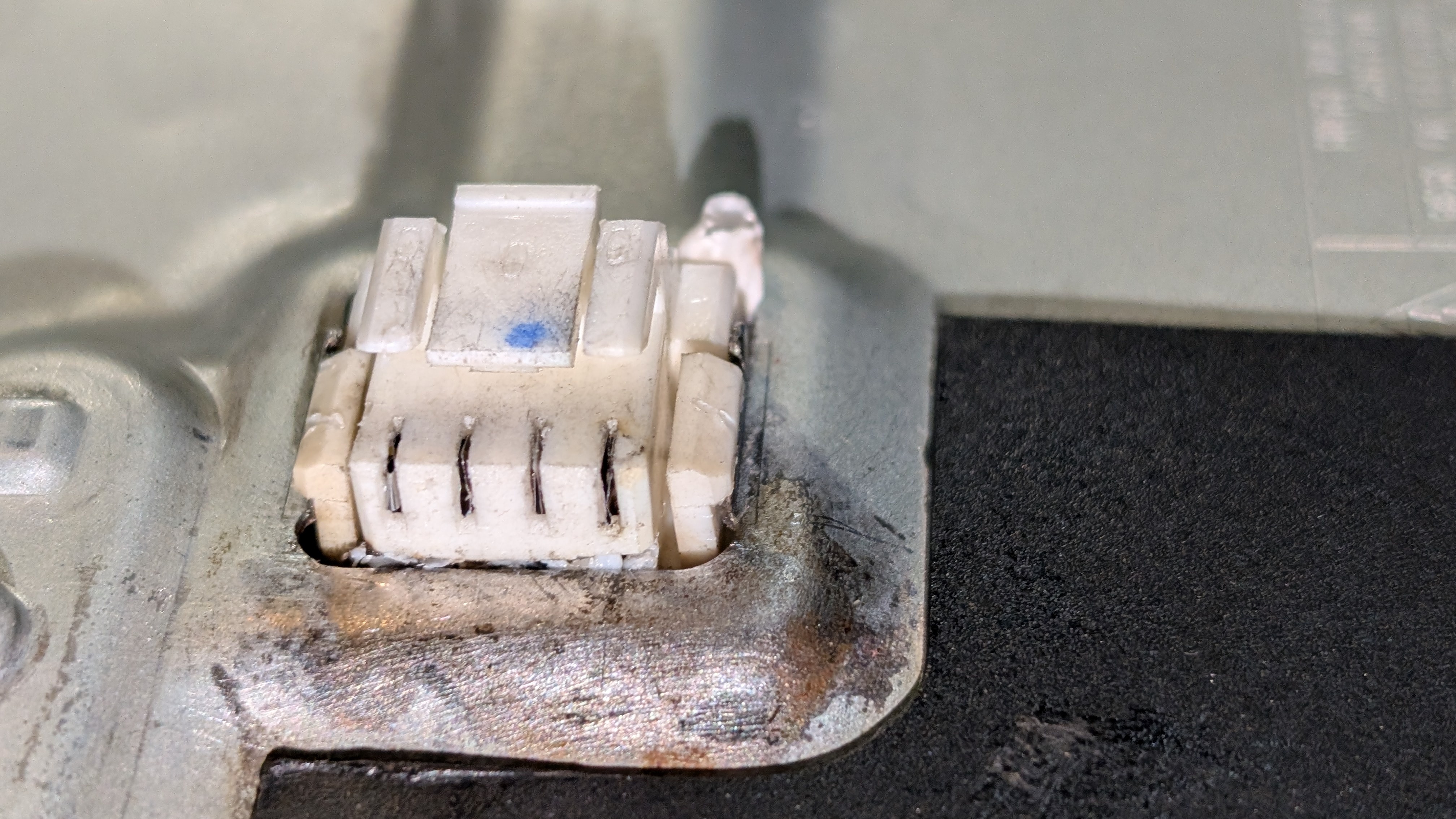

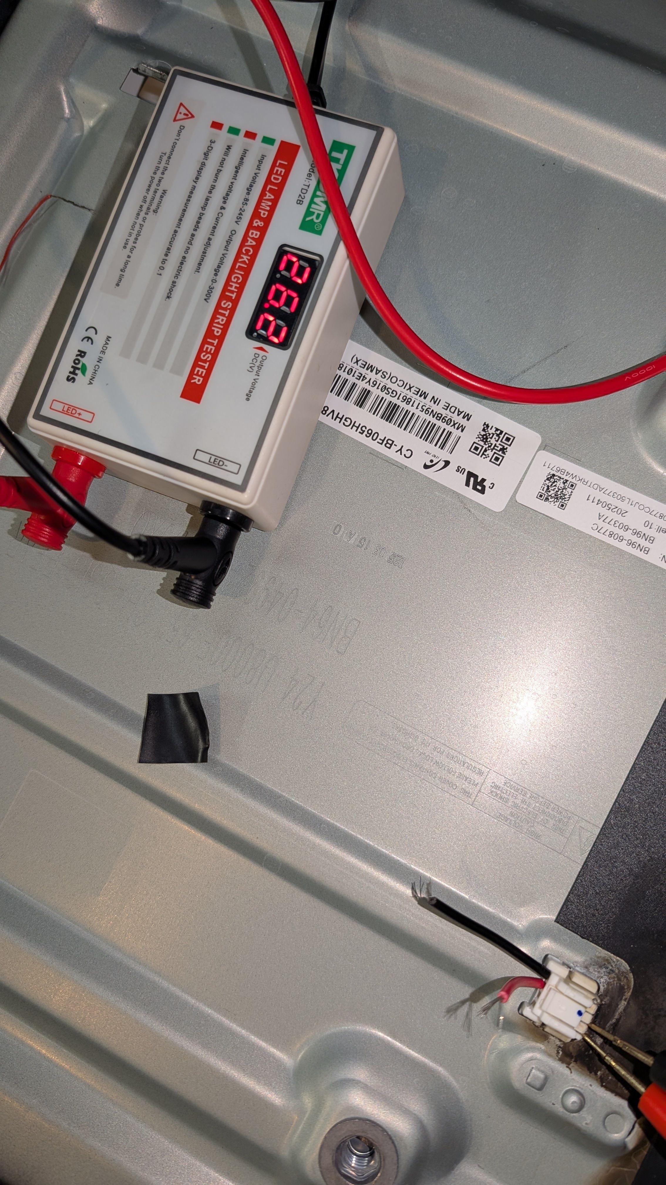

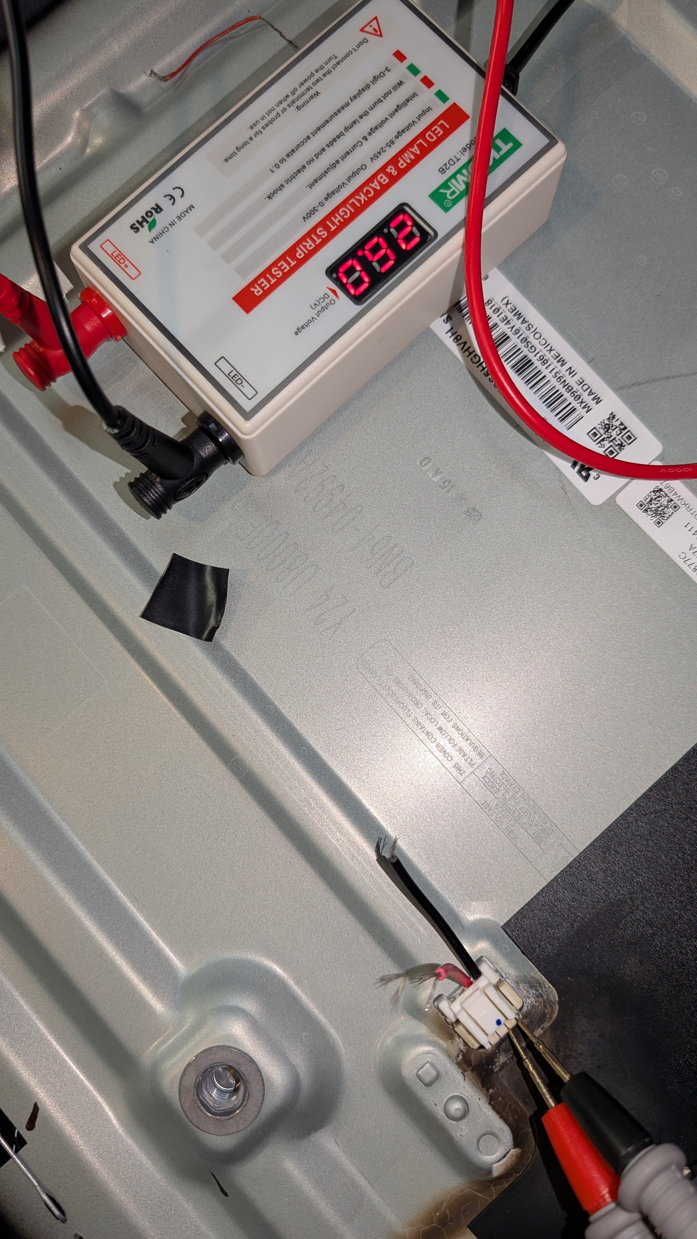

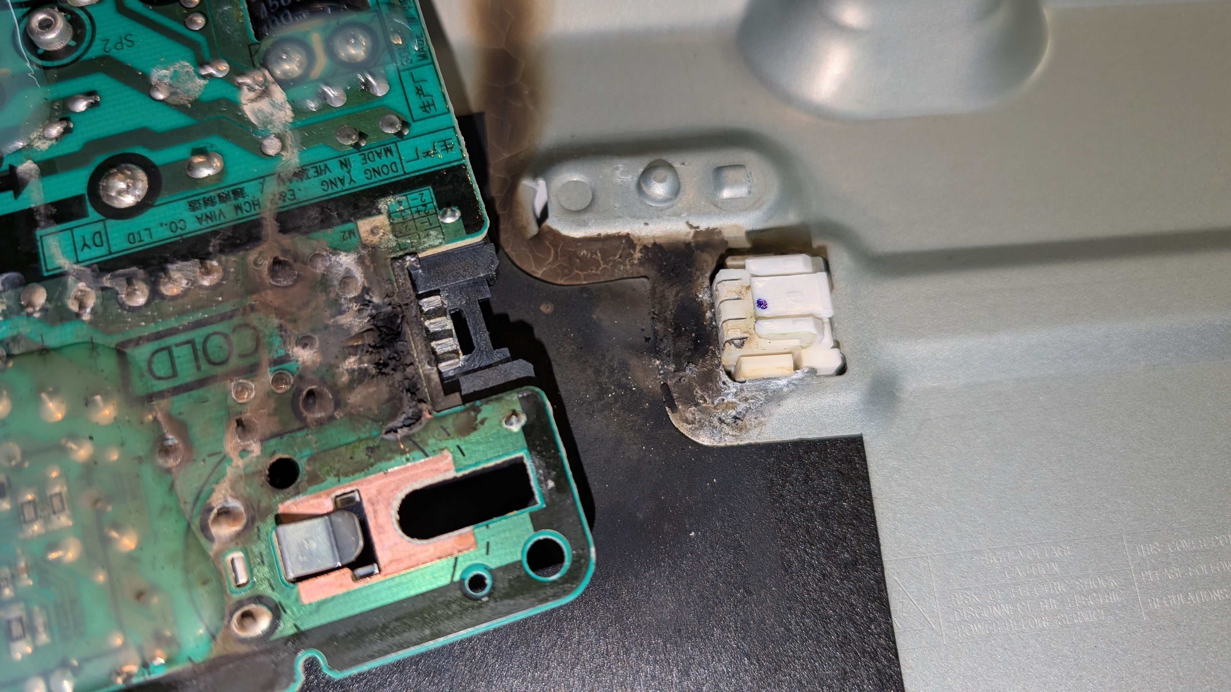

    I was given this tv today. It was purchased just last month and only used for 3 weeks until recently when water leaked down the back and behind the cover. I removed the boards and WHOA 😲 did this thing get fried. Unfortunately the water got directly onto the backlights portion of the PSU. The board appears to be completely unrepairable, but I'm not certain about the backlights. I managed to get the probes of my tester into the slits of the plug and I DO get readings from both strings. I'm getting 26v from both. The PSU says LED Output is 167.4v however. Would this indicate that the backlights got damaged, or is this some sort of partial reading condition or something like that? If it's only the PSU I may purchase a replacement, but if it's backlights too then I'm not going to bother.

    Any suggestions? I'm reluctant to order the boards if these readings indicate bad backlights too..I don't want to replace those simply because this is a bezel less design and last time I replaced backlights in one of those the double sided tape didn't hold right and it was all bad from there.
    Is it possible that 26v is since sort of low power state? I would expect tho that they would be full voltage when connected directly to the tester.

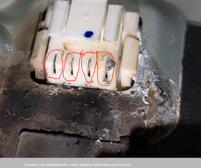

      I would cut out plastic from that connector to get to the pins and then solder a piece of wire on them to test them correctly. Then, if they work, I would use these wires to solder that connector to PSU directly.
        Ya I tried going in through the back of the connector with the probes not they're not long enough, so I tried stuffing don't short wires in there as seen in the pictures but that didn't work either. Are you thinking I'm not getting good enough contact in the slits thus only giving 26v?

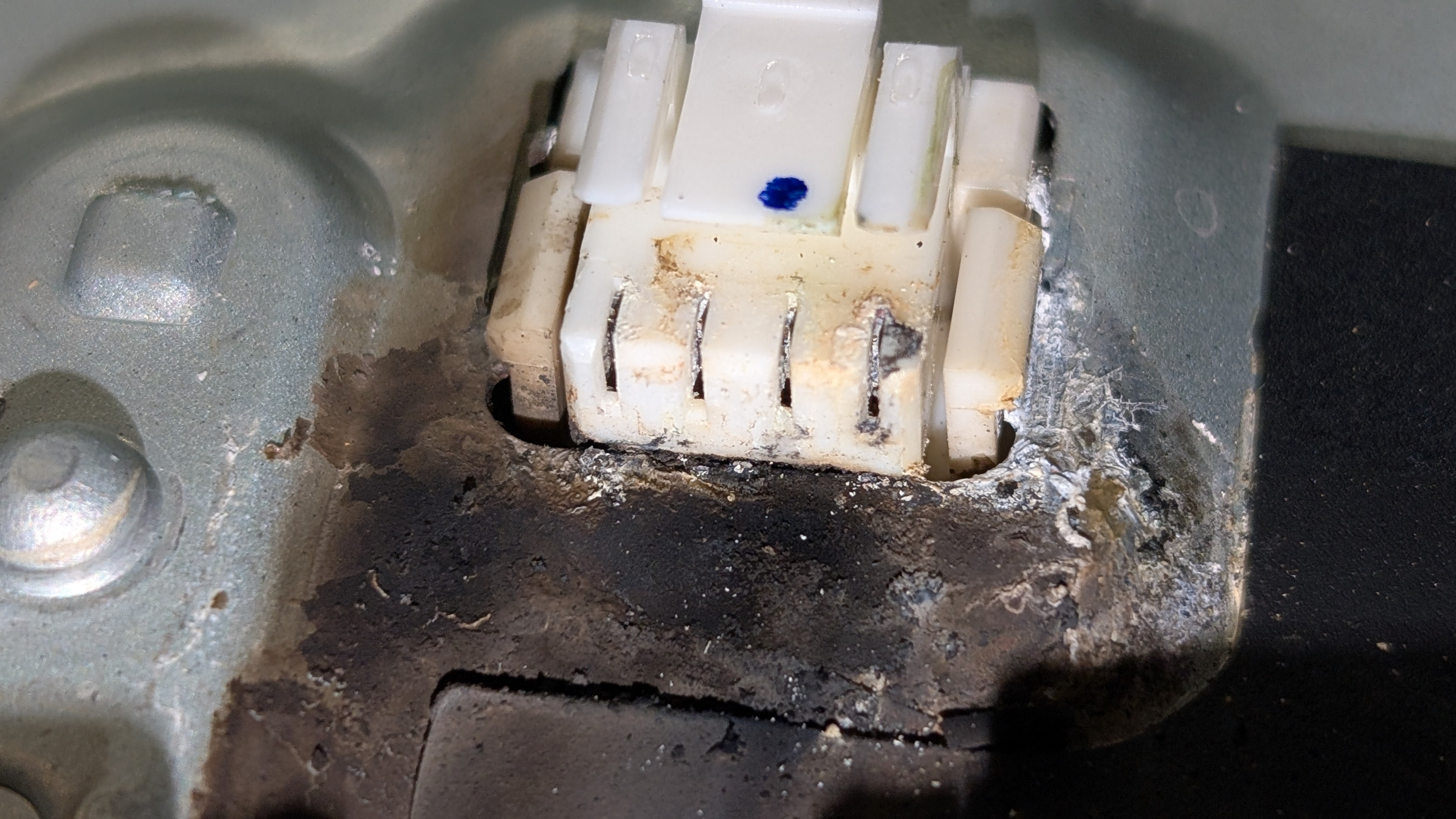

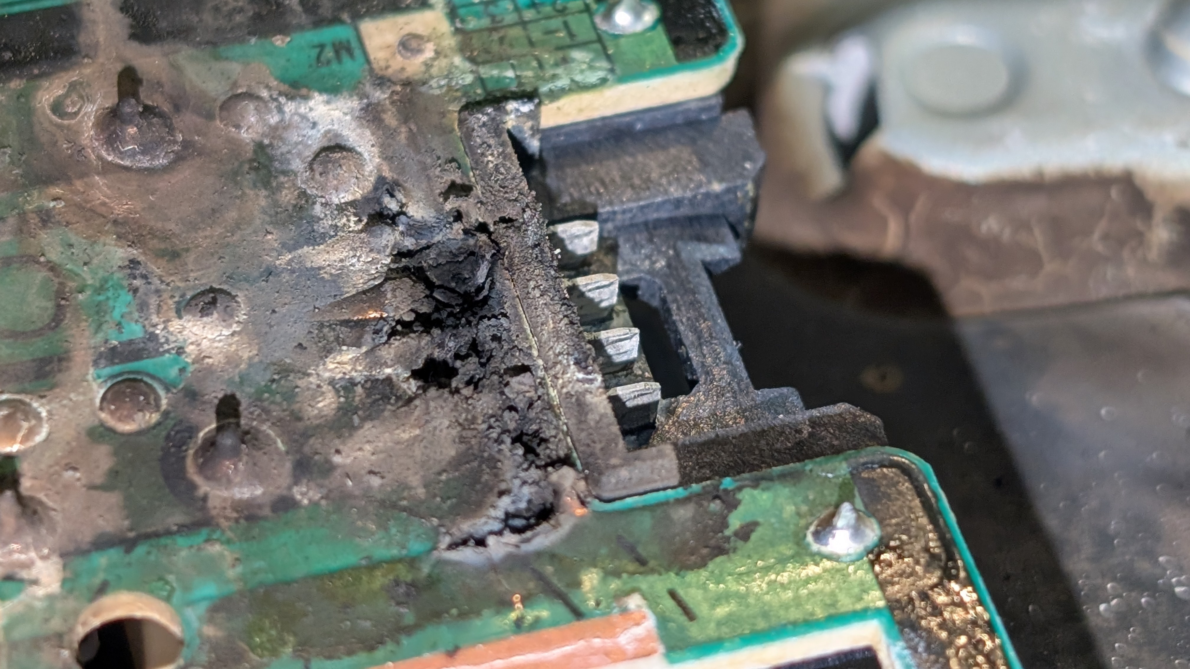

              I'm thinking I'll try to clean up the burnt corner and try to repair the traces to the connector. If I can get it working and get backlights on then I'll go ahead and order the boards. Btw, the fuse didn't blow on this board, so I suppose that means the rest of the components may be okay.

                After cleaning the area with electronics cleaner it looks more manageable than I had thought. I see the ground trace is broken, as well as a trace from the left side of the connector.

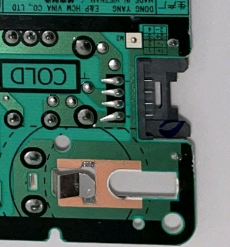

                Edit: so I found a picture of the bottom of the board on an eBay listing. It looks like all that's been severed is the ground that goes across in front of the plug. Would soldering a wire across here be enough, or is this also the ground trace for that connector?

                  Here is the picture of a good board from eBay. I was "not authorized" to add it to the previous post for some reason.

                    The ground is not an issue, but all that black carbon will need to be removed, or it will likely arc with 167vdc, also water may have entered the panel around the connector, hopefully not.
                      As it stands the board does not power on, it produces a clicking noise when plugged in. Why wouldn't the ground be an issue? Something on the top side is almost certainly grounded to it, right? As for water getting in around the connector, I hadn't thought of that! BUT, if it did I didn't think it would be an issue. It would be behind the backlight reflector sheet and probably run down and out of the bottom frame without touching the driver boards as they're mounted on an upward angle on the back of the tv.
                      If the ground isn't the issue, what should I be checking or looking at in this damaged area?

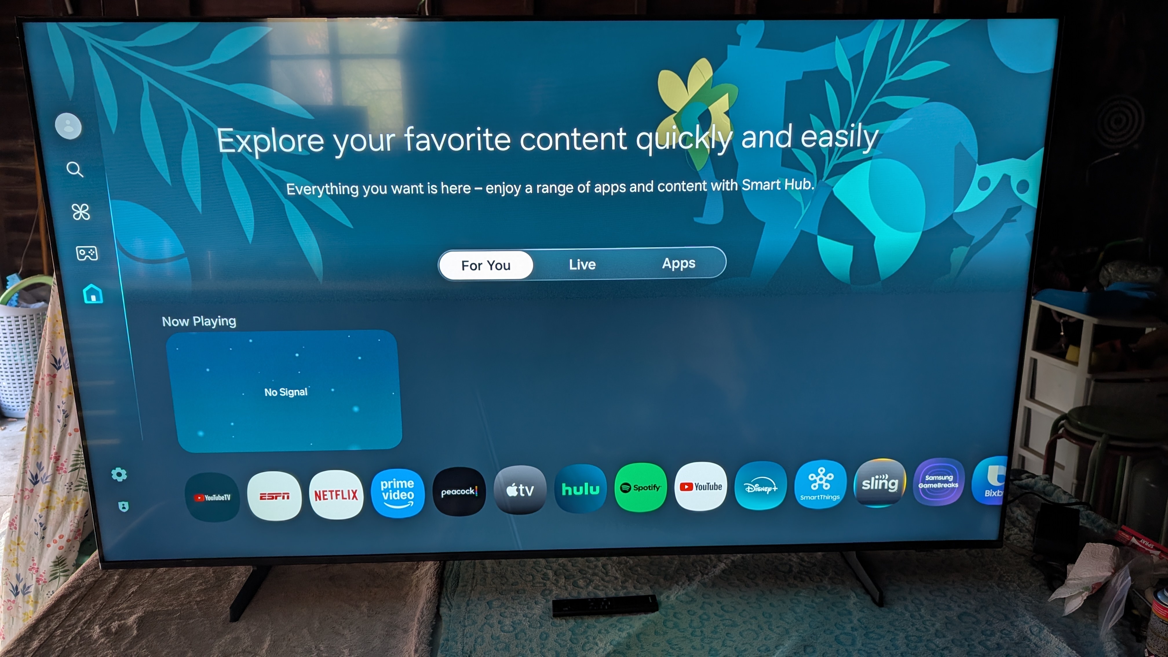

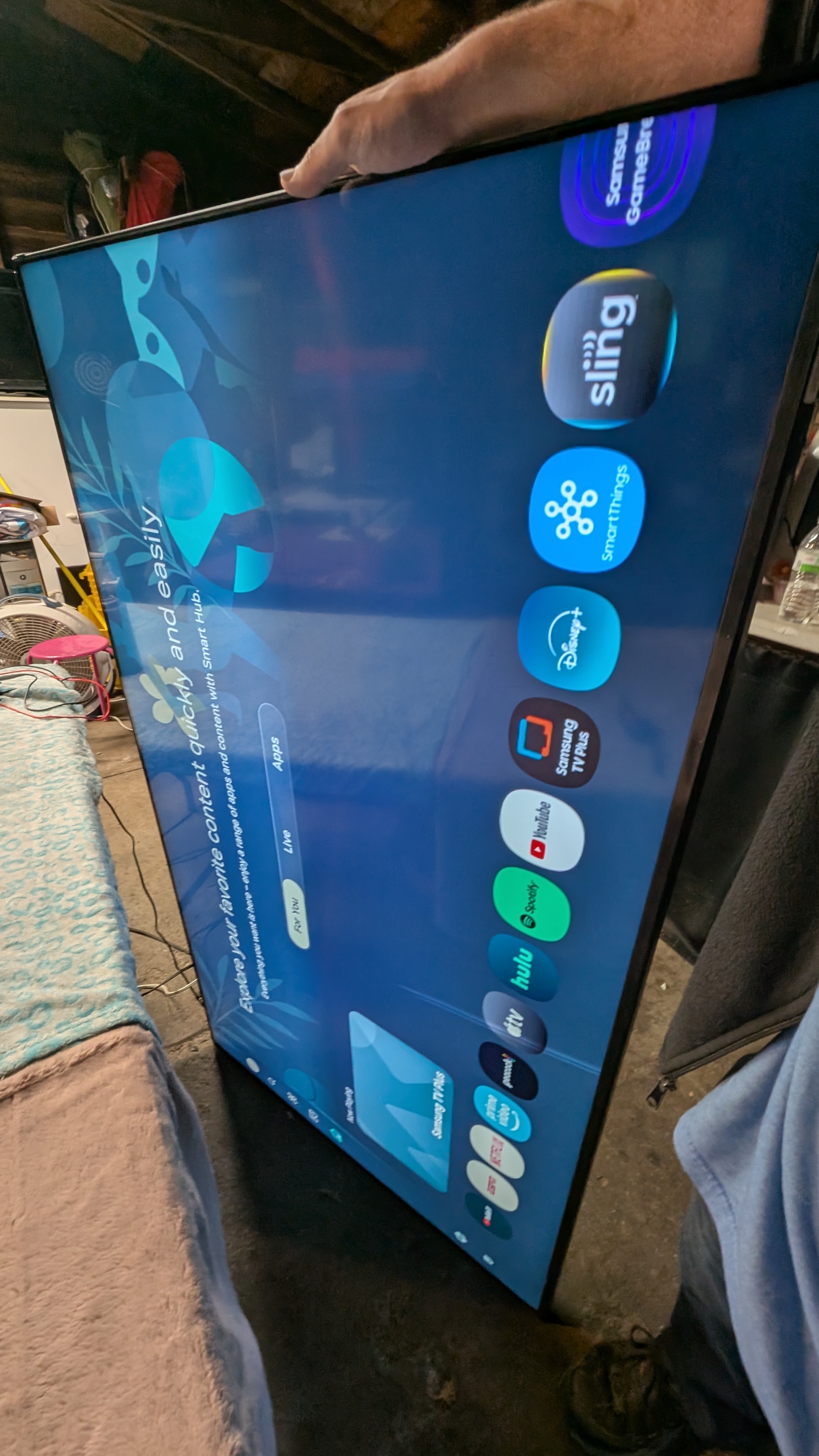

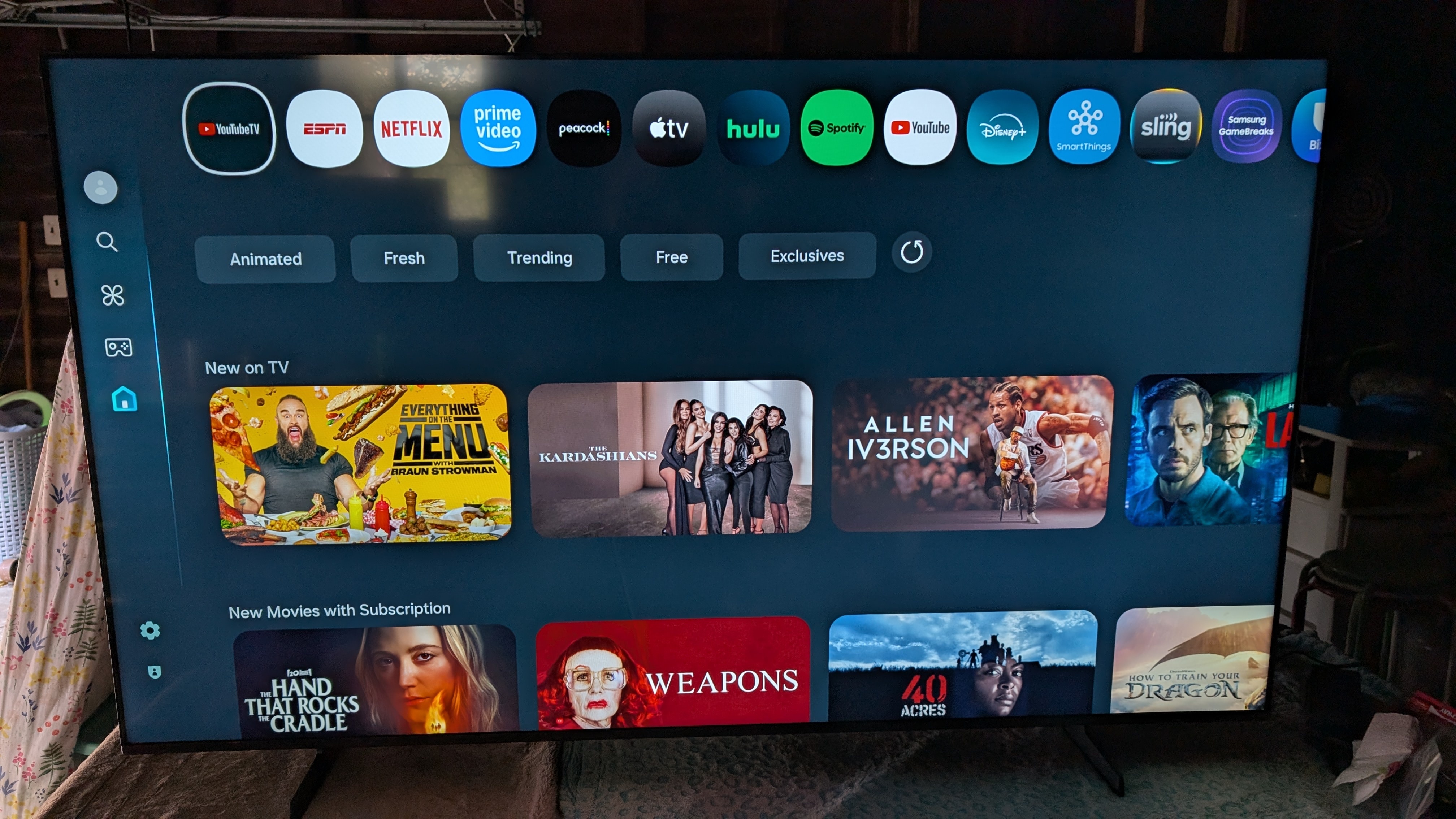

                                It's alive!
                                I cleaned up the carbon on the board and hooked it back up. At first it was making fizzle and crackle sounds then stopped and I noticed I had a standby light. There was no backlight, so I checked with my flashlight and could see an image. I removed the boards again and wire brushed the contacts of the connector and plug, sprayed them with contact cleaner, and reinstalled them. Powered right on with backlights! I'm going to order a replacement power supply now that I know the backlights are good.
