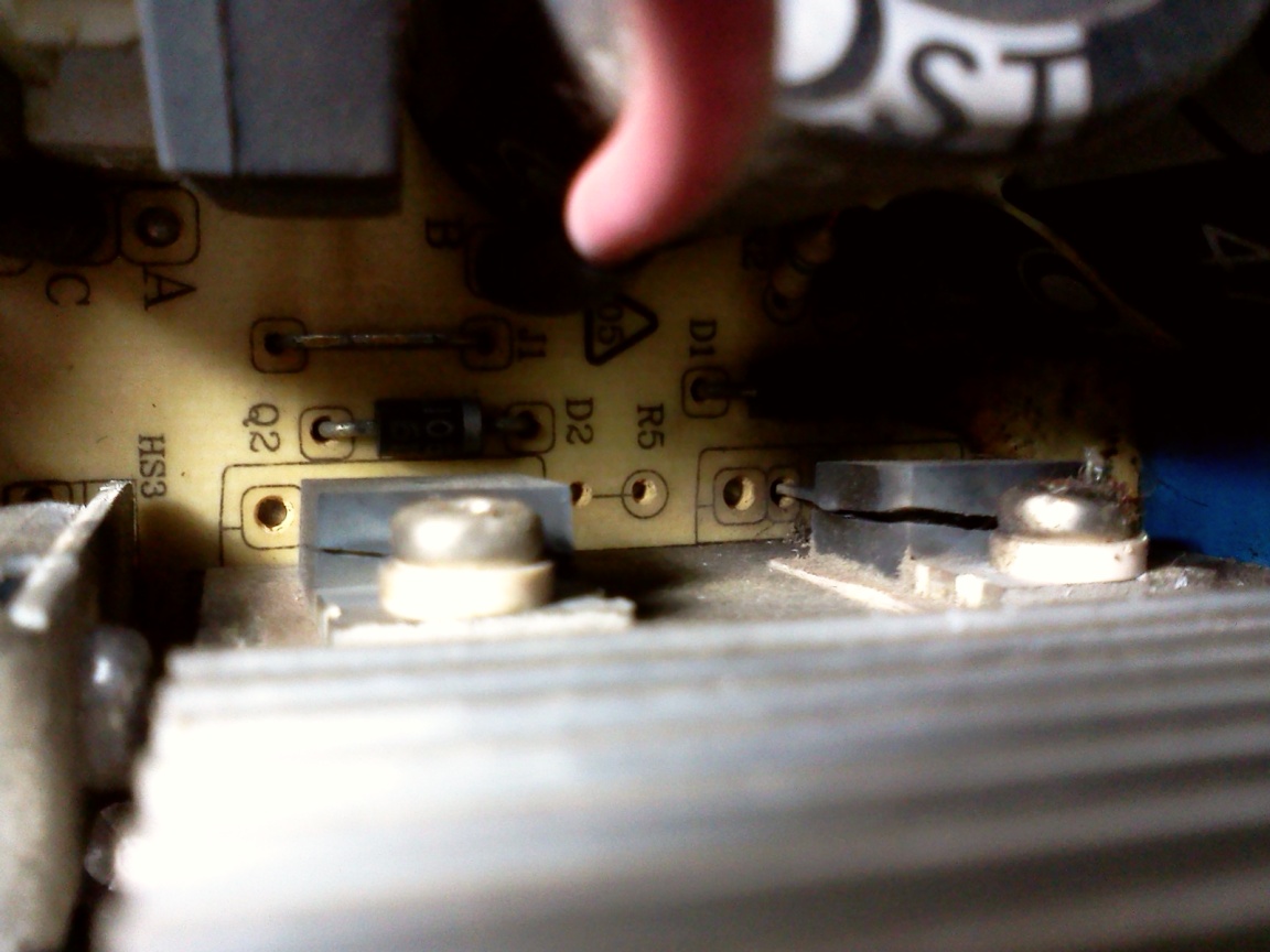

                    FSP F350-A went seppuku!
                    Took motherboard, processor and 1GB DDR2 with it, primary transistors were MJE13009, there are several resistors burned around the area and mexico just put a new satellite into orbit (a small OST cap)
                    Customer said he pushed power button and heard a pop then smoke came out of computer, any guesses here about the "sequence of selfdestruction"? This is my first F350-A so I need your advice as if it is worth the time to try a repair.

                      Fair bit of damage! I haven't built a system for years now. However I thought FSP built good power supplies and just require a recap.

                        Probably was a random failure, maybe the switching transistors shorted out and backfed into the capacitor, which is in the driving circuit for the switching transistors.

                          Concur with ben7. The damage seen in the pictures you posted is in the inverter circuit - the switch transistors and the base drive components. What I find interesting is that the damage to the P/S is on the primary side, but that catastrophe seems to have propagated through the output transformer, creating a voltage surge large enough to wipe out the motherboard. Maybe the fan seized up and let the switch transistors cook themselves?
                          Based on the 0621 datecode (21st week of 2006) on that one OST input cap I'm going to guess that this power supply is about 7 years old, not exactly new or old. A decent design in a reasonable operating environment should last longer. About the design generally, a 350W rating seems optimistic. Based on the heatsinks, 250W seems more realistic (if not a bit optimistic). Based on the output inductor core material and use of transistors for the switch devices, it probably operated between 20KHz and 50KHz. Two switch transistors suggest a half-bridge design, voltage-mode control and a TL494 ("real" or clone) PWM. I may be wrong, but I don't see the large film capacitor on the primary side that is often used with half-bridge designs to prevent the main transformer core from "walking" in to saturation, due to small imbalances between the two switch devices. Assuming the fan did not seize up, it could be that the 13009s were not well matched (or aged differently), the output transformer core saturated, and the 13009s went .
                            It's a simple half-bridge design, so it should be fairly easy to fix once you find all of the components that went bad (and there will be quite a few on the primary side). There's also the 5VSB circuit - it's a 2-transistor design. If I was to fix this power supply, I'd do something about the 5VSB circuit as well before it goes into a computer.
                            I think it's on the far side near the front grille. Probably a smaller one and harder to see on that picture.

                              Thanks for the input guys, I just finished testing hard drive and optical drive and to my surprise both are toasted so this PSU took the entire computer with it.
                              ...What I find interesting is that the damage to the P/S is on the primary side, but that catastrophe seems to have propagated through the output transformer, creating a voltage surge large enough to wipe out the motherboard. Maybe the fan seized up and let the switch transistors cook themselves?
                              Fan and fan speed circuit works as it should, don't know what could have happened but the magnitude of damage is what really surprise me, I've seen even crappy units like low end Key Mouse with shorted 13007s and none of them damaged the entire system.
                              ... Two switch transistors suggest a half-bridge design, voltage-mode control and a TL494 ("real" or clone) PWM. I may be wrong, but I don't see the large film capacitor on the primary side that is often used with half-bridge designs to prevent the main transformer core from "walking" in to saturation, due to small imbalances between the two switch devices...
                              It uses propietary chip but i guess it is a functional equivalent to a 494 +339 maybe ? About the film cap it does have one rated at 2.2uf 1KV btw thanks for the info i didn't know what was the purpose of that big film cap.

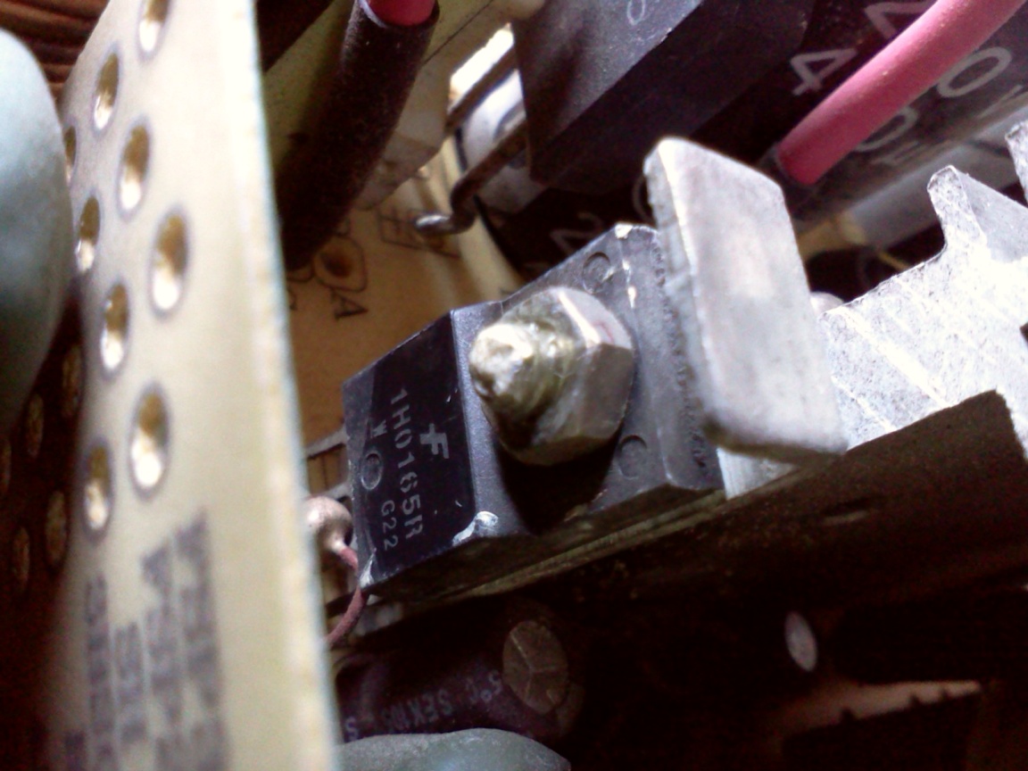

                              Turns out this PS does not use 2-transistor circuit for SB, it uses an KA1H0165R from Fairchild's Power Switch Series so at least this is one thing less to fix.
                              I will try to fix it but after seeing the disaster caused by this unit I don't know if it will be smart to use it again inside a computer.

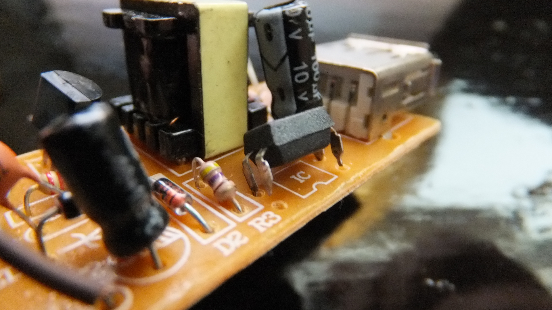

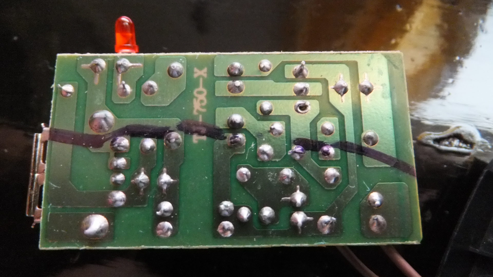

                                          Chinese 1$ including shipping phone charger.
                                          Brand is TJ Courier Charger, specs 5v 500ma.
                                          Surprisingly, this thing works.
