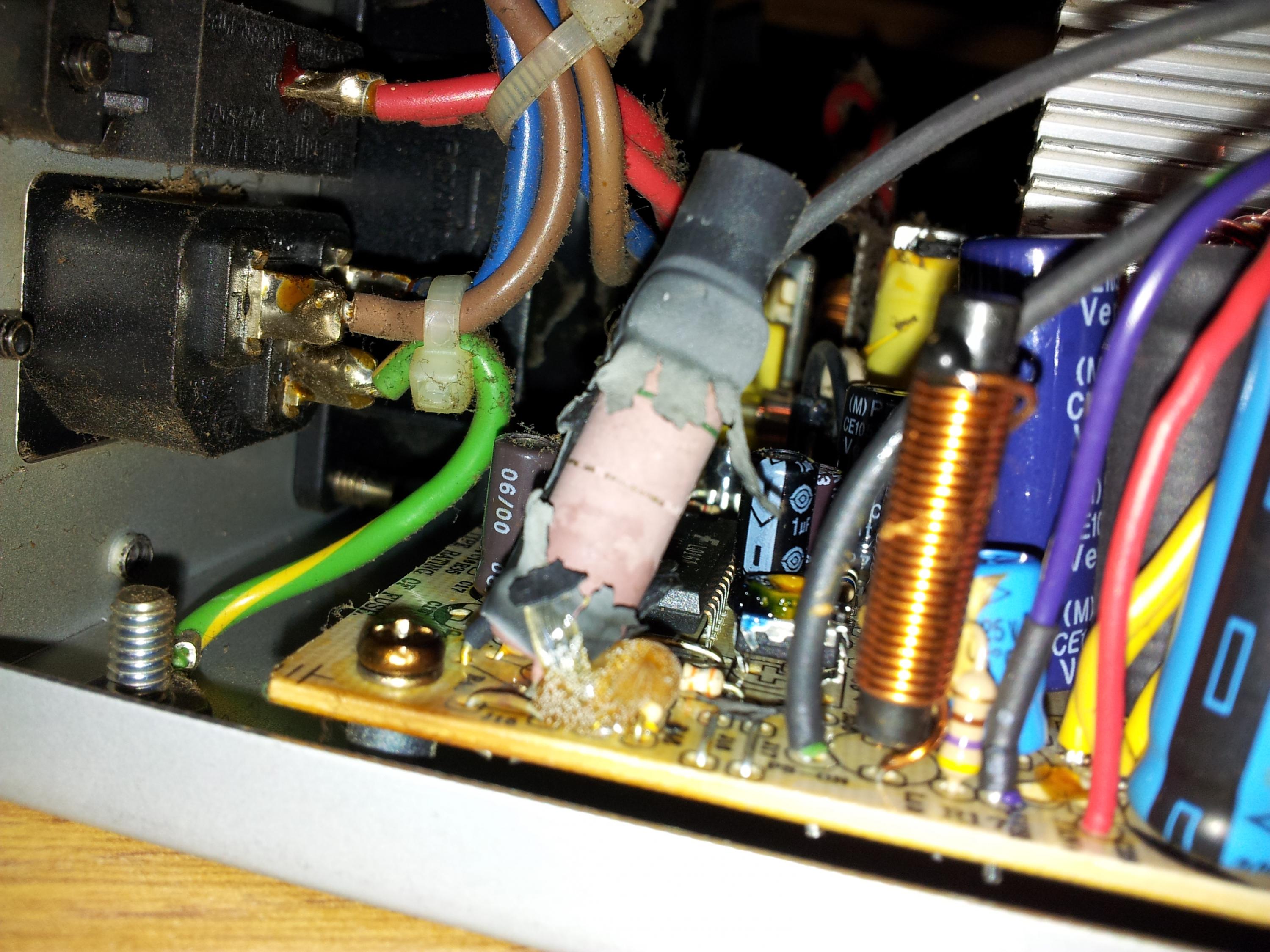

                                  #536
                                  Re: the gutless, bloated, and fried power supply hall of shame
                                  These pictures come from a Norwegian forum, this is a AOpen psu - Fuhjyyu and Yec caps.
                                  Premium supporters get full download access and other benefits.

                                    #537
                                    Is it FSP design or something else? AOpen seems to actually be a daughter company under FSP Group so it should be theirs, but hey may have had outsourced this one…

                                      #538
                                      Yeah, looks like an old FSP one from 2000 (judging by that Teapo cap) I had one like that and the caps died in it too cause they're all trash worth a recap though, although not a very efficient PSU at all

                                        #539
                                        It's very old design so you can't look for efficiency in that thing. But it can deliver it's rated power.

                                          #540
                                          I don't have any more info on the AOpen psu other then that the resistor on the left gets really warm - you can see it has melted the shrink tube.
                                          The psu doesen't belong to me, just happen to see the pictures on a forum yesterday - the owner did not post any specs on it.
