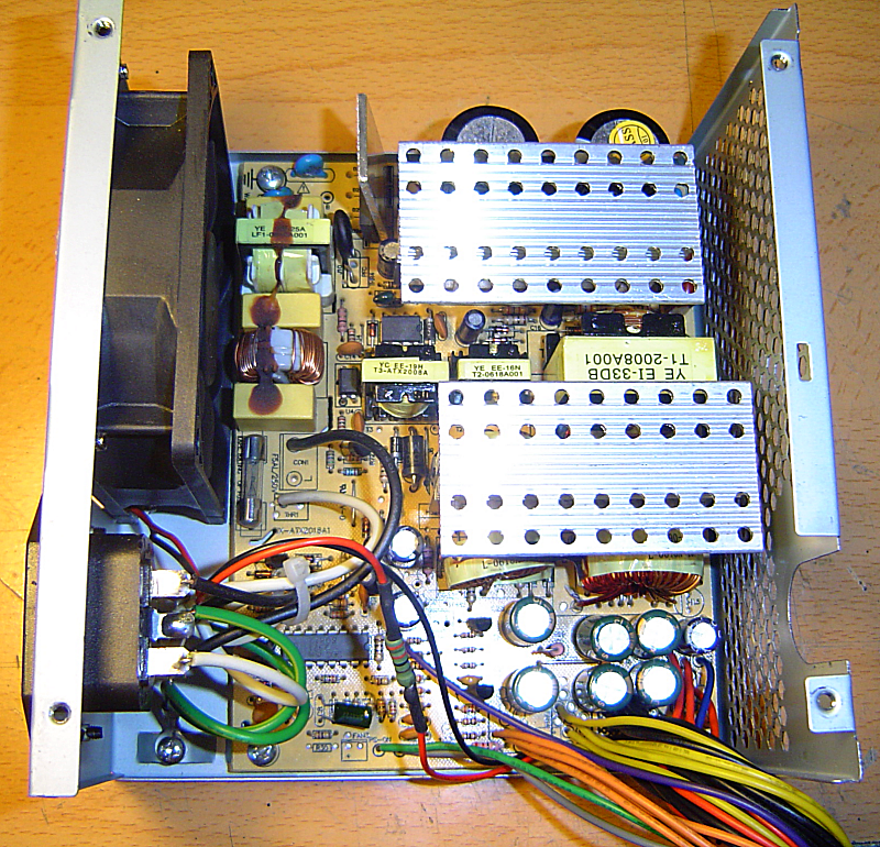

                    Another even worse 'TOOQ' gutless wonder :
                    Behold its mighty rectifier bridge :
                    (Should I 'upgrade' to a four-diode treatment?)
                    Somebody messed up and put 13009s instead of the traditional 13007s:
                    Armoured extra thick heatsinks:
                    Exquisite output filtering courtesy of state-of-the-art, stealth technology PI coils:
                    And not a single SATA connector !

                        #851
                        Worldwide EA-300
                        Seen a Worldwide PSU before, but it was a rebranded CWT ISO series PSU. This ones UL number leads to "MITACHI TAIWAN CO LTD" and the fan pretty much confirms this. For the 300W label it looks alright.
                        First time I've ever seen Su'scon on the voltage doubler of a PSU, 560uF isn't bad. 4A bridge, switchers are your standard 12A 13009 transistors, and 2 transistor 5VSB. The input filter is decent minus the fact that those aren't safety approved Y caps and the spots for the MOV's were not filled.
                        35 transformer, decent sized 5VSB transformer.
                        Here's what I don't understand about this PSU. Where is the toroid for the 3.3V regulation, and the 3.3V output?! Also, instead of your average 16-20A ultra fast, there's a 40A MOSFET on the 3.3V rail. Why would they use this method? 16A ultra fast for 12V and 30A schottky for 5V. Both the 12V and 5V have room for another rectifier in parallel. All of the caps minus the bulk caps are JEE, and surprisingly only one of them on the 5VSB is bulging. Although I wouldn't be surprised if some of the other ones had high ESR. According to the PWM chip, this thing was manufactured sometime in late 2006.
                        Also really glad that this things fan doesn't run at 100% all the time!

                          #852
                          Re: the gutless, bloated, and fried power supply hall of shame
                          The 3.3V rail uses linear DC-DC conversion from the 5V rail, which doesn't require a toroid coil. It's used because it's cheaper than using a separate rectification circuit for it.

                            #853
                            Cool, thanks! Does it yield any benefits such has higher efficiency, or does it just reduce the ripple on the 3.3V rail?

                              #854
                              It's just cheap. Linear regulation is the cleanest and simplest, but also the most inefficient form of regulation, as the difference between input voltage and output voltage is dropped across the regulator element and wasted as heat. Basically the regulating element behaves like an automated variable resistor.

                                #855
                                It's 34 watts at 20 A? OMG, what is efficiency of this thing, 40 %?

                                  #856
                                  Interesting. Does this create more heat on the only toroid since it's generated from the 5V? So it probably doesn't even need a PI coil for that rail to stay low on ripple. Luckily the 3.3V rail isn't stressed much at all in modern systems. I have this thing powering a Pentium D (90nm powerhog) with DDR RAM and a GT220, surprisingly even with that Pentium D at full load the 12V rail is staying steady at 11.97V. The fan did kick up quite a bit, but still pretty quiet.
                                  Are you talking about the 3.3V rectifier?

                                    #857
                                    Whole supply, in worst case scenario it burns 34 watts just at +3,3 V, don't rather think how much it burns on other rails

                                      #858
                                      Haha When it was running that Pentium D system it was pulling about 150W and the secondary heatsink + toroid were 35C, 36C respectively. Doesn't seem too bad. This thing did not take a 30A schottky rectifier on the 12V, even one with 100V reverse voltage. Can I put a 12A ultra fast in parallel with the original 16A ultra fast? They're both MOSPEC with the same exact specs except the peak amperage. If not, I think two 12A ultra fasts in parallel would be better than a single 16A especially for efficiency, and combined probably good for ~19A

                                        #859
                                        Indeed.
                                        But if you don't have much of a load on the 3.3V rail (which most systems nowadays don't), then this is nothing to worry about. In fact, I prefer this linear regulation method as you have the choice to use any caps you want on the output of the 3.3V rail and also the 3.3V rail outputs very very clean power.
                                        As far as I know, only old video cards like the Radeon 9500/9700, and 9800 used the 3.3V rail more heavily (like 2 to 5 Amps).
