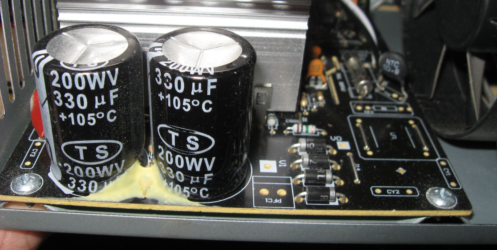

          #864
          Re: the gutless, bloated, and fried power supply hall of shame
          here's the power supply that died in my father's computer - see this thread if you don't know what I'm talking about : https://www.badcaps.net/forum/showthread.php?t=33718
          Claims 450w , 3.3v @ 24a , 5v @ 35a , 12v @ 16a .. uses 16a diodes on secondary for all rails.
          Primary capacitors claim to be 330uF - I don't care enough to measure them, I'm sure they're probably 220uF. 13007 transistors in theory could give it 250-300 watts but no way with that main transformer.
          Power supply still 5v standby but when i try to power it on, there's a fain fizz (barely audible) and it doesn't turn on. Assume over voltage protection or some diode shorted.. not sure if I even want to spend time to fix it.
          Shame about the nice black pcb with nice silkscreen.
          Not much else to say... see the pictures below:
            That thing's so wimpy that 200W might be pushing your luck, and I'm not sure what the worst weak point is. The AC I/P rectifiers are probably rated for 1A. Even if they really are 330uF, those I/P lytics are nowhere near what they should be for 450W. The heatsinks are somewhere between painfully thin and anorexic. Even the number of output wires on the high current outputs looks worrisome.
            But at least you didn't have lots of beefy components and wires to obstruct getting good pictures! And you don't have to worry about unsafe X and Y caps.

              #866
              I actually checked those diodes after taking the shots. I think it says RL257 on those and in that case they're rated for 2.5 A each:
              https://www.badcaps.net/download/?id=ef6614d6
              It could be that the manufacturer is overly optimistic or... yeah, datasheet shows them rated at 2.5 A for up to 75c .. at 100c they can only do 1.5 amps.
              It's sad these things are sold in my country and people like my father without electronics knowledge fall for these (and often in small towns with just one IT store you don't have alternatives). He simply went with the whole computer to the store and asked them to change the power supply after previous one failed.
              This power supply was 50 RON, which is about 15.4$ and that includes our country's 24% VAT.
              So the distributor probably brings them into the country for around 9-10$ each...

                #867
                Originally posted by mariushm
                ... not sure if I even want to spend time to fix it ...
                Not much worth it IMHO. Even if you upgrade everything else, output filtering lacks PI coils and there is only one cap per rail . There are no empty parking slots to improve that.
                  Nah, I just misjudged the rectifiers from the picture. At 2.5A they're less under-sized than I thought, but still probably not good - with reasonable derating - for more than 400W. Not having PFC, the peak currents those things conduct at the peaks of each half cycle must be pretty high (looks like it can handle on the order of 12A repetitive peaks).
                  This broaches a couple of things that really bug me. Painting with a very broad brush ... North Americans and Western Euro-Folk are freaking spoiled when it comes to having good stuff available - speaking as a North American. Eastern EuroFolk, and folks from Oz and KiwiLand have it less easy, and much of Asia, Africa, South America and Oceania, good stuff is hard to get, if at all. Or at least that's my perception. Those who make the good stuff go where the $$ is, and less prosperous nations are left wide open to shadier operators.
                  When it comes to safety agencies, North American and Western EuroLand agencies really are legit - creating meaningful regs and having enforcement behind them. To be blunt, I think "safety" agencies in many/most third world countries are means of extorting $$ from companies that make good stuff, but lack the enforcement teeth to keep out unsafe @#$% from shady fly-by-nighters (and seriously, who's the bigger target, multi-B-$$ companies like HP and Sony? Or No-Name companies making a few million $$ a year making @#$%?).
                  And then there's the grey areas of not-so-good stuff, brought into whatever country a bit shadily, sold by retailers who may or may not know what quality looks like, and sold to non-technical customers who trust the retailer to sell products that can safely do what they claim to do. That's a plague affecting every country to some degree.
                  I wish I could say that I see an good solution, but government regulation easily becomes weapons to stifle innovation and competition, and to pay off cronies (e.g. Solyndra and more) while punishing political enemies (e.g. Gibson guitars). OTOH, there are plenty of shady and dishonest people eager to make a few quick $$ off of people's trust and ignorance.
