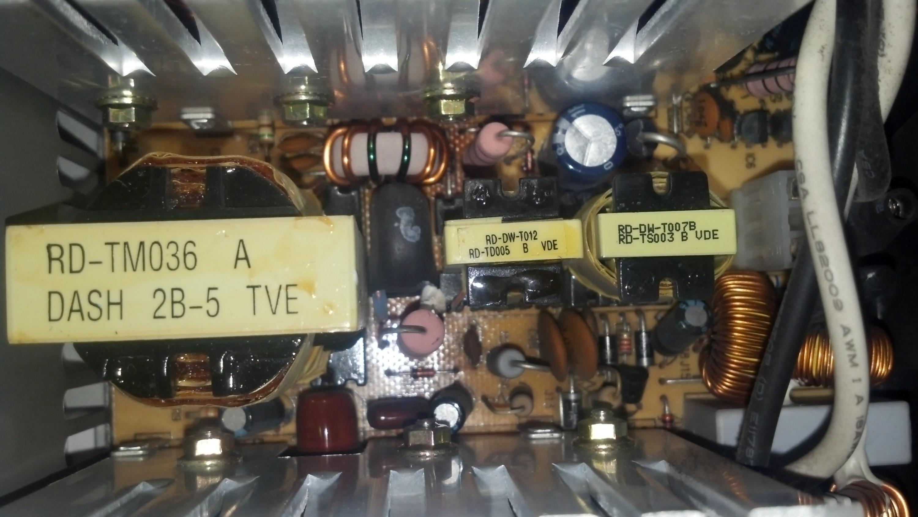

            Re: the gutless, bloated, and fried power supply hall of shame
            Originally posted by Pentium4
            I refuse to put any Leadman unit in the build quality pictoral so I'm putting it here Although it isn't as bad as some...It has what I think are fake 1000uF NCC KMG input caps. It only has one part on the primary heatsink and it is an ST W12NK90Z MOSFET rated at 11A 900V, how many watts would this thing be good for? The secondary has a 40A schottky for 12V and 30A for 3.3V and 5V. On the 12V filtering it only has a 1500uF 25V cap
            Is this a two transistor forward design? Would this thing have ridiculous ripple?
            STW12NK90Z is a decent MOSFET that I've seen used in Delta 350W and Hipro 400W power supplies, and that means it's single switch forward... I don't know if it would do such a rating in spec with such poor output filtering, though.

              #606
              Oh nice, that's good it has a decent enough heatsink too. I don't think the 12V ripple would be in spec either. I could increase it to 3300uF but it'd still be pretty high I'm sure....Wish there was a spot for an inductor, looks like there's only one on the 5V

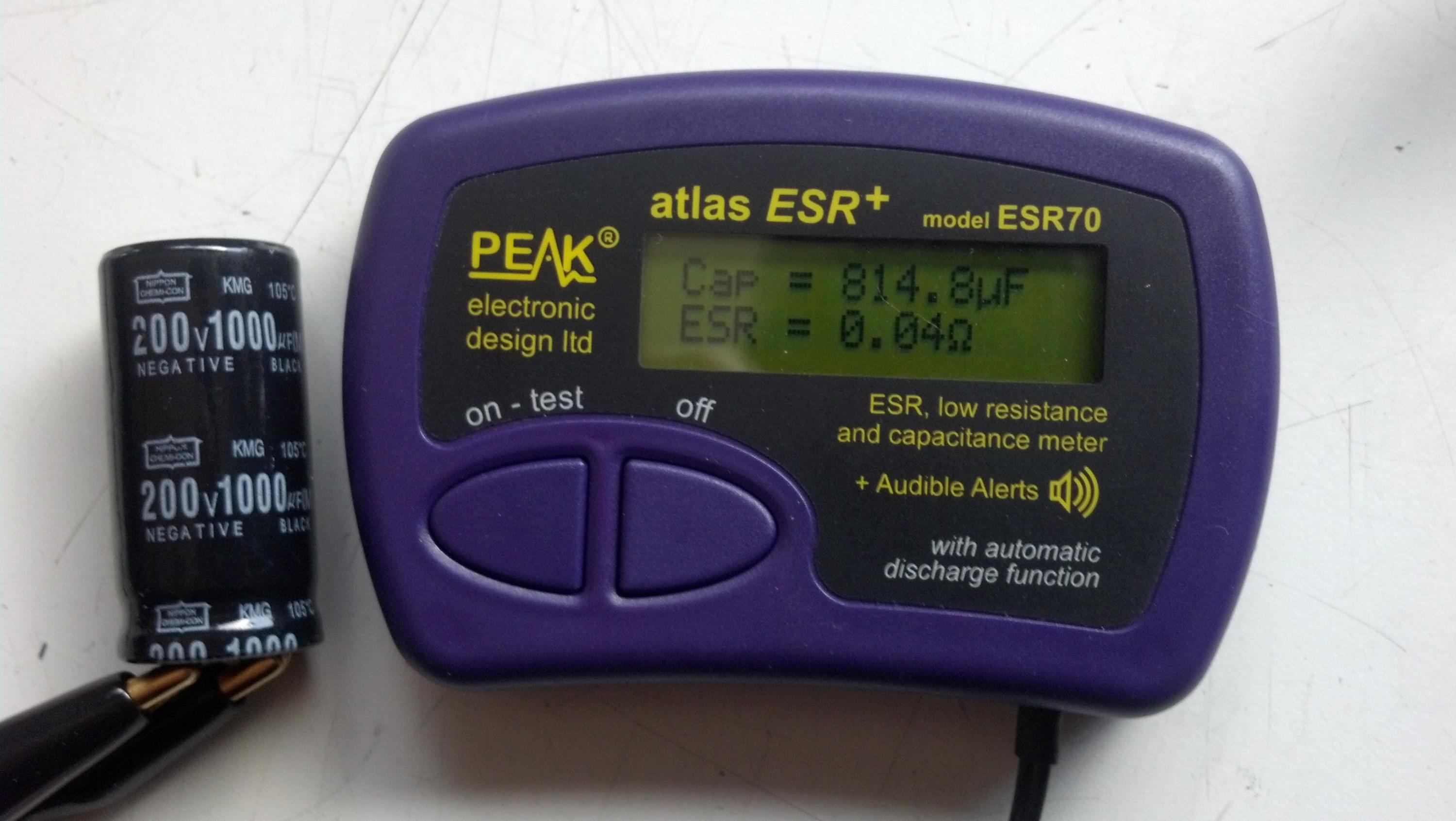

                        Ahh, 820's...you're almost there Leadman! The picture doesn't do it justice but the sleeve and paint look extremely cheap

                          #612
                          Well, still in +-20 % tolerance And don't forget these ESR meters are not really precise in measuring these big caps. It uses only small voltage (as being powered by CR2032 cells, usually), fraction od the caps nominal.

                            #613
                            But being almost brand new and so close to 820uF I figured it's probably fake And this one uses a single 12V Alkaline battery
                                Big electrolytic capacitor is not affected by test voltage.
                                Only ceramic capacitors and some tantalum capacitors are.
                                I have found many in-spec 200V & 400V caps (from Rubycon, Nichicon, Panasonic, CapXon, Samxon etc.) But in almost all power supplies I see, at least cheap models, the primaries are fake and mislabelled.
                                  Yeah but sometiems even quality ones are out of spec (or on the bottom of tolerance). Also it may be that many of the biggies do not quite really like over 10 kHz frequency. Don't the meters use higher freq?

                                      #618
                                      The capacitance is measured by integrating charge into it and takes several seconds to do so, the test frequency is under 1Hz for all but single-digit uF caps.
                                      The ESR is measured at 100kHz but that is not the important factor here.
                                      Yes whilst capacitors are rated +/-20% it is rare to see a quality brand depart from +/-10%. These are definitely remarked 820s in my opinion, perhaps to fool PSU review websites? The manufacturers are learning...

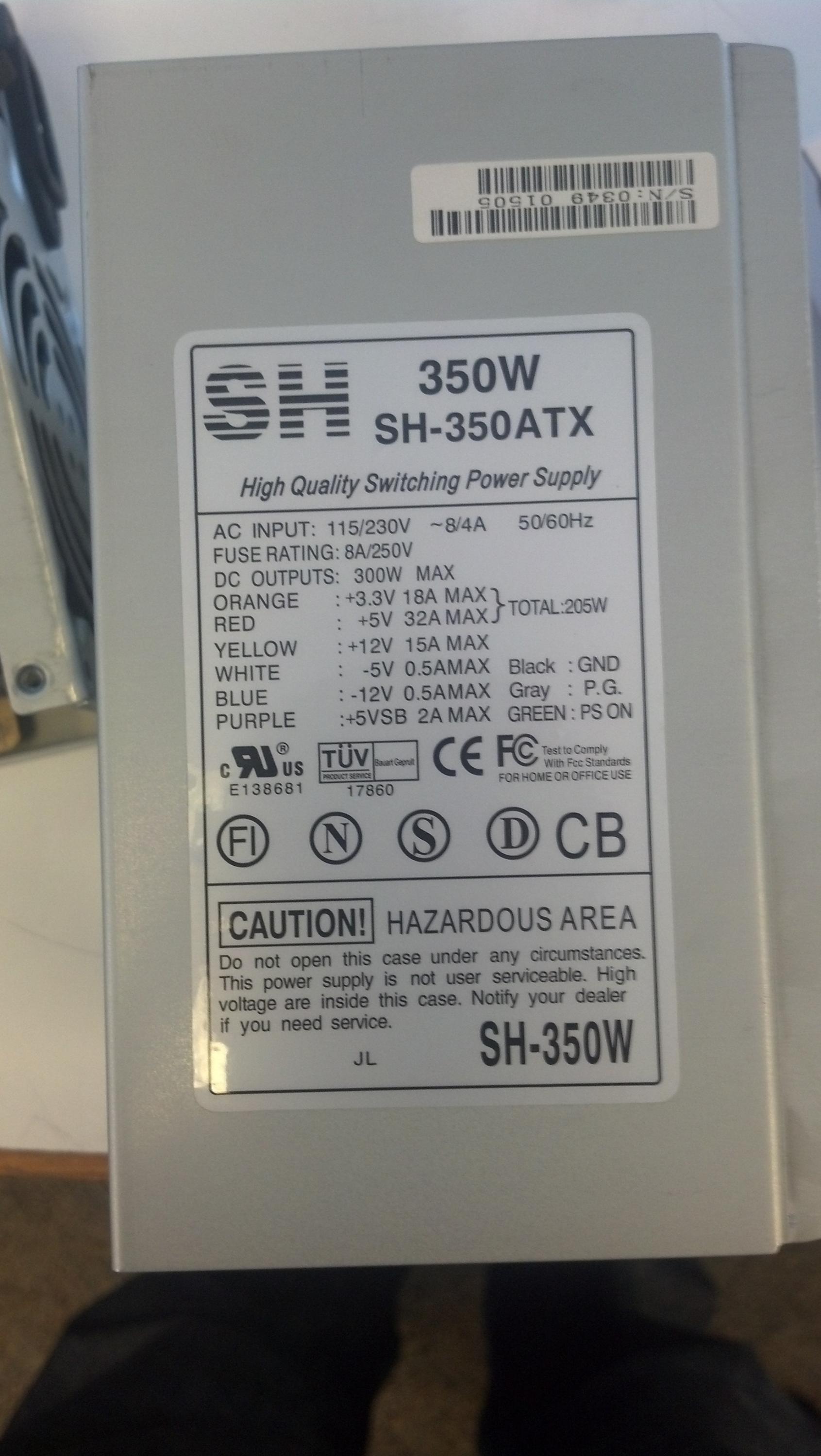

                                        Another one of these "SH" PSU's. I find it strange that I've seen 3 of these and all 3 were from different OEM's. I'm not 100% sure who this is...It looks like an old beefed up Deer unit, but it seems unlikely they would use Teapo and Jamicon. It has some nice Fuji Electric 2SC2625 10A switchers. This thing died powering an old P4 server...Surprised it lasted 8 years. It has a ball bearing ADDA fan
