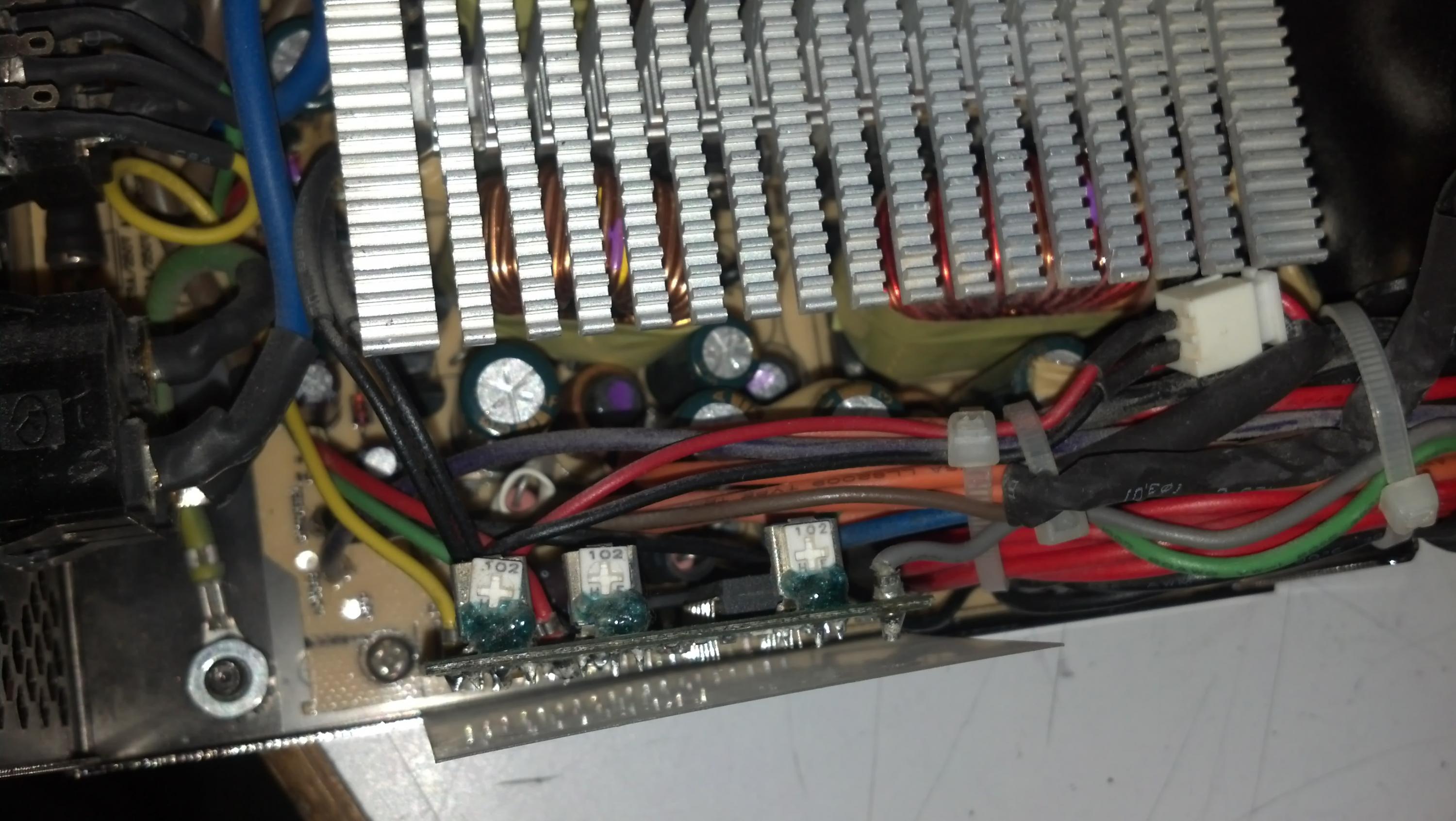

                        Here is a Coolmax made by Sirtec. Bulging Teapo caps, what a surprise! Every single cap in this thing is a Teapo. Rather weak 2SC2625 switchers, don't know why they didn't use the 2SC3320's.
                        Looks to have two 12V rails...until you see it only has one 12V rectifier, and there isn't a slot for a second one. I will have to remove the heatsink to see the specs of them. You can't see them really in the pictures but there are two HUGE PI filter coils under the wires. They're each 10x20mm and shrink wrapped.
                        That daughter-board is housing a SG6105DZ PWM controller and an LM339N comparator. The crappy T&T fan is going to be replaced, nothing but trouble with that brand, and it's LOUD even on the lowest speed setting

                          #652
                          Re: the gutless, bloated, and fried power supply hall of shame
                          It's a HPC-460-N12s ... lying on the label.
                          http://www.highpowersupply.com/hpc430n12s.html
                          hpc-430-n12s says 14A and 16A for 12v rails, 300w total. And 150w on 3.3v and 5v.
                          The 460w wouldn't ever be 380w on 12v, probably 320-340w max.
                          Yet coolmax advertises it as a 500w psu with 180/380 wattage.
                          Considering how many cables are there it doesn't surprise me than the teapo leaked .. who knows in what system this psu was in the first place and how dusty/hot it was.
                          Looks good for a 2006 power supply.

                            #653
                            It does look good for a 2006 PSU. And the heatsinks look really nice. It has a two PCI-E connectors (6 & 6+2) so you're probably right, they probably had a nice video card hooked up to it. So you think it's really a 400W PSU or not even? It'd probably need beefier switchers
                              It's a 460w honest psu, labeled as 500w by coolmax, with i would say 520-550w numbers on the label.
                              It says on the label in the corner, hpc-460-n12s so you can estimate what it was rated for by going with the 430w model listed on the sirtec site, the one i linked to. I couldn't find a 460w model, probably because it wasn't sold under high power brand.
                              2006 is written on the pcb, but it could be a 2005 design fabricated in 2006, or it could be a 2007 psu using pcb from 2006, you get the idea.
                              It's still good psu for that time, that's all i'm saying.
                                Thanks for the link. Judging by the label it was made in the 31st week of 2006. I think I will keep it
                                  Originally posted by Pentium4
                                  I refuse to put any Leadman unit in the build quality pictoral so I'm putting it here Although it isn't as bad as some...It has what I think are fake 1000uF NCC KMG input caps. It only has one part on the primary heatsink and it is an ST W12NK90Z MOSFET rated at 11A 900V, how many watts would this thing be good for? The secondary has a 40A schottky for 12V and 30A for 3.3V and 5V. On the 12V filtering it only has a 1500uF 25V cap
                                  Is this a two transistor forward design? Would this thing have ridiculous ripple?
                                  I was looking back on this one....Any particular reason they used a 25V capacitor on the 12V rail? Maybe just to get a higher ripple rating, or for some reason is 16V too low there?
                                    Yeah mostly it seem they have higher ripple with voltage. Seems like Samxon RS is the exception here
                                    Or they just had 10000 pcs left?
                                          Originally posted by Rulycat
                                          I'm pretty sure there are only two guys in charge of the company - A guy who knows how the PSU works, and a purchasing guy. The purchaser just asks the engineer "Would this part work?" "Nope" "This part work?" "Close enough" as they flick through a catalogue of the cheapest components.
                                          This cracked me up
                                          I think maybe they might have had a reason for a 1500uF 25V cap there. I replaced it with a 3300uF 16V KY cap, and removed the minimum load resistor, fired it up and the 12V read 12.59V....in spec but very high. I put the minimum load resistor back in and it didn't change the results at all, so I'm thinking the cap might have something to do with it? the yellow wires on the 24 pin connector sit around 12.52V but the other yellow wires read sometimes up to 12.61V, although after letting it warm up, it goes down a little bit to 12.57V. It's powering a P4, 9800GT, and 3 hard drives so there is plenty load on the 12V line
