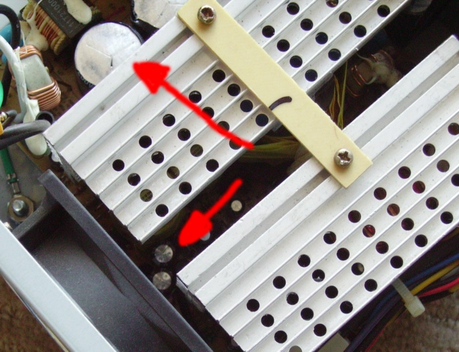

    Here's an SP-350 with busted caps (a very common sight on these forums). Unlike I'm used to on Smartpowers, this one had tiny 330uF primaries, rather than the usual 680uF. Both of them were bloated, as well as the standby caps.
