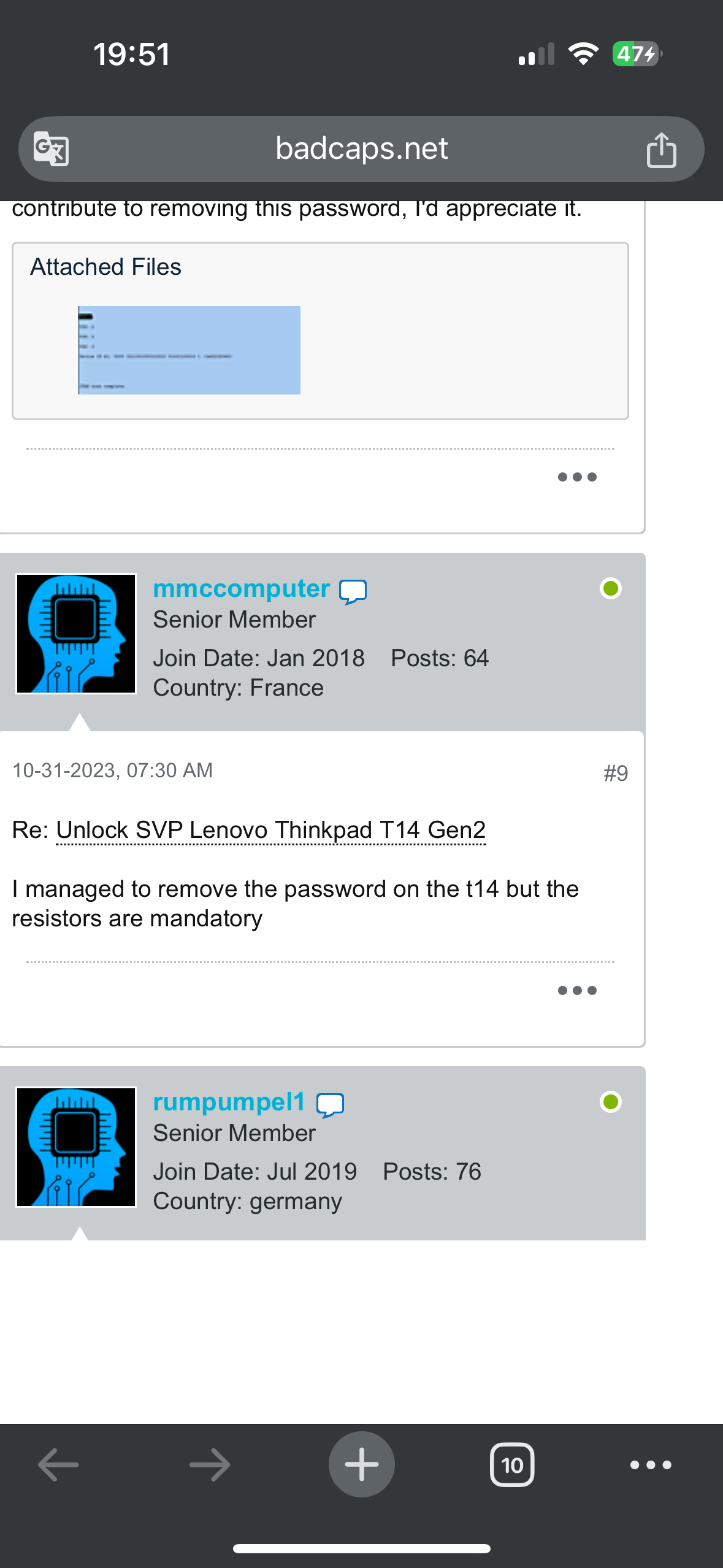

              to make things clear, the solution I talked about in the thread ''Unlock SVPLenovo Thinkpad T14 Gen2"
              is different from the solution of the guy from Algeria
              the first is functional on certain Mec1503 (and I cannot share it because I do not have authorization of its owner and it requires a hardware modification)
              the second is functional and concerns mec15xx mec17xx (but not all) and some npcx9xx and it cost me around 100 euros (transport and service)

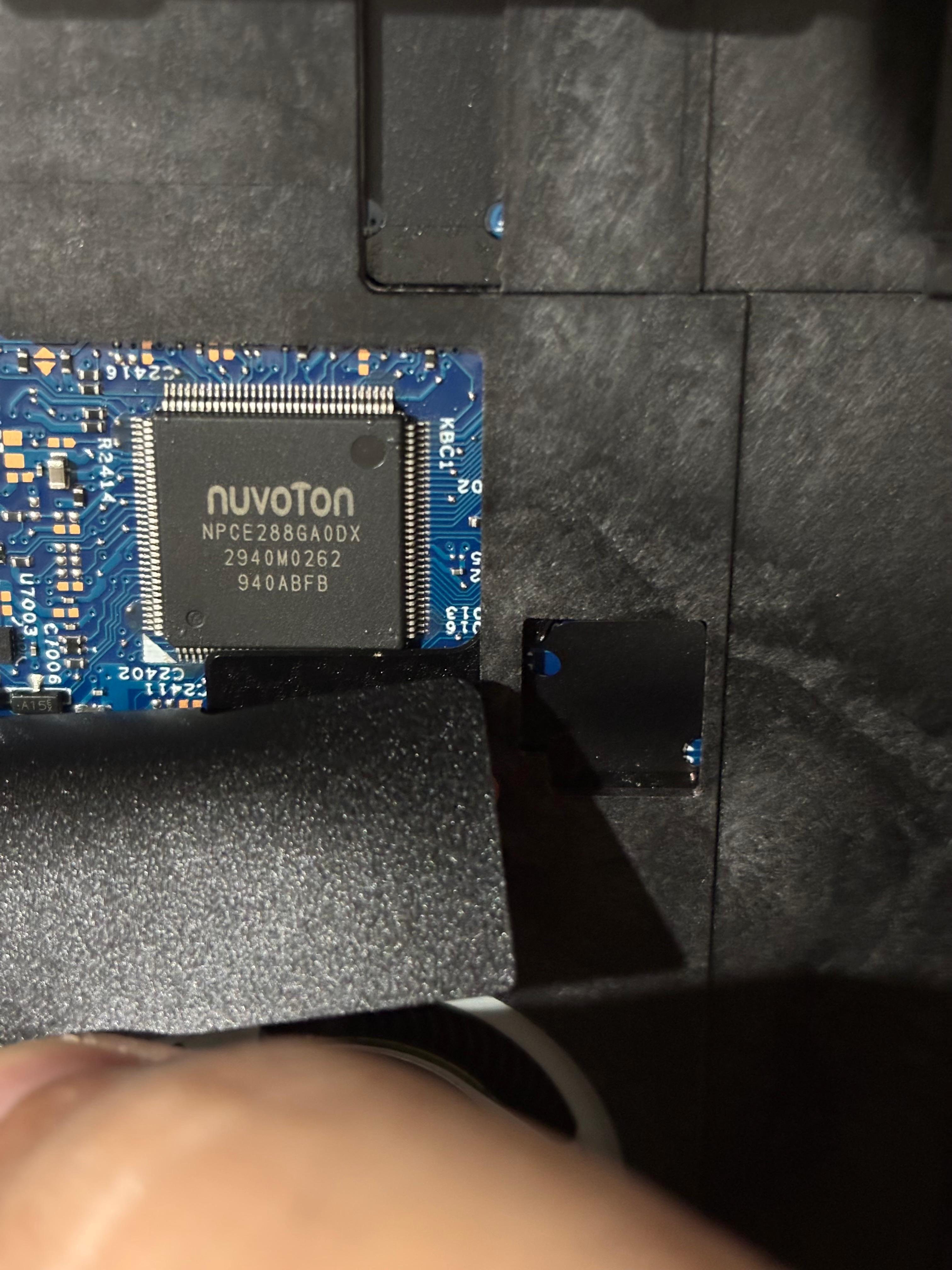

                                        Hello, could someone help me with bypass to my Thinkpad L390 Model: 20NSS2GF00 - NPCE288GA0DX?
                                        • shiyab
                                          • Sep 2023
                                          • 1695
                                          • india
                                          #500
                                          post ec bios and snid
