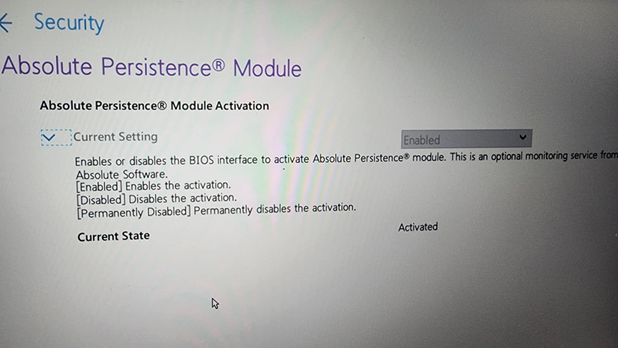

                        Some Help for this? T14 gen 4 no Bios pw, but i cant disable this

                            #593
                            You need to change the serial with programmer in EC

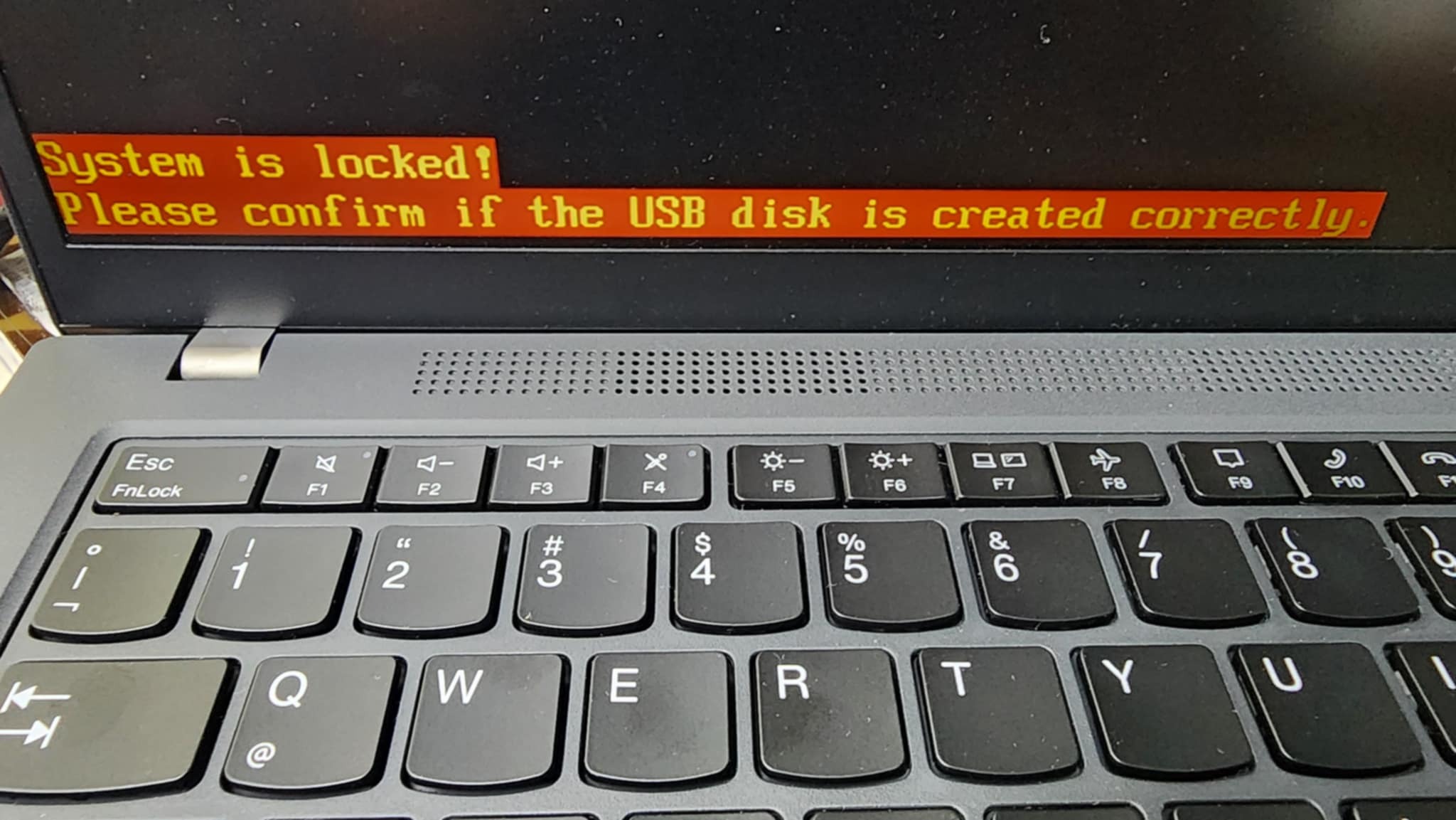

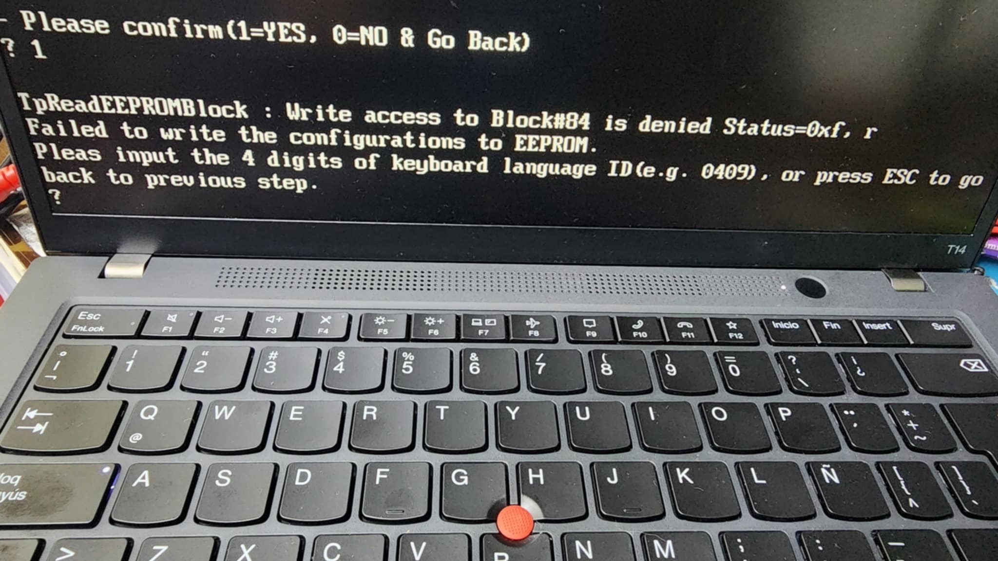

                                  #596
                                  What is the Lenovo utility for in this case?
                                  If there is no BIOS password, it has access to change the serial number!
                                  And it won't disable absolute because it's still active in bios?
                                  I tried with lenovo golden key 3.5 and I get the following errors

                                    what did you make the usb key with?

                                      Respect rules please !!
                                      Sorry
                                      Thinkpad T14 gen 4
                                      SN: PF-4PYXD7
                                      TYPE: 21HE-S89500​
                                      following the next tutorial
                                      https://www.badcaps.net/forum/troubl...r-bootable-usb
                                      • Maxpower3

                                        #599
                                        Sorry
                                        Thinkpad T14 gen 4
                                        SN: PF-4PYXD7
                                        TYPE: 21HE-S89500
                                        try another key with my post
                                        https://www.badcaps.net/forum/troubl...70#post3538670
                                        Ver 3.5.35

                                          #600
                                          Ver 3.5.35
                                          OMG Your post works! Thanks!
                                          i can change the SN thanks!
