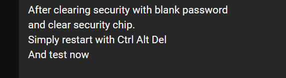

            Originally posted by altuntabak
            hello lenovo t14s gen1 nm-c891 rev:1.0
            I think you are talking about the blank password, which I understand without clearing it. I tried it with enter. The same result (Did you clear the security chip?) I couldn't understand what you mean. When I get the errors, when I press enter a few times, it restarts, but nothing changes, the result is still the same.
            https://www.badcaps.net/forum/troubl...00#post3262400

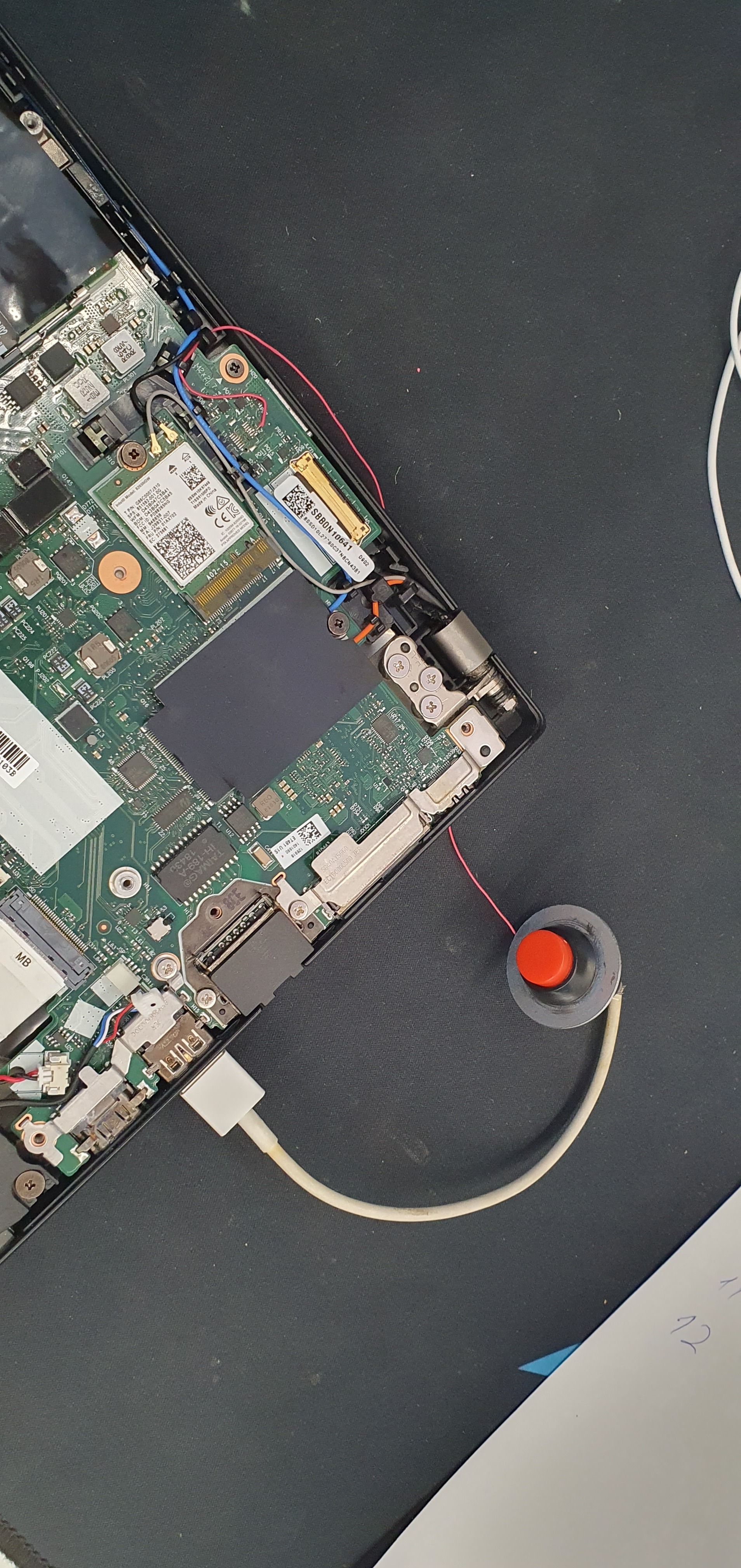

              Success!!
              The mini circuit with button and GND from USB was a miracle, i was ctrl-alt-delete and buttoning rapidly.
              Thank you Maxpower3 pro as usual.
