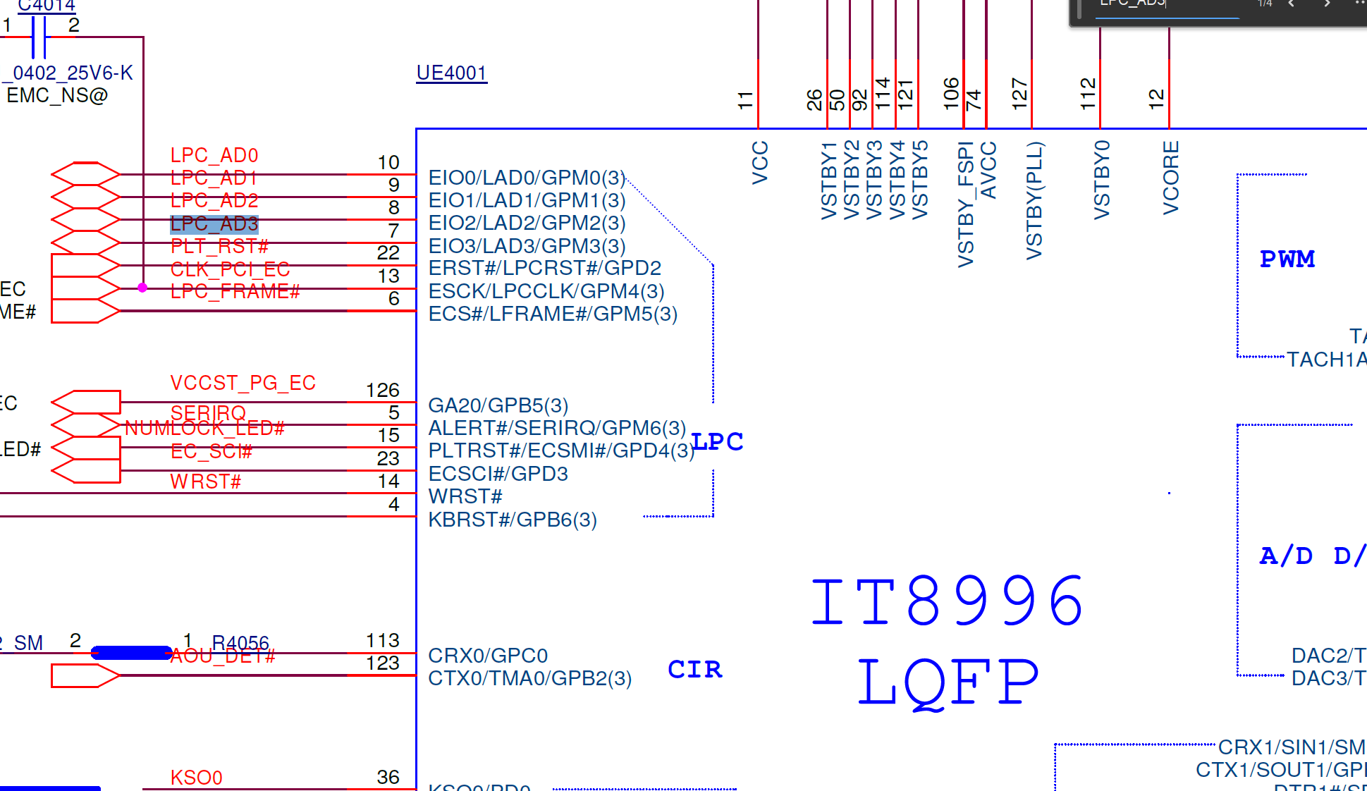

      Hi Maxpower3 ,
      First of all thank you for your great work!
      I'm trying to remove the BIOS password from my p14s gen 4 amd (21K5), would the method described work on this model?
      I'm trying to locate the EC on the motherboard but can't find it, would you have any information on the EC location or how to access the LPC bus?​

          hach
          santoslao
          Hello.
          Both of you must find schematics and search for words "LAD" and "eSPI"
          If you found "LAD" is possible
          If you found "eSPI" is not possible.

            Thank you for these ways, but unfortunately t14 gen2 only has eSPI in its scheme. The fact is that there are people who do this unlocking but are keeping the seven keys, they don't sell and also don't contribute with the information, I've already taken more than 10 pieces of equipment of this model and dismissed it for not having a solution for them, and giving it as scrap. Right here in the forum there are people who say they managed to solve it but don't pass on the information.

              Well it's known that it can be done but with programmer.
              If you have many Lenovo with eSPI then it's worth it to buy a SVOD programmer and do it your self.

                  edit
                  after many try
                  I managed to enter the bios, but the tabs are missing.
                  Click image for larger version  Name:	441499388_881095270699214_2116687842734834106_n.jpg Views:	1250 Size:	363.5 KB ID:	3279733 Click image for larger version  Name:	441409609_1406188906766540_432083223838718957_n.jpg Views:	1050 Size:	336.0 KB ID:	3279734
                  The Espi connector is not connected, the resistors are missing
                  Click image for larger version  Name:	436069011_1692389747833736_4228328836113742636_n.jpg Views:	830 Size:	701.1 KB ID:	3279735
                  so it must be connected near the EC
                  Click image for larger version  Name:	NM-E441.png Views:	831 Size:	401.8 KB ID:	3279736
                  I have to start very early to pass, well before backlighting.
                  I have not yet fully understood how.
                  I also managed to get errors like uuid or others
                  not yet able to remove the password
                  ON T480s 1.13 that i had missing tabs and UUID errors i managed to get all tabs with glitch right before lenovo logo and probably some milliseconds with logo too.
                  Early glitch gave me exactly these errors.
                  Try this way, very interesting case.
                  Update:now that i remember details, i never managed to trigger the glitch with 1.13 so i updated to next version of bios. Try next version too and try the way i wrote
