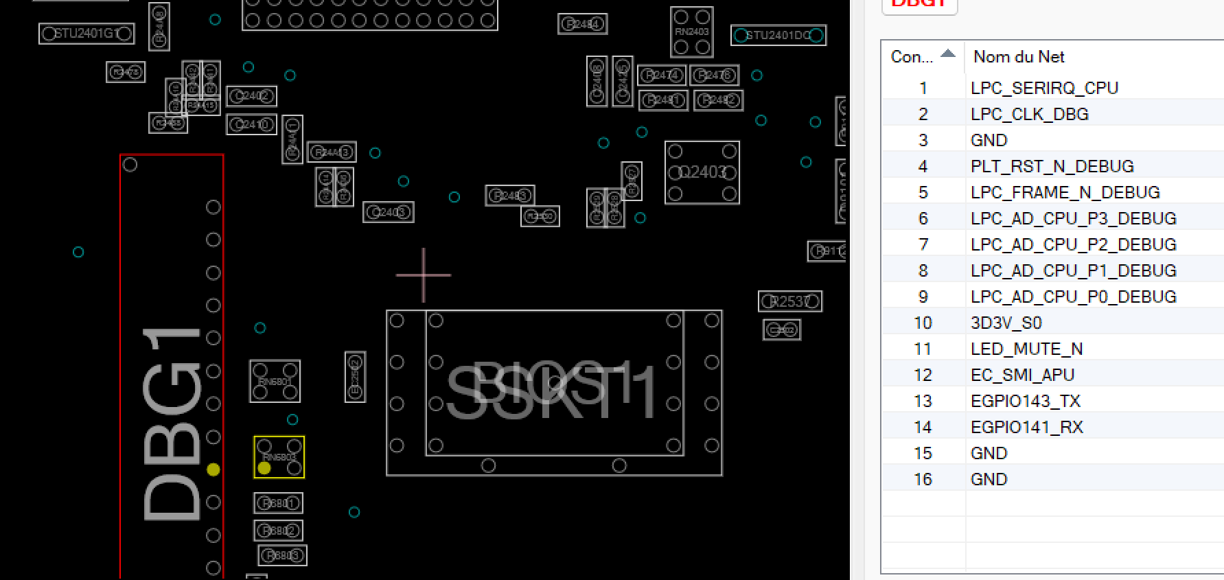

    Hello, could someone help me to bypass an L14 GEN3 AMD?
    • Maxpower3
      Bad Veteran
      • Feb 2018
      • 1358
      • France
      #402

        it won't work. the device is using the espi bus.
        • claudio21s
          • Nov 2022
          • 30
          • chile
          #404
          Yes, I tried and it didn't work, thanks anyway
