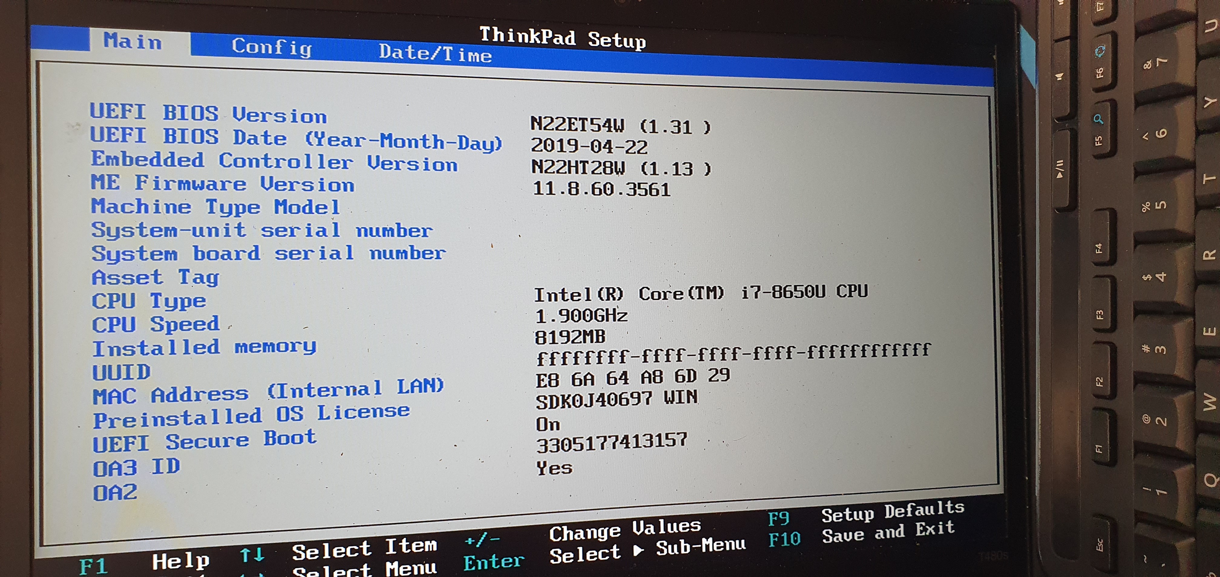

    2+ hours of testing and no success.
    The closest i get is a "user" bios interface with only Main, Config and Time tab enabled.
    I get some EAIA data access error and Machine UUID is invalid but still after this asks for password again.
    I even installed the same BIOS like Max's laptop on T480s video.
    I give up.

          No luck, still the same, closest i can go is a limited BIOS with Main, Config and Date/time tabs only.
          Esc is not preventing the shut down due to Thermal Sensing Error

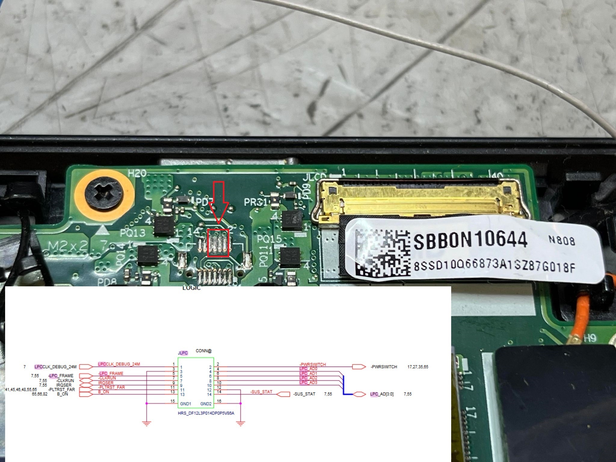

            Just to make sure i'm not super dumb, the marked red pins are the correct? any of them?
            Please confirm.

              I bricked it, loaded defaults on limited BIOS and now is just singing a melody, no post.
              No problem, it will become a great donor for the rest T480s, locked motherboard was useless anyway.
              If you need any testing with t480s, T490s and E14 Gen2 let me know, i have many.

                for me, t480s and t490 worked with pin 6.
                I don't bother with T14 gen1.​

                  i tried all pins with the above results.
                  perhaps has something to do with the enabled fingerprint on my BIOS, i don't see other difference.

                    Hello everyone.
                    Don't save with F10, just clean Pwd with enter twice.
                    If the serial, uuid etc. information is corrupted, you are saving the wrong information
                    The method is delicate, there is always a risk of bricking or try failed.
                    ITE and Nuvoton is easy
                    Mec16 is more delicate (many try necessary).
                    Timing is important
                    you're almost there, the safety tabs are missing, you have to keep trying. maybe stay less long
                    for MEC, must start before the display with a short contact,
                    too long = fan error and power off.
                    Never saved or loaded by default, I killed a few computers during my tests too
                    if Mec records corrupted information, it's over​
                        Before display you mean before the LENOVO logo BUT after the backlight?
                          difficult to explain
                          just before the panel lighting, before the logo.
                          It takes many tries to get the timing right.
                          if too long or too late, fan errors and other errors appear.
                          The ideal is when you have access without errors so that the numbers are not corrupted.
                          you have to check if information is not corrupted in the first tab.
                          that's why I do a ctrl alt del after deletion like that the information is not saved, just password removal
