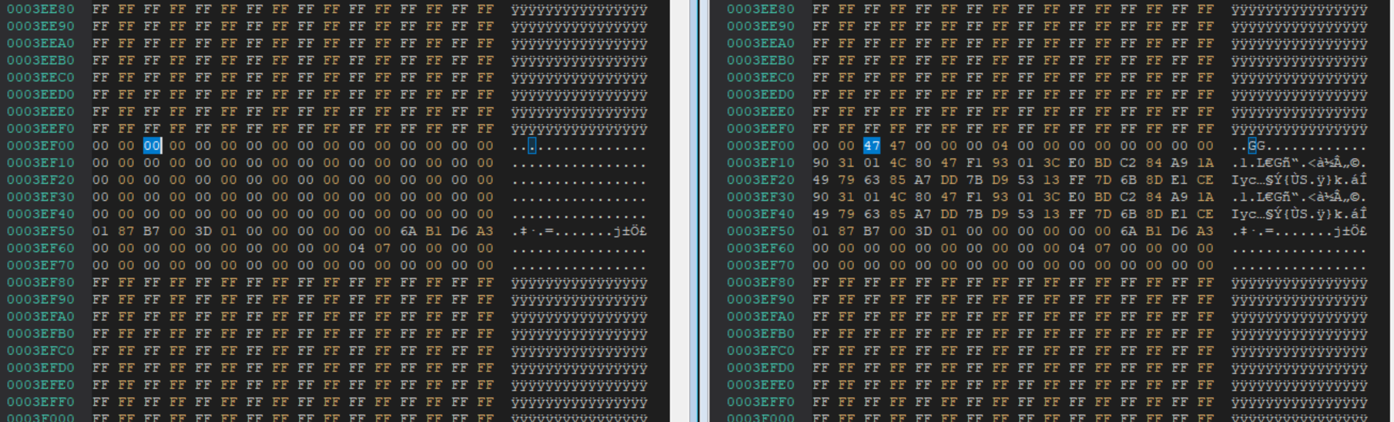

    Does anyone have any information on this?
    I asked the question there, but got no answer of course.​
        no, nobody would tell because of money... it's a shame

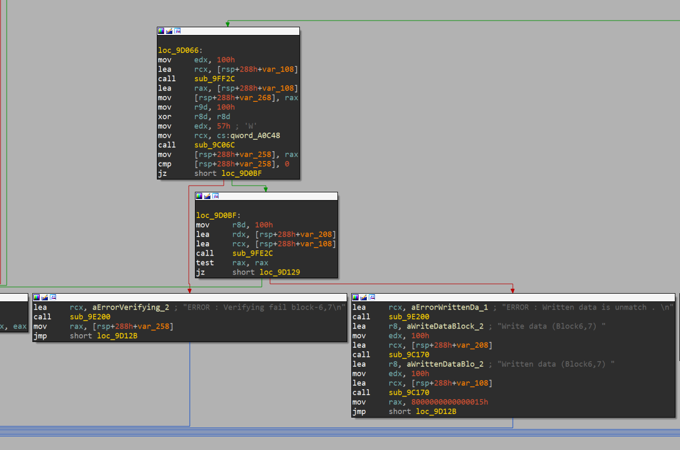

                      thank you, it's been a long time since I've been here, I reread the messages in my feed.
                      As for the dead processors, I believed on several occasions that they had killed the card but each time when idle the card restarts. We clearly see an increase in current consumption when the shunt is made and the freeze.
                      As for models that worked before but no longer work, I think a bios downgrade is necessary because we now know that changes were made following this.
                      The only PC I killed was an X390 when I played around with modifying the Lenovo utility to remove the password.
                      I replaced 54h with 57h but I made a mistake in my modification.
                      The EC is corrupt now​

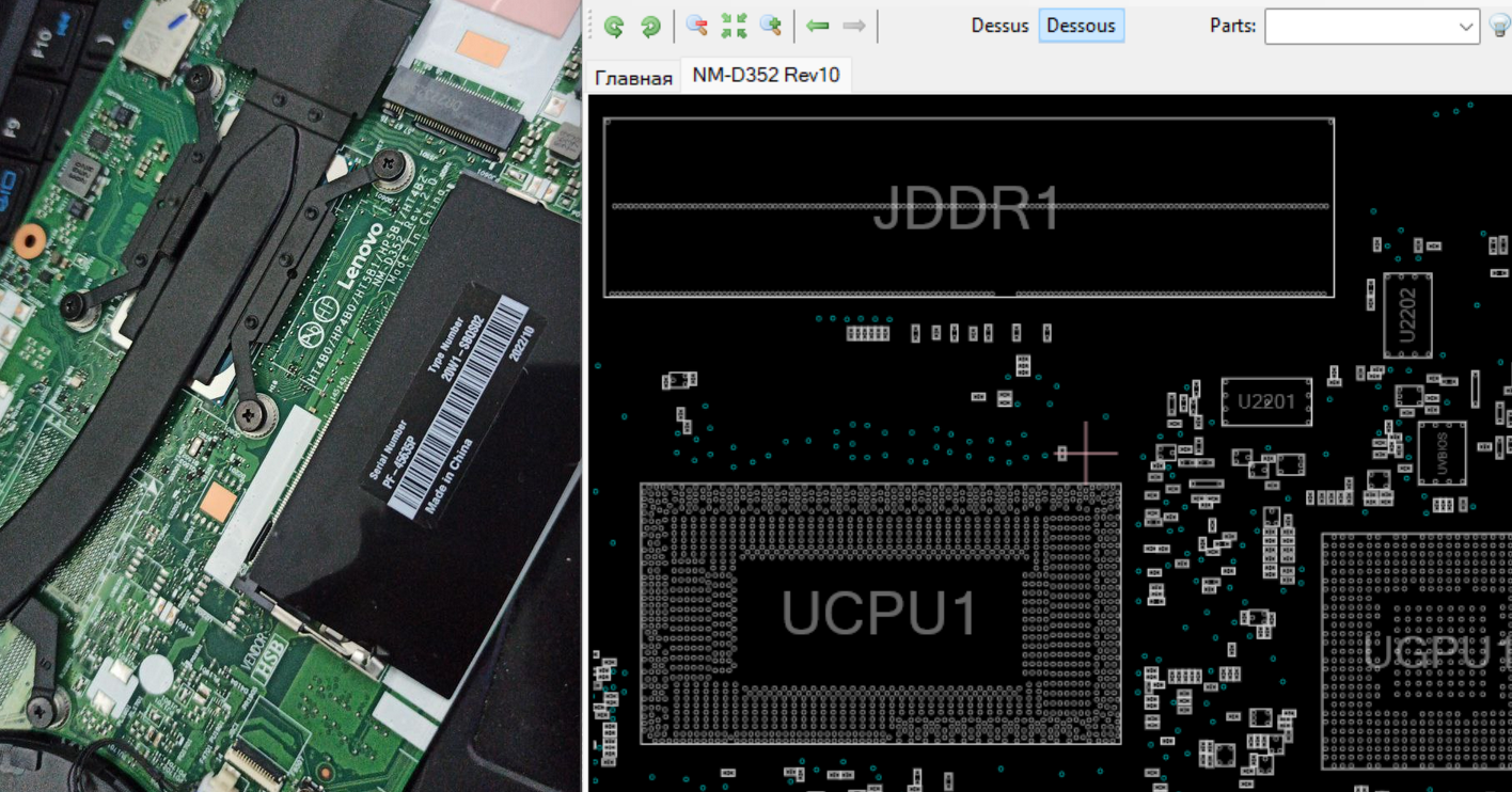

                          Originally posted by Usering
                          If you focus on the video, the BIOS chip is desolder.
                          this image, where 2201 and 2202 went on vacation ?

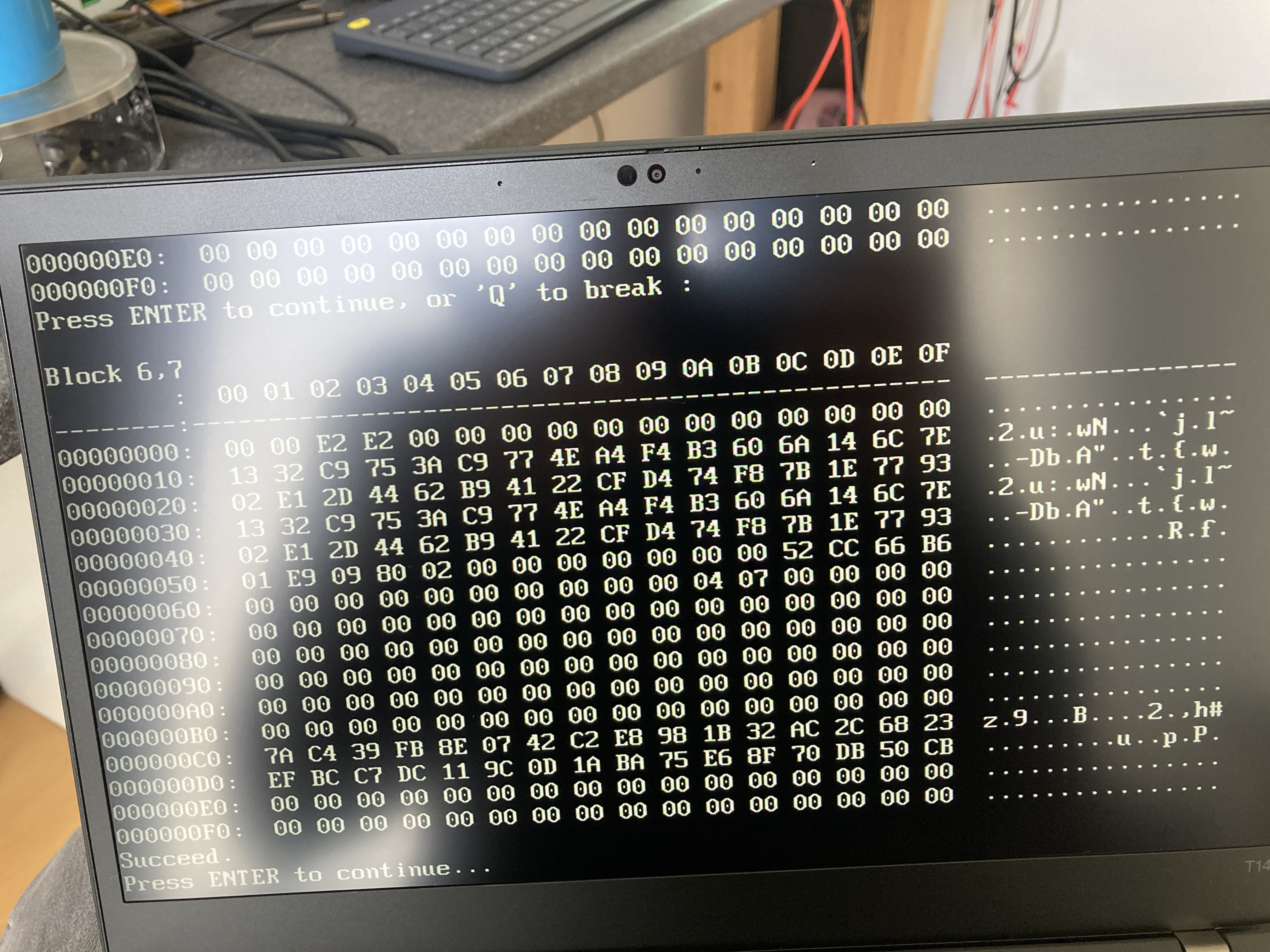

                                Cliquez sur l'image pour la voir en taille r?elleà  Nom : 		image.pngà Affichages :	0à Taille :		164,2 Koà ID : 			3523816
                                we have the authorization to modify certain blocks with the utility but blocks 6/7 are prohibited if password is configured. I tried to fake the blocks.
                                we also notice that the cleaning is contained in the utility so I tried things on this side​
                                Cliquez sur l'image pour la voir en taille r?elleà  Nom : 		image.pngà Affichages :	0à Taille :		90,7 Koà ID : 			3523818
                                Block
                                0/1 =T
                                2/3 =U
                                4/5 =V
                                6/7 =W

                                    #557
                                    https://www.badcaps.net/forum/troubl...17#post3449517
                                    Block
                                    0/1 =T
                                    2/3 =U
                                    4/5 =V
                                    6/7 =W

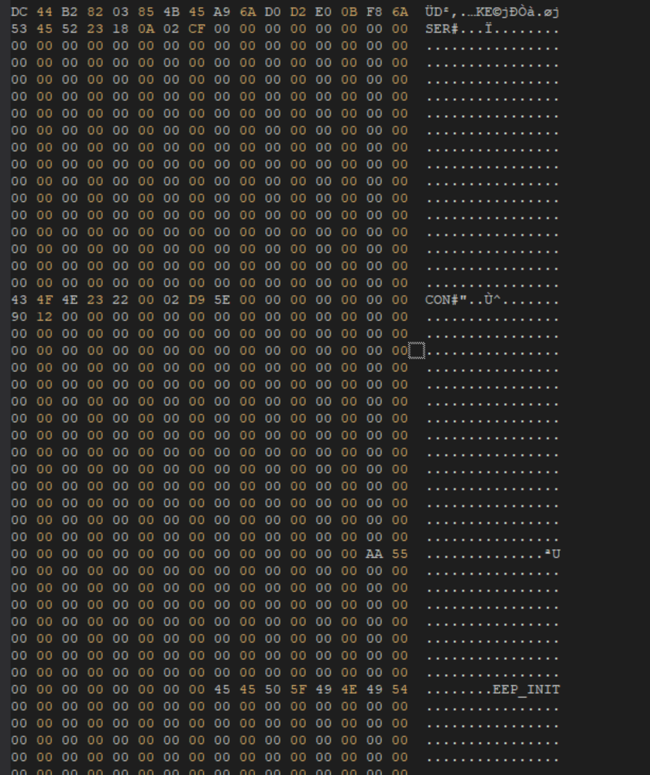

                                    there is an e2e2 flag set, if svp is active (block 6,7). see attachment (mec1503 - read with golden key tool).
                                    • Maxpower3
                                      Bad Veteran
                                      • Feb 2018
                                      • 1358
                                      • France
                                      #558
                                      yes I always clean this area

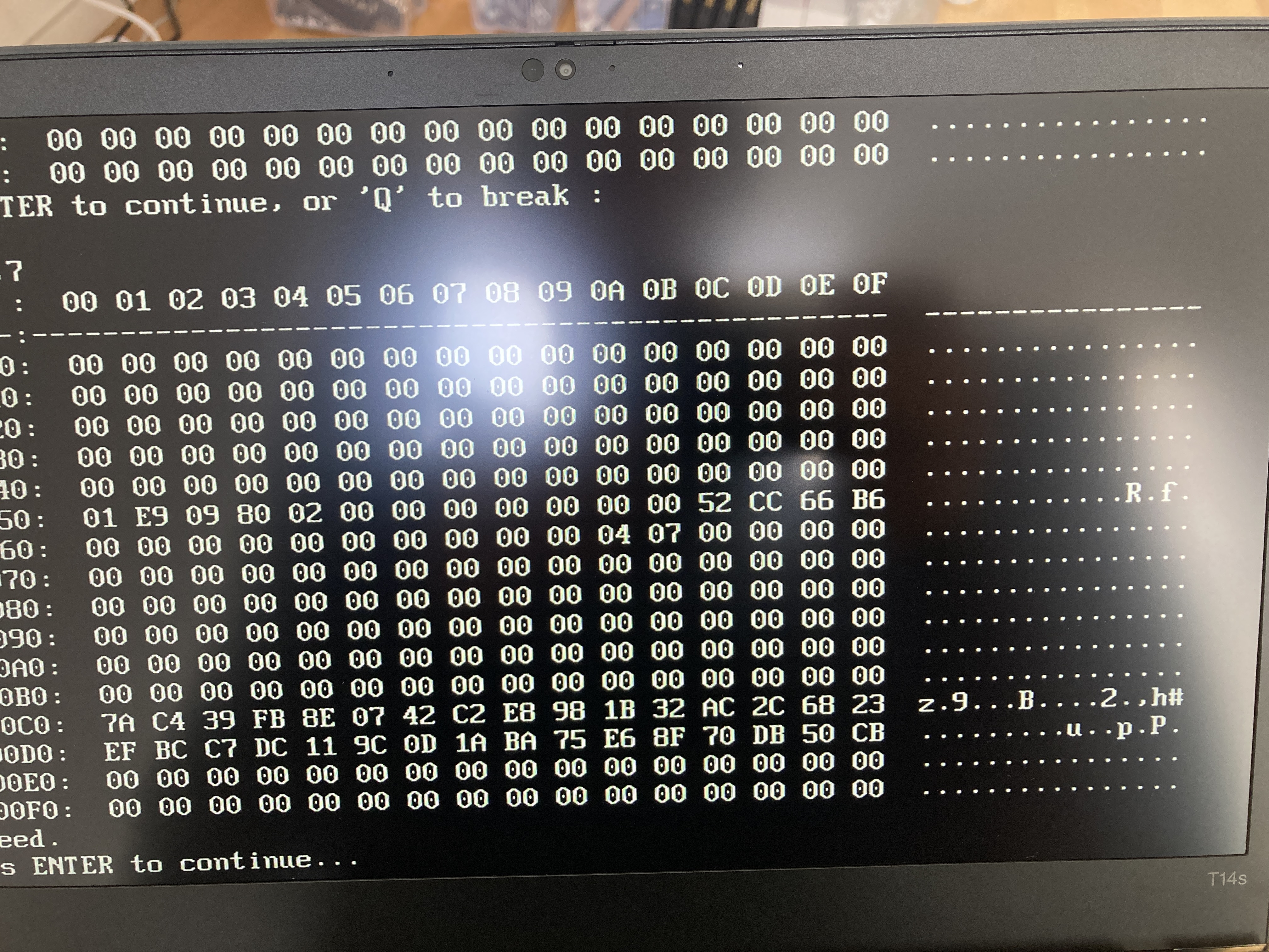

                                        I'm wondering... I didn't succeed with this method on a Lenovo Thinkpad E15 Gen 2 laptop (I could enter the BIOS easily but the double-enter empty password was never saved in my situation). Is there a chance that Lenovo closed this security hole in their BIOS? Should I try to flash an older BIOS before I try this again? Is there any chance or it won't help at all?
