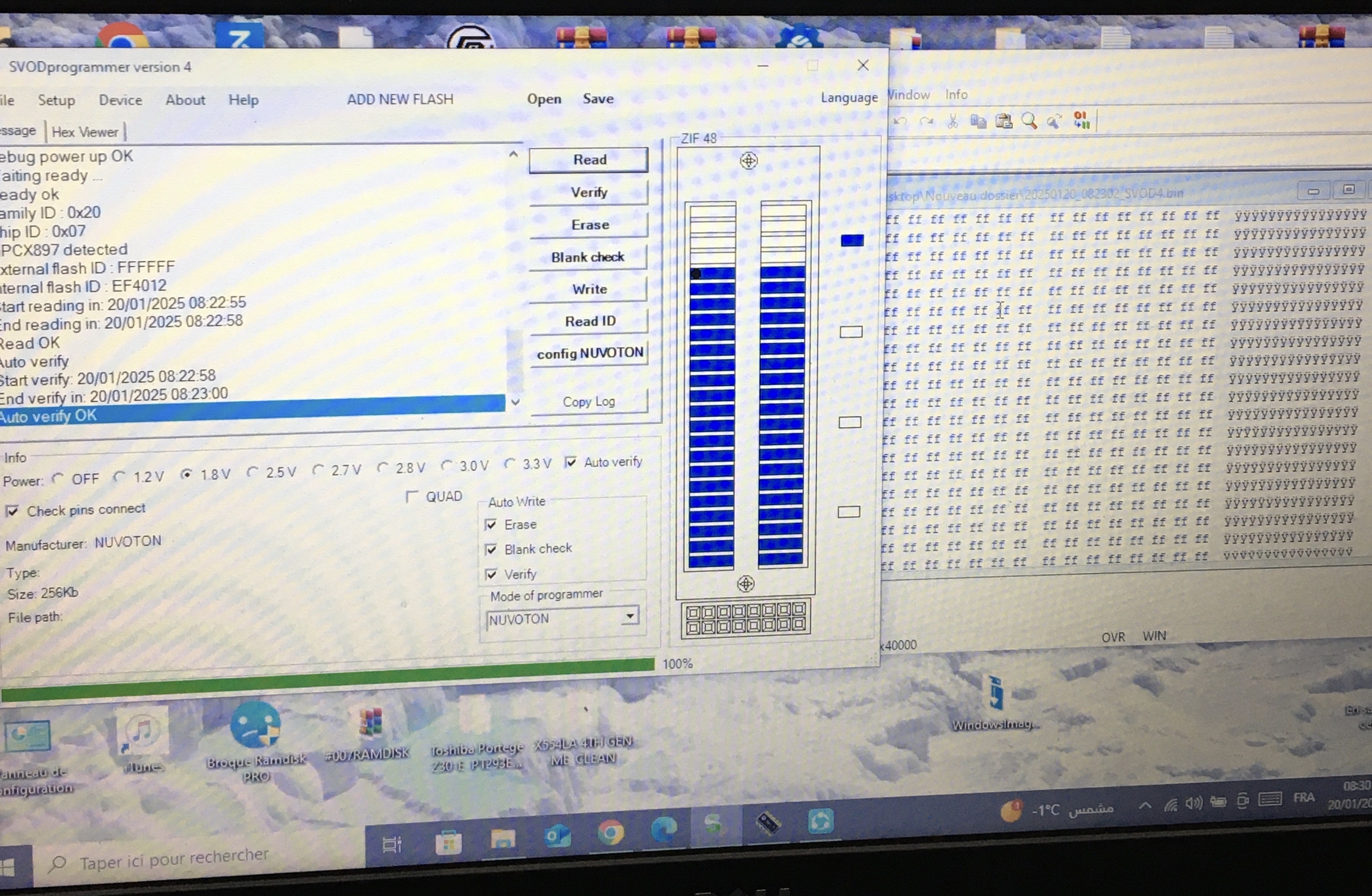

                  • wraster
                    • Jan 2025
                    • 18
                    #609
                    Maxpower3
                    I confirm your genius method is working for T14 gen 1 AMD GT4A1 NM-C801 rev.1.0 Thank you very much!

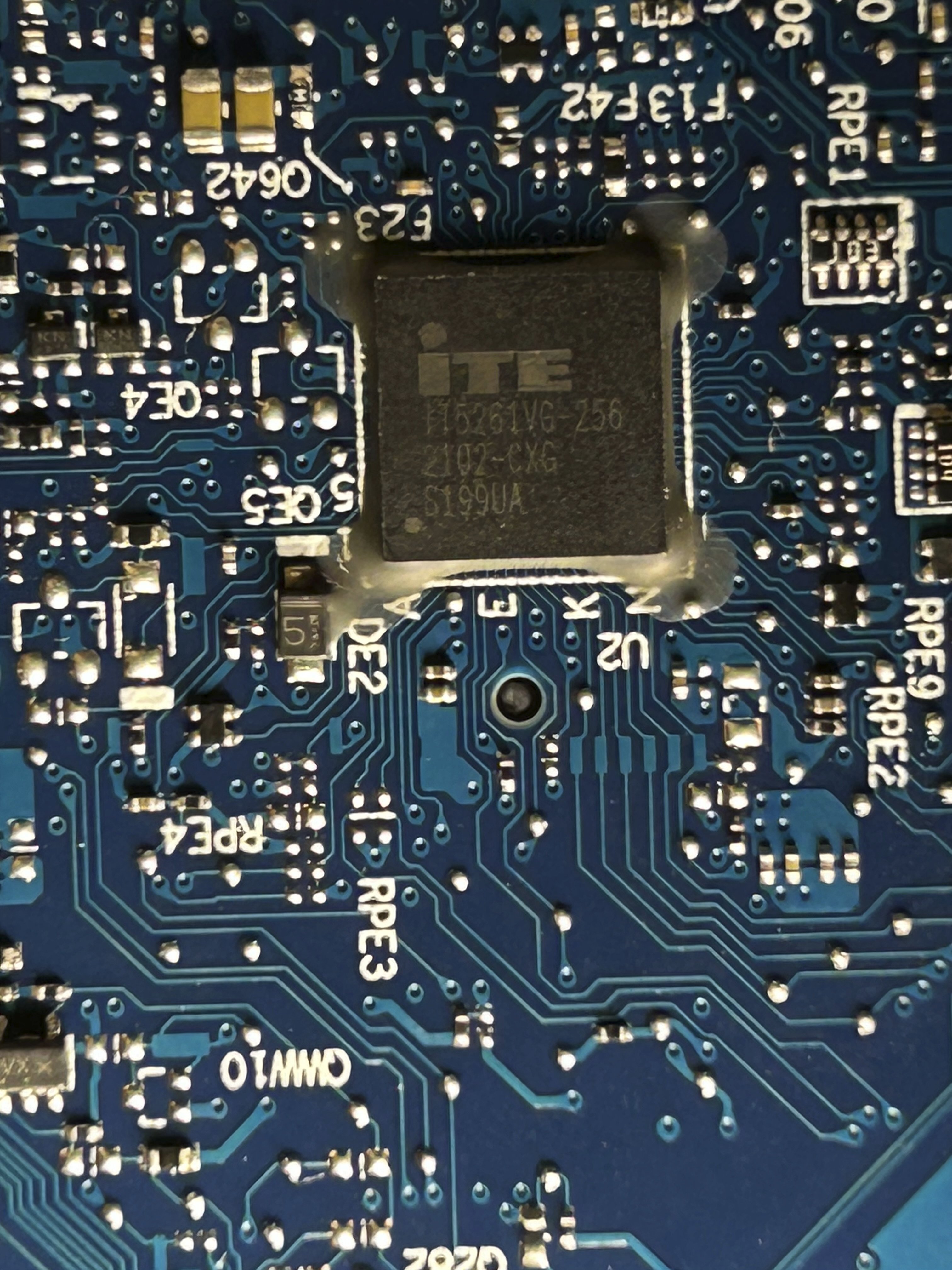

                    volinakis Are you up for sharing a picture of the part of the board that you shorted? I am confused because the ITE IT5261 on mine has some kind of covering-looking thing over it and the pins are not visible. Do you have to use the other side of the board? Or am I looking at the wrong part? Thank you!

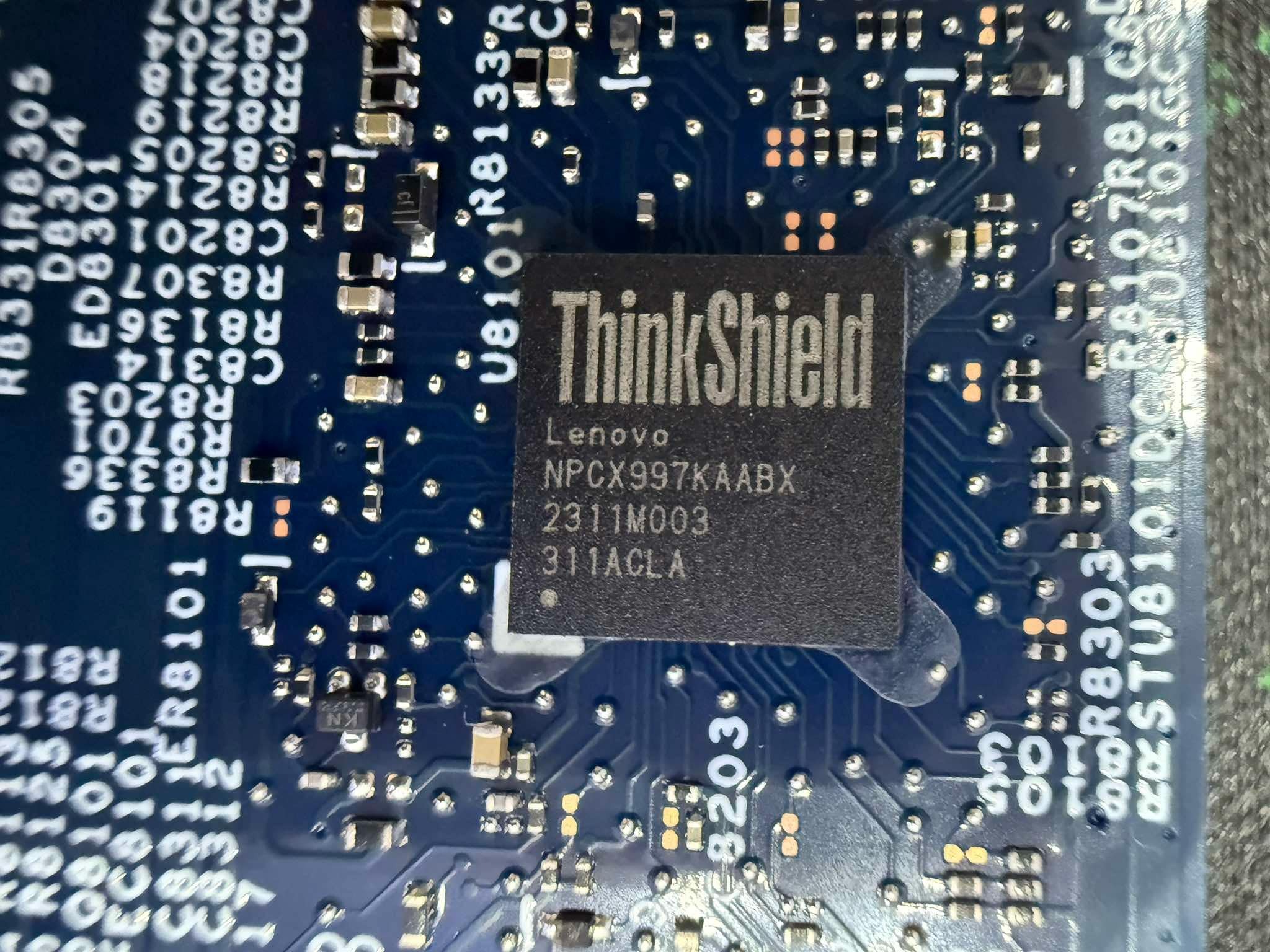

                    • black0hackers
                      • Jul 2020
                      • 369
                      #610
                      P1 Gen 6,
                      Boad code : LCH-3 P MB 223027-1 448 OSR04 0011
                      IO name is NPCX997
                      this one can read? @Maxpower3​?
                      • volinakis
                        • Jan 2021
                        • 2876
                        • N/A
                        #611
                        marked part to ground, as Maxpower3 instructions
