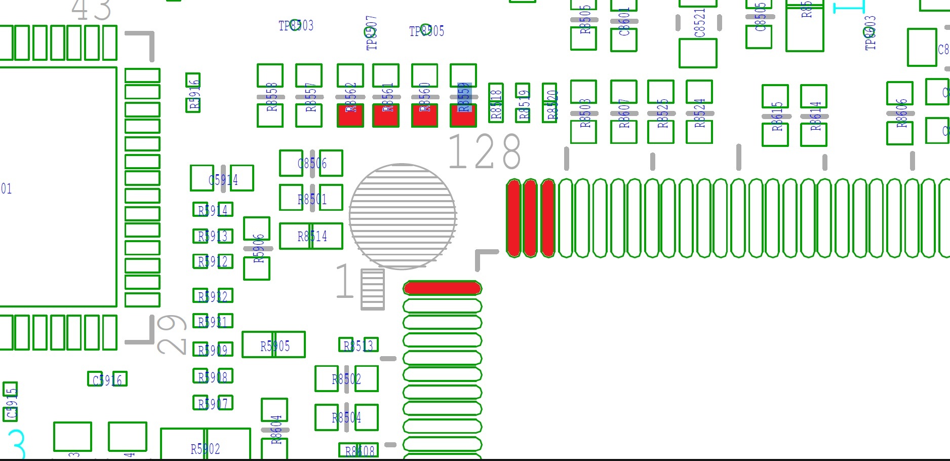

                            #373
                            1 wire to ground on one of the points following 1 or 128/127/126 of your choice
                            at startup as indicated in previous posts
                            EC : NPCE68AP
                            L14/L15 gen1 GL40-GL5A0 NM-C631
                            of course, check that the diagram matches
                            Click image for larger version Name:	Thinkpad L14 GEN 1 - GL40-GL5A0 NM-C631.jpg Views:	0 Size:	372.8 KB ID:	3259076
                            Click image for larger version  Name:	Thinkpad GL40-GL5A0 NM-C631.jpg Views:	1730 Size:	286.4 KB ID:	3259090
                            Click image for larger version  Name:	Thinkpad L14 GEN 1  GL40-GL5A0 NM-C631.jpg Views:	1736 Size:	44.5 KB ID:	3259091
                            Who has now used this technique and is satisfied with it here ??

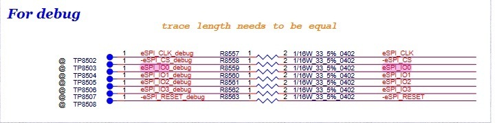

                              Both of you must find schematics and search for words "LAD" and "eSPI"
                              If you found "LAD" is possible
                              If you found "eSPI" is not possible.
                              DEAR Andreasbest I found "ESPI' in NM-D422 it work fine and it is possible , 100% work 😊
                                Yes because it's LAD too.
                                If you found only eSPI it won't work

                                  #376
                                  shorting espi doesn't work, andreasbest is right... mec1503 and mec1723 will never be supported i guess (jtag interface). the jtag interface is software locked.

                                    #377
                                    LAD working
                                    eSPI don't working (After several attempts, the processor shorted died )
