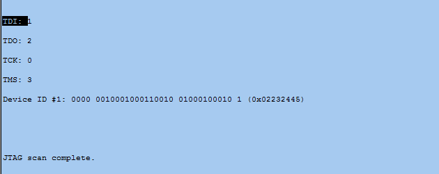

                I managed to activate the JTAG interface by removing resistor R4313 and leaving R4411 (not inserted) in place of R4410 (inserted).
                By doing this you can recognize the MEC1503 on the Vertyanov and the RT809H
                ID found is attached in the image.
                But not everything is perfect.
                In both tools, reading and writing is not done correctly... the EC is recognized, but the flash is being done incorrectly (like it is blocked).
                I'll keep trying, if anyone managed to find anything, and contribute to removing this password, I'd appreciate it.

                        Could you please share some details? Especially, what programmer you were using and what MEC chip you selected in there?
                        I use RT809H and finally was able to get some output from the MEC. Sometimes the expected ID shows up right on the first read attempt, but it is always wrong on the subsequent ones and after 3-5 reads it shows up as 0 and stays that way no matter how many times I try to read or reset. I have to recycle power to get a non-0 ID and even if I do that, it is not always the right one.
                        I removed R4313 to enable JTAG, I moved R4410 to R4411 position to pull JTAG_RESET to Vcc, I added 10k pullups to 4 other JTAG signals.
                        I do not understand the randomness of JTAG output. I suspect this might be because the internal CPU is still active and also controls those JTAG pins since they are shared and the programmer is supposed to stop the CPU.
                        I tried all MECs that RT809H has in the list but none of them work.

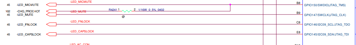

                                    Hi. I googled my motherboard model of my Lenovo P14s Gen2 : HT4B0/HP4B0/HT5B1/HP5B1/HT4B2 NM-D353 Rev: 1.0 and I stumbled on this page.
                                    From what I can see, resetting the supervisor password is not possible at the moment.
                                    However, I was wondering if it is not possible while keeping components on the motherboard. Meaning that if I had the possibility to remove the MEC (or other) component, this might help to find a solution to this problem.
                                    Is there more technical data on what theoretically should be done to remove/reset the supervisor password on these boards? For example, write a specific pattern to an offset in the internal eeprom of the MEC or spoof the data on a communication bus when address range X is being read.
                                    I'm looking for a lead to get my hands dirty with the hardware I have in had.
                                    Thanks!

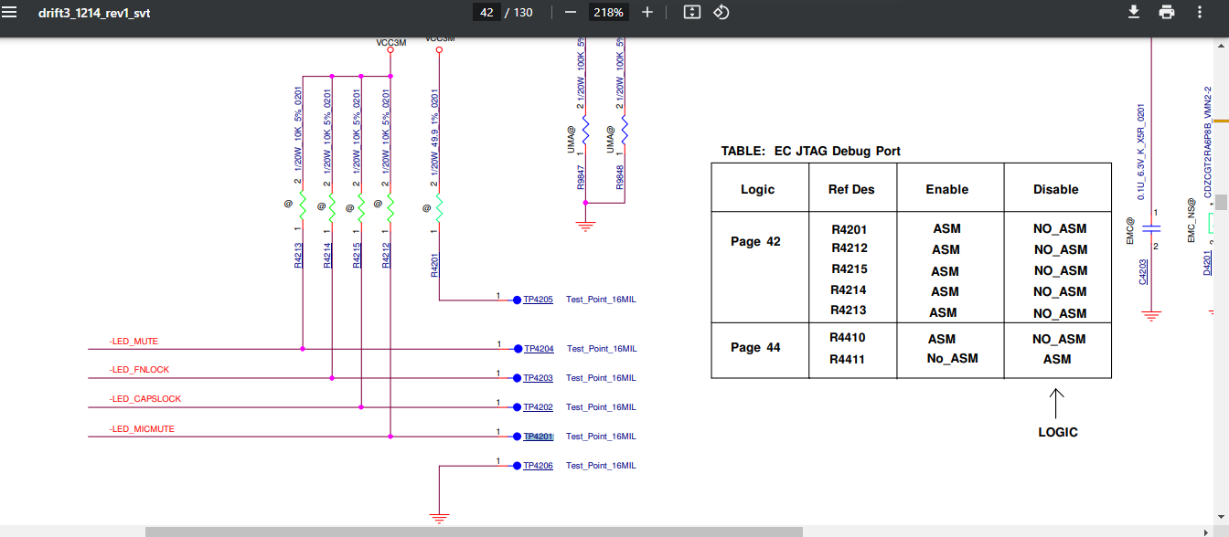

                                      I did a bit more research and found this (see bottom link for source)
                                      Looks like the T15 / T14 / P14 all have similar MEC1503 chips.
                                      I also found the schematics and board layout PDFs while searching to correlate the image found on the other thread
ID:	3229035 Click image for larger version
                                      I then did the rework and plugged in a Segger J Link Plus to it:
                                      However, I do not seem to see the MEC in the JTAG chain. The Segger captures the 0v to 3.3v when I plug in the power supply to the board, but that's about it. The fan on the motherboard spins a few times and the heat pipes eventually become hot (not burning hot, but hot).
                                      Any pointers?
