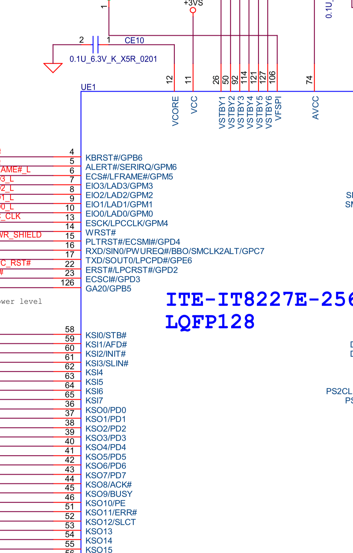

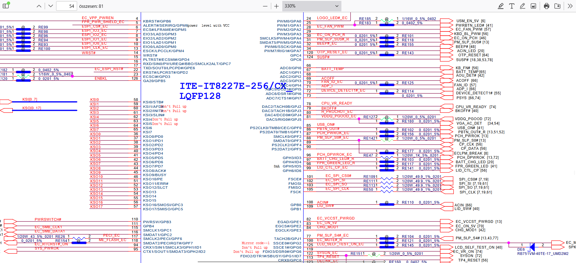

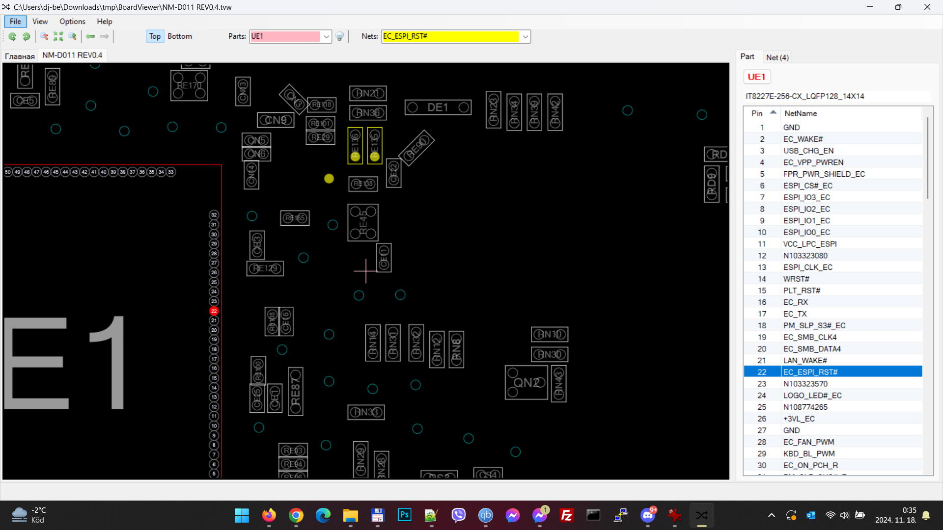

      Hey guys!
      Can you help me identify where to attempt the bios password removal for the Lenovo Thinkpad E15 Gen2?
      It has the IT8227E EC chip. I'm attaching the board view and the schematics. Is the EC_ESPI_RST the correct point to short to ground?

        Originally posted by szepesif
        Hey guys!
        If it's eSPI then it's not possible with short, you will damage the cpu.

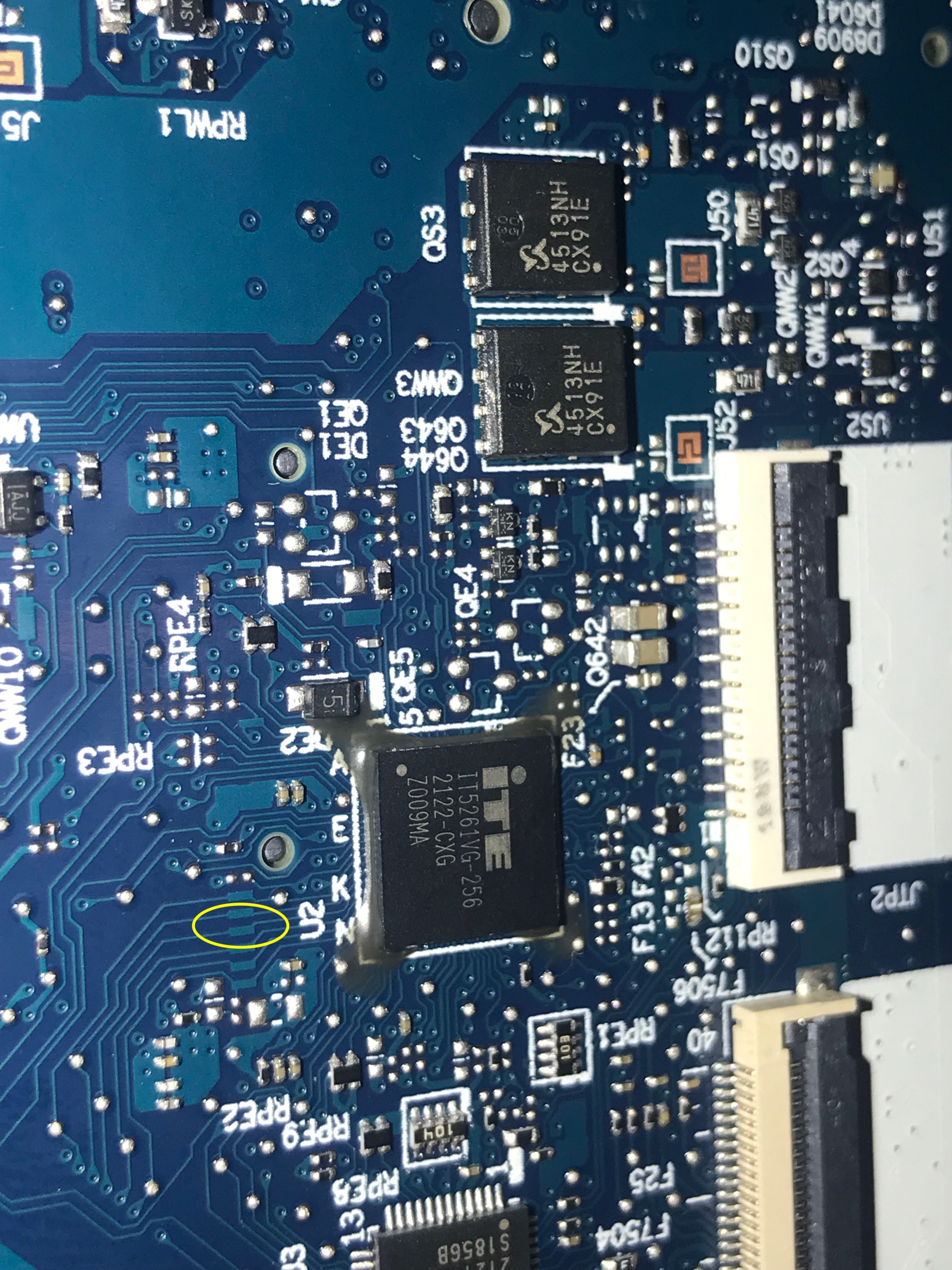

                • fernandoalonso
                  • Sep 2023
                  • 2
                  #508
                  Maxpower3
                  I confirm your genius method is working for T14 gen 1 AMD GT4A1 NM-C801 rev.1.0 Thank you very much!
                  Hello Volinakis,
                  How did you find the correct pins on the NM-C801 to short the EC? Any help is appreciated.
                  Best regards

                    #509
                    Originally posted by fernandoalonso
                    Hello Volinakis,
                    Best regards
                    one of them to the ground

                      #510
                      Originally posted by Stefan Steff
                      I think that board in the zip file is a E15 Gen 3 not Gen 2...and yes it has an IT8227 with LPC
                      So I can try shorting any of the LAD(0-3) lines with ground without killing my CPU?

                        #511
                        Short those signal cannot kill your CPU but these are too small so you may ended up shorting other signals that can kill your CPU. So be careful.

                            • fernandoalonso
                              • Sep 2023
                              • 2
                              #514
                              Hello!
                              I can confirm that the method works on T14 Gen 1 AMD, NM-C801 with ITE IT5261-VG EC chip. After consulting the boardview file, I found out that the LPC_AD0 to LPC_AD3 pins are accessible through some test points and I used them, so that I did not have to cut open the PCB paint layer. The timing is tedious, but it definitely works and it works really well - even my machine serials are preserved. Thank you for your help on this matter. Thanks to Maxpower3 for his genius method. Boardview is attached below if anyone needs it.
