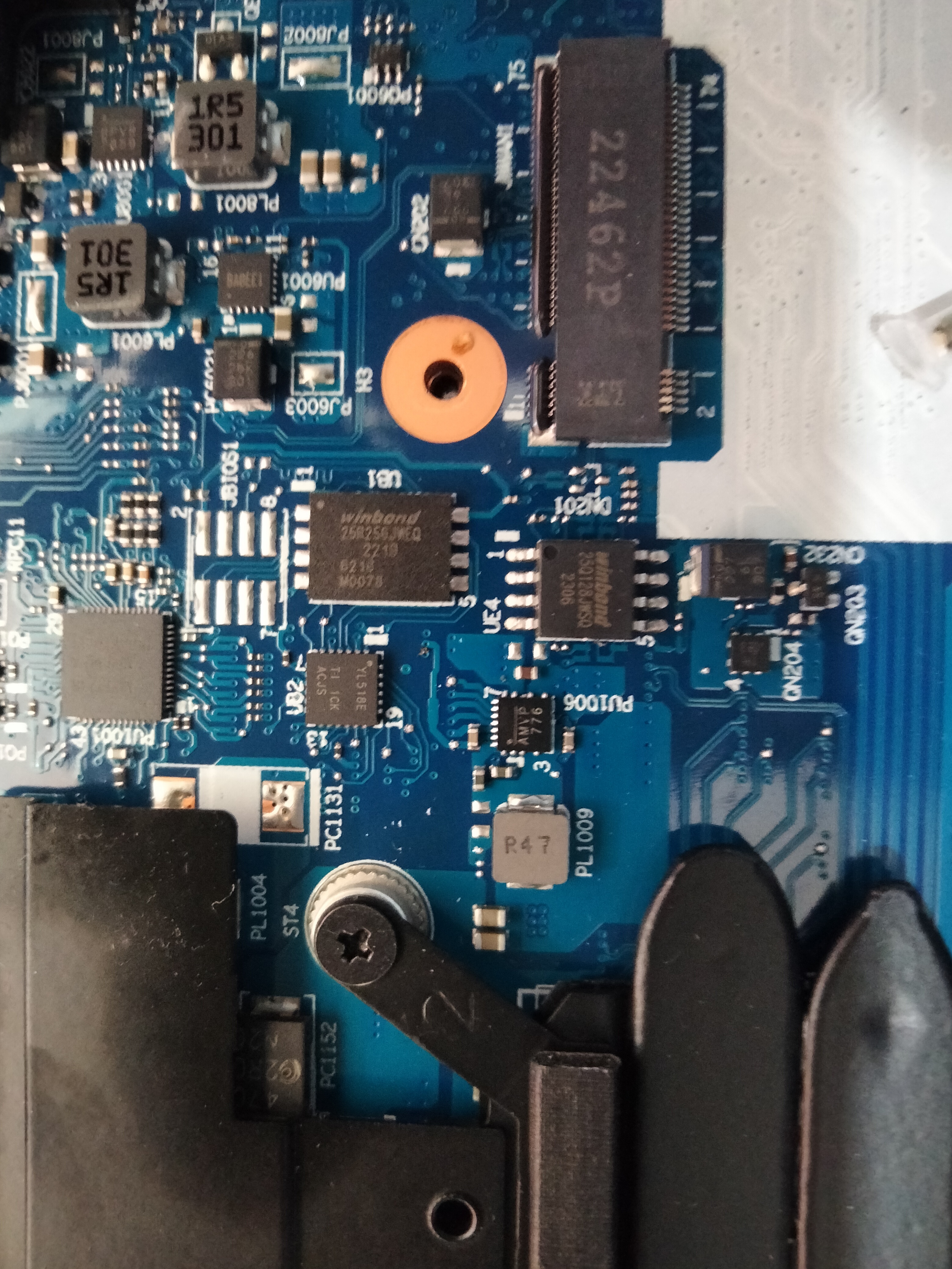

    I mean the model of the EC chip on the motherboard.
    You motherboard color must be blue (green is for Intel CPU) so if i'm correct the EC chip should be on the bottom side so you must diassemble it.
    • sam2929
      • Apr 2024
      • 5
      • algeria
      #322
      ​​​​​​There is 2 winbond

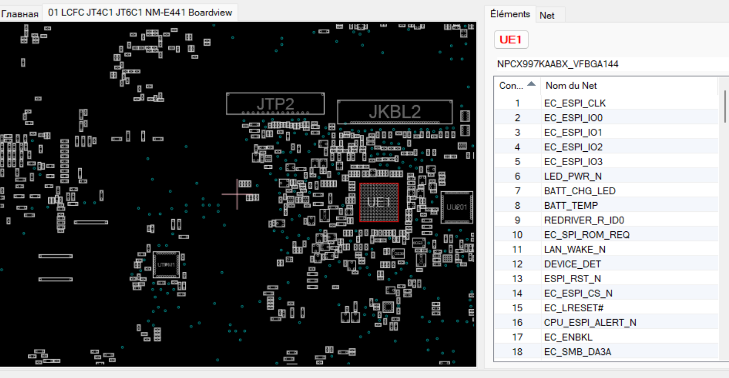

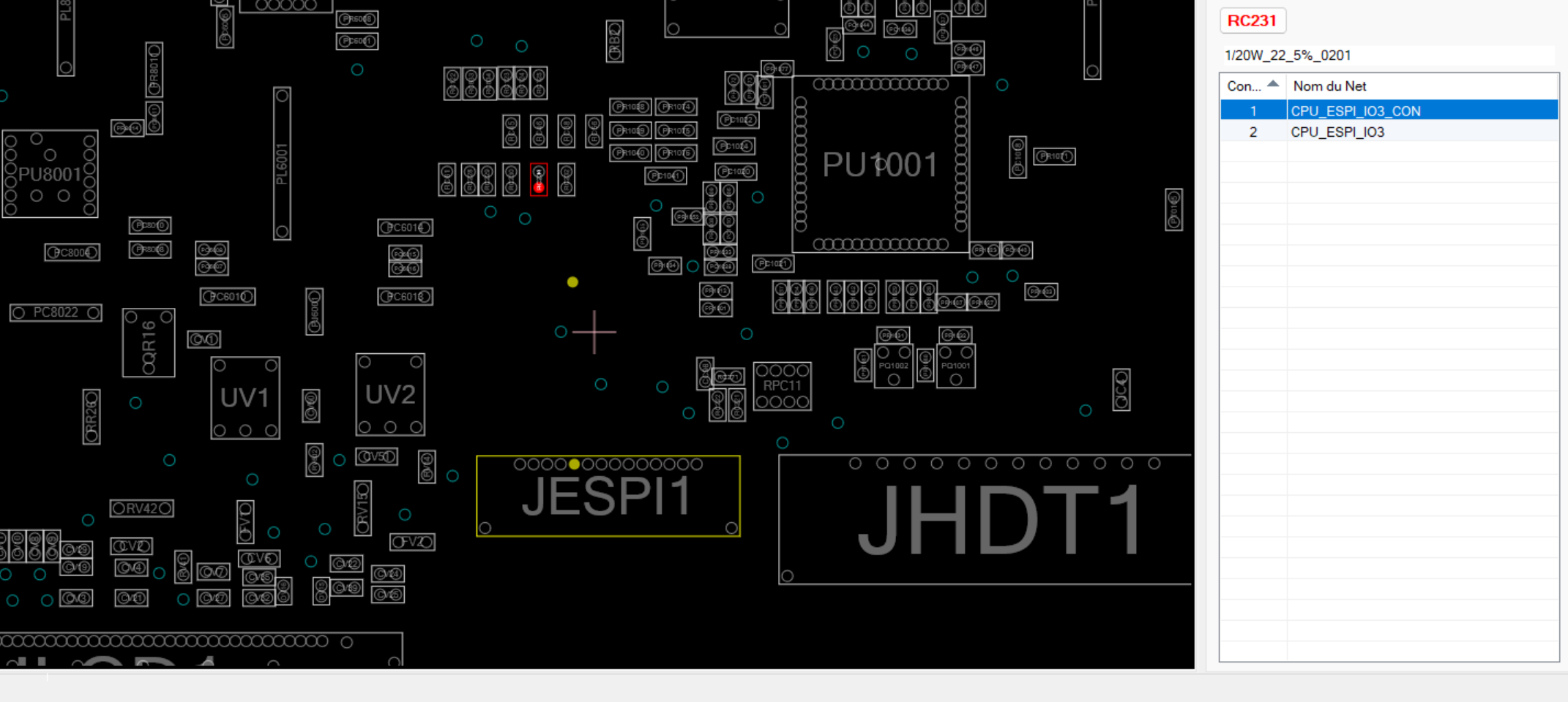

        Cliquez sur l'image pour la voir en taille r?elleÃÃà  Nom : 		image.pngÃÃà Affichages :	0ÃÃà Taille :		355,0 KoÃÃà ID : 			3338343
        NM-E441
        https://www.badcaps.net/forum/troubl...-0#post3273315
        Cliquez sur l'image pour la voir en taille r?elle   Nom : 		image.png  Affichages :	0  Taille :		416,2 Ko  ID : 			3338345
        • Andreasbest
          • Aug 2014
          • 1218
          • Hellas ( Greece )
          #324
          As correctly Max indicated, i's eSPI, no free solution yet.

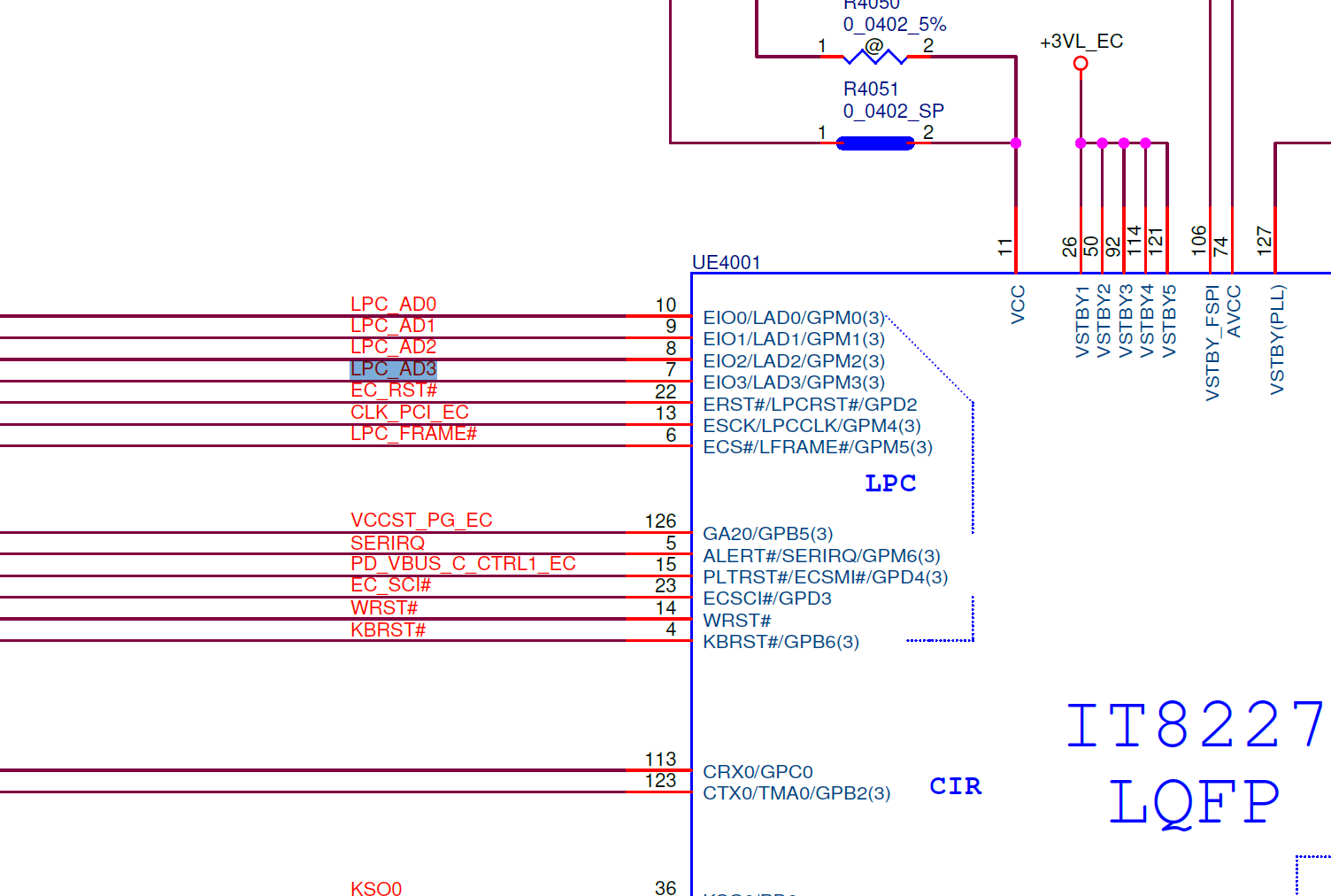

                I happened to have a Thinkpad E590 which is BIOS locked.locked. Laptop have IT8227-256 chip...
                Question:
                1: can you please xonfirm this method works?
                2- if so, can you please confirm I need to short eithernpinn7 or 8 or 9 or 10nof that chip? From a first overlook they do not seem to be connected but, maybe, there is a via on the board. Also these pins shall go to an EC and TPM debug port but I cannot find that port...
                Any help is warmly welcome!
                Thanks!

                  #328
                  Originally posted by kicker12
                  Hey!
                  #1 -> thanks a lot for the noce job all of you (and especially Maxpower3) are doing. :-)
                  Question:
                  Thanks!
                  Cliquez sur l'image pour la voir en taille r?elle   Nom : 		image.png  Affichages :	0  Taille :		164,5 Ko  ID : 			3340186
                  https://www.badcaps.net/forum/troubl...14#post3238014
                  link not work
                  not tested, try
                  yes 7/8/9/10 ​
                  if you have the bios provide it for test with the serial number of the laptop.
                  Not sure it works ITE
                  https://www.badcaps.net/forum/troubl...55#post3312755

                        Hello everyone.
                        Here is the bypass solution for several Lenovo ECs.
                        This has worked on many ECs.
                        Only works if password is contained in EC
                        I succeeded on many models
                        https://www.badcaps.net/forum/troubl...86#post3217086
                        https://www.youtube.com/channel/UCeF...t_adKcguvynjeA
                        I shorten the LPC bus, with the LAD0:3 and Gnd.
                        you can use the dedicated ports where you connect directly to the track.
                        (Be careful, resistors may be missing on the path)
                        look at the diagrams
