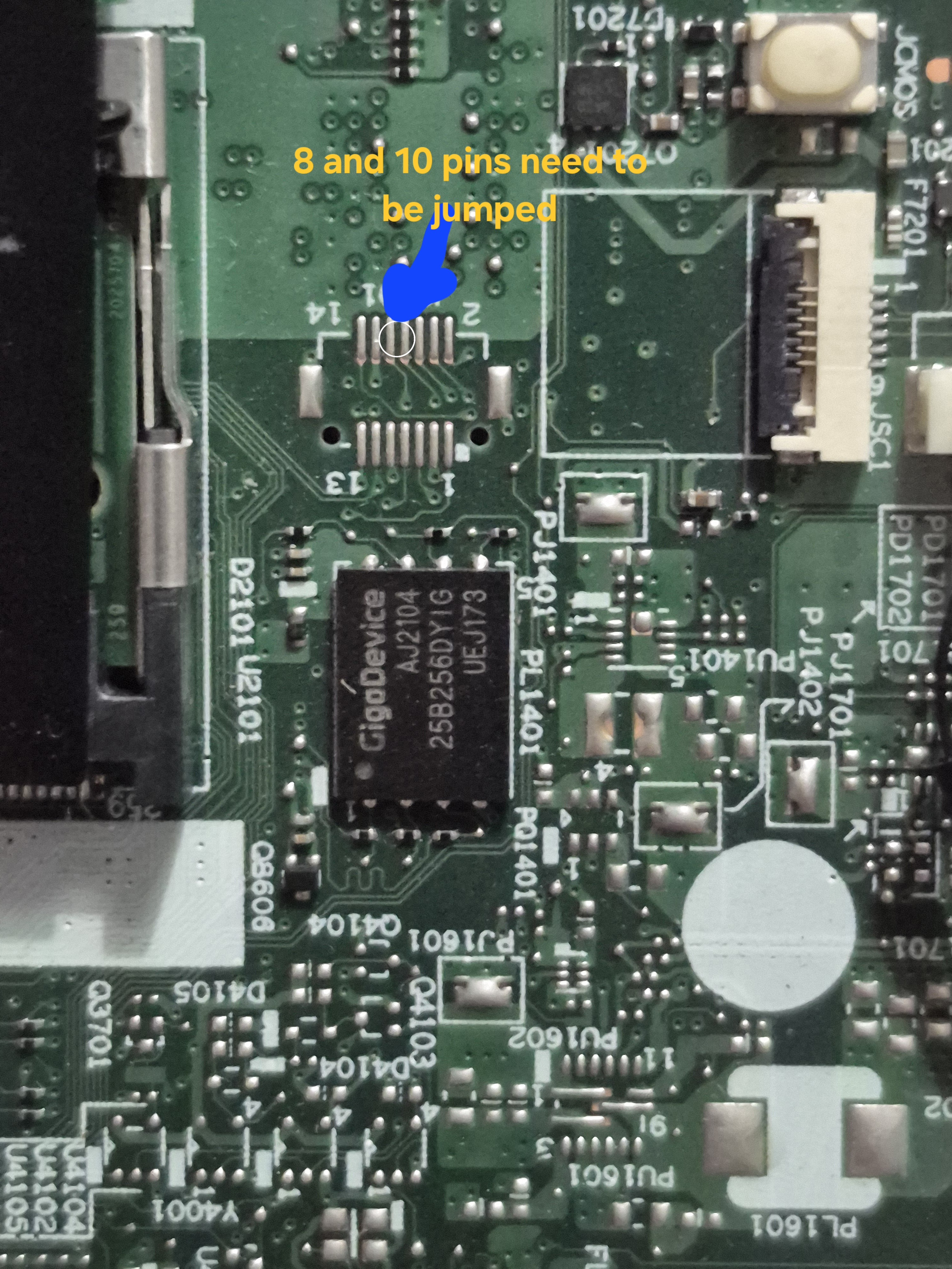

            ¿Puede alguien marcar los puntos a tocar en la imagen? Sería más facil de entender, ya que soy principiante.Can anyone mark the dots to touch on in the image? It would be easier to understand, as I am a beginner.
            • Geromen
              • Mar 2025
              • 7
              • Dominican Republic
              #666

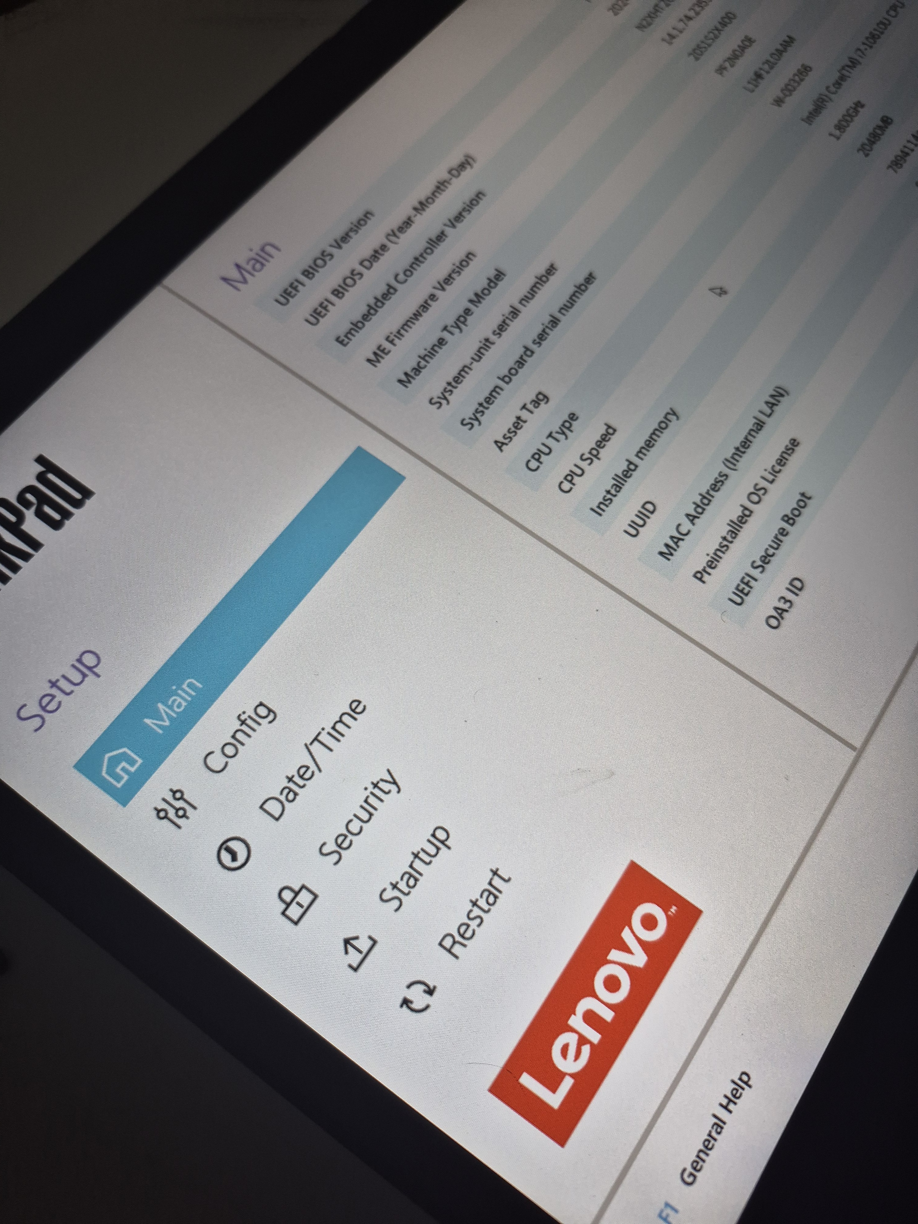

              IT WORKED ON THINKPAD T14 I7-10610U.
              The pin order is as follows:
              1. Where number 14 is located, that is pin 14. The others in the same line are 12, 10, 8, 6, 4, and 2 (2 is also marked on the motherboard).
              2. Where number 13 is located, that is pin 13. The others in the same line are 11, 9, 7, 5, 3, and 1 (1 is also marked on the motherboard).
              Procedure:
              Use a clip to short pins 8 and 10.
              Power on the laptop, hold the short for a moment, then release and press F1.
              If the keyboard doesn’t work, use a USB keyboard.
              Once inside the BIOS, remove all passwords (leave them blank).
              Save the changes and reboot using Ctrl + Alt + Delete.

                  #668
                  Hello, I have a T14 Gen1. I've been trying all day to clear the SV password using pins 4, 6, 8, and 10.
                  Currently, I only get the startup logo, and after a short while, the laptop shuts down.
                  Can anyone help me with the best way to do this and get my notebook back up and running?

                        #671
                        Originally posted by dino44
                        Lenovo T14 gen1
                        20S1-S1UJJ00
                        serial number: PF-2ZQCB2
                        Board: NM-C931 rev.1
                        Gotta start shorting early on MEC1663. Listen to the coils whining noise, as soon as you hear it, short pin 8 to GND for 1-2 sec. Before you see any image. I also used external screen with internal disconnected and external keyboard. And use ALT+CTRL+DEL to restart and try over and over. You'll get it eventually.
                        Also I used a tape to cover every other pin except for #8 to save myself a headache of accidentally shorting 2 pins next to each other.
