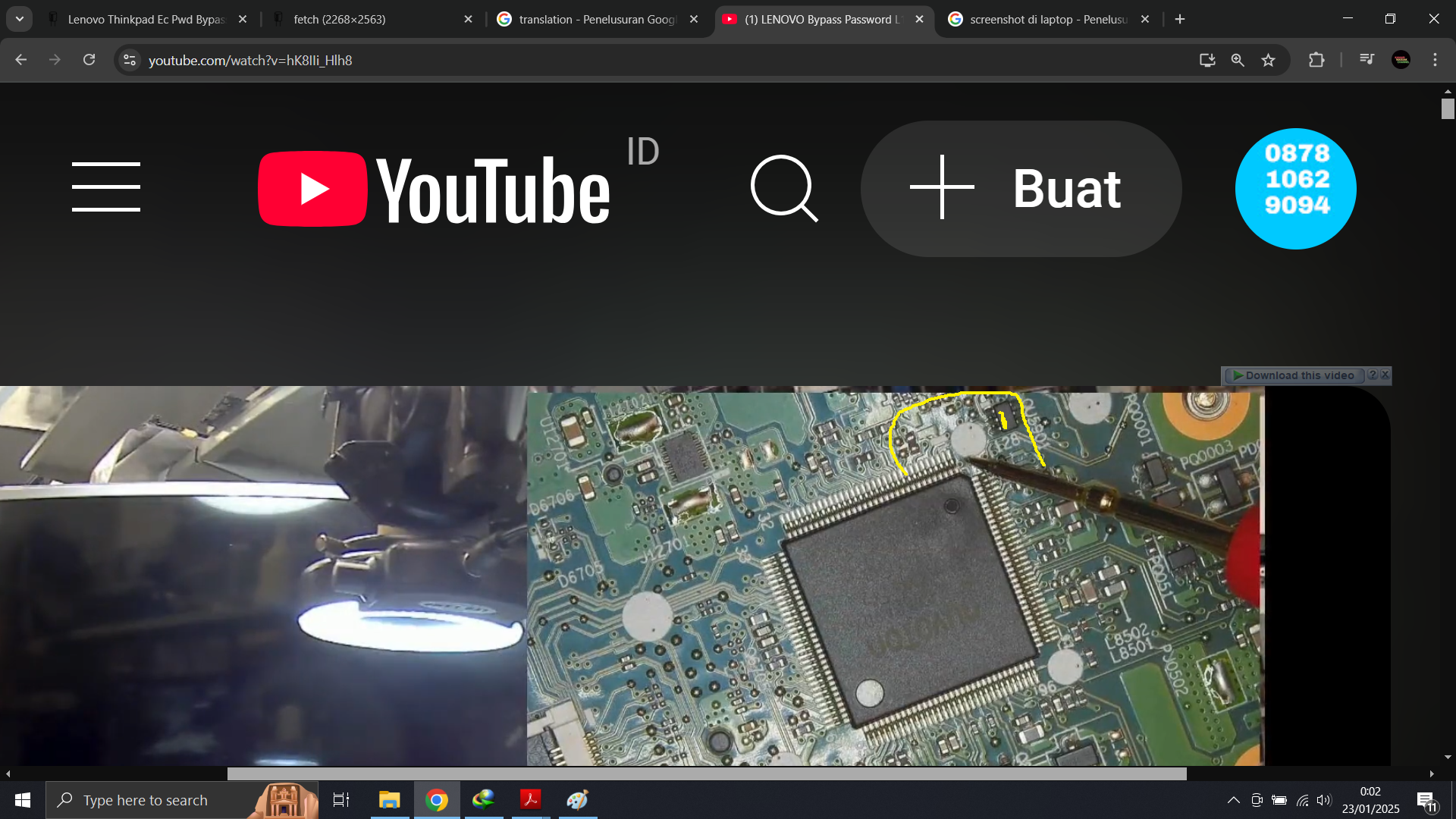

    you're talking about my video L13 Gen2, you left a comment??
    at the beginning for the suspense, I didn't show,
    I did with switch
    not in the video, I'm just curious because it wasn't from the start.
    now I wonder why the e14 g2 i5 gen 11 and l14 i5 gen 11 didn't work while for amd it worked​

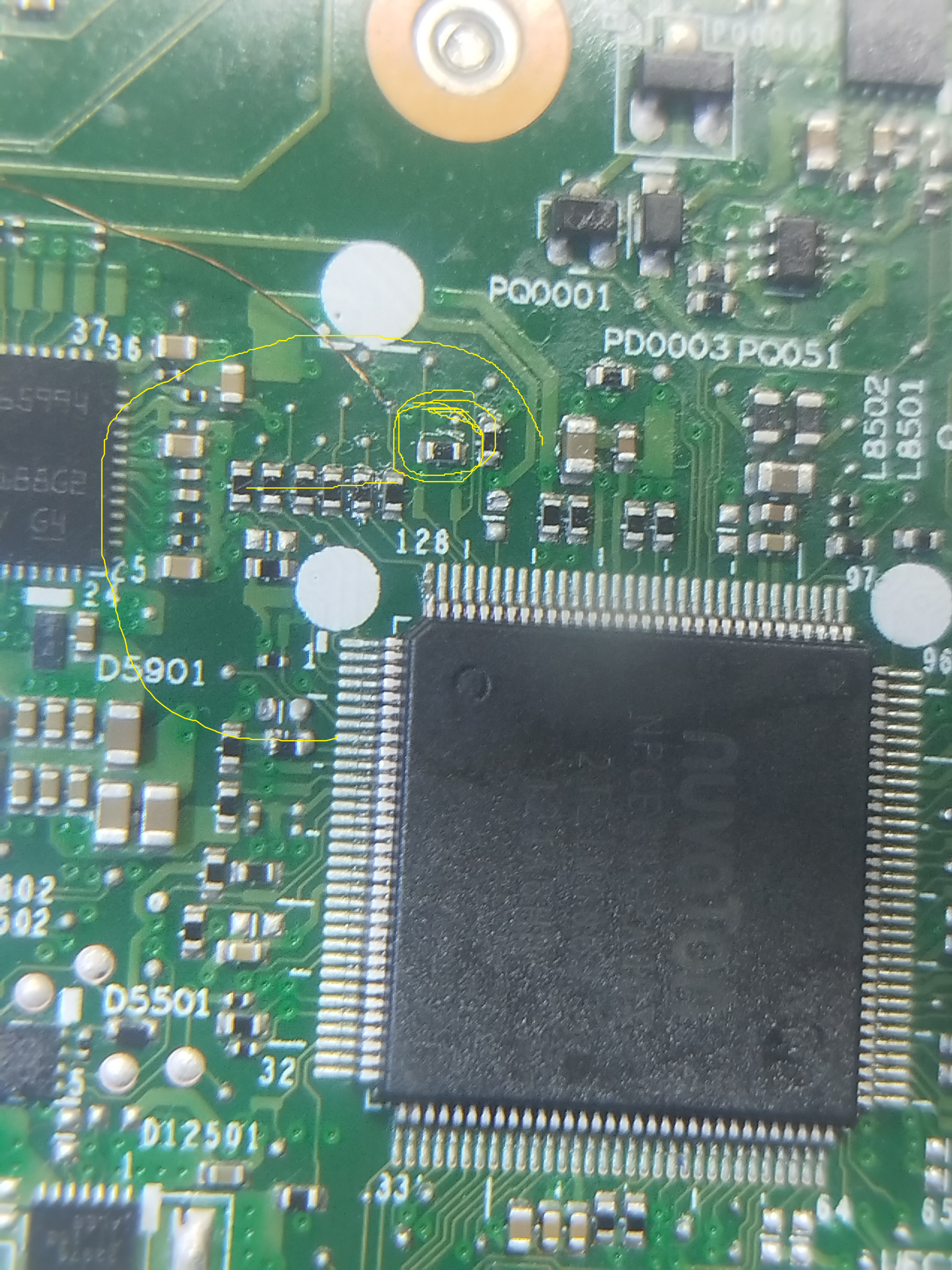

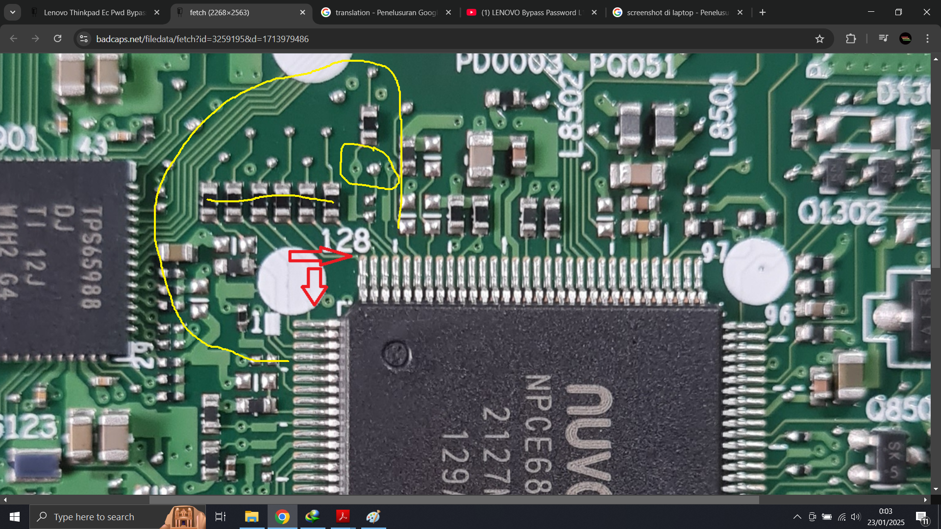

        marked part to ground, as Maxpower3 instructions
        Thanks very much.
        Can you help me learn how you knew that is the 0-3 LAD trace? I am just starting to learn to translate board diagrams. In the attached schematic LAD0:3 are labeled K1, J2, J1, H2, and overlapping the trace you marked on the board are the letters "K" and "U2". Are all of the LAD wires bundled together in that trace, or the entire LPC bus? I see that there are many fewer traces on the board than are connections in the diagram.
        Link to schematic - https://www.badcaps.net/forum/troubl...v1-0-schematic
        Another question I have is, how exactly do you short it? Just touch the top of the trace right there where you marked with my grounded conductor?
        I really appreciate it, this is very interesting to me.

          look at the boardview of NM-C801. Use a switch, as you can see in Maxpower3 instructions or other users photos.

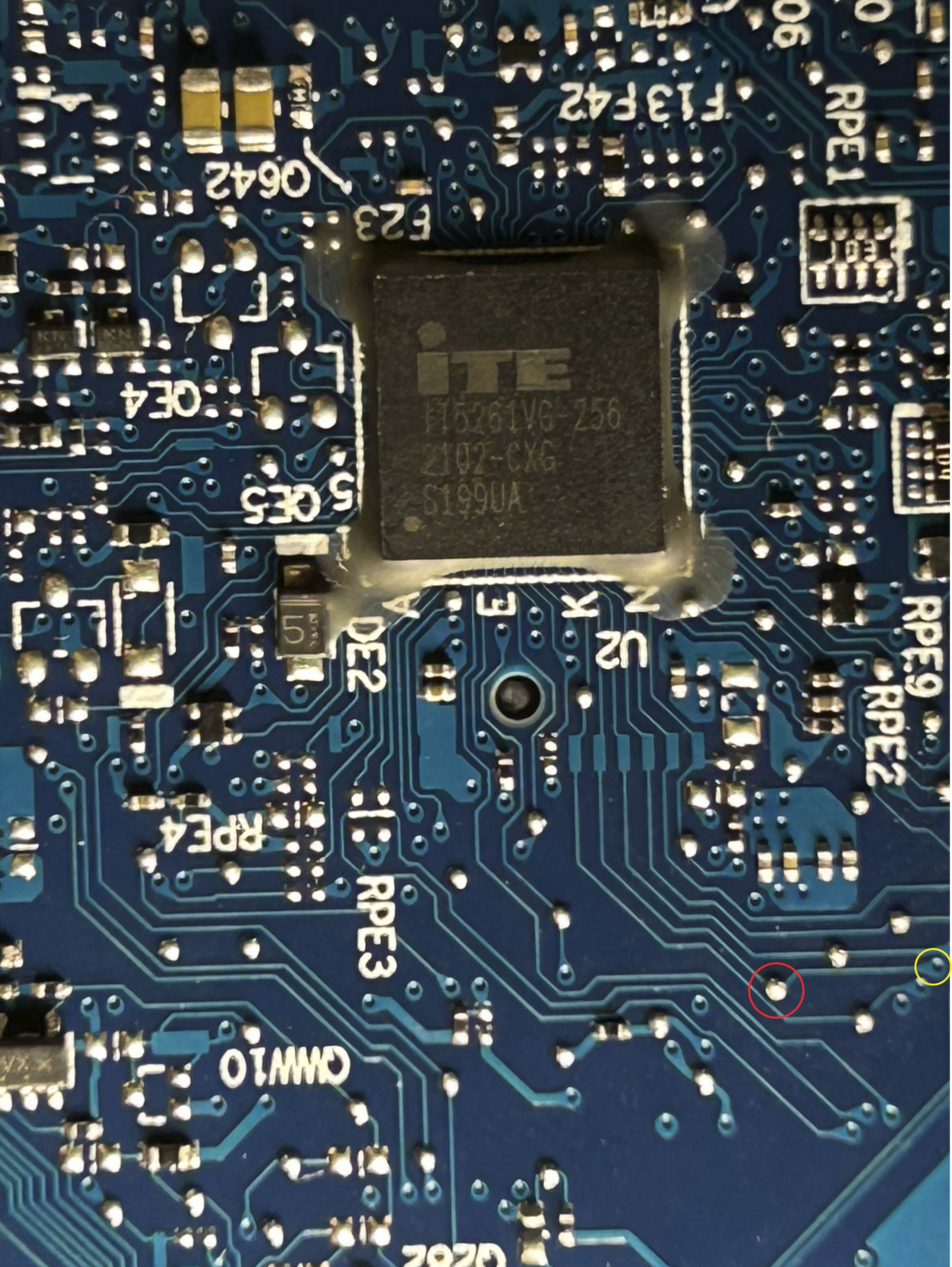

              It would help me understand to have answers to the questions I asked. I am trying to find the information I need to understand Maxpower3's instructions (I am unfamiliar with many of these terms and acronyms and am piecing it together). For example I don't know what you mean by "use a switch" (what is a switch in this context?). If anyone else can help answer my questions I would appreciate the help! Also/alternatively, do you know of a good reference for these things? Like how to translate the boardview to the board.
              In the attached pic of the chip and board region, does either the red circle or yellow circle contain the actual location of where one would touch the board to short the LPC bus?
              I see my attachment didn't work in my previous post, trying again here. I think this is what you refer to by boardview.

                #627
                Click image for larger version  Name:	image.png Views:	0 Size:	2.84 MB ID:	3553923
                lad 0​ or 1/2/3
                look
                  You would understand if you read previous posts, in post 603 you have a pic with "switch". Boardview is a schematic containing print of circuit board and components placed on board, google should answer to this question ... You can find boardview searching on this forum for "NM-C801 schematic". ALL INFORMATIONS are here, in this forum, but you want to be given to you instead of looking for them ...

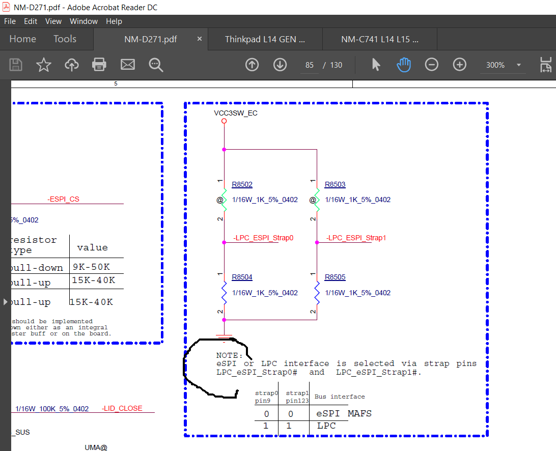

                    @mahendra938
                    hy max, what are doing to LENOVO L13 Gen2 Nuvoton NCPE68B , I see you don't do grounding
                    sorry, I got confused.
                    sorry I don't want to confuse you, now I don't discuss what in your video I already understand.
                    now my question,
                    d lenovo e14/e15 G2 amd this method works.
                    l14/l15 g2 amd also works.
                    but this method is not working
                    on e14/e15 g2 intel and l14/l15 g2 intel.
                    even though it is only different from LPC and ESPI.
                    In the schematic, there are LPC and ESPI modes, how to change them​

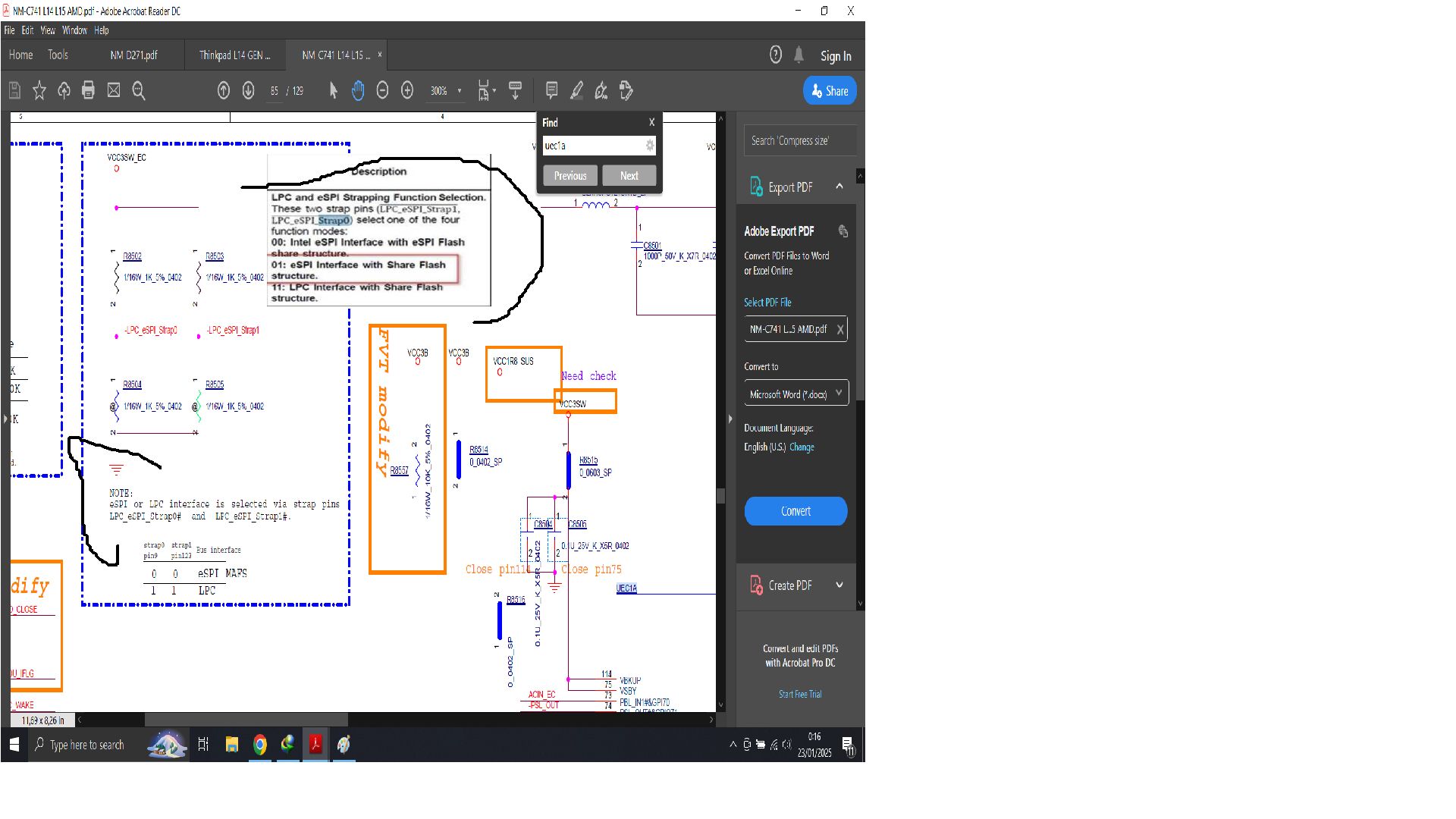

                      NPCE68BPA0DX Lad Pin 126-127-128 or 1 of EC
                      This doesn't work max, there is a difference in the cascitor installed with L14 gen 1.
                      check pins 125 and 124 on l14 g1 and l14 g2.
                      is it necessary to remove the connecting resistor at pins 124 and 125 of l14 G2​

                        I have attached the differences
ID:	3554532 Click image for larger version
                        IIClick image for larger version
Name:	max bypass l14 AMD.png
ID:	3554529Click image for larger version
ID:	3554530 Click image for larger version
                          you can try!
                          for me it doesn't work,
                          Espi is in Pch.
                          some killed processors or motherboard while playing with espi
