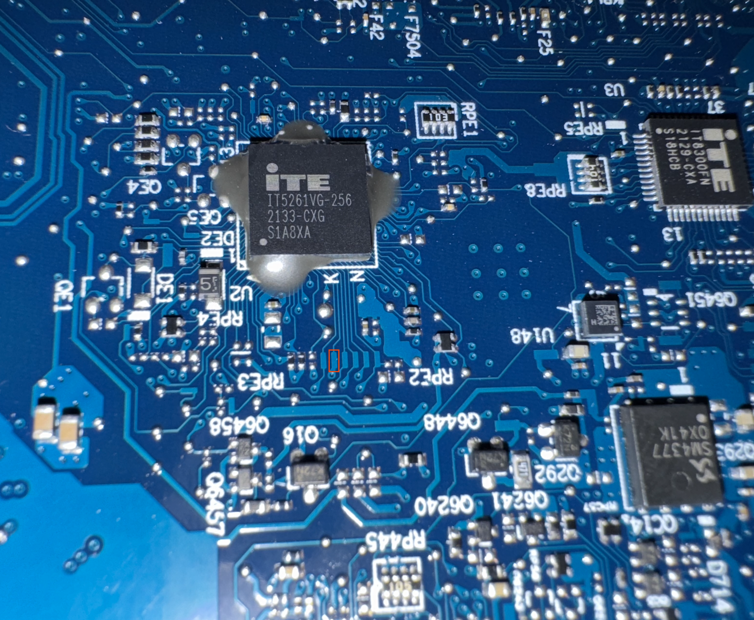

                      Hell guys i did it! 😃
                      Lenovo E15 G2 AMD Ryzen 4500U
                      GE420/520 NM-C771 Rev 1.0
                      20T8-000VGE​
                      IT8227E-256 2048-CXA S16TCB (<- the bastard is on the PCB backside covered under protective tape film)
                      winbond 25Q128JWSQ 2046
                      Needed around 30-40 tries to get it to work on Pin 7-10.
                      Left a little tip for the team. THX for this great forum and Maxpower3 for sharing! 💝

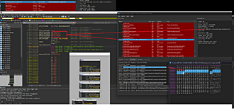

Name:	self healing.png
                              Do you have any ideas for checking the keys?
                              We notice here that the automatic repair (Self Healing) is linked to the verification of the Phoenix keys.
                              We know how to calculate it for older AMDs with SHA256,
                              but I can't find Intel.
                              I looked on other forums too, and I found information for older models.
                              https://www.insanelymac.com/forum/to...eps-on-lenovo/
                              • rediii

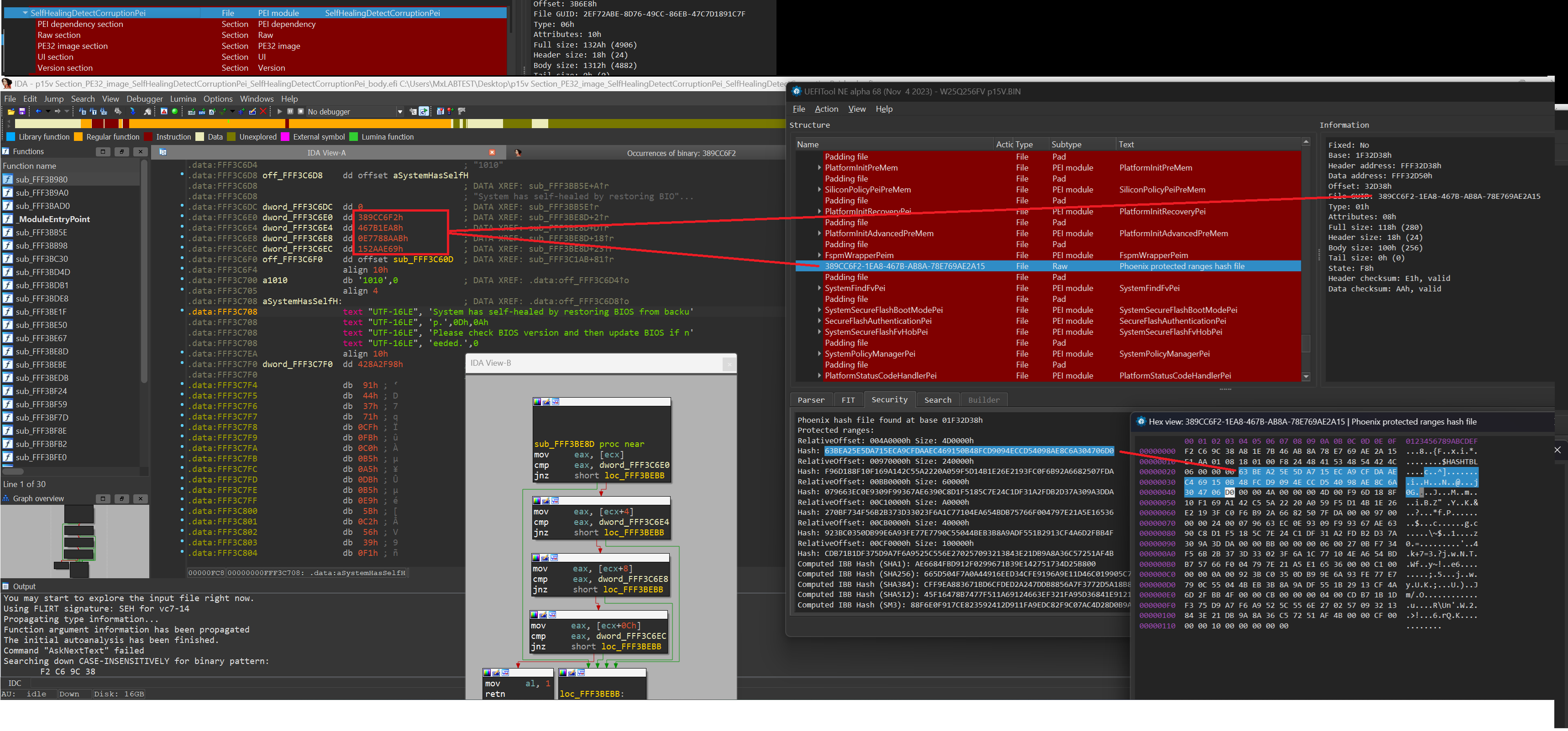

                                Click image for larger version  Name:	self healing.png Views:	79 Size:	1.10 MB ID:	3659691
                                Click image for larger version  Name:	image.png Views:	66 Size:	747.1 KB ID:	3659692
                                why are you looking for these keys? By the way, there is a new version of the UEFI tool.

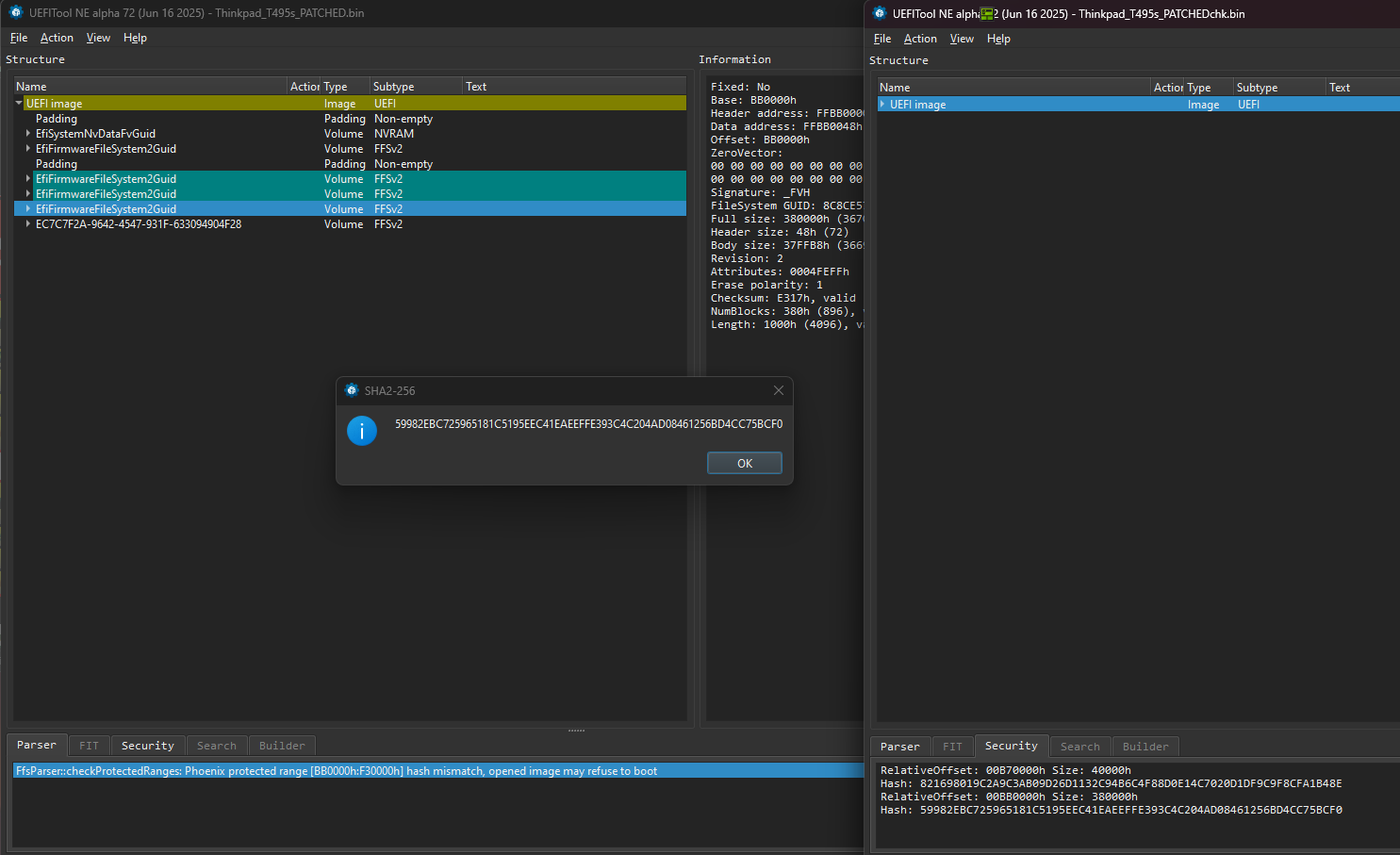

                                  thanks for uefitools. practice calculating hashes
                                  No more need for hxd
