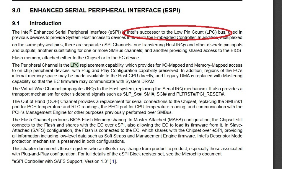

      but my tests failed with the Mec1503
      The LPC bus is no longer used, it has been replaced by eSPI
      Thank you MxP
      Yesterday I discovered what you posted, I immediately realized the solution and thought straight to Mec1503
      What is the difference between eSPI and LPC? Only speed?

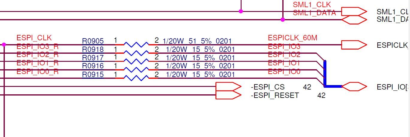

        • CraterM
          • Mar 2018
          • 180
          • Moldova
          On the diagram, communication is identical!

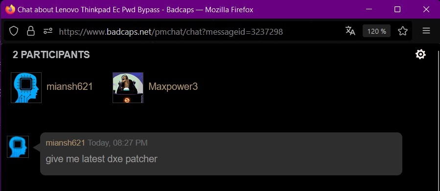

                • Maxpower3
                  Bad Veteran
                  • Feb 2018
                  • 1352
                  • France
                  Hello, Please, Thanks Lost in space .....?
                  it's over DXE

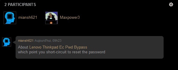

                          • pakistan
                          which point you short circuit to reset the password
                          • Maxpower3
                            Bad Veteran
                            • Feb 2018
                            • 1352
                            • France
                            afterwards people ask me why I don't want to share.
                            Damn, make an effort and look for everything indicated.​
                            stop private messages without any form of politeness too

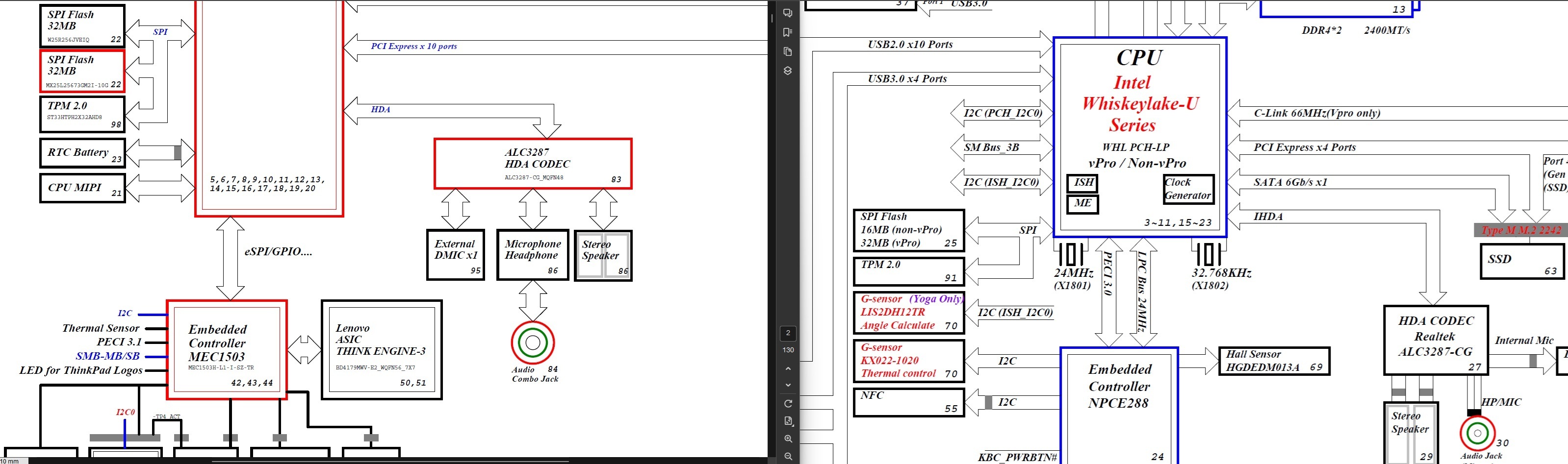

                                Originally posted by RethoricalCheese
                                Like I said, tested on P53 and P1 gen 2, thus works fine on ncpx.
                                find schematics or boardview
