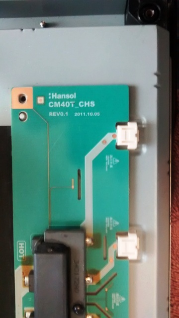

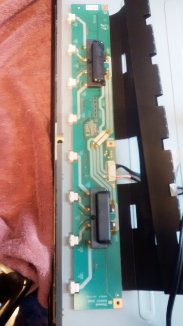

    Hello all. Currently trying to fix my nieces tv. Has no video. She did her own research and did the flashlight test. then ordered a replacement inverter. I installed it, however it did not fix the problem. There are no swollen caps. I suspicion the power supply board, but I need a schematic or other assistance in testing. Yes, I have a multimeter and a usb oscilloscope however, I don't know how to use the oscilloscope yet. Have searched and searched for service manuals, schematics, etc. to no avail. The power supply board is a BN44004400B. Thanks!

    pretty smart niece to figure that out it could be the inverter board. However for your board is a PSU repair kit at SJ available that fixes: The Samsung BN44-00440B Power Supply Component Repair Kit includes all necessary components to repair common failures on the Power Supply. Symptoms include will not turn on, no backlights, missing 5V standby or PFC.

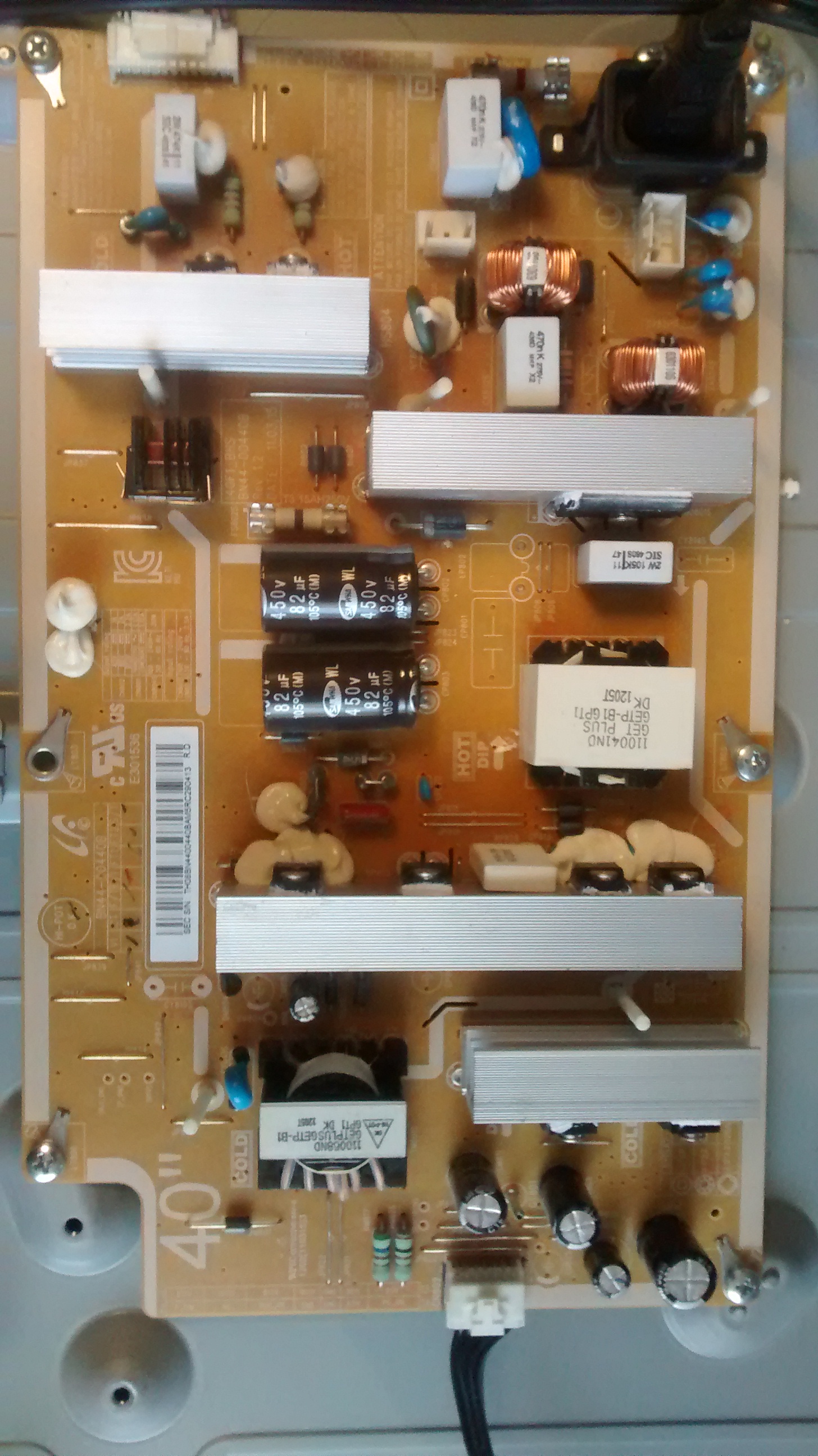

      So what Voltages do you have on the connector of the power supply board that goes to the main board when TV is in standby and when power switch is activated?
      You MUST report the pin name and follow by the Voltage reading for each pin so we can see if they are correct or not.
      We also need good clear the pictures of YOUR whole power supply board.

        Exercise caution when testing power supply board, it can be deadly. there are legends like little maps on the power supply board that tell you what voltages to expect from the connector pins, put negative lead on ground like the chassis for example, also check those 2 fuses if you haven't, I check those fuses with tv off and unplugged. The voltages have to be checked with tv on or plugged in of course.

                If you do post voltages and pin numbers, you have to include the pin out name. Your pictures are way too small in order to see anything like that what we need. You need to upload high resolution pictures, so we can see the details.
                  Re: Need help with Samsung LN40E550f7f
                  1) No pin names to tell us what each pins are.
                  2) There are 14 pins on that power supply connector that goes to the main board but you only report 7 of them and without the pin names as requested then those reported numbers are just about meaningless.
                  3) Samsung BN44-00440B power supply board?
                  4) You need to follow the instructions.

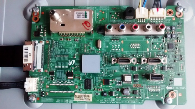

                        http://www.shopjimmy.com/samsung-bn4...upply-unit.htm is this your power board? you may have gotten a bad tcon board, hard to tell, I see shopjimmy has 1 for 10 bux. oops my bad you said inverter not tcon.

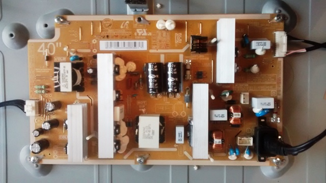

                                  psb:
                                  1. B13V -13.1V
                                  2. DIM- 5V
                                  3. B13V-13.1V
                                  4. NC -0V
                                  5. B13V- 13.1V
                                  6.BLU_ON -0V
                                  7. B13V-13.1V
                                  8., 9., 10 GND- 0V
                                  11.B5V- 5.1V
                                  12 A5V - 5.1V
                                  13. B5V- 5.1V
                                  14. PS_ON- 3V
                                  • Kindred1
                                    • Feb 2018
                                    • 55
                                    Here's a better one.

                                      No scorch marks. 450v caps read 375v. Everyone is talking about standby mode; on this t.v. , when is off, the indicator light stays red and I have no readings. If I turn it on, it chimes, the light flashes and then goes off. After several minutes, it shuts off.

                                        Don't have a schematic, not sure if this one will do it, try unplug power supply board from main board, see if backlights go on.
