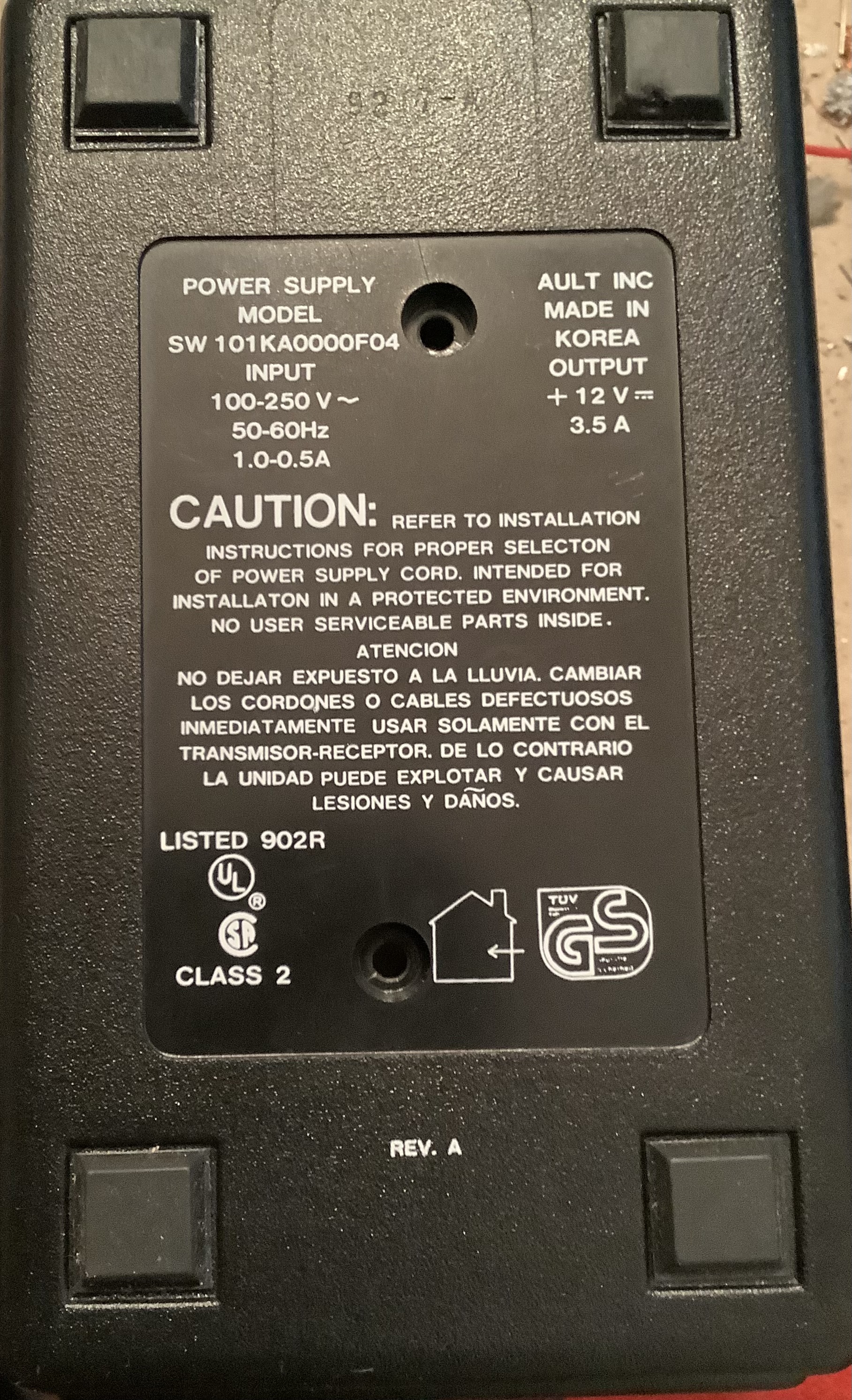

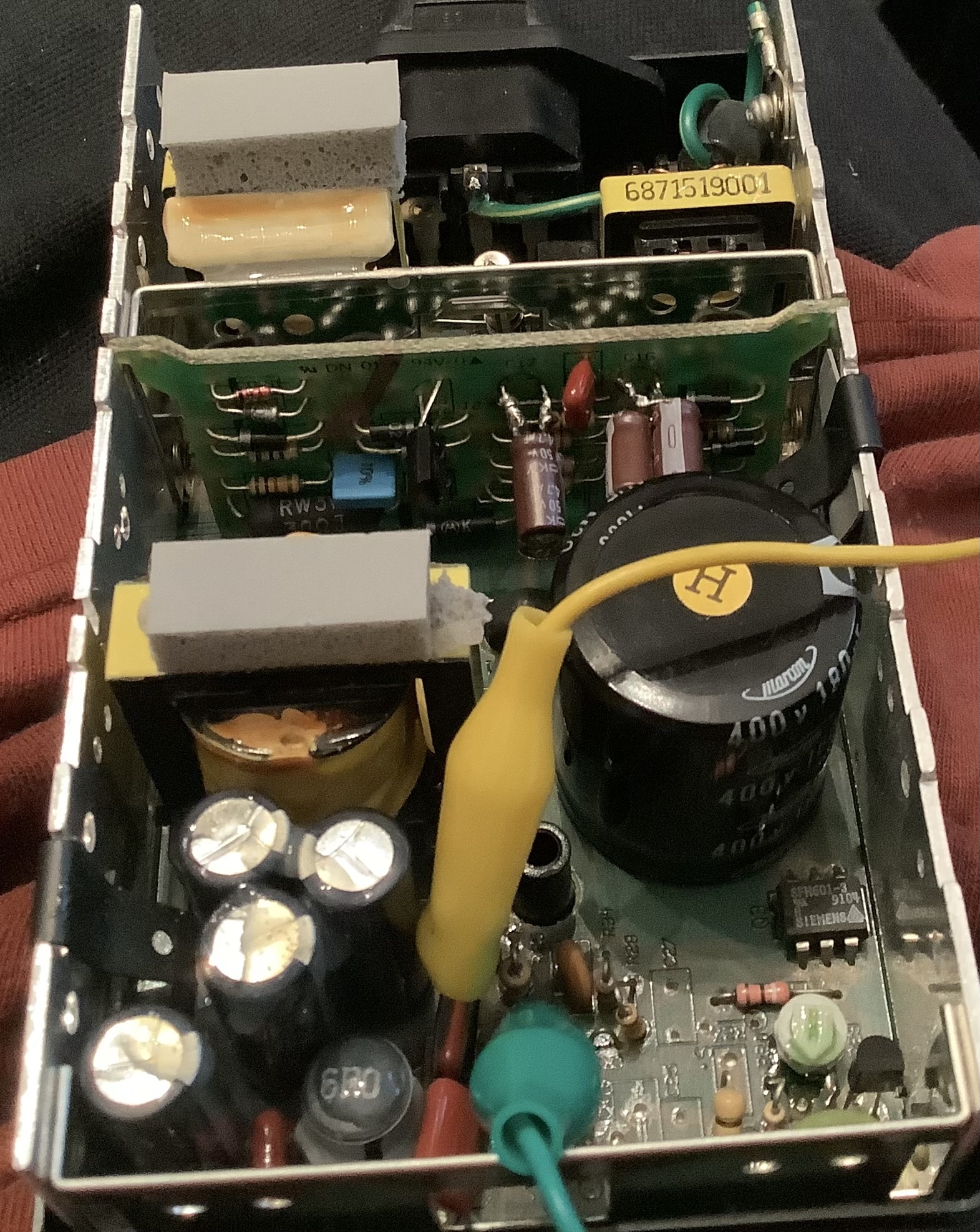

                  Here are the pictures of the switching power supply in question

                    I don't see a main PWM control IC in there, but the two 27uF caps might be for the driver stage of a 1/2 bridge, they are to keep imbalance or maybe average current reasonable. They see action when the PSU is heavily loaded.
                    Never seen a Marcon primary cap before 180uF 400V.
