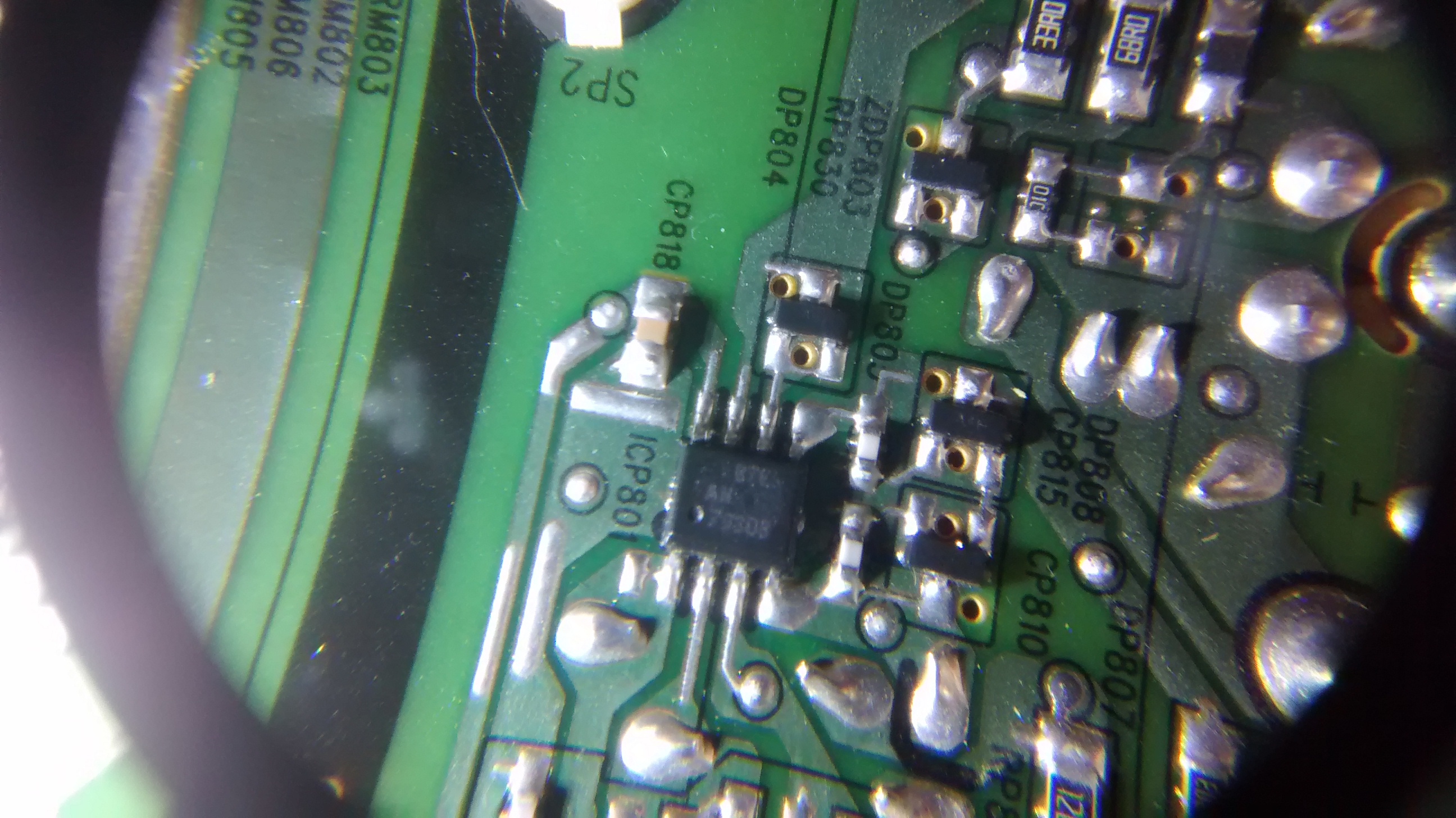

    Hey everyone,
    This power supply board is hard to find but there are repair kits available. This board had a blown fuse, FP801S, blown PFC MOSFET, QP802CS and ceramic cap, CP809. I replaced them with parts I already had and tested the rest of the parts that would've come in the repair kit and they were fine. I powered the board up on the bench expecting, in typical Samsung power supply board fashion, to see all my output voltages but, nothing. 0 volts on CNL801, CNM801 and CNT801. The only thing I have is 170vdc on the filter caps. No standby voltage either.
    Anybody...

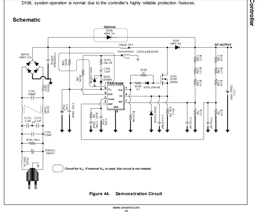

    Need advice testing a samsung power supply board with scope
    by repair-it
    I am attempting to test a samsung power supply board to verify the pfc ic is working. I am powering up the board with my isolation transformer. The board turns on fine but when I attempt to connect the ground for the scope probe, it trips out the isolator. I was taught not to 'float my scope' so I am wondering if I should test without connecting the ground lead or would that be asking for trouble? Not sure how else to test, I don't have a portable scope. I could plug direct to mains power but that would bypass the safety factor.
