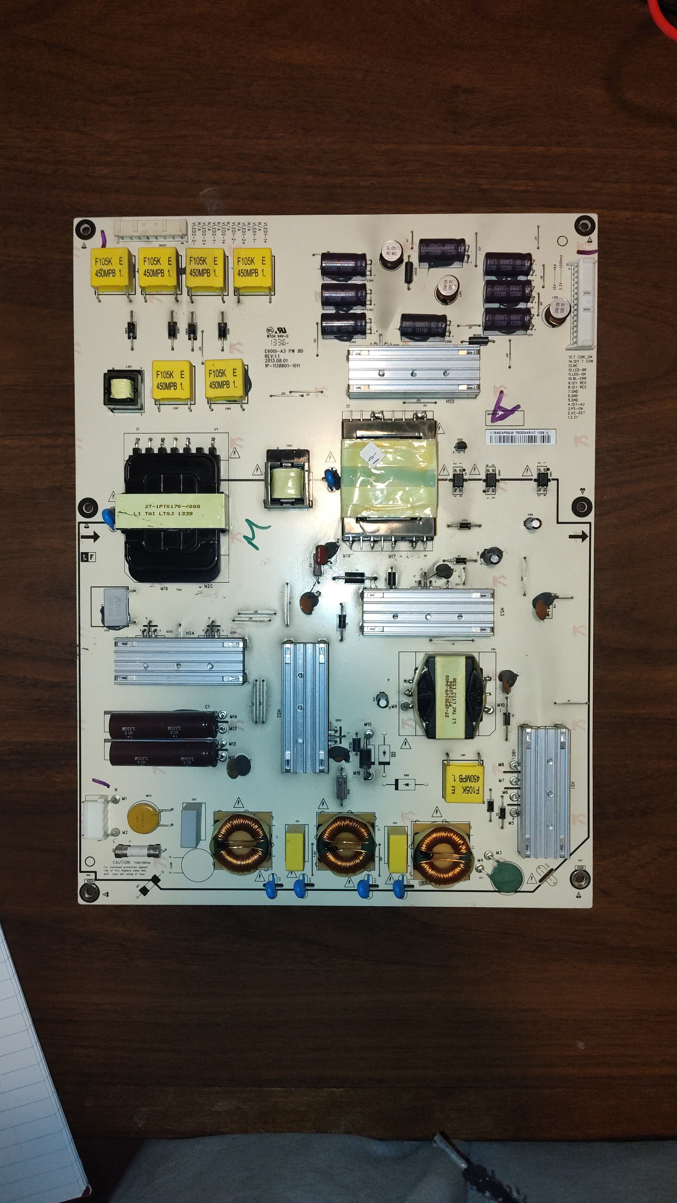

    I bought a replacement Power Supply Board but bought the wrong one not knowing the part numbers to match with a replacement, I just bought it by the TV model number not knowing there are two or 3 of the same board and all are not compatible with my TV model.
    The original Power Supply Part and Board numbers are "V 09-60CAP000-00 F0020EAAU9WW1343" and "1P-1139800-1012"
    The replacement Power Supply Part and Board numbers are "V 09-60CAP000-00 F0020DAARJVC 1338" and "1P-1138801-1011"
    (See attached pictures)
    When I installed the replacement power board, the TV lost complete power, no stand by lights or anything. I used my DMM to test the voltage at the power cable plug in connector, LED lights connector, and the Main Board connector on the Power Supply Board. There were no voltages showing from any of the pin points at all 3 of the said locations.
    I removed the replacement board and put the original Power Supply Board back into the TV and it had power again but still the backlight issue. I tested the voltages at the same points as the replacement board, only this time the Main Board pins all showed the voltages as indicated at the connector on the Power Supply Board, but there is suspicious voltage readings at the LED connector.
    I swapped the both of these boards twice to confirm this. The replacement Power Supply Board doesn't supply power to the TV because it isn't compatible with my TV model. The two compatible Part Numbers and Board Numbers for my TV model are :

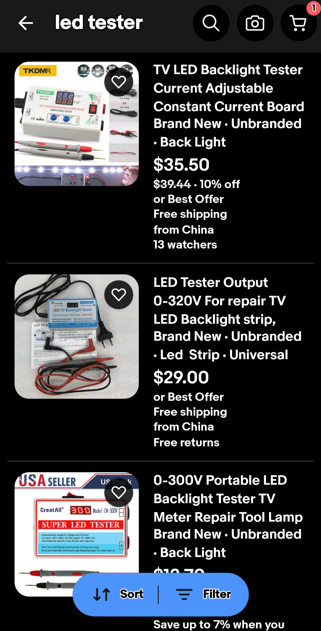

            Is this the LED tester you're referring to ?

              Amazon, my friend.. Amazon.
              This is the one I bought and it works great:
              TKDMR LED Lamp Bead TV Backlight... https://www.amazon.com/dp/B082GVB68Y...p_mob_ap_share
              Your issue is more than likely backlights. If you have Amazon Prime you might be able to get that overnight and know for sure by this time tomorrow. I've only had one Vizio not have backlights that turned out to not actually be the backlights. It was a P-series and it ended up being a few blown capacitors. The E and V series are the cheapest and backlight failure is very common.
              As for where to get the strips..I recommend eBay. There is no difference between the ones on there and ShopJimmy other than cost. I've purchased many sets from eBay and only ever had 1 strip come doa and was refunded the next morning. I purchased a set from ShopJimmy for my 60" Samsung for about $75 and within a month of putting them in the light spreaders started falling off one by one inside the screen and I had several bright spots. They did replace them, but the replacement set had an issue with arcing at the connectors between strips. I replaced with a $30 set from eBay and the TV is still going strong after about 3 years with at least 12 hours use every day.

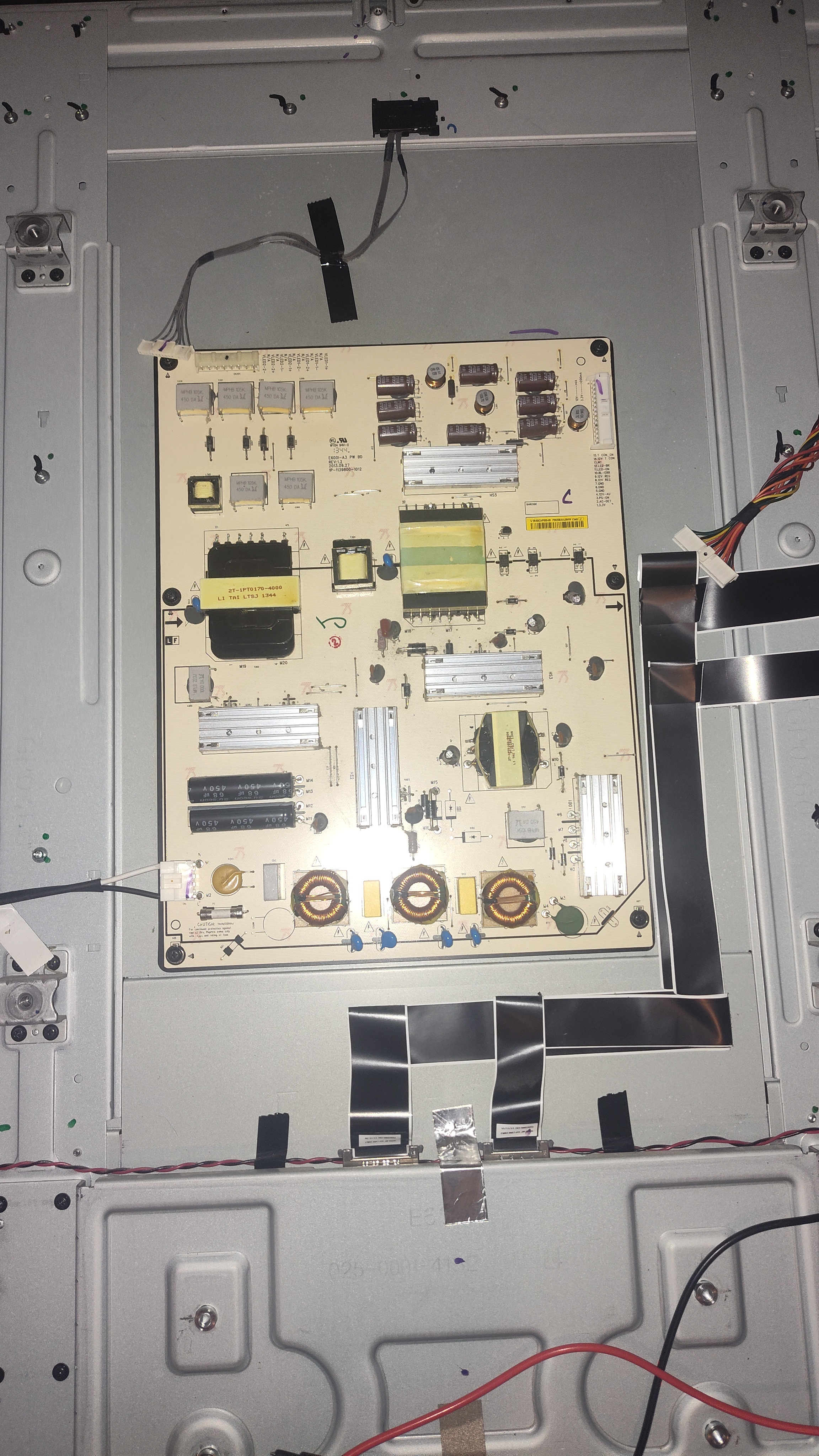

                          Which parts of the board do I use my DMM on ? What voltages should I be looking for ? Click image for larger version

                            These. Do all 1-15 on both boards same way.

                                  I tested the power board per your instructions. I unplugged the LED connector and main board connector from the board, and left only the power cable connector on the board, as pictured :
                                  Here are the test results :
                                  1. - 03.3v
                                  2. - 04.4v
                                  3. - 00.0v
                                  4. - 12.4v
                                  5. - 00.0v
                                  6. - 00.0v
                                  7. - 00.0v
                                  8. - 12.2v
                                  9. - 12.2v
                                  10. - 00.0v
                                  11. - 00.0v
                                  12. - 00.0v
                                  13. - 00.0v
                                  14. - 00.0v
                                  15. - 00.0v
                                  What are we looking at with these results ?

                                    Well rip it out of the package and plug it in. Definitely worth your time. But original board is looking fine. Besides testing the other board wait for the led tester. Always test the LEDs with the PSU disconnected . Use the legend and put + and - in correct spot.
                                      • Nov 2024
                                      • 54
                                      Ok, I'll go ahead and get it out of the box and test it too real quick.
                                        • Nov 2024
                                        • 54
                                        Replacement board shows no voltages at any of the points referenced in the 1st test.
