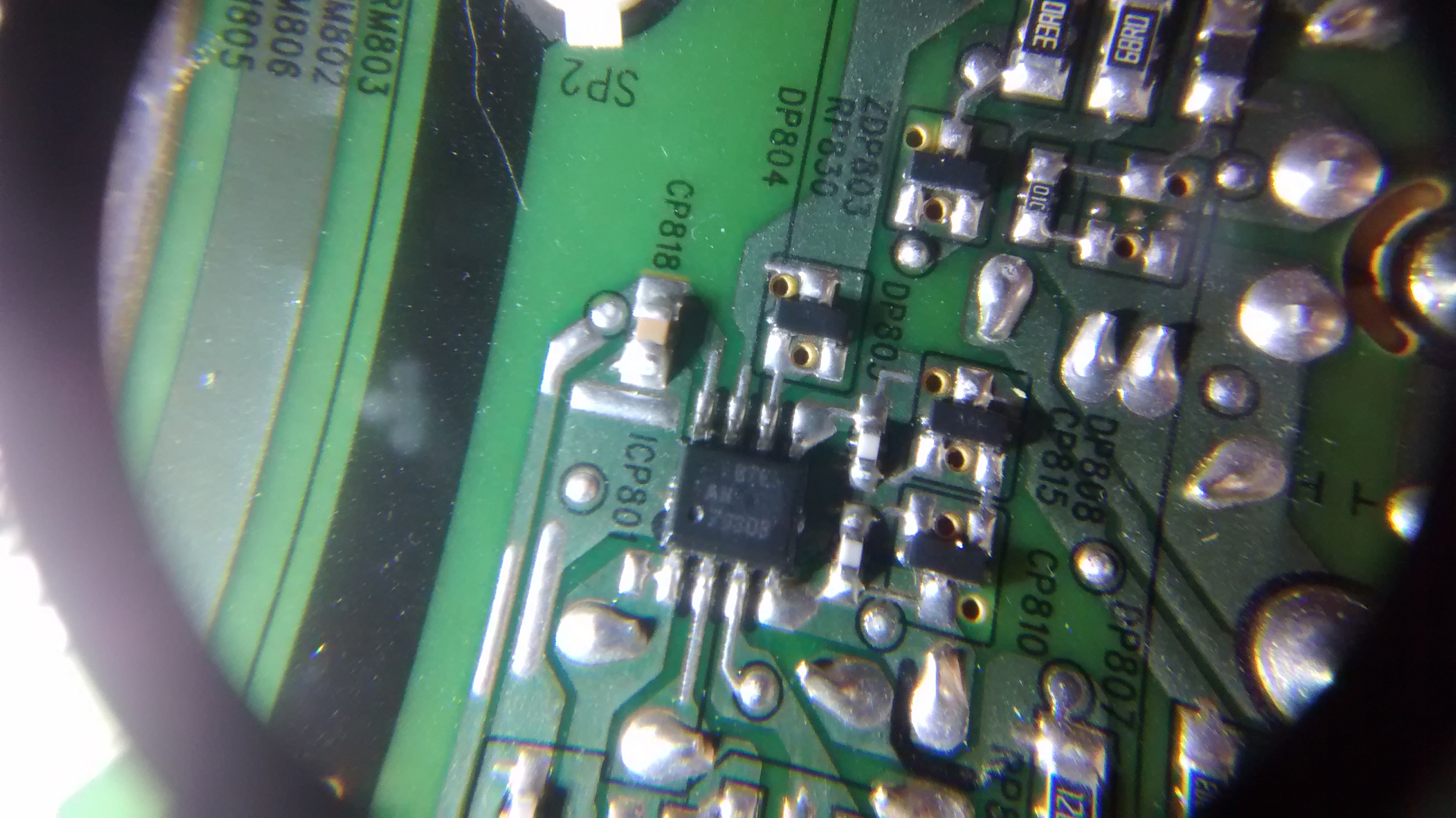

                  Ok, I found it. - It appears to have a little corrosion/heat damage on the top. ( no scorching on or around.) All I can make out is as follows.
                  B7E
                  AN
                  7930B

                      FAN7930B
                      https://cdn.badcaps-static.com/pdfs/...0db2152410.pdf
                      Pin 8 is VCC, Pin 6 is GND which is connected to circuit GND (negative leg of the main filter cap) of the hot side, so be real careful since you are making measurement in the HOT DEADLY side of the circuit; I suggest you to at the least plug the TV into the GFCI outlet to protect yourself.

                        https://www.digikey.com/products/en?...G&pkeyword=&v=
                        Is this it?
