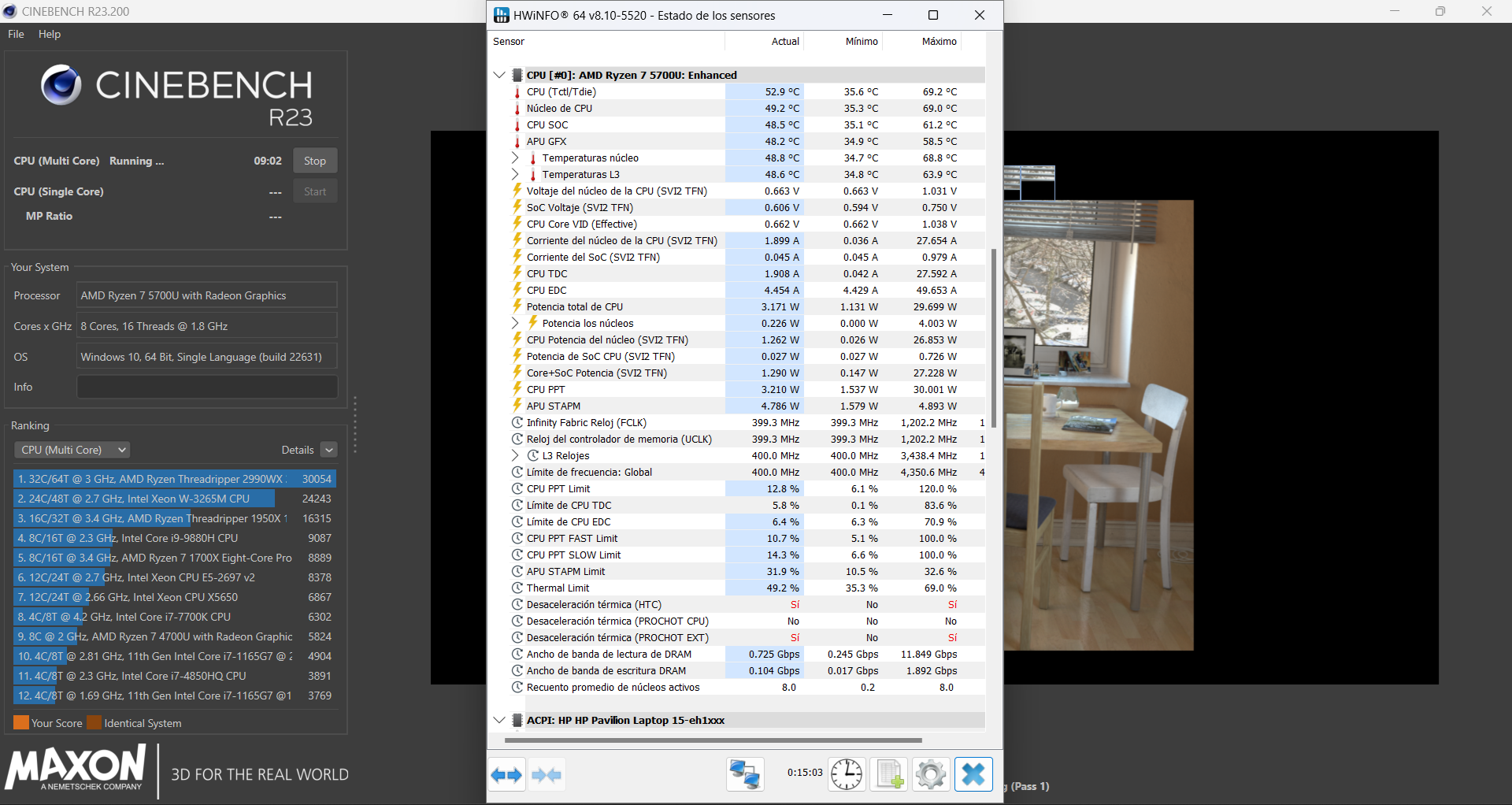

    - The board appears to work fine, it boots normally to Windows, but sometimes the CPU would throttle to 0.4GHz depending on load, checking with HWINFO64 reveals that Thermal Throttling (PROCHOT_EXT) and Thermal Throttling (HTC) report a value of "Yes" when that happens
    - Running CPU stress tests (Cinebench R23), it would "thermal throttle" within 30-40 seconds, the CPU temp doesn' get hot enough (max 70 deg. C and the fan woudn't even turn on), and stopping the stress test and it takes around 2 minutes for PROCHOT_EXT to get "no" as a value, something has to "cool down"
    With charger plugged in (doesn't matter if the battery is installed or not)
    - Same thing, boots to Windows (I'm writing this right now from this laptop), but running Cinebench, the screen would go black almost instantly and the power LED stays on, holding the power button works to turn off the laptop, and can start again

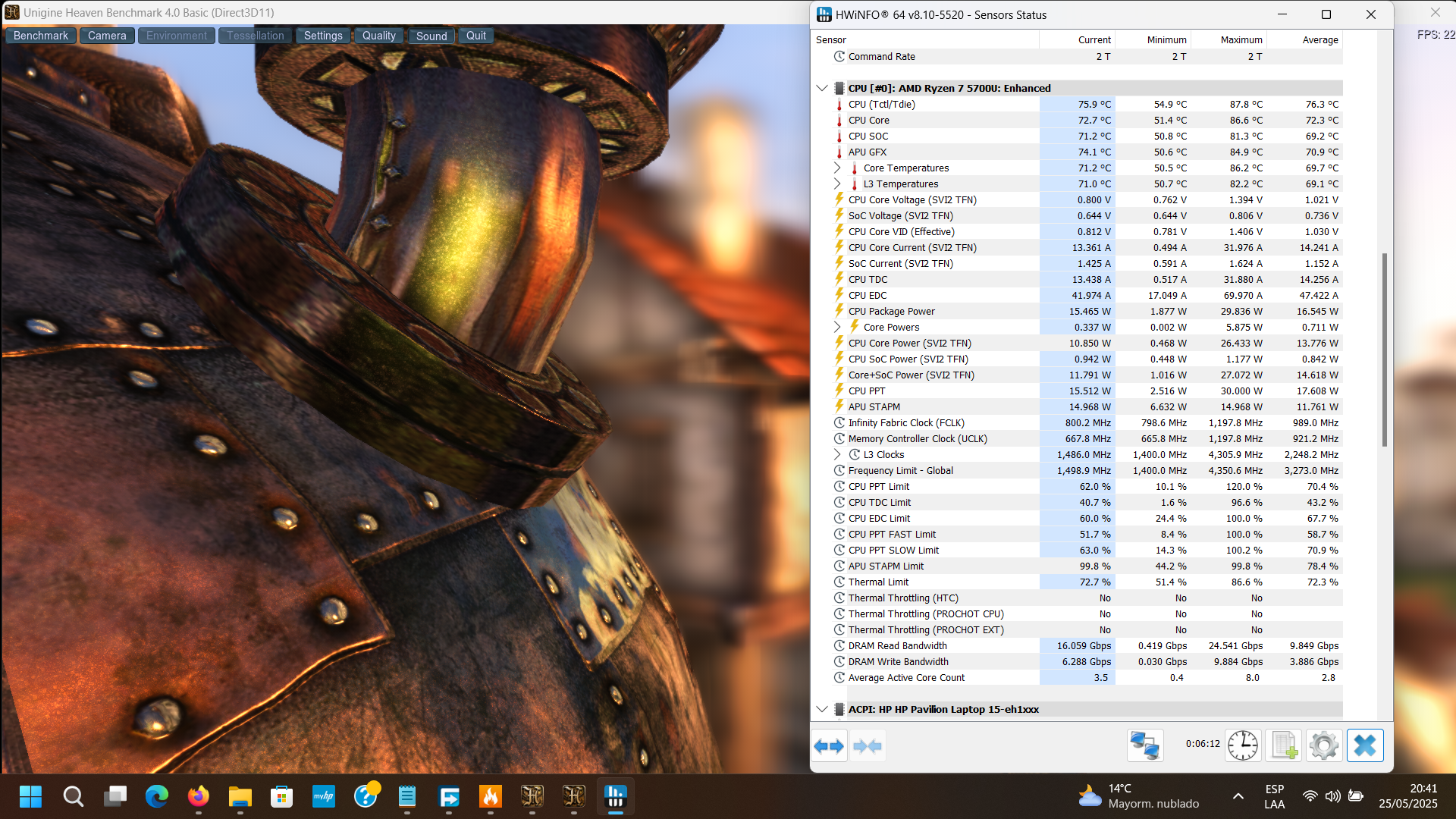

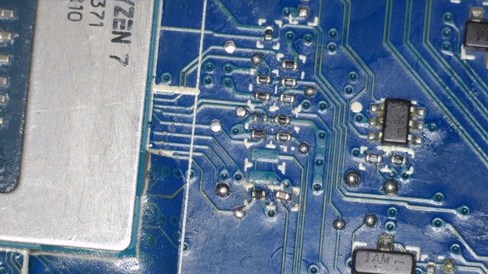

    Attached pictore shows PROCHOT_EXT and HTC change to "yes" on HWINFO64

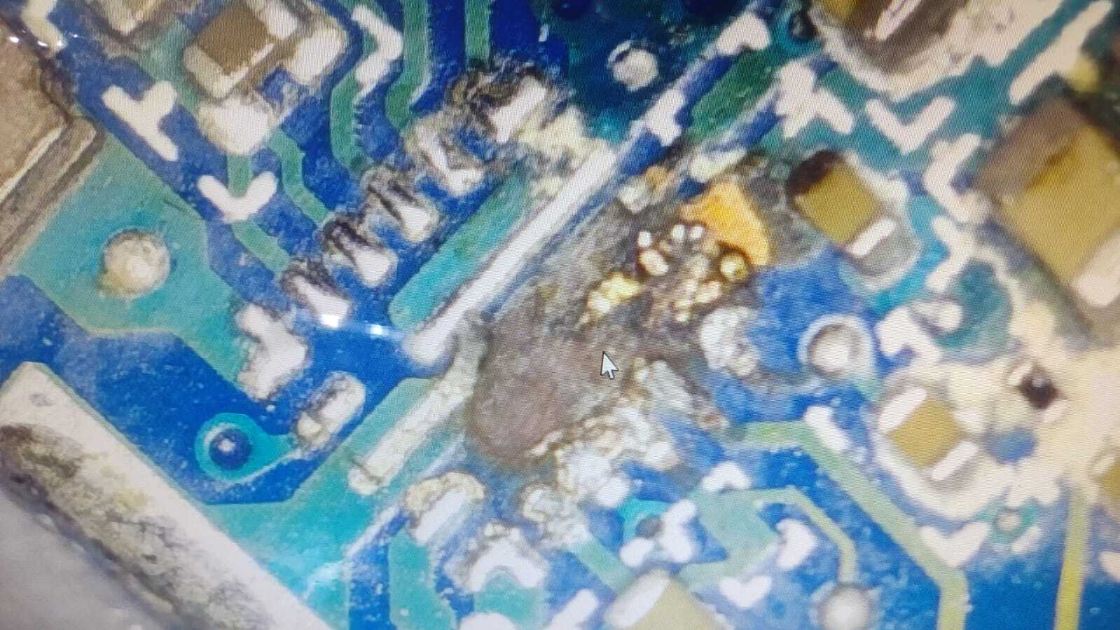

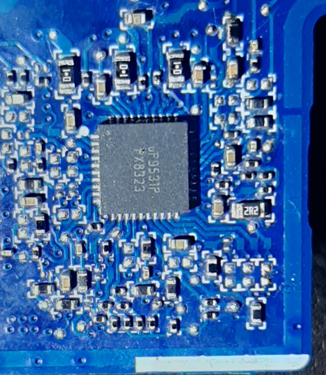

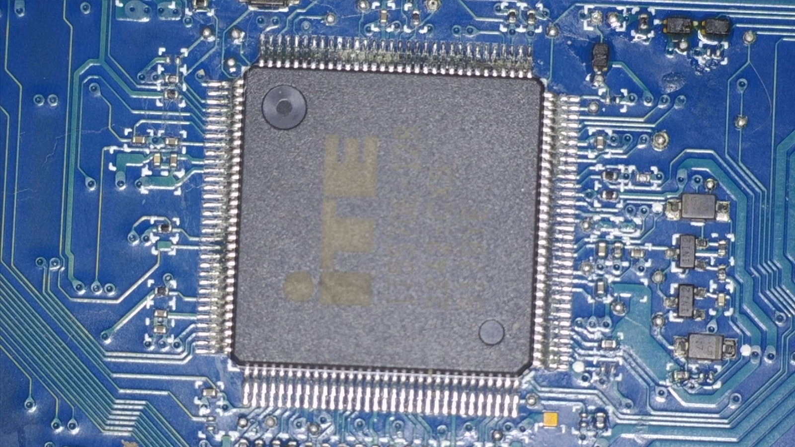

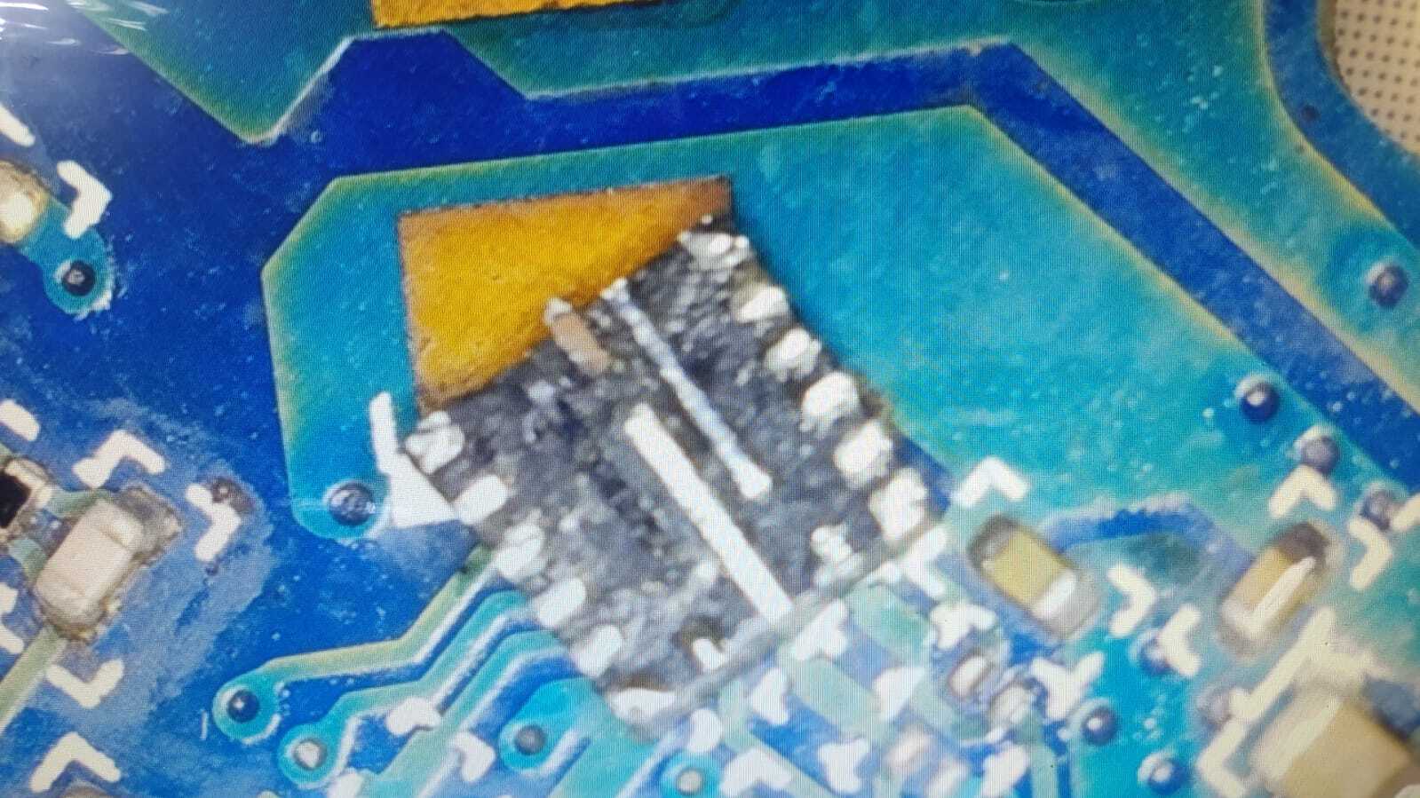

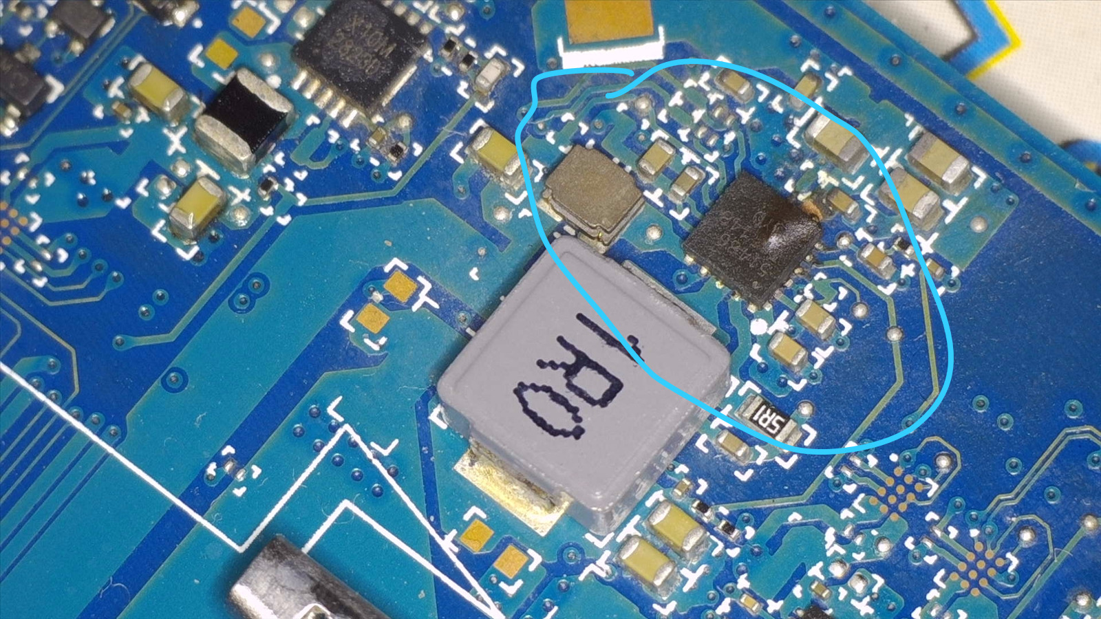

    Pictures of the damage on board A (original board from the laptop), if anyone is interested, I already cleaned the soot, second picture is the "before" state
    Also the 2823D IC on the left from the first picture was shorted

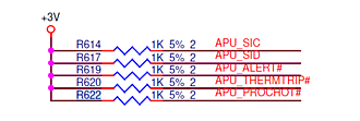

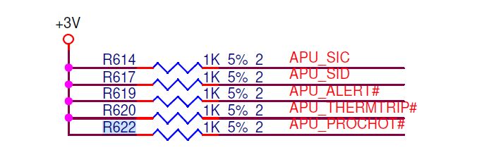

      Not sure but PROCHOT_EXT may be an open-drain pin so a pull-up resistor on this line is mandatory. Confirm it is present.
      • m1ch43lzm
        • Mar 2019
        • 1001
        • Peru
        mon2 according to schematics I can't find a pull-up on PROCHOT#
        It only goes to 4 places
        - APU itself, as APU_PROCHOT#, tied to H_PROCHOT#
        - EC, H_PROCHOT#_EC, then goes through Q4702 and becomes H_PROCHOT#
        - Charger ISL9238 PU8200, H_PROCHOT#
        - CPU VRM controller PU8800 as VRHOT, which is tied together to H_PROCHOT# with trace jumpers R625 and R626

          R622

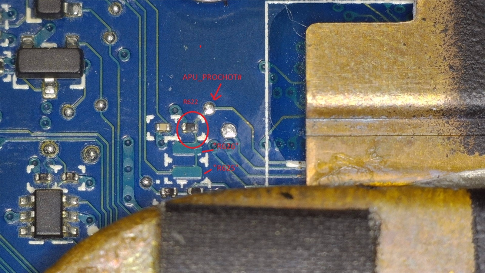

              mon2 you're right, i took measurements from the Board A (dead), and Board B (the one i got from ali), i wont be able to replace the resistor right now, will update when i get time to do it properly
              Thank you for pointing that out
              Board A
              R622 1.02k
              Diode reading (red probe on GND) at R622 H_PROCHOT# 0.534
              Thinking it was the thermistors, i took measurements anyway (yes, i know they're in parallel to other resistors in the schematic)
              PR8864 15.9k
              PR8816 15k
              PR8823 15.08k
              PR8852 16.52k
              Board B
              R622 440k-460k, varies every time i probe it, so yes, it's faulty
              Diode PROCHOT# 0.440
              PR8864 16.94k
              PR8816 15.07k
              PR8823 15.03k
              PR8852 16.63k​
              R622 is a 0201 resistor near the heatsink, attached picture of the location
              I added some notes about the location of a testpoint of APU-PROCHOT# and the trace jumpers R626 and R625 (they designed them to be difficult to cut on purpose, instead of just addind a narrow section to them)
              So yes, heat in the area will probably make that resistor drift to a higher value, but i still can't find an explanation why it instantly loses VCORE and VDDSOC only when on AC power, while i start cinebench stress test
              Have to try to replace it to check what happens next, whether i grab it from the donor Board A or find it in some other random board i have

                I'm back, replaced R622, PROCHOT doesn't trigger anymore when running Cinebench... on battery
                Yes, it looks a bit misaligned as i used the soldering iron, didin't want to use hot air near the CPU, in the process managed to "lose" C602, placed it back with the soldering iron
                But with the charger plugged in, if i start Cinebench, at the "Preparing render test" phase, laptop crashes with black screen, power LED still on (likely VCC_CORE/VDDCR_SOC goes missing again), on light CPU load it doesn't happen
                The charger is 45W, original charger which came with the laptop
                Noticed also that the fan wouldn't turn on at all unless i change the "Fan always on" setting on BIOS, the CPU temp went up to 90 deg. C while running stress tests and the fan woudn't turn on at all, could it be the EC firmware? Noticed that the soldering on the EC doesn't look factory
                Something else is still wrong with this board

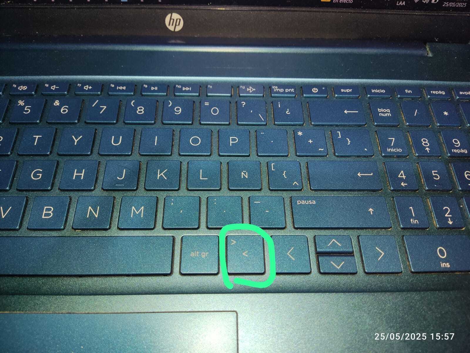

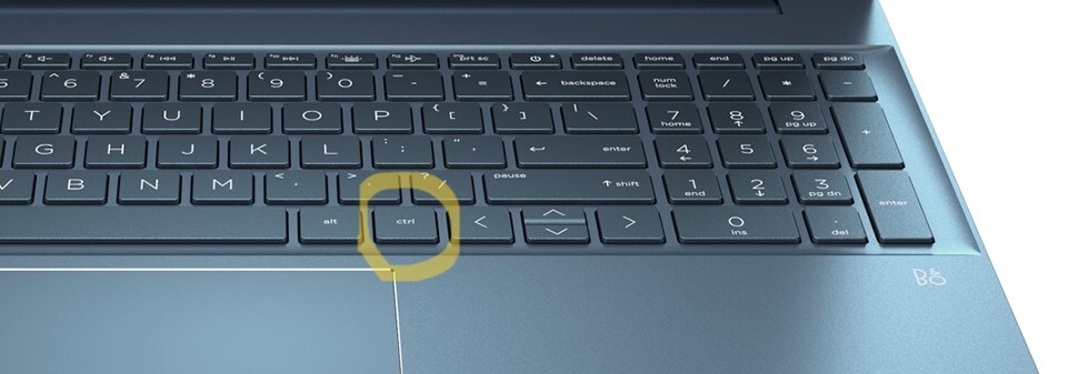

                  Noticed something else, my keyboard (Latin American Spanish) has a "><" key next to right Alt, but that "><" key currently works as a Right Ctrl, it's not the keyboard language setting in Windows, as all the symbols match, and that key worked before as it's printed on the keycap
                  I checked pictures of the keyboard online, and only the US English keyboard has a Right Ctrl key instead of "><" (or something else, on other languages), maybe some hidden BIOS setting? (feature byte/product id?)
                  The BIOS from this board (88D0) is different than from the dead board, even HP website lists different bios updates for the 15-eh0000 and 15-eh1000, so i can't directly flash it with the dump of the dead board (87C5)
                  My keyboard / US keyboard layout

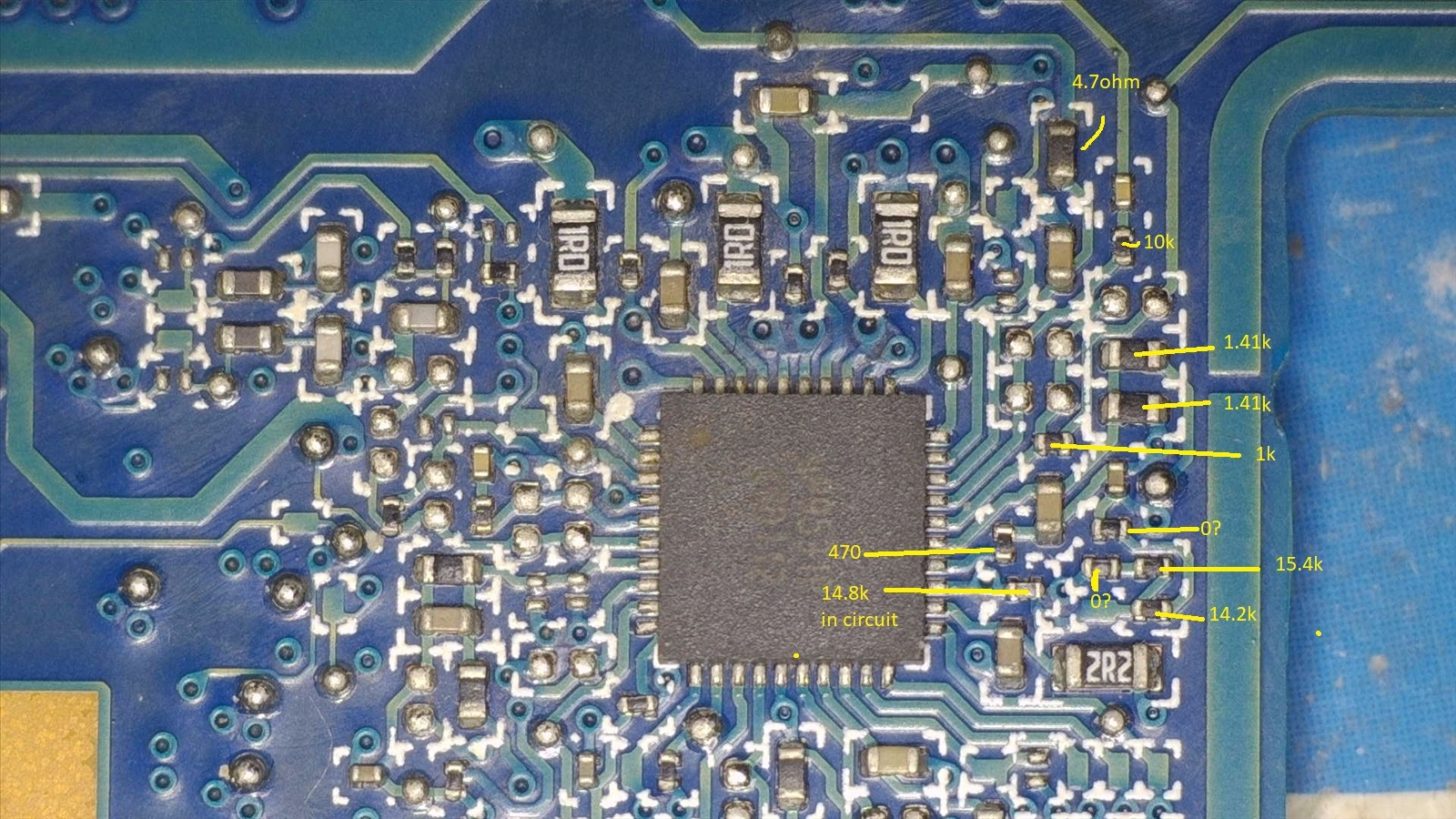

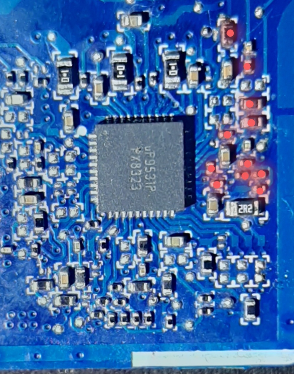

                    Good afternoon, please tell me what the resistor values ​are next to the uP9531P?
                    • m1ch43lzm
                      • Mar 2019
                      • 1001
                      • Peru
                      Hi, here, measurements from the Ryzen 7 4700u board
                      All measurements done in circuit
                      PR8802 same as sch 4.7
                      PR8817 1.41k
                      PR8822 1.41k
                      PR8826 1k
                      pr8812 close to 0ohm
                      pr8813 15.4k in circiut
                      pr8815 14.2k
                      pr8814 14.8k in circuit
                      Several resistors in that area on the 8F0 board are different values compared to the schematic for the 8E0, unfortunately the proper schematic/boardview doesn't exist
