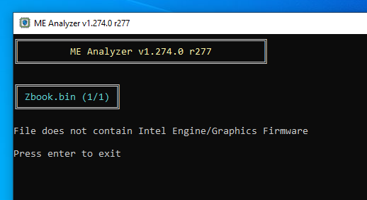

    I can't even Analyze your file using MEA, try to read the chip again.
    I think it will be better to create a New thread with your Device name "HP ZBook Firefly 14 inch G8".

      some one can clear me for me this bios?
      Is it the same bios youve already asked about in the HP ZBook Studio G8 thread - https://www.badcaps.net/forum/showpo...3&postcount=14 . What is your model,firefly or studio G8 .If its the same bios you`re asking for just bump that thread,no need to post the same thing again.If its a different one then start a new thread.

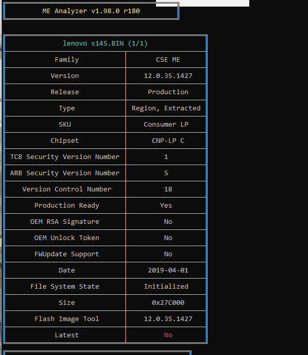

                  Hello guys,
                  I need the firmware bin file CSE ME 12.0.35.1427 CNP-LP C, and I cannot find it anywhere, do you have any idea if it is possible to find it?
                  Thank you in advance.

                    If you can`t find it anywhere its ok to use the next oldest or newest version. Use PRD_RGN .
                      It's already exist in Win-Raid`s Repository (Check the attached links in Post #1).
                      Also you are using a very old version for ME_Analyzer.

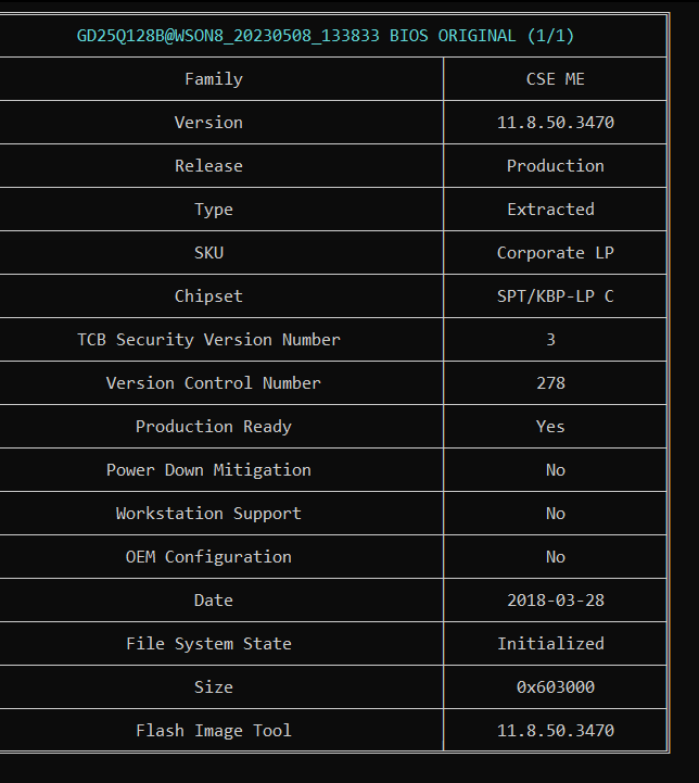

                        What flash image tool
                        Hi
                        what fit flash image tool to use with
                        "11.8.50.347" ?

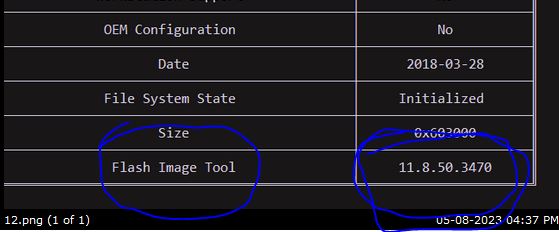

                          "11.8.50.347" ?
                          11.8.xx.xxx

                            Originally posted by SMDFlea
                            11.8.xx.xxx
                            great. so the most important is the first digits like 12.5.xx.xxx?
                              thanks
                              Yes.
                              Do yourself a favor and read again post #1, as well as the linked topics.
