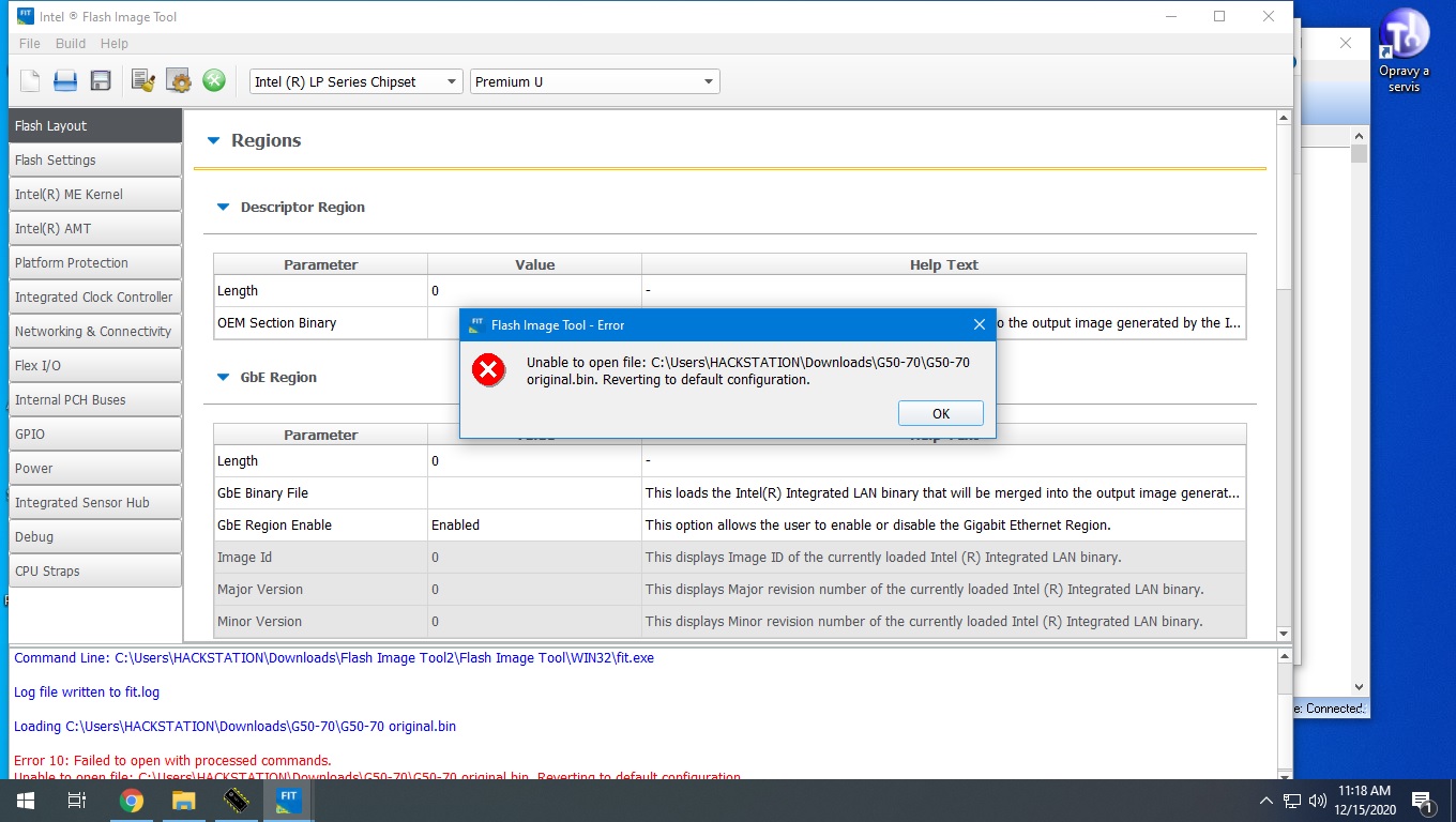

                  when i try to open bios file i get this error

                    The bios is corrupt.Post it in the bios requests for fixing .

                      but it show me even on known good bios

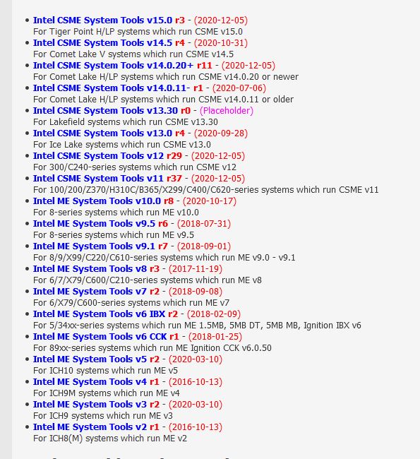

                        You should open the bios with ME Analyzer first and check what ME firmware version you have,then you need the FIT tools version that matches. You`ve been trying to open a G50-70 bios that has an ME FW version 9.5 with FIT 11 . Each ME firmware version has its own set of tools.There`s a link in the first post to all the tools, and the full ME cleaning guide at win-raid .
