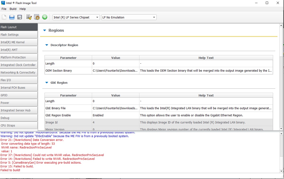

          #104
          Re: ME Firmware Cleaning Guide
          Anyone can understand why i am getting this error?
          I followed the instructions one by one!
            • 21597
            #105
            Ive never seen that error before. Post your backup in another thread, if theres one with the same laptop/motherboard model as yours, or start a new thread please,and we`ll see whats wrong

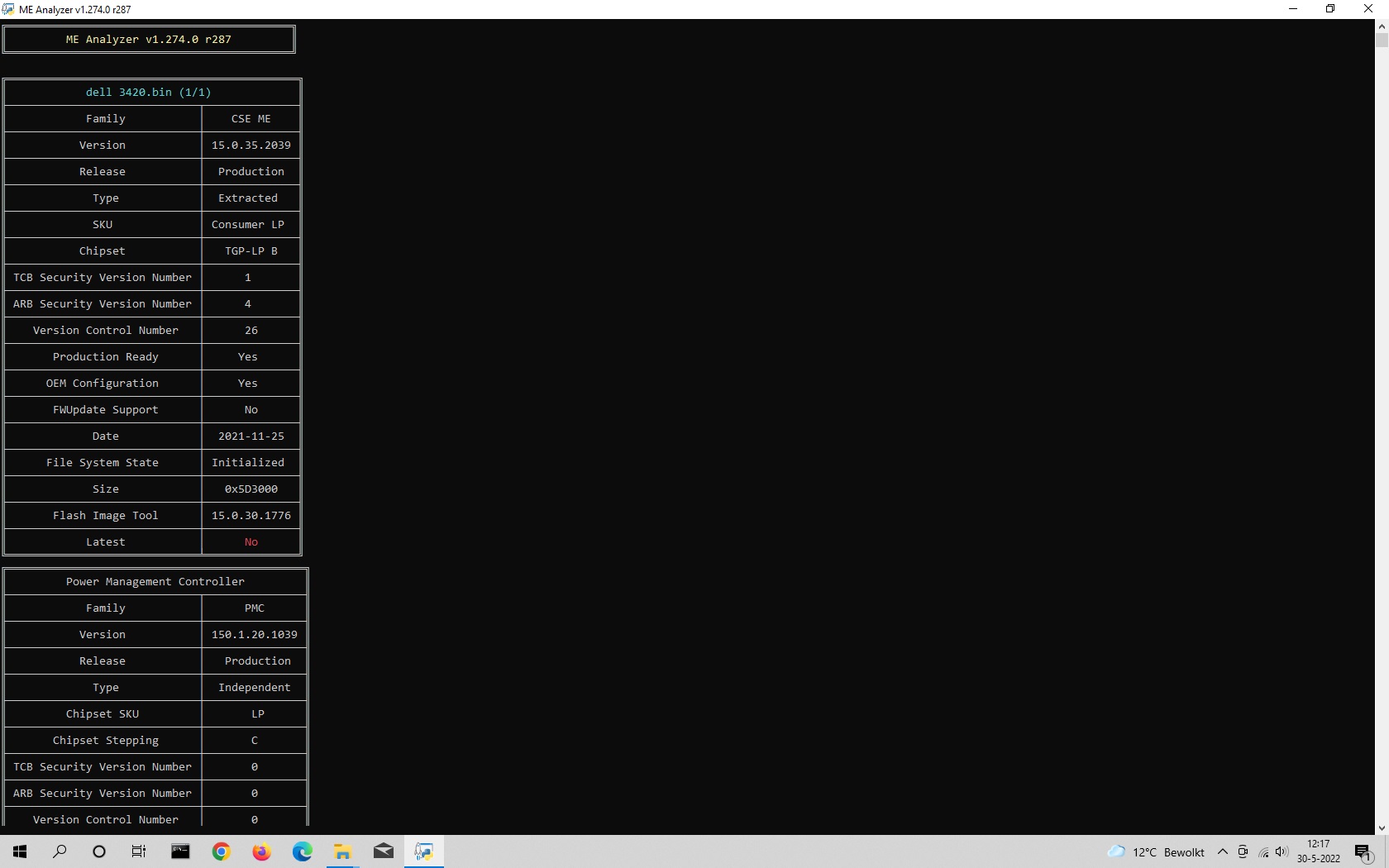

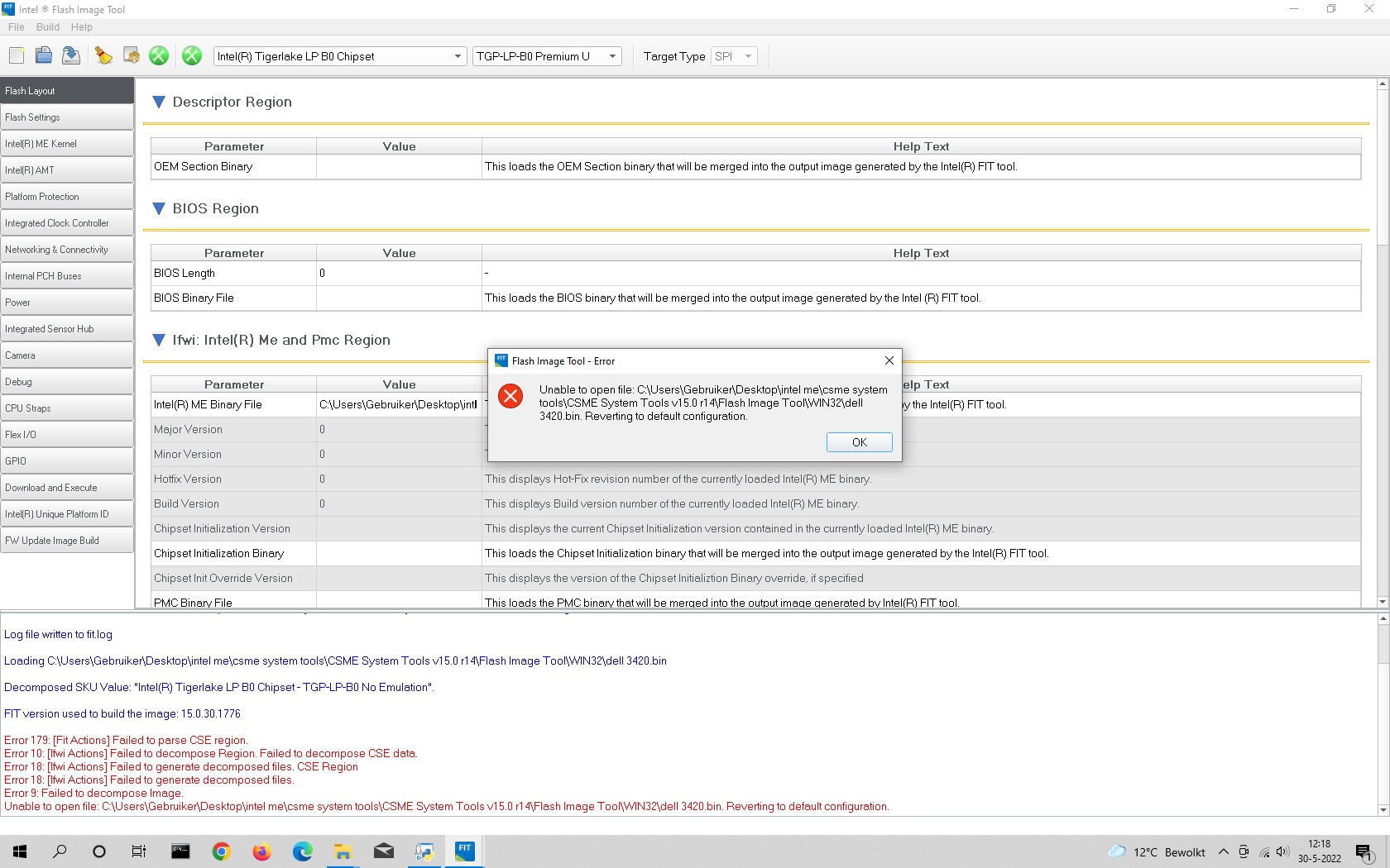

                  #108
                  I am trying to clean me with fit version 15.
                  but i get error
                  Intel (R) Flash Image Tool. Version: 15.0.35.1951
                  Copyright (c) 2013 - 2021, Intel Corporation. All rights reserved.
                  5/30/2022 - 12:18:12
                  Using vsccommn.bin with timestamp 15:10:12 08/11/2021 GMT
                  Command Line: C:\Users\Gebruiker\Desktop\intel me\csme system tools\CSME System Tools v15.0 r14\Flash Image Tool\WIN32\fit.exe
                  Log file written to fit.log
                  Loading C:\Users\Gebruiker\Desktop\intel me\csme system tools\CSME System Tools v15.0 r14\Flash Image Tool\WIN32\dell 3420.bin
                  Decomposed SKU Value: "Intel(R) Tigerlake LP B0 Chipset - TGP-LP-B0 No Emulation".
                  FIT version used to build the image: 15.0.30.1776
                  Error 179: [Fit Actions] Failed to parse CSE region.
                  Error 10: [Ifwi Actions] Failed to decompose Region. Failed to decompose CSE data.
                  Error 18: [Ifwi Actions] Failed to generate decomposed files. CSE Region
                  Error 9: Failed to decompose Image.
                  Unable to open file: C:\Users\Gebruiker\Desktop\intel me\csme system tools\CSME System Tools v15.0 r14\Flash Image Tool\WIN32\dell 3420.bin. Reverting to default configuration.
                  Loading defaults.
                  someone can help me with this problem?

                    #109
                    but i get error
                    Try this version

                      #110
                      Thank You Hoaca,
                      this version works without error

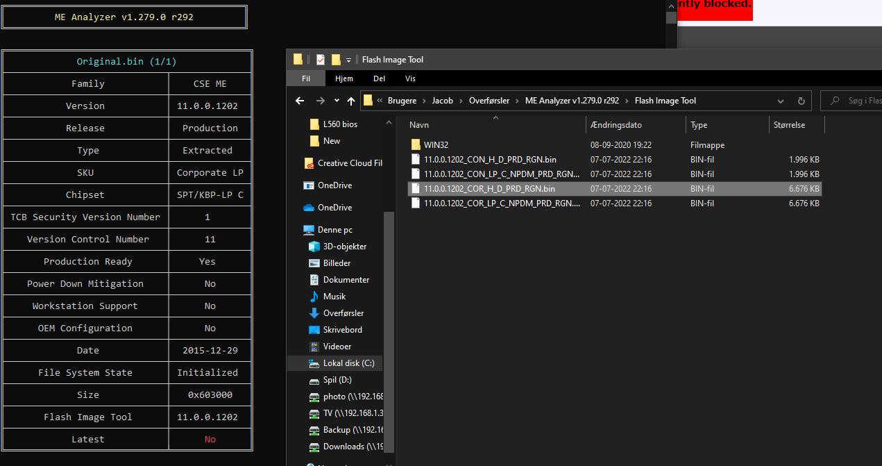

                          Hey, awesome guide, but there is something I don't understand. How do I know which ME version to use? I found the correct version number, but which one of the four should I choose? How would I go about figuring that out? (See pic)

                            #113
                            I would go for the lowest one, has cor_lp_c_npdm, look at the chipset on MEI. The highlighted one has cor_lp_hd. Would someone more experience corroborate?

                              #114
                              I think I understand now
