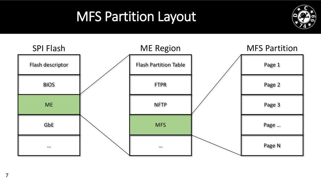

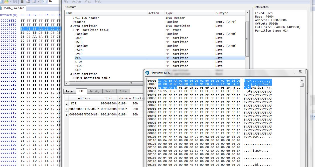

                @SMDFlea i want to know something.How i replace in Me Region MFS/FTPR/NFTP area.
                According to this video.He doing auto how i can manually.
                link video
                Time 01:12:40 MFS CHUNK DATA CLEAN
                https://www.youtube.com/watch?v=j2K5PHqZunk
                  • 20593
                  #48
                  Re: HP 840 G1 is not in committed state
                  link video
                  You can check with MEAnalyzer how the partitions are laid out and the start and end addresses and size using the -dfpt switch .You can use a hex editor and UEFITool (newer version) to see the partitions use the extract as-is if you want to copy any part from one ME region to edit into another. You can even edit the PCHC,PMC partitions
                    Can you share UEFI tool which version show me partition.
                      • 20593
                      #50
                      I`m using A57 https://github.com/LongSoft/UEFITool/releases

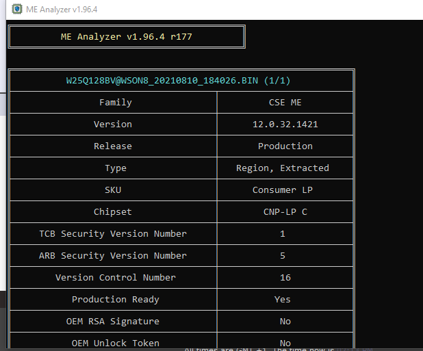

                          please i need flash image tool V 12.0.32.1421
                            • 20593
                            #53
                            Re: ME Firmware Cleaning Guide
                            The FIT tools version doesn`t have to match exactly, as long as its version 12 its ok (version 12 ME firmware,use version 12 of FIT). The link to the tools is in the first post, along with the win-raid guide

                                  #56
                                  i do clean me region to the bios and i flash pc but hdd becomes not detect in setup and when i flash with the old bios the hdd is detected
                                  the new bios cleared is in the picture
                                    • 20593
                                    #57
                                    Maybe you did something wrong. Post your original bios backup in a new thread,not in this thread please - https://www.badcaps.net/forum/forumdisplay.php?f=40
