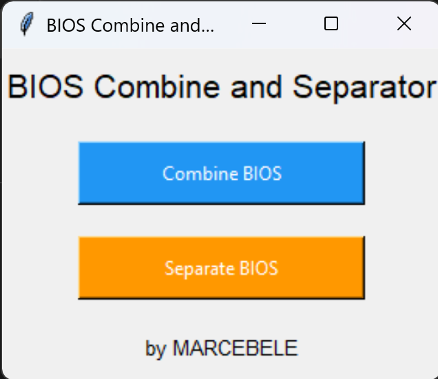

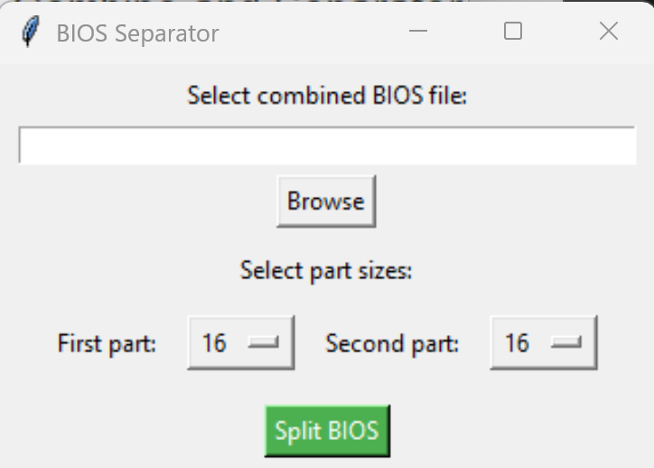

ME Firmware Cleaning Guide
  • MrBojangles
    replied
    Originally posted by SMDFlea
    There`s a link at post #1 to some firmware repositories. For CSME versions later than 15 check the win-raid forums and search the internet.
    Okay thanks
    Leave a comment:
    replied
    Originally posted by MrBojangles
    Ahh okay thanks guys.
    And how do I got about finding a matching ME firmware?
    There`s a link at post #1 to some firmware repositories. For CSME versions later than 15 check the win-raid forums and search the internet.
    Leave a comment:
  • MrBojangles
    replied
    Ahh okay thanks guys.
    And how do I got about finding a matching ME firmware?
    Leave a comment:
    replied
    Originally posted by MrBojangles
    When I try to open my merged BIOS in FIT I get an error
    There are two bios chips, one for the main bios and one for the EC_Bios which is a recovery bios. The recovery bios is seperate it is not a split bios where the code from the first chip continues onto the second one
    Leave a comment:
  • Stefan Steff
    replied
    Originally posted by MrBojangles
    When I try to open my merged BIOS in FIT I get an error
    Another problem is that I don't know how to find matching ME firmware from step 2
    HP ProBook G4
    S/N: 5CG9155S9W
    Loading C:\Users\Supernörden\Desktop\new.bin
    Error 39: Invalid input file type. C:\Users\Supernörden\Desktop\new.bin
    Error 16: Not a valid file type. C:\Users\Supernörden\Desktop\new.bin
    Error 10: Failed to open with processed commands.
    Unable to open file: C:\Users\Supernörden\Desktop\new.bin. Reverting to default configuration.
    Loading defaults.
    Do not merge BIOS with EC.
    Open with FIT only the BIOS.bin.
    Leave a comment:
  • MrBojangles
    replied
    When I try to open my merged BIOS in FIT I get an error
    Another problem is that I don't know how to find matching ME firmware from step 2
    HP ProBook G4
    S/N: 5CG9155S9W
    Loading C:\Users\Supernörden\Desktop\new.bin
    Error 39: Invalid input file type. C:\Users\Supernörden\Desktop\new.bin
    Error 16: Not a valid file type. C:\Users\Supernörden\Desktop\new.bin
    Error 10: Failed to open with processed commands.
    Unable to open file: C:\Users\Supernörden\Desktop\new.bin. Reverting to default configuration.
    Loading defaults.
    Leave a comment:
  • ali0robot
    replied
    Originally posted by SMDFlea
    I don`t know, you would have to post a BIOS request, post your backup,part number(s) on the bios chip(s) , motherboard model number, etc.
    Okay, I should check some settings. I’m not familiar with the new version of FIT, so maybe I did something wrong in the settings. I’ve used all the previous versions of FIT for a while, but version 16 is new to me.
    Leave a comment:
    replied
    Originally posted by ali0robot
    thank you so much for file but I have one question, I can't understand why output file from FIT 16 is 64MB instead of 32MB
    thanks in advance
    I don`t know, you would have to post a bios request, post your backup ,part number(s) on the bios chip(s) , motherboard model number etc.
    Leave a comment:
  • ali0robot
    replied
    Originally posted by SMDFlea
    You don`t have to use the exact version. Lenovo support have configured ME firmware updates, the latest one for the x13 Gen4-21ey is 16.1.35.2557
    16.1.35.2557 Corp LP unconfigured firmware attached
    thank you so much for file but I have one question, I can't understand why output file from FIT 16 is 64MB instead of 32MB
    thanks in advance
    Leave a comment:
    replied
    Originally posted by ali0robot
    it's for Lenovo x13 Gen4-21ey
    thanks in advance
    You don`t have to use the exact version. Lenovo support have configured ME firmware updates, the latest one for the x13 Gen4-21ey is 16.1.35.2557
    16.1.35.2557 Corp LP unconfigured firmware attached
    Leave a comment:
  • ali0robot
    replied
    Originally posted by SMDFlea
    What PC/Laptop model is it for
    it's for Lenovo x13 Gen4-21ey
    thanks in advance
    Leave a comment:
    replied
    Originally posted by ali0robot
    hi,
    I need csme 16.1.25.2124 cor-lp-a please
    What PC/Laptop model is it for
    Leave a comment:
  • ali0robot
    replied
    hi,
    I need csme 16.1.25.2124 cor-lp-a please
    Leave a comment:
  • MAREBELE
    replied
    Hi all, want to shere a python scrip i made to combine and seperate laptop with 2 bios chip,
    might be usefull, theres a python scrip (source code ), portable and installer version all work and function the same, use 1 you like
    Leave a comment:
  • Sailman
    replied
    Hello
    can anyone please provide Flash Image Tool 16.1.35.2545 or something works in place of it?
    Thanks in advance
    Leave a comment:
  • adamgouadma
    replied
    Originally posted by hoaca388
    Flash Image Tool 16.1.25.2091
    Thank you, I am grateful to you
    Leave a comment:
  • hoaca388
    replied
    Originally posted by adamgouadma
    Hi, can anyone please provide Flash Image Tool 16.1.25.2091?
    Thank you!
    Flash Image Tool 16.1.25.2091
    Leave a comment:
  • adamgouadma
    replied
    Hi, can anyone please provide Flash Image Tool 16.1.25.2091?
    Thank you!​
    Leave a comment:
  • DHAPP
    replied
    Originally posted by SMDFlea
    ME Analyzer does not support CSME 18
    Thanks for the reply sir. Any other method on how to open it.
    Leave a comment:
    replied
    Originally posted by DHAPP
    Thanks bro. I wanna follow the method explained by SMDFlea mentioned in the thread. Can you share the ME analyzer version which can open this above image file and i can get the SKU information.
    ME Analyzer does not support CSME 18
    Leave a comment:
