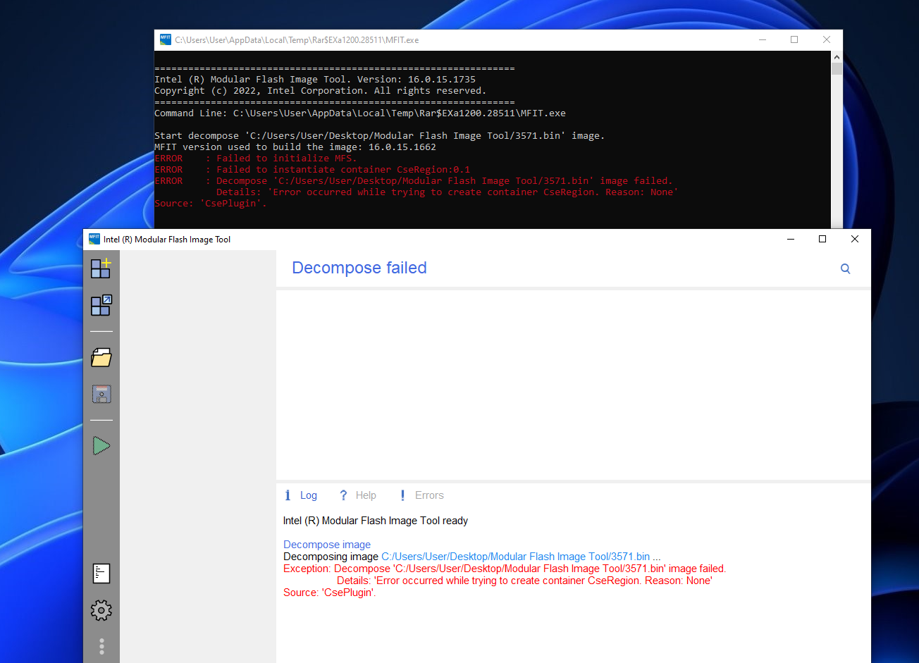

            Greetings friends, I've been trying to understand how the new way to clean the ME from a bios works for some time, and in this version 16.1.xxx it's quite complex! If anyone knows or can explain it to me I would be very grateful. In the example I use a bios of a dell precision 3571, where I can't even unzip the file, even with the MFIT in the current version of the file or in the previous version according to the error that appears.
            • hoaca388
              Badcaps
              • Jan 2022
              • 11555
              • Viet Nam
              #166
              Re: ME Firmware Cleaning Guide
              No ways. It's possible if 16.0.xxx version.
                • 20611
                #167
                Use MFIT 16.0 with ME 16.0 firmware. Post the bios in one of the related thread topics,or start a new thread,we`ll see if we can do anything with it.

                  • santoslao
                    • Apr 2017
                    • 101
                    • BZ
                    #169
                    attention to the details of the prints.
                    • santoslao
                      • Apr 2017
                      • 101
                      • BZ
                      #170
                      Hello friend, thank you for your feedback and for your interest in the subject. See that I posted prints, and they are from the same firmware, notice that the print. of ME Analyzer has a very strange information by the way, in the version this one is "ME 16.1.25.2128" and was created by a Flash Image tool "16.0.15.1662". I tested it in both FIT but it doesn't open in any of them, that was my question about it, why it doesn't open in any of the FIT, be it 16.1xxx or 16.0xxx.
                      See.. https://youtu.be/a63Lhep3Jz0

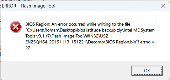

                                          #180
                                          I checked my BIOS dump with ME analyzer, which is 9.1.37.1002.
                                          I use Intel ME System Tools v9.1 r7 package and FIT, but no matter what I do I will always get an error when opening the BIOS dump in FIT. No idea what I could be doing wrong. Error number 22.
