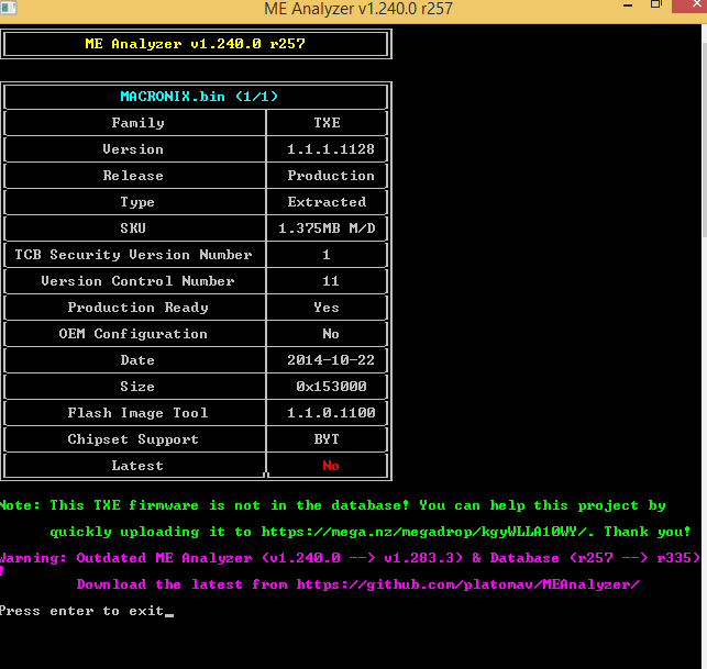

        Hey, where can i upload this file? This TXE firmware is not in the database
          Its ok to use an older or newer version,it doesn`t have to be the same one.The major and minor version has to be the same though 1.1.x.x

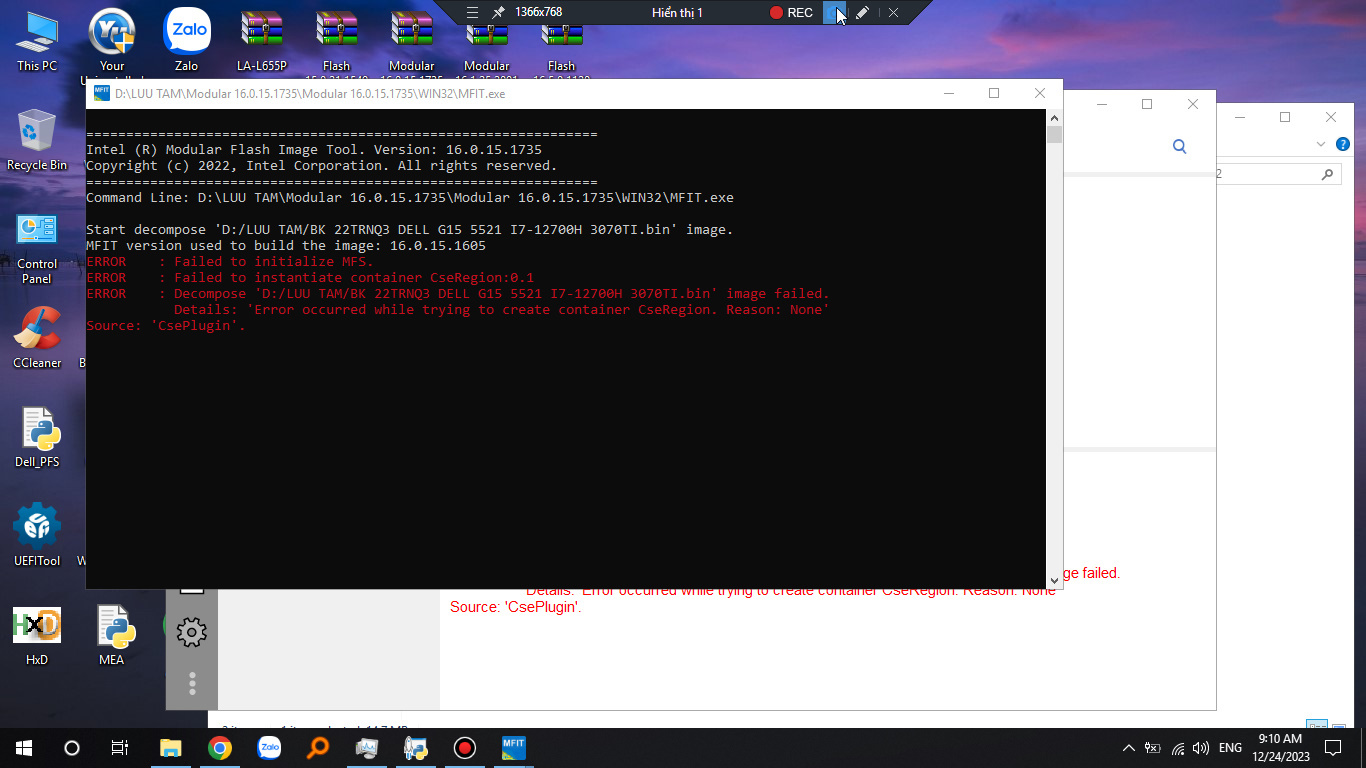

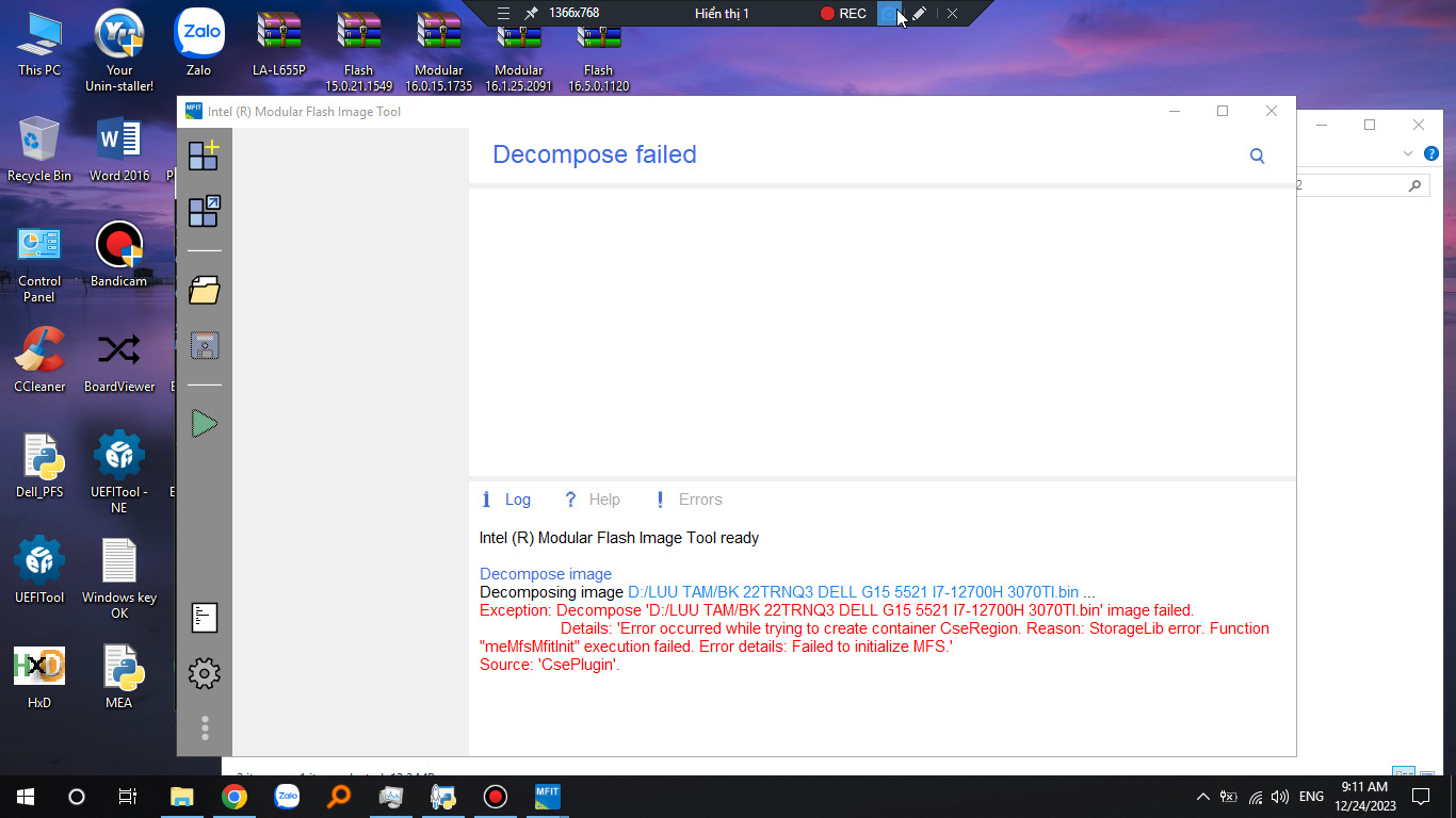

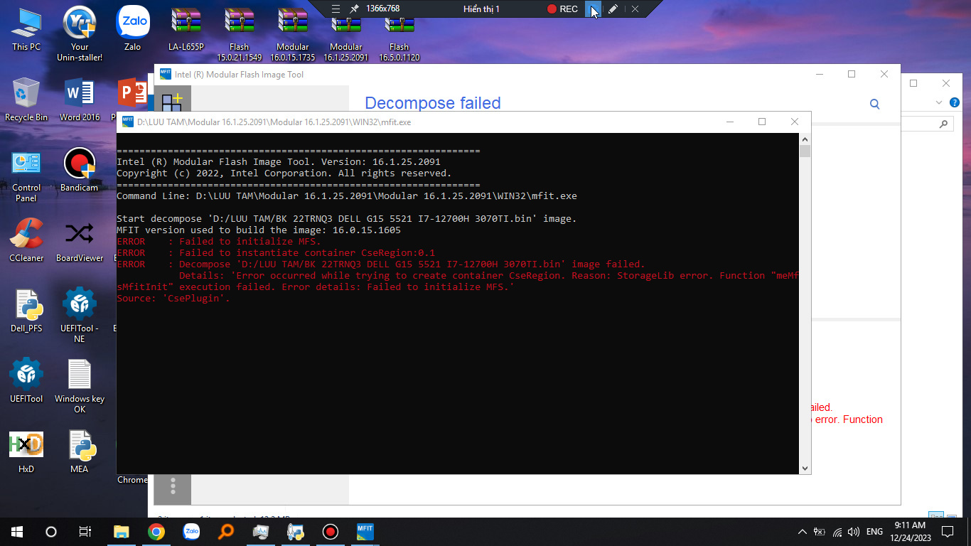

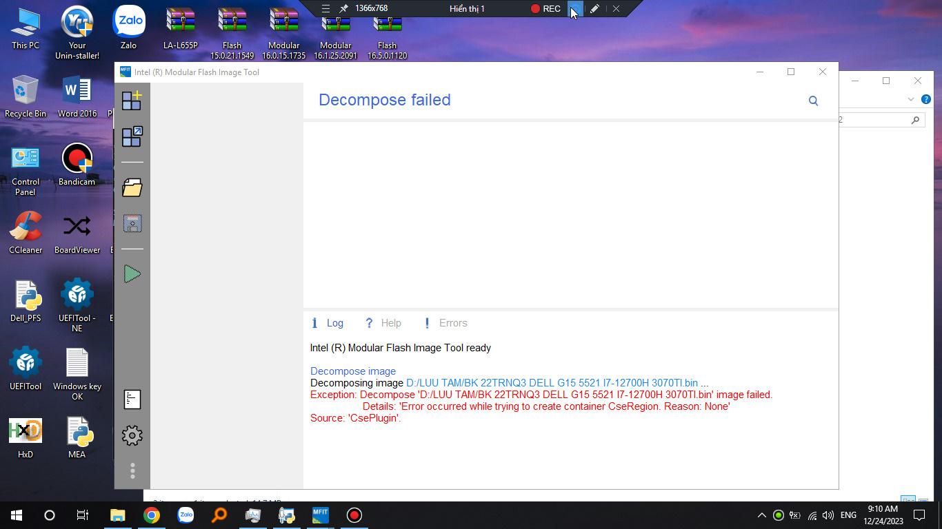

                        How to fix this error cseplugin CLEAR Failed ???????????????????????????
