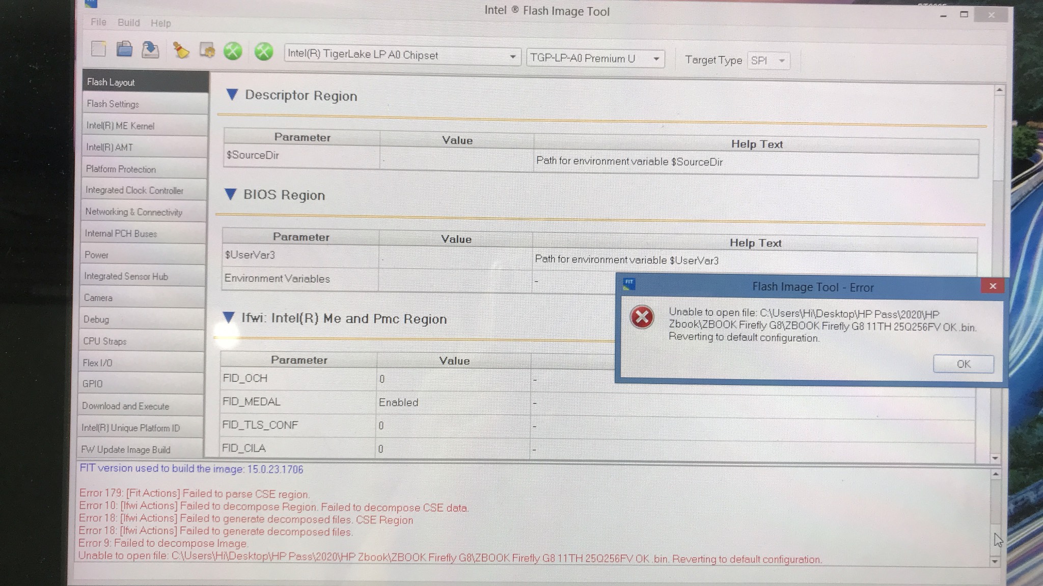

      trying to clean ME region in HP Zbook 15 G3. Working with full BIOS dump, which is 16 MB (16777216 bytes), done using ch341a. MEAnalyzer says that Version is 11.8.70.3626 and Flash Image Tool is 11.0.22.3001.
      Using Flash Image Tool v11.8.86.3877 (from package CSME System Tools v11 r46.rar) I get this error:
      Error 16: Not a valid file type.
      Error 10: Failed to open with processed commands.
      Could the dump be corrupted or am I doing something wrong?

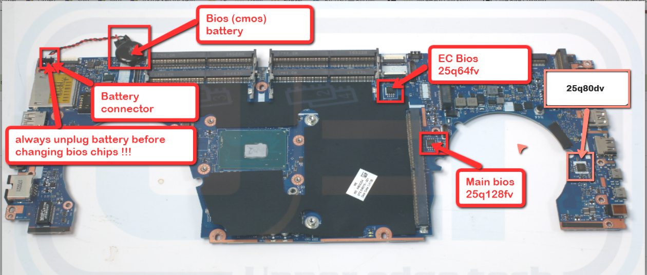

              Thanks, I'll desolder the chip and try to read it again. Just to make sure - all we need is the main BIOS and not the EC chip's contents, right? (picture shows both chips).

                It's better to combine both chips. so upload (16+8)MB.
