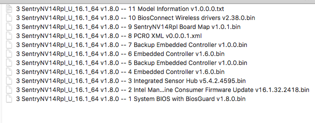

              well, you don't need to use MFIT to extract ME firmware from DELL update package, use DELL_PFS_Extractor and you'll have all modules for bios. You said you attached bios dump but it's nothing to attachements.
              Click image for larger version  Name:	Screen Shot 2024-10-25 at 19.40.03.png Views:	0 Size:	74.4 KB ID:	3492278
                it seem when i edit the message the attachment got remove ive attach it again,
                and when i try to write the me to the bios dump using hdx but it gave me eror is there any exra step to take?

                  you CAN'T just replace ME Region with hDx and expect to work, that's why I told you to read guide made by SMDFlea how to clean ME.
