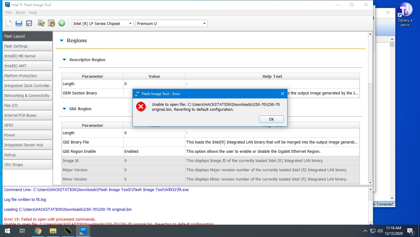

      Originally posted by ktmmotocross
      when i try to open bios file i get this error
      guys i still have problems with FIT tool. i want to clean me in T460s bios but FIT wont open bios still the same error with all bioses
              I can tell by looking at your picture that you`re trying to open a G50-70 bios with the wrong FIT version. See the attached picture the G50-70 bios opened with MEAnalyzer,the ME firmware is version 9.5 ,so you need to use FIT from the "Intel ME System Tools v9.5" .The T460s does have ME 11 ,so open it with FIT from the Intel CSME System Tools v11

                    #89
                    Re: ME Firmware Cleaning Guide
                    Thanks for clearing it up. i dont know that FIT is from that tools with many versions.
                    so i need to first check me version and by that use correct FIT version?
                      • 21605
                      #90
                      Yes thats right. Hre`s the link at win-raid https://winraid.level1techs.com/t/in...ols-2-15/30719
                      Scroll down the page to: C2. (CS)ME System Tools .Click on one of those tools links and it`ll take you to mega. Check back there every few months to see if there`s a newer version of the tools.
                      You can run into a few issues sometimes trying to open a bios with an older version of FIT than what it was built with,ME 11 and under seems to be ok,its 12 and above that can be problematic.MEAnalyzer will tell you which version of the tool it was built with,that exact version might not even be available. Ive got 3 different versions of the "Intel CSME System Tools v12" ,r10 r14 and r21 ,each one has a "Tools Version Info.txt" file with a build number for each tool. The r10 FIT version is 12.0.6.1120 ,r14 FIT version is 12.0.22.1310 and r21 FIT version is 12.0.49.1536 .

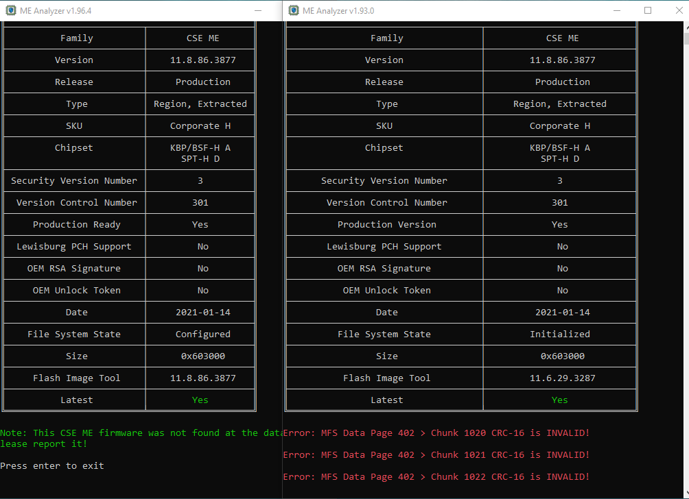

                      If i have a bios doesn`t open with one version i try the others,if it doesn`t open with any then its probably because the bios or ME firmware is corrupt.
                      • ktmmotocross
                        Boardkiller

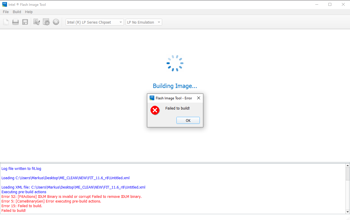

                                Hello SMDFlea,
                                is it possible that the bios file is defective?
                                With this Lenovo X1 Carbon 5th, the touchpad does not work under Windows 10 at any time.
                                Maybe it has something to do with the bios file.
                                Thank you very much
                                It looks like the bios didn`t build because you didn`t open the untitled.xml file before clicking on the build button.The bootguard warning should be yes.
                                Install lenovo thinkvantage and let it do the driver updates,you`re probably missing something like the serial io driver,have a look in device manager and see if theres any yellow triangles.Don`t trust windows to install all the drivers

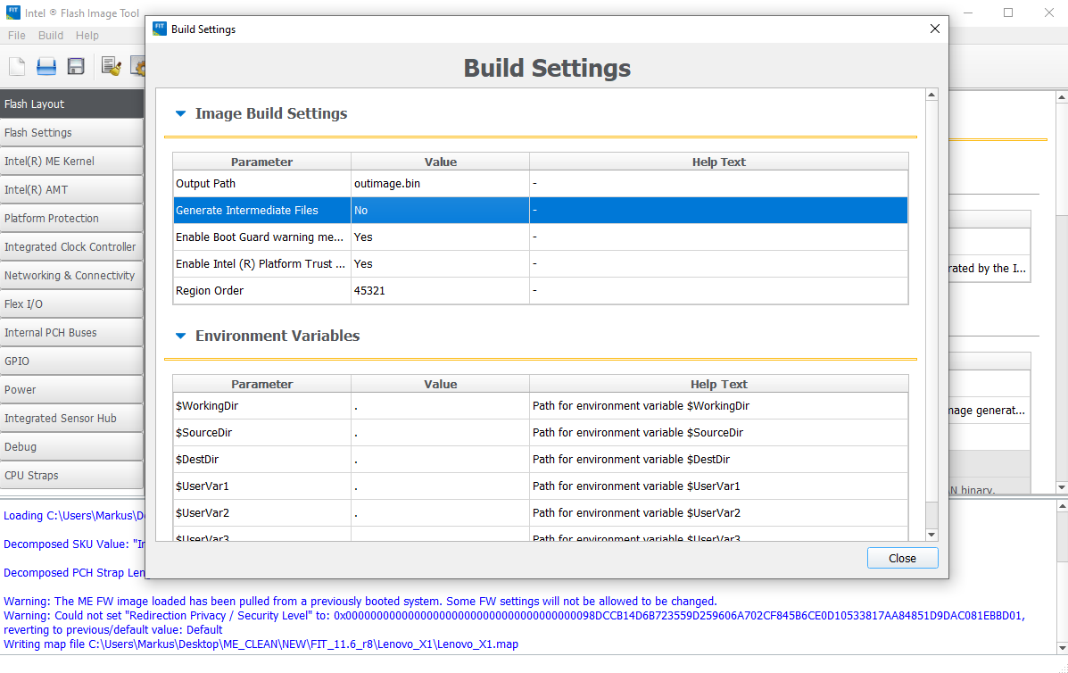

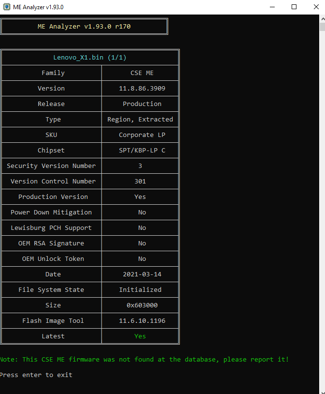

                                • Markus1741
                                  • Sep 2020
                                  • 903
                                  • N/A
                                  #96
                                  Originally posted by Markus1741
                                  Hello SMDFlea,
                                  Thank you very much
                                  Hello SMDFlea,
                                  sorry for my mistake, I guess I loaded the wrong FIT from the internet.
                                  I used the version from the Win-Raid Forum CSME System Tools v11 r44 and it works without any problems.
                                  Many greetings

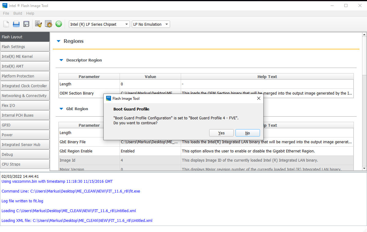

                                      I have a question in the picture if I had this error in the ME Analyzer again when checking the BIOS file.
                                      What does it mean now?
                                      Error: MFS Data Page 402 > Chuck 1020 CRL-16 is INVALID !
                                      Maybe you can explain that to me.
                                      Thanks in advance.
                                        • 21605
                                        #99
                                        Hello SMDFlea
                                        Thanks in advance.
                                        It means part of the ME FW is corrupt.If the bios opens and builds ok with FIT its fixed but sometimes it can be too corrupt and it won`t open.
