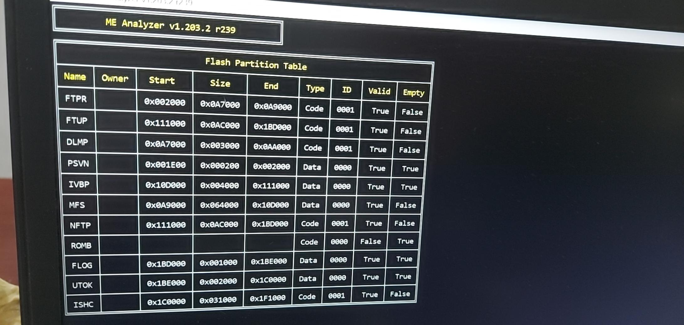

    The touchscreen can be fixed by cleaning the ME firmware and making a change to a few settings in FIT (flash image toolkit).Change the "Integrated Sensor Hub Supported" from NO to YES ,the "ISH Image - InputFile" will change to the bios image path.If the "Integrated Sensor Hub Initial Power Up State" is set to disabled then set it to "Enabled" .After changing those settings clean the ME as normal,the settings wil be retained in the saved xml file.

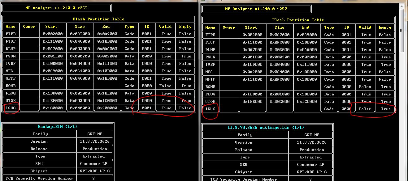

    In picture 1 is a bios dump on the left and a bios with cleaned ME firmware on the right (non working touchscreen,without the fix).Compare the different settings.
    The dump on the left has the correct settings.

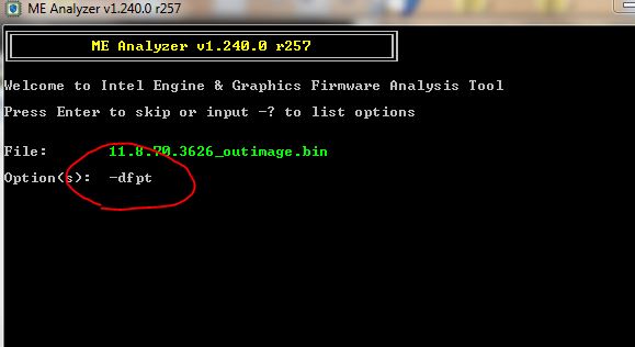

    open the bios with ME Analyzer using the -dfpt switch
    Both bios showing the ME Partition layout.ISHC is the integrated sensor hub firmware partition
    Cleaned ME bios,showing the ISCH partition as TRUE after changing the "Integrated Sensor Hub Supported" from NO to YES and
    changing "Integrated Sensor Hub Initial Power Up State" to Enabled
